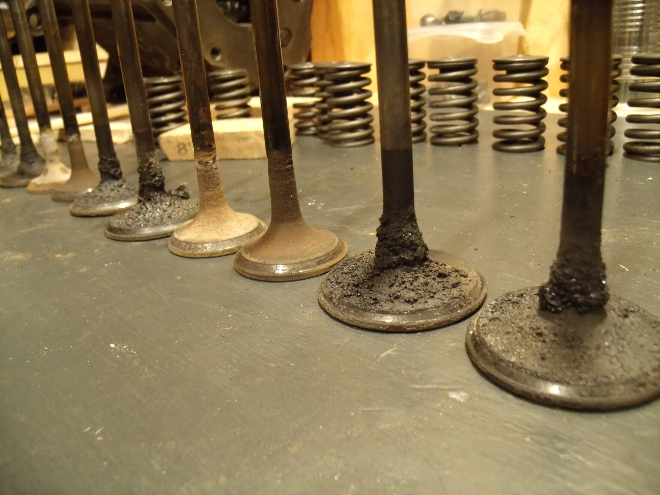

I'd grab what others consider snake-oil. Once you get enough oil in the combustion chamber that it is visibly ejected from the exhaust upon deceleration of the engine rpm, you'll likely be making engine deposits. Fresh oil, clean spark plugs, and fresh gasoline is critical. I take it one step further by running fuel additives like Techron. I'm currently using an aggressive detergent synthetic oil, Valvoline Restore and Protect because deposits on ring landings ruin rings and piston walls. All the traditional noise of ZDDP is assuming that the calcium and sodium-based detergent package that was common before '20 is still in use, which it is not - ZDDP's protective layers stays on the engine's critical surfaces because the modern detergents now target varnish, and sludge deposits, and not specifically ZDDP. Because the engine isn't undergoing the proper rebuild, you'll have to deal with the congestion on top of the valves from leaky seals.
My 2F used to visibly burn oil. However, things have really improved since the (50-year-old?) valve stem seals were replaced. Throttle response is better, and it runs much better in the cold than it did ever. Compression is up from where I started on the scrapyard 2F motor. However, lapping valves might be worth the effort to increase the sealing at top. It is also running kinda dry because the cylinder hone has been worked thin, or worn-out...

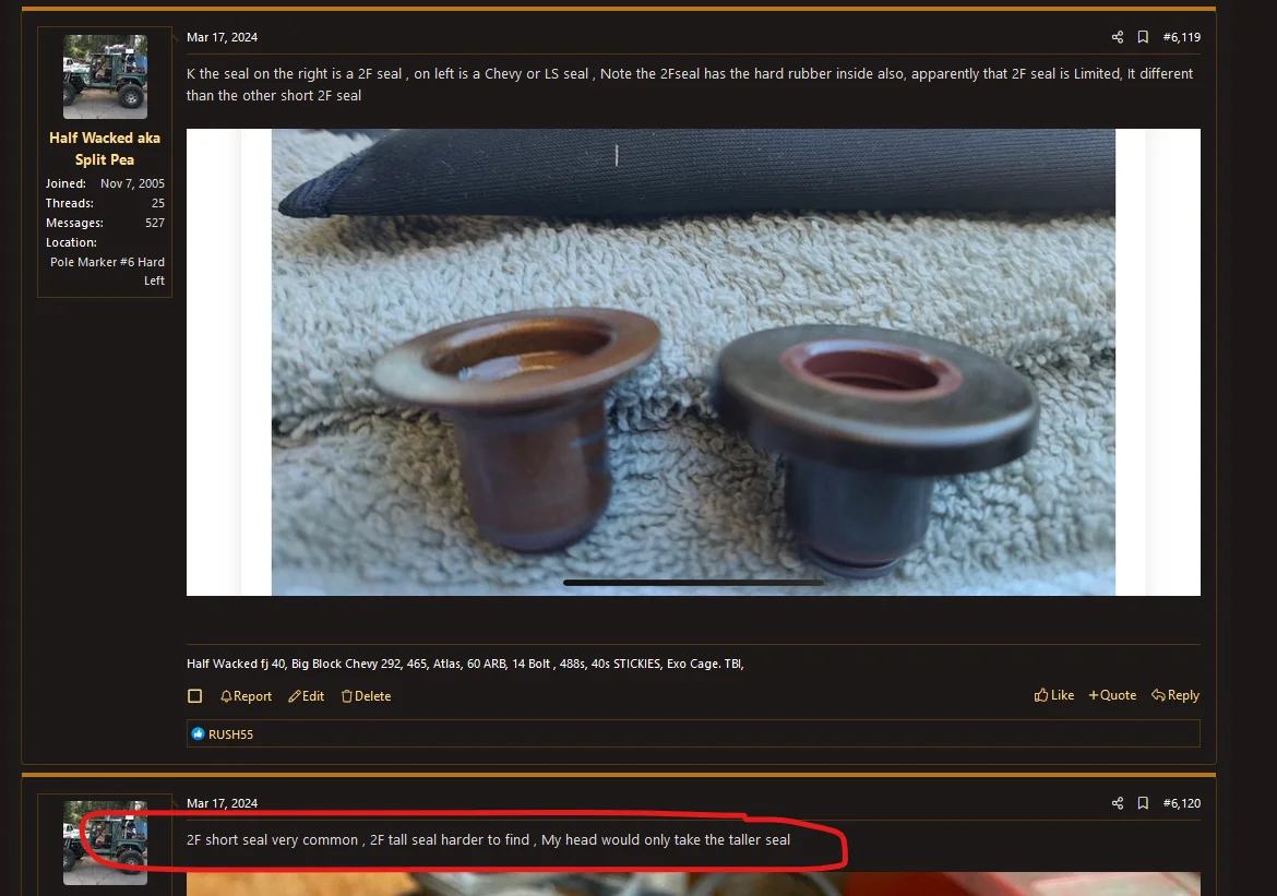

Go to Cruiser Outfitters, not Cruiser Teq. Try the actual correct style (I realize that they are basically interchangeable) for the year of your valve guides - $5.50 /each. They don't press on, unless the valve guide has been replaced/updated. They are 'deflector' / umbrella-type valve stem seals, not positive. Valve Stem Seals & Valve Seals | Fel-Pro Gaskets - https://www.felpro.com/parts/engine-repair/valve-stem-seals.html
Cruiser Outfitters: VCC02017OEM
I used a length of rope (3/8 x ??') and stuffed it in the cylinder, turned the crank until the the cylinder compressed the rope at TDC, that kept the valves from dropping into the cylinder while I changed out the valve stem seals. Borrowed the spring compressing tool from Auto Zone. Took a couple hours and was really not all the difficult. No more smoke on start up for me. I've had good luck with Rock Auto, but I also like to support the Cruiser community.

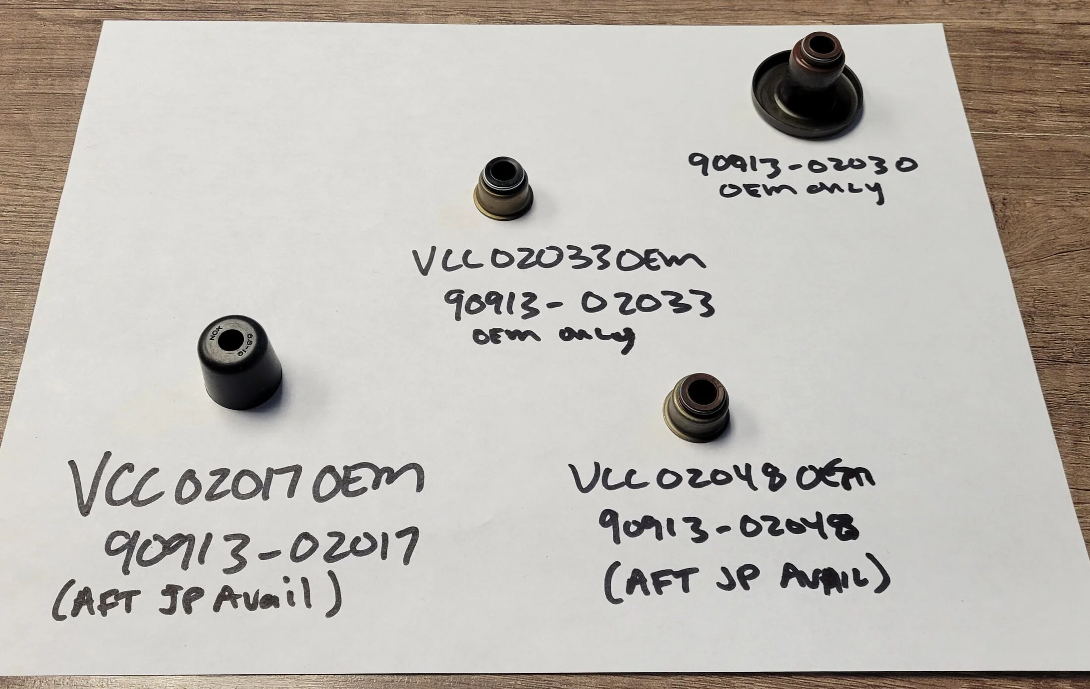

We have (3) of the different types of F/2F/3F valve stem seals, many in both OEM and Japanese aftermarket so 6-7 part numbers we service. We then have them parsed by the years they cover, while similar, there are differences between even identical looking seals, some of which can be interchanged. We've looked at some import seals but didn't like the QC upon comparison with the OEM. Given the scope of work to change seals, we've found most customers want OEM/Japanese NOK seals either loose or in our EGGK engine overhaul or head gasket kits.
I've not been able to determine a difference between the 02033 and 02048 outside of material color and code, many aftermarket suppliers list them as the exact same. In that case, our VCC02048 is a Japanese seal for half the OE price.
@cruiseroutfit @OGBeno
the 90913-02030 is interesting.... i dont recall seeing this one before... by the part number it predates the 33 and 48... do you know what years that came on?
90913-02030(08/1976 - 09/1978)
On an individual level, it supersedes to the 90913-02033 but we have OEM as they still come in some OEM engine overhaul kits. Some have reported they couldn't get the 02033/02048 style to fit their head. I need to research that more in my free time :D

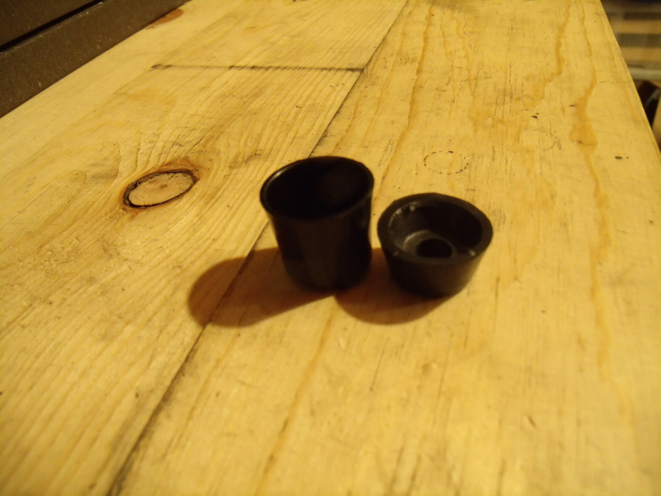

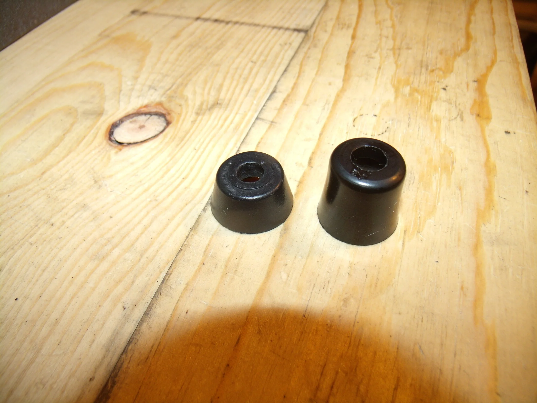

The tall one was out of either a 2/75 or 4/75 2F. It says "2F" on top.
The shorty is under my valve cover currently. I got them from SOR. No issues, about 9,000-miles and five years of use.
Those large diameter ones that Kurt posted look like they are a valve stem seal combined with a valve spring seat? Or are you supposed to use a valve spring seat as well?
As far as original valve guides, the chamfer on the early engines is greater, and only deflector or umbrella seals were originally used. Later valve guides allow for the pressing on of valve stem seals, and were metal on their bases, where they press on to the valve guide.
