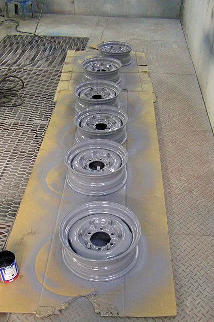

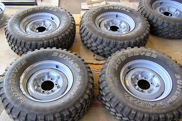

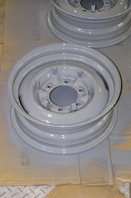

The rims got their first coat of gray Friday. Here's a coupla pix in the spray booth.

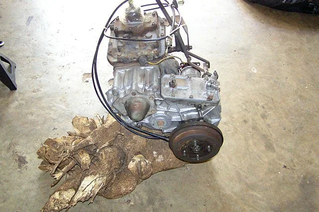

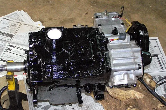

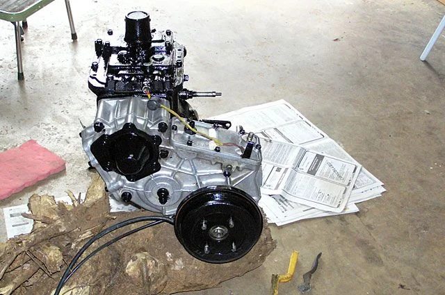

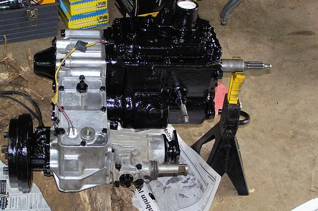

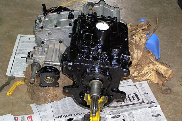

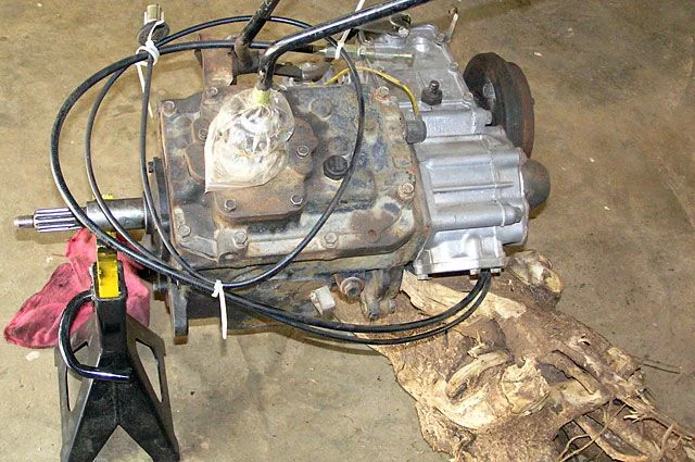

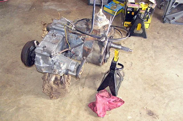

Meanwhile, back at the ranch, the gearbox is ready to be cleaned up and coated with RB Black Shell.

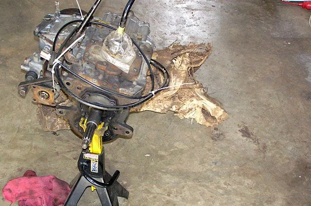

Yes, that is a "tree root jack stand" :D I've only got two, and had no time to get one from Chris before the weekend. It works.
Looks like the rebuild I did on the gearbox about 4-5 years ago is holding up fine - no leaks anywhere. Yet :lol:

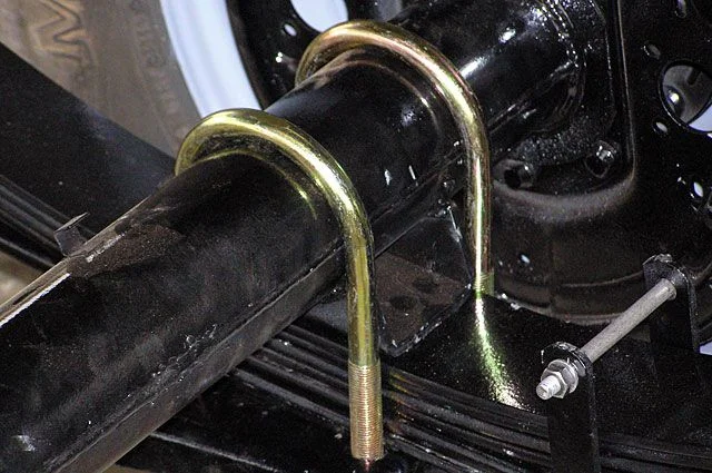

Clean, replated bolts would have been nice, but that is a cosmetic thing that is not done here. So, I just coated them with RB Black Shell, since what I really don't want is rust. :)

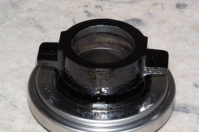

Tomorrow, I'll take the old release bearing down to one of the indies I use for service on embassy vehicles, to get the hub pressed out and the new bearing pressed onto the hub.

I'm sure they would be more than happy to use a BFH on that bearing :D I'd prefer to have it pressed... And Constantini Brothers have a nice machine shop with the repair shop. I'll have them skim the manifolds to make sure they are flat, too, since I noticed some carbon on the manifold gasket when we were pulling the engine.

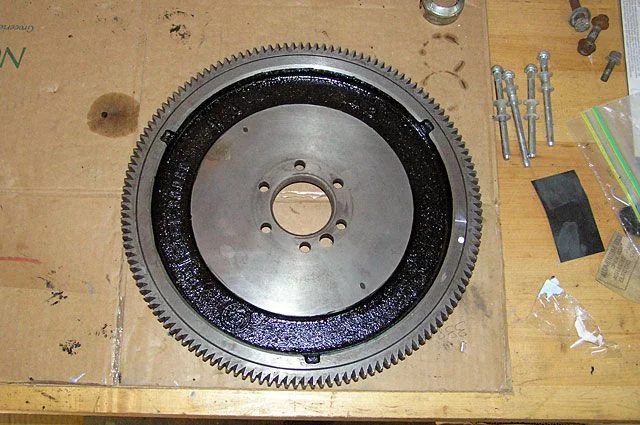

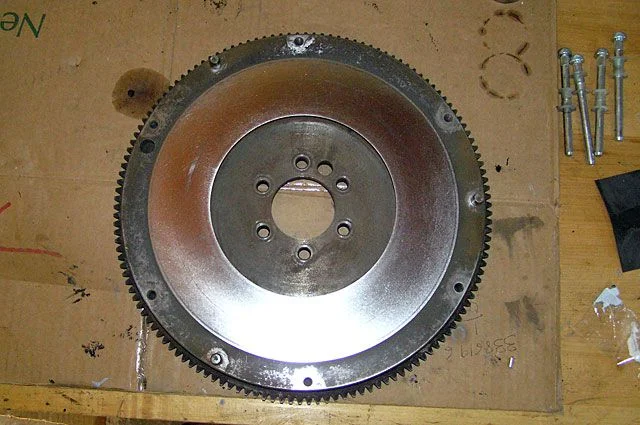

Plus a 30-year old flywheel still in good condition. After checking the surface several times with a straightedge, I decided no need to skim this, just a light clean up with some fine sand paper and it's good to go. Should be good for a couple more years at least. :)
Progress again!
Hmm... Don't know why the pic of the flywheel looks brownish - that surface is really quite sooth and shiny.

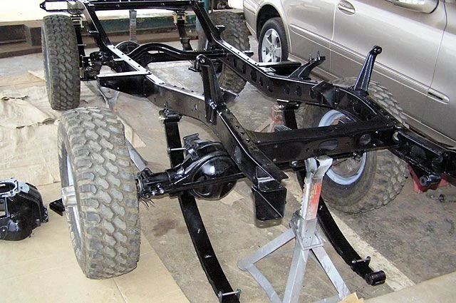

Anyway, I think we finally got past the hold up at the panel beater and are back on track. I took Friday off from work and managed to make a little progress on getting this beast back together :bounce:

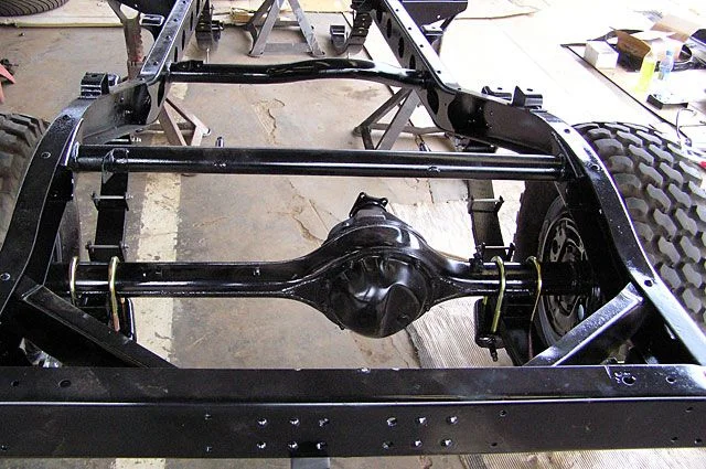

The rear axle is on. Didn't manage to get the front axle bolted up yet, so it will have to wait another week :frown: Boss won't let me burn any "use or lose" time right now, since we have a congressional delegation coming on 5-6 July to screw up our 4-day weekend :mad: We're using the 3rd for the official celebration, then would have had 4-7 July off (one US holiday, one Malawian), but no-o-o-o-o.... these guys have to come right in the middle of the weekend, and we have to treat them like royalty... sigh! THAT will be a wasted weekend :rolleyes:

Are you using the panel beaters to reassemble as well or are you doing it? The rolling chassis looks like it is brand new. What a fantastic job you are doing! Sorry about the dignitaries Fudging up your weekend.

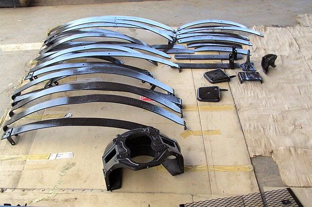

That stuff is still at the panel beater, but I am doing the work. I did ask them to help me shift the heavy stuff around :) ...gettin' old - don't lift stuff like I used to, so I needed help getting the frame flipped over on the stands. When I asked for stands to put the axles on, so I could mount the tires, they just picked 'em up and held 'em for me. :D
Anyway, the black parts are mostly back home now, except what I need to finish bolting up the chassis and getting the engine back in it, so that can come home for me to work on. They started the silver bits Friday - looking pretty good so far. The blue parts will be the last, since we're still waiting for the seam sealer to get here. I'm just happy to be :wrench::wrench::wrench:ing again!
