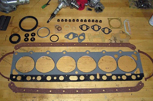

Went by the Toyota dealer to inquire about gaskets - nothing. (Well, they DID laugh! :p) Then went to the indie who maintains my out-of-warranty motor pool vehicles, and sure enough - he had a complete gasket set for the 2F engine. Cost me $70 equivalent, and is not OEM, but should work. I'll have to take pix of that, too. It's a rebuild kit, so it has pretty much everything. :clap:

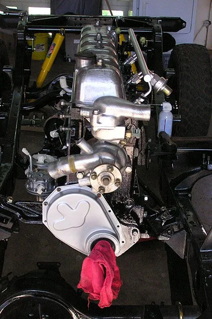

Back at the ranch, I have been able to get back to work on the engine clean up. The leak at the rear of the engine has hopefully been resolved. Now I'm going after the timing gear cover leak and an exhaust leak.

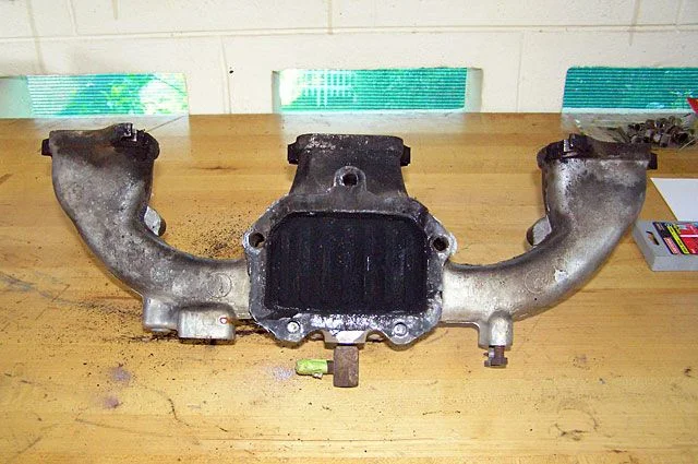

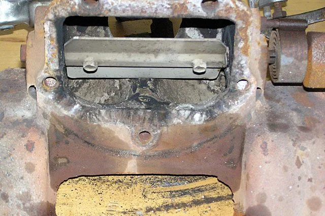

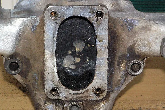

The manifolds are actually in decent shape, but the carbon tracks on the gaskets and the side of the engine show a lot of exhaust leakage - between the manifolds, at the head, and at the EGR pipe connection. This can all be resolved with a little sweat and some new gaskets & sealer.

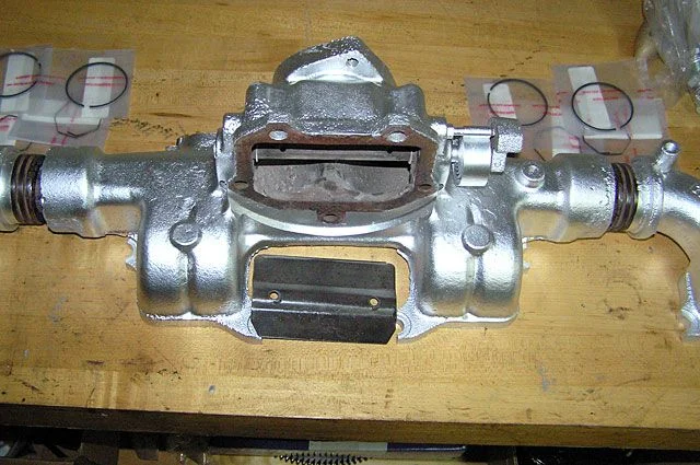

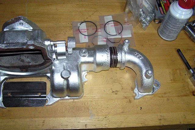

The ring seals on the exhaust manifold ends were completely compressed. They came out easily, and the ends and grooves cleaned up nicely with some emery cloth. The new seals went in easily.
What are you using as a spacer between the manifolds? I'd recommend a solid piece of stainless steel like SOR sells. You could fab it up easily. It may prevent the heat from the exhaust manifold from someday cracking your aluminum intake manifold.

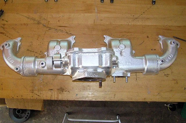

The manifold ends went back in easily, and are once again a nice tight fit. I wanted to do this in a semi-gloss black, but the only high temp aerosol I could get without waiting for months was the aluminum variety, so silver it is... :D
That air rail from Eddie cleaned up nice, too!

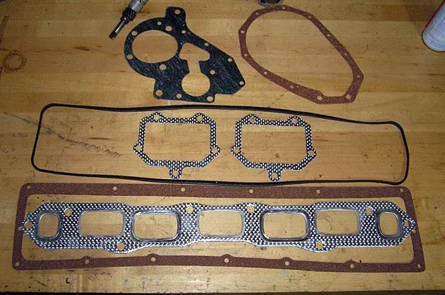

Gotta get some gaskets since I pulled everything off the engine to clean up the rust and get it painted. The owner of the independent shop I favor had told me several months back that he had a gasket set for a 2F engine. I went there today while doing all my other running and sure enough - just under 10,000 Malawi kwacha (about $70) for a complete set. I don't need most of these, but it can't hurt to have some spares on hand. A few of the gaskets won't work with my '78 (10/77 build) engine, since the kit was for '80 and later, but the kit has what I need.
Hi, Eddy.
I already have that stainless plate from SOR :) I'll have to trim the flapper a bit to make sure it clears but I think it's worth that bit of work to have the stainless piece in there. I figure that will help some of that leakage and keep the intake manifold from being as susceptible to cracking. I'll also be using the high temp copper sealer there and at the manifold/head junction. :D
am i seeing things wrong, or is that one flimsy lookin head gasket?
Might be. It's about 1/16" thick, and the metal rings seem decent enough, tho. I can't use that on my engine (and don't need it ;) ) right now, but if it was right for my '78 and I needed a gasket, I'd use it. All the others seem to be decent quality and good materials. The manifold gaskets appear to be metal clad asbestos. The set is made in Japan by a company called "Stoner". No - really ! :lol:

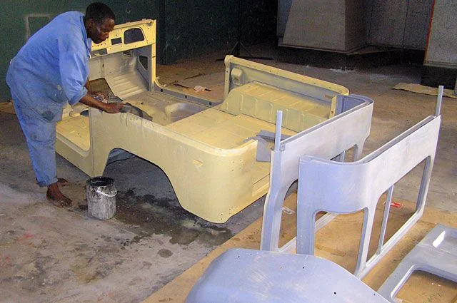

The mucked up sealer has been removed from the tub seams. I decided to just have it painted without sealer, since we can't get the right stuff. The paint work should be decent, and I can take the mule to a shop once back in the US and have the seams sealed and some touch up paint work. Not the ideal solution, but sometimes ya gotta go with what ya can get.
The second photo is Francis, my "minder". The shop here has generally been good about allowing me free access to the entire shop, as long as someone brings me in and out. Works for me, and Francis is an amiable fellow.
The high fill primer was put on over the Rust Bullet after the bullet had been wet sanded. Then the high fill is smoothed, the final primer applied and we're ready for paint. Should start the blue paint this week :)

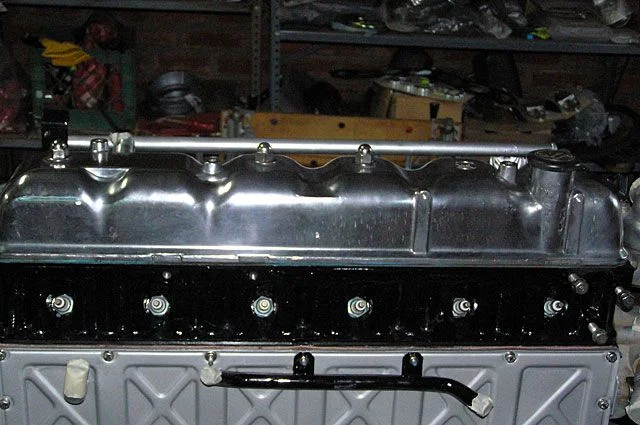

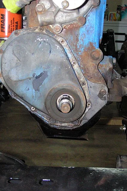

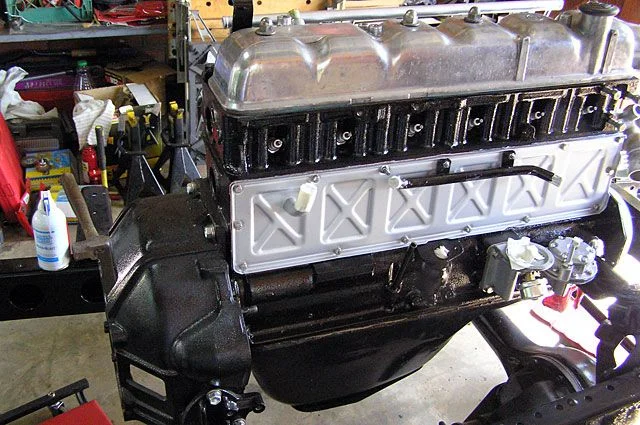

While waiting for the bits I need, I work on other things. Fortunately, there is plenty to do, and a lot can be done without getting in the way of access to the engine. I got the side cover and timing gear cover painted and the side cover installed. I put the timing gear cover on temporarily, to take the photos, but the crank pulley isn't ready to go on yet, so that cover is still to be completed. I stole the color scheme from Keith Richardson (of BJ42 to FJ40 conversion fame) :D

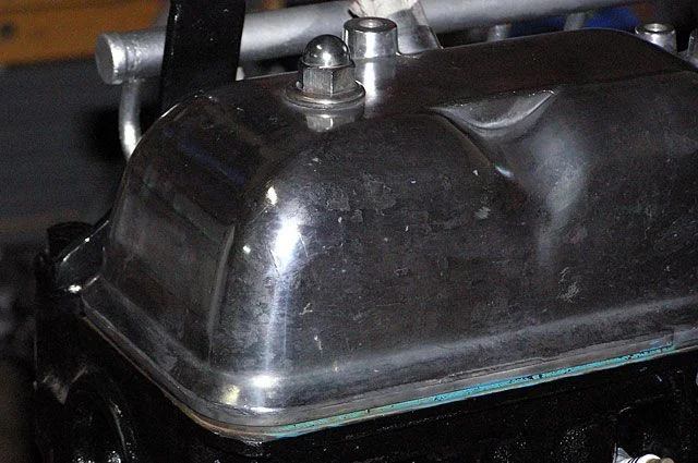

Cleaned and polished the valve cover while waiting for paint and Rust Bullet to dry.
Yep - more Rust Bullet :D

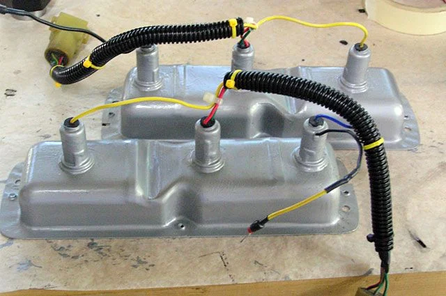

Those are new taillights. After seeing how bad the originals had rusted, I decided even with the yellow zinc coating, a little RB is cheap insurance.

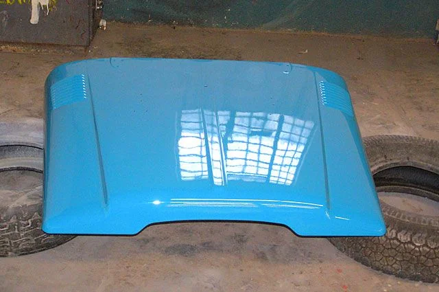

Finally had a few minutes to run by the panel beater today. Francis was anxious to show me how the work is going. When we rounded the corner next to the paint booth, here's what greeted me :bounce::bounce2::clap:
