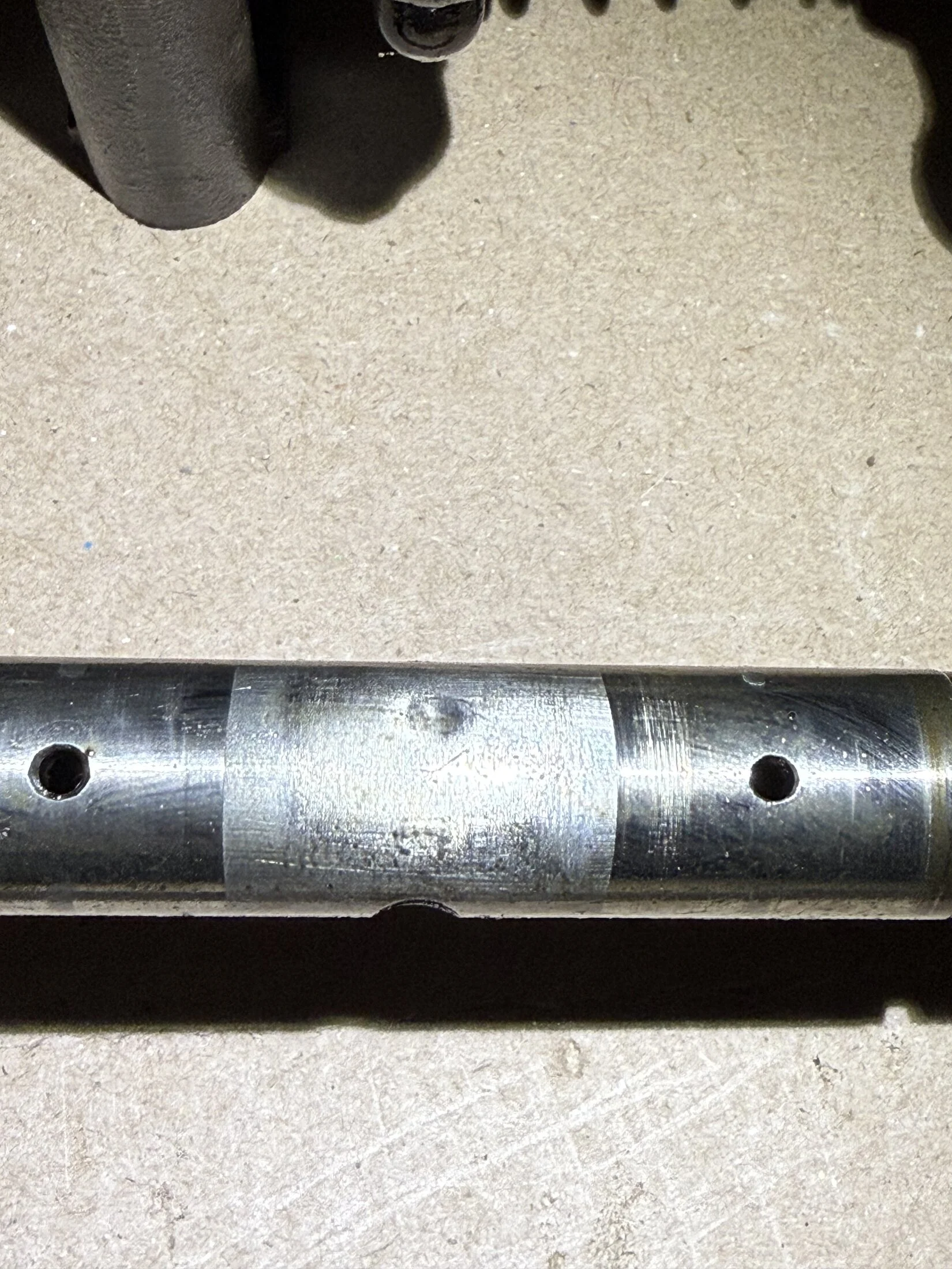

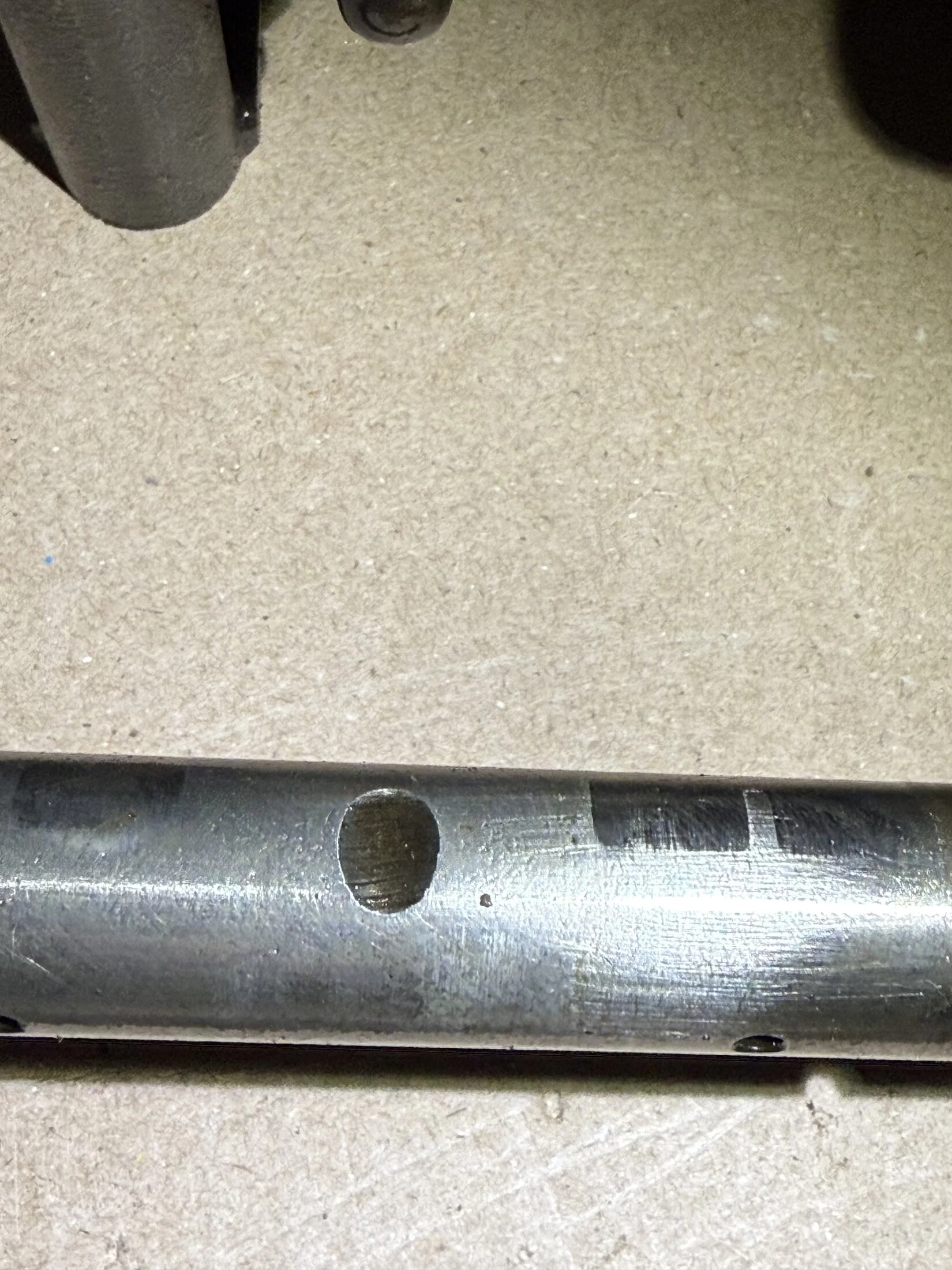

Prybar did the trick! It did dent the rocker shaft though. It didn’t gouge it/leave any knurled metal, but there are two smooth dents on each half of the shaft. Pics attached of a dent and the factory notch for comparison.
Wouldn’t the notch keep the shaft from rotating freely once the bolt is in the rocker tower? Do these dents mean my shaft is fubar? Thanks for the help.

Glad the pry bar worked for you!
The dent you made might not be an issue, but like Charlie suggested, check it for out of round. You don't want to crack the rocker support and you want it to seat properly when you reassemble.
You could probably do a quick check by running a rocker arm over that area. It should pass smoothly.
Also, check the shaft to make sure it's straight and true.

Dial indicators at harbor freight are inexpensive. I would set the shaft and indicator on flat surface even the kitchen table. Rotate the shaft and see if it's true. A metal plate to hold the magnet on indicator would be better.
