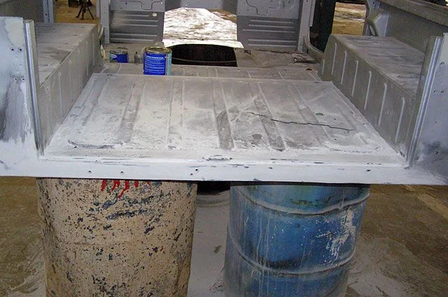

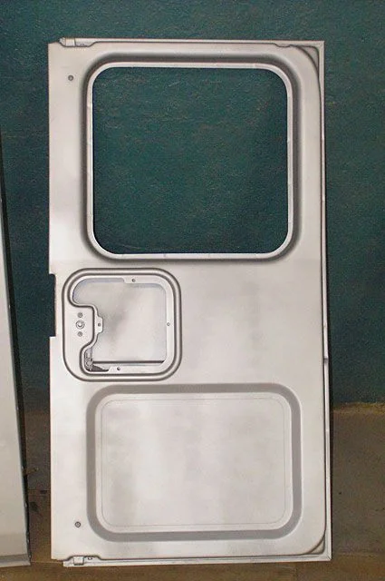

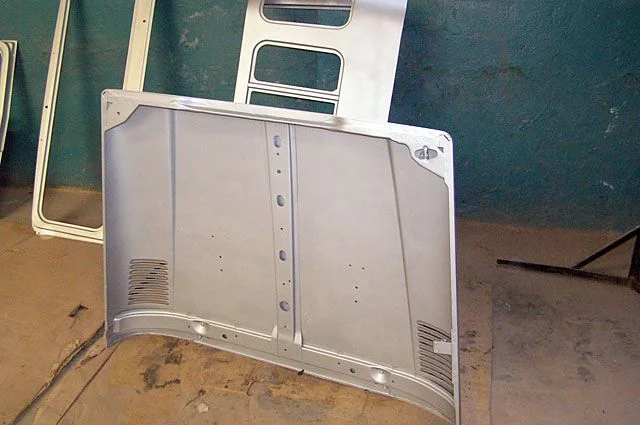

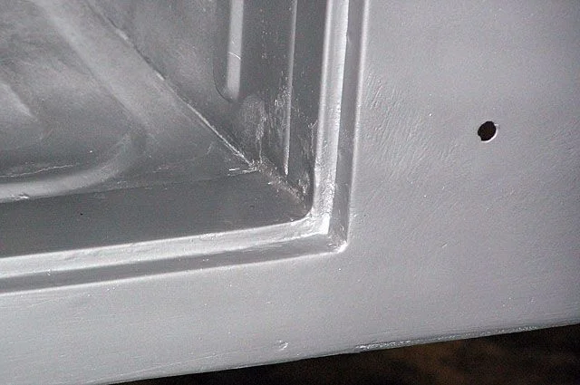

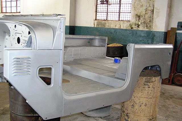

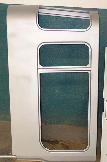

Here are more of the panels and parts under Rust Bullet. The tub and fenders are getting body filler over the welds now; I hope to have photos of them in another day or two. That will finally finish the RB part of the painting.

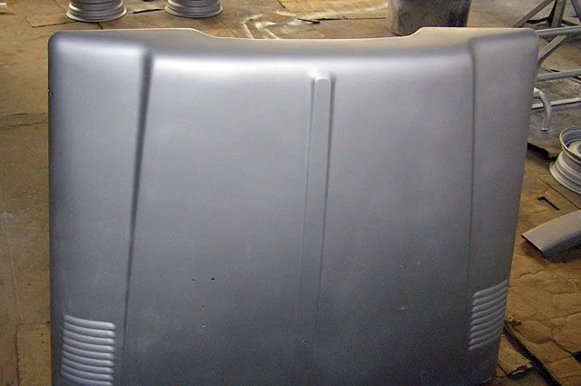

Still more panels...

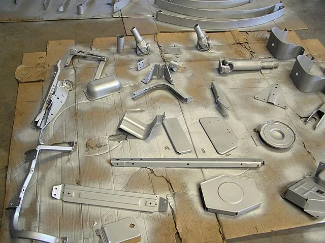

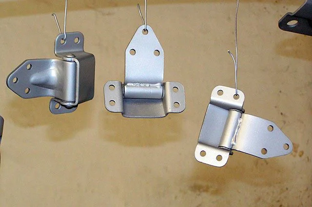

Some random bits...

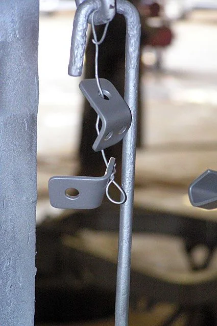

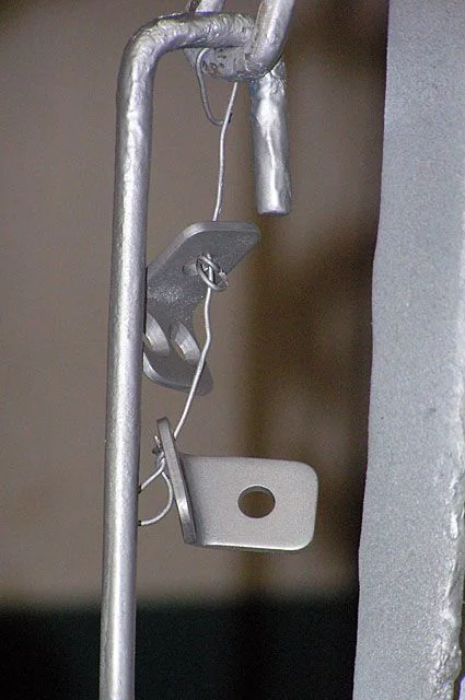

Even the smallest bits got the silver bullet treatment.

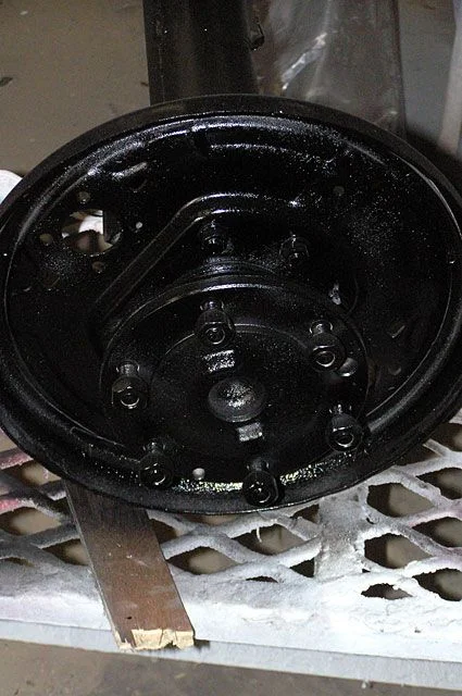

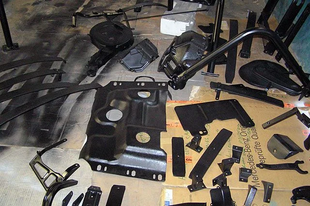

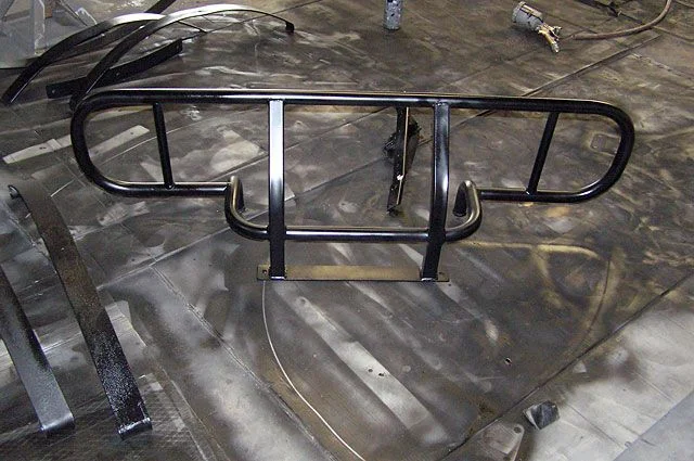

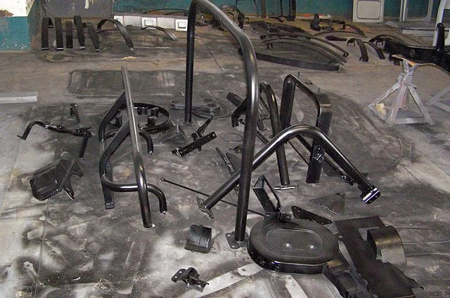

These parts got their first coat of color today! :bounce: The black parts, including frame rails and axles will get 3 coats; then smaller parts will be polished out and may get a 4th coat.
Still slow going, tho. I really don't expect to be able to bolt up the chassis until next week at the earliest, based on the current pace of painting. BUT, we're not going backward (not much anyway - a couple pieces will have to be redone, but they are small :rolleyes: )

:eek: Is there anything that didn't get the RB treatment ?:p

The glass. Rubber bits. Upholstery. Transfer case (aluminum). :D:lol:

Just a few pix tonight of more parts getting first coat of black
And the first batch of black parts to polish.

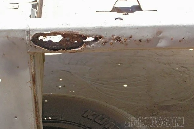

That rear sill is looking good, too. You would never know it was rusted through and nasty. :)
Oops! More RB. The tub will get two more coats after the body work is done.

Tub update
Hard to believe we've gone from rot to clean again :D (top photo is with the tub upside down)
Here's the right corner of the tub before and now
Still some work to do, but this is starting to look like it should :bounce2:
That thing will last for 100 years when you get done with it. All of the bare metal has been encapsulated. It is looking great!
That's the goal :D:D
This kind of build up should only need to be done once per cruiser :)
