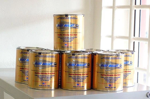

8 qts waiting in my office when I got back today :bounce::bounce2:
Took two qts by the panel beater this afternoon. They started cleaning stuff up before I left and will start shooting more RB tomorrow morning. All the patching is done, so we are ready to move forward smartly now!!!

How did you calculate the quantity of Rust Bullet you need? I am running into problems finding the Silver Label and thought/hoped 4 quarts would be enough to do my whole body including hard top etc. Now I see your 8 quarts and :confused:. Sorry for the hijack :frown:
Looking good Dan :bounce:
Theo,
That is 4 qts for me, and 4 qts for Chris :p My "calculation" was based on coverage figures from the RB web site and experience with what I had already used. I figure 1 gallon should do everything I have left to do, and still leave some for "just in case". Hope I'm right :rolleyes: I am doing everything - wheels, frame, chassis parts, and all body panels except the fiberglass; the rain gutters get it, too.

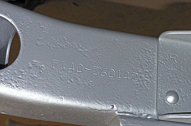

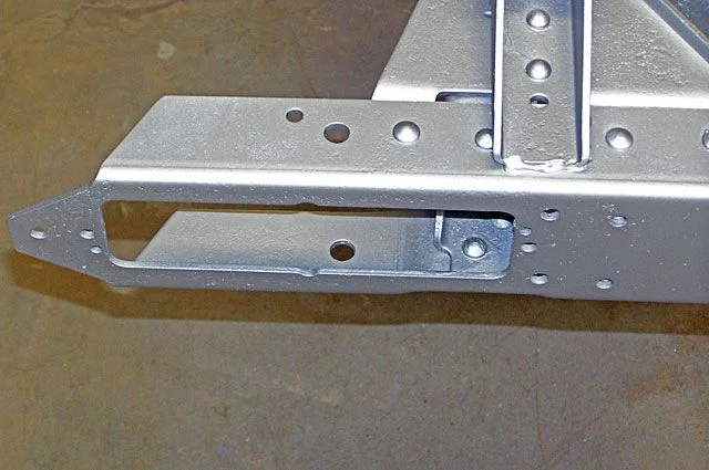

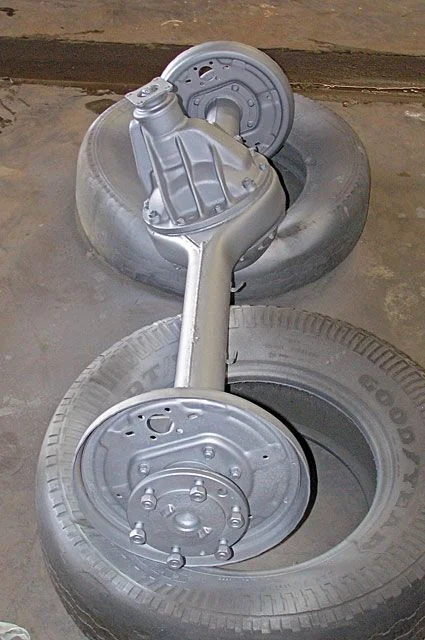

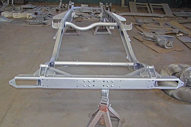

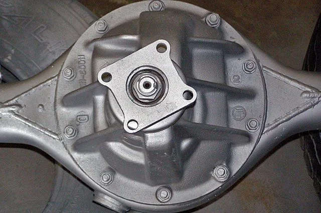

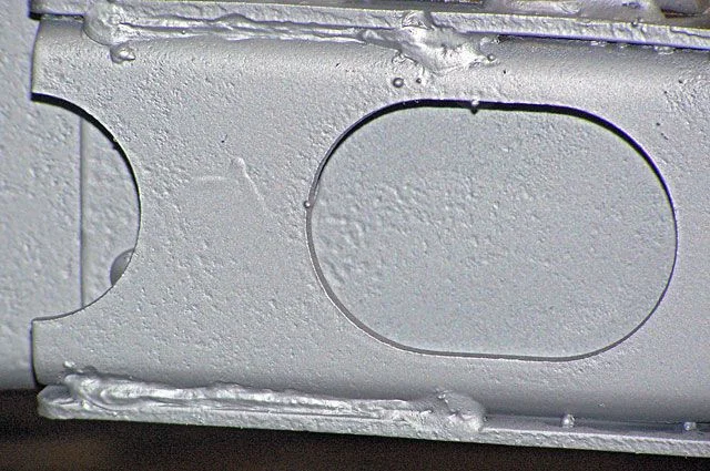

When I went by the panel beater today, they were degreasing the tub and fenders and prepping them for the first coat of Rust Bullet.
The frame, wheels, and axles got a second coat; looking good and much better results that the first attempt :o
Here are a few more pix:
They will sand a bit (couple of runs) between 2nd and 3rd coats on the frame.
Other stuff starting too look good. And yes, that is pretty much the entire cruiser, except engine and gearbox, laying on the floor there :)
Since I know everyone here just hates all the pictures, here's a few more ;p

We initially had some xylene made up, but that was disastrous. The xylene got contaminated with water, which ruined 3 pints of RB before we sorted out the problem. Then, we were able to find MEK in a sealed container, which works great, since RB is apparently urethane based. While I was in the States, the panel beater imported additional MEK from S Africa, so we are set. :D

On the positive side, since nothing had happened after I left on Friday (this counts as progress here - at least we did not regress), I was able to go over the frame rails again with an inspection mirror and point out the spots that had been missed when brushing the Rust Bullet. I chalked the spots, so they know exactly where to apply the brush, since I apparently have the only inspection mirrors in Lilongwe, maybe in all of Malawi! With the possible exception of dentists, that is. :p I also inspected all the other parts that Victor had told me were ready for paint and found a few more painter's holidays, as well as painted over zerks (with Rust Bullet) on the driveshafts, and found that the driver's side seat rails had been Rust Bulleted solid and would not operate. :bang: The "mechanic" was going to just take a BFH to it, without bothering to operate the locking lever :eek: - I intervened and we got the rails working again without violence.
