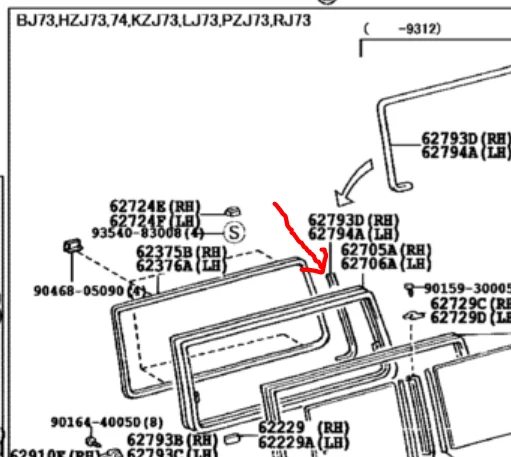

The 62793-60010 weatherstrip is the successor for 1993-1999 BJ73s with FRP top. Megazip says it's 55cm long. Why is it so short?? Here's a diagram which checks out based on the 55cm description:

From the diagrams, it looks like that bit is part of a different system of installing the window frame.

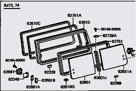

Older BJ diagram is below. Maybe this newer system traps less water/rust?

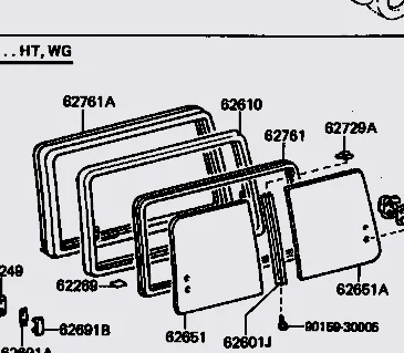

Here is the other diagram that is not labelled HT.
Is your diagram like this but cropped more?

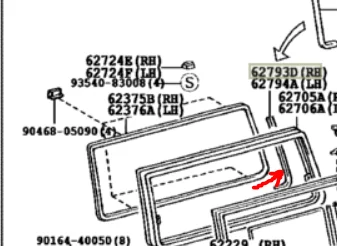

Mine is cropped a bit more and is for model years 93 and newer. It shows how the "62761A" weatherstrip above is superseded by a weatherstrip which is only about 1/4 of the old length. This is the mystery. Here it is again to compare:
The parts catalog calls it a "weatherstrip" and the repair manual calls it a "frame spacer". The latter term is more accurate. The frame is actually sealed to the top with butyl tape (orignal # 08850-00065, "butyl tape set"). I don't think the "spacer" is all that critical. I think it's more of a way to fill the void between the frame and the top and to help with positioning the frame in the opening in the top. I'd fill the space with the Butyl tape. The size of the spacer/weatherstrip was likely changed since it was probably bigger than it needed to be.
