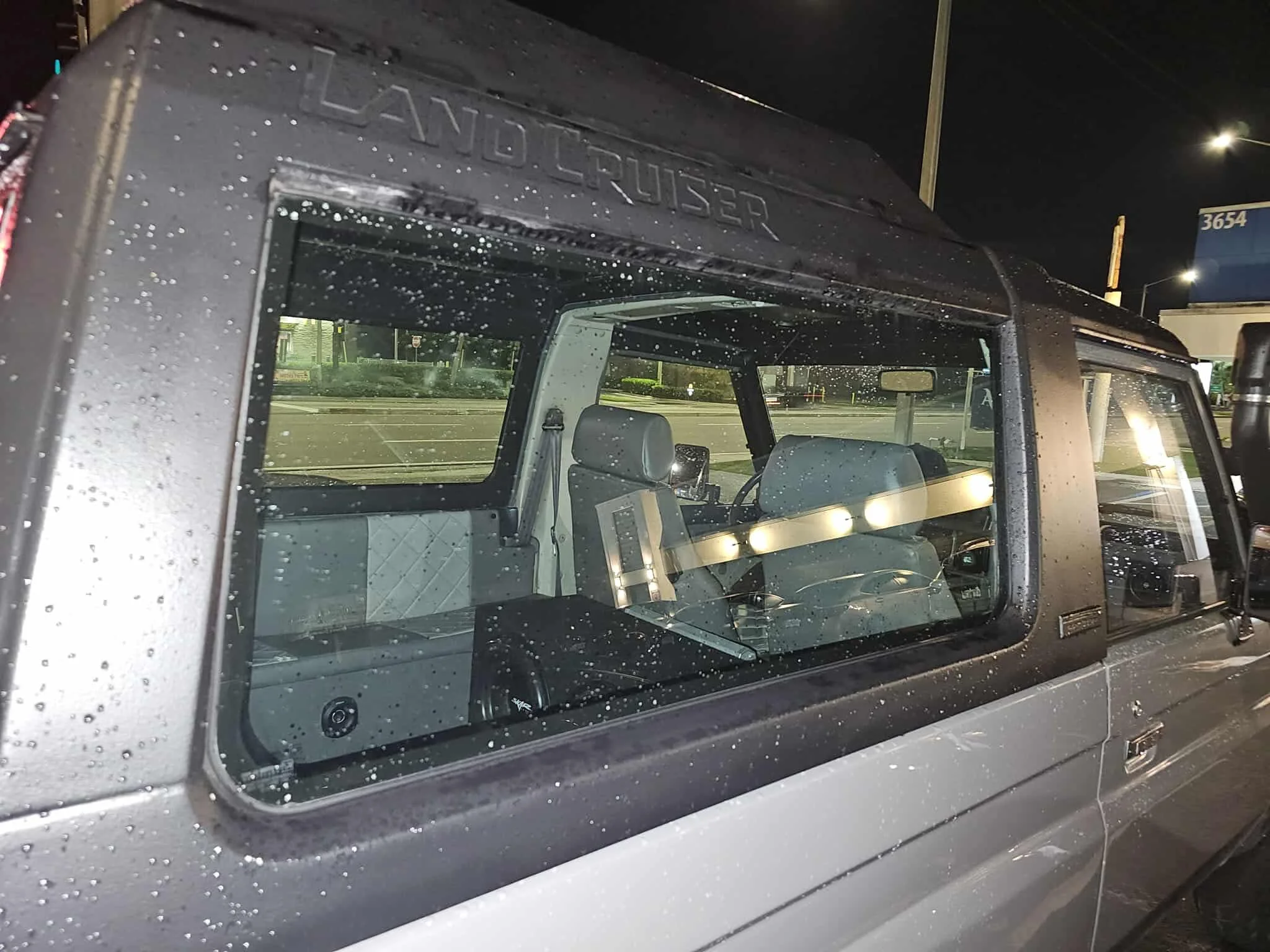

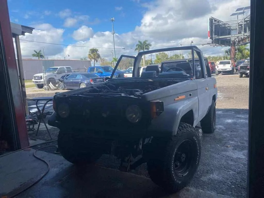

Thank you all for your thoughts. Let’s get some photos going.
I had no idea these were locally modified tops, I don’t mind the looks of it. Not sure would hurt or help resale, but I’m not planning on flipping it.
The windshield has the hinges, but not the hood brackets. Doors are all full height.
He had it painted, and the windshield was off it for the repaint. I saw that in a couple of pictures.

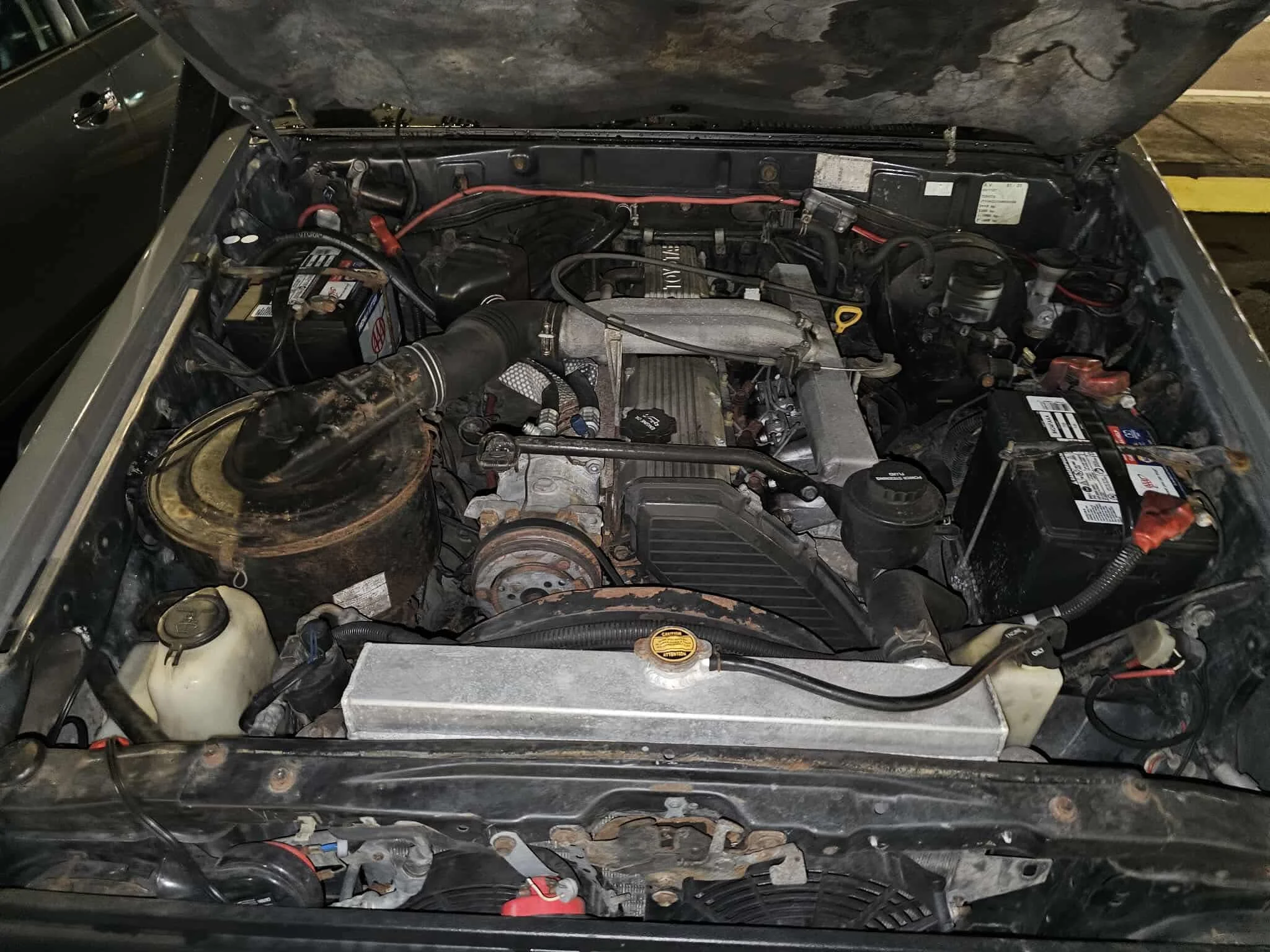

For you experienced guys, please have a look at the engine bay and the pics and let me know if you see any red flags! These things are not cheap when they left-hand drive!

So your top just has a small cap on it, rather than a full cap like my spare top has. I mean, you can keep it, make some storage up there?
I would really like the see all the before pictures as you can see rusty/crusty bolts and engine pieces so I would want to make sure all the rust was mitigated correctly and not just bondo/patch.
I see a pusher fan on the front as well as an aftermarket radiator.

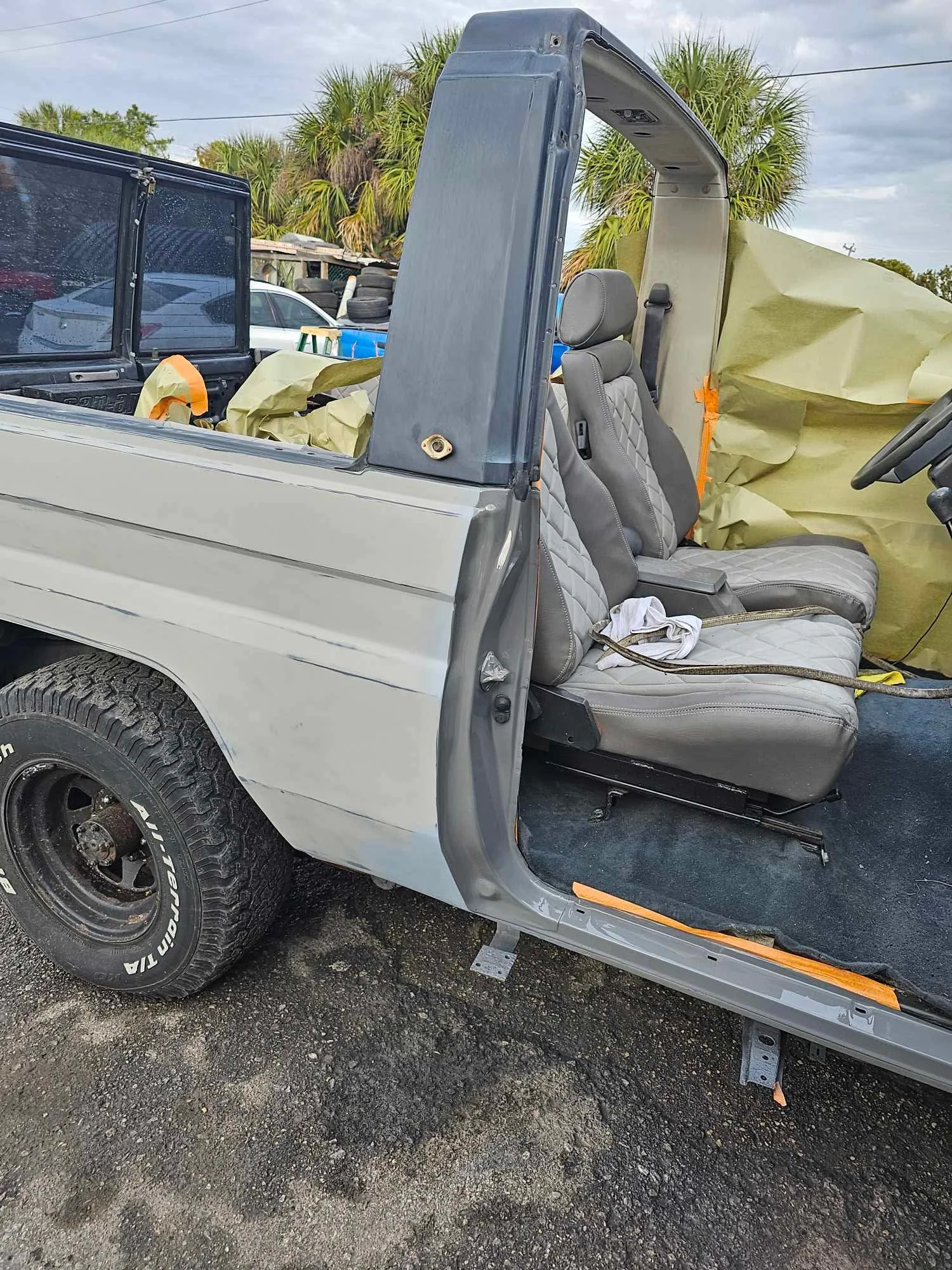

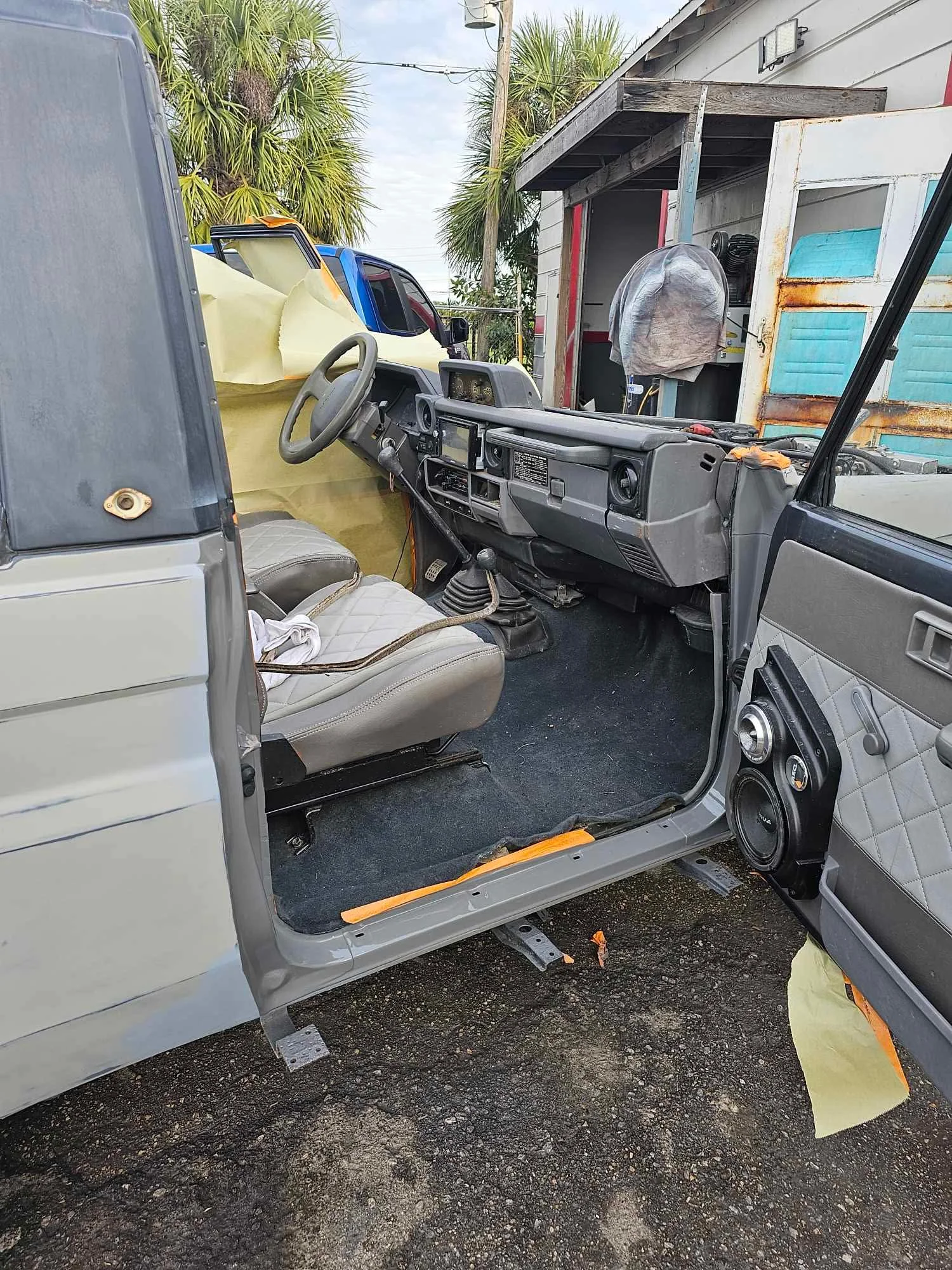

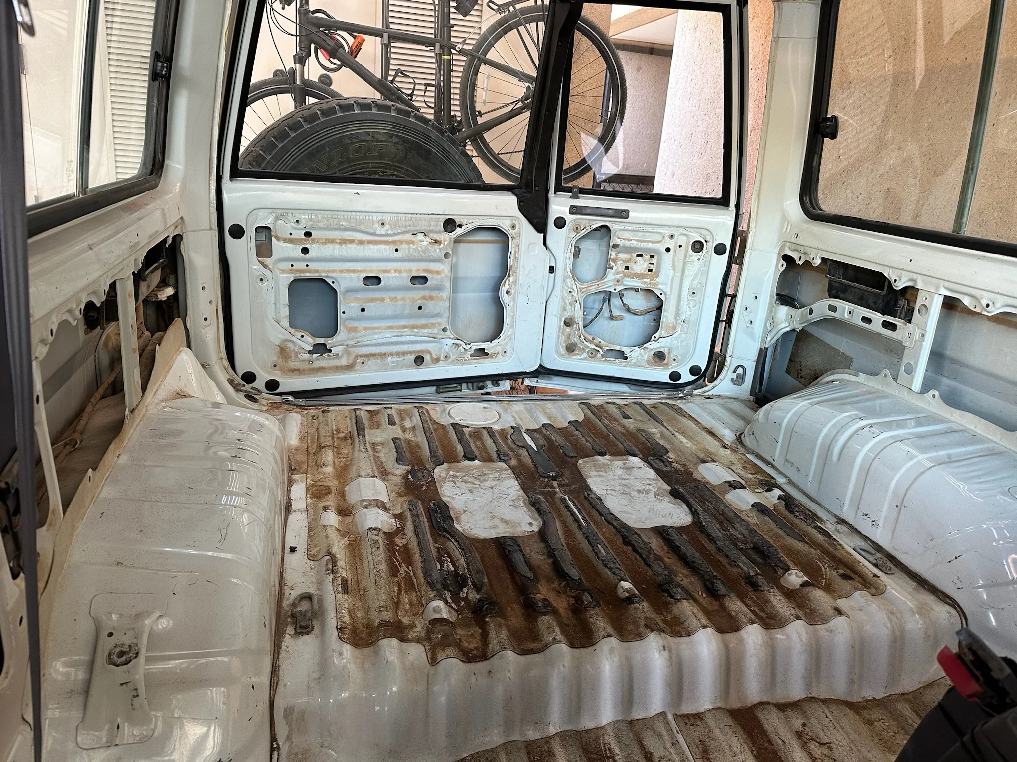

Seller says there was no rust on the body when he got it. He just wanted to change the color. And he wanted the interior modernized so he did seat covers and rear Trouppe style seats with no seatbelts. He said when I get there, there is “zero rust” under the body.
Here are the pictures he sent me of the work being done on it.

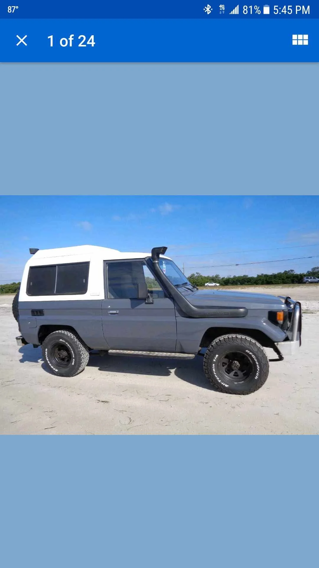

And the pictures that he sent me of when it was purchased when it was blue.
Please give me any feedback.

What is a pusher fan?
It does have aftermarket AC.

The electric fan sits in front of the radiator, behind the grill. It pushes air into the engine bay. Original would be a mechanical fan behind the grill, driven by the engine, with a visco clutch, pulling the air in.
Radiator appears to be Chinesium. Needs monitoring for overheating. The factory temp gauge isn't very accurate and may not indicate overheating quick enough. Head gasket check is advised.
Can be checked on location only, though.
Rest of it doesn't look terrible.
But 'no rust' at that age & milage is wishful thinking. Pics never tell the truth.
Pics of the undercarriage are required
Also check on how those back seats were fitted. This was a work vehicle and originally didn't have rear seats and also not the mounting points for seats.

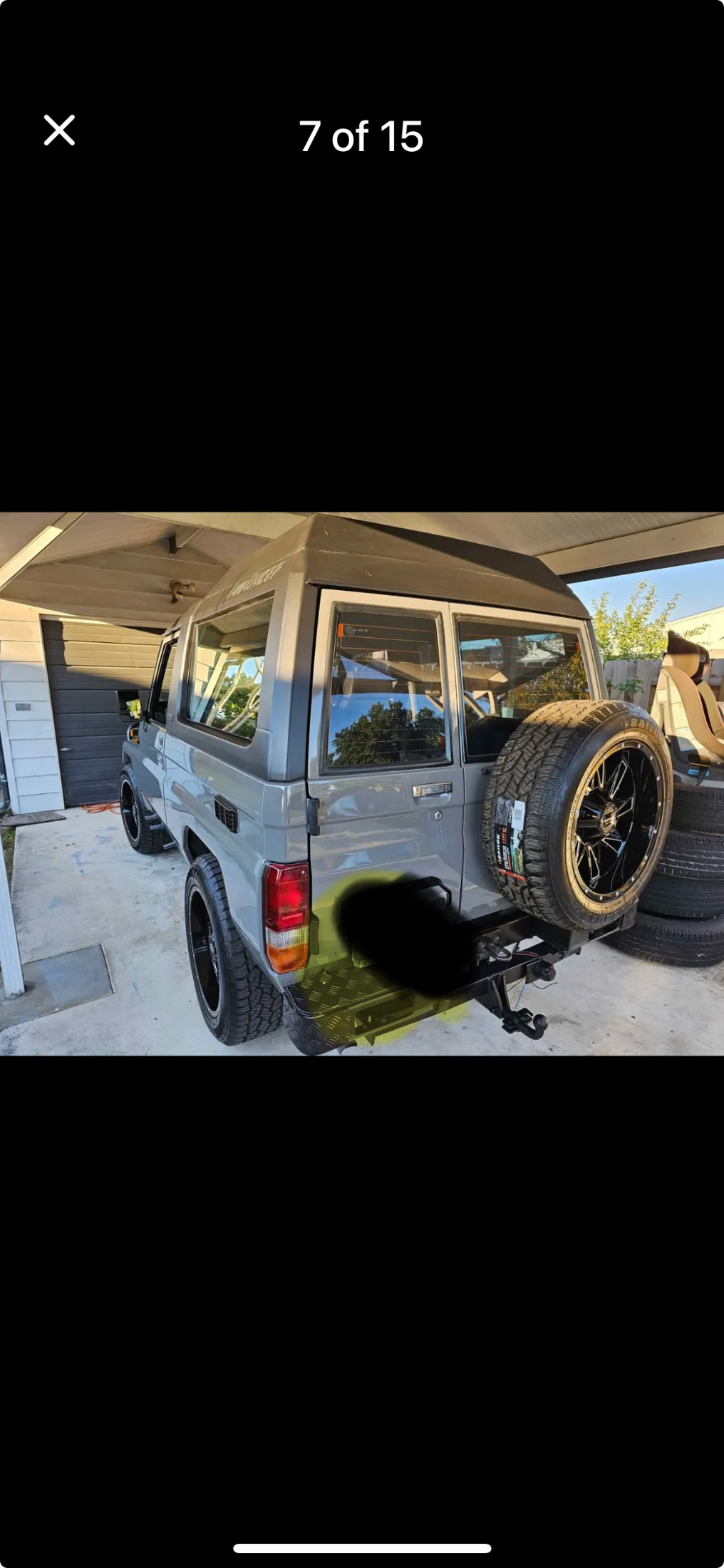

also chevk the sparewheel carrier. Those rigs might have had the spare on the indide of the door. The carrier might got fitted later, which is problematic as the rienforcement inside the door doesn't support this.
My BJ73 was similar; the seats were just bolted through the floor, and the floor was cut for the latch, anx the reinforcement for the sparewheel carrier was a lump of wood. Doo.
Not kidding. Dutch engineering.
Be prepared to invest a bit; it's part of the game. I don't see any absolute red flags, though.

That’s just the fan on the front of the radiator. So that would make sense to help cool the AC. However I can’t see if it still has the factory fan on, which is superior IMO on cooling these.
Those fans and a new radiator give me a little concern…was there an overheating incident because of a failed regulator? Is the ac causing the heat to rise a lot? It could be a nonissue.
I would say it needs a timing belt/waterpump asap, if it’s unknown. Might as well redo all the hoses/belts you can.
And if unknown, fuel filter, any cracking hoses any base lining you can do.
I also agree, the only rust free ones are full frame off restores. I see the crusty bolts and oxidized aluminum parts, I be very curious to see underneath. She looks solid, but my looks pretty sweet in pictures from 20’ as well 😂
So here are my 2 cents . The truck came from the Netherlands originally and that top part is glued on top of the oem top . I have thrown several of these on the dump already . No idea why the guy has a Belgian license plate surround on the front bumper . It looks like the quarter panels have been repaired or it might be an optical illusion with the door jambs painted . No oem interior parts not even the carpet usually means it was used hard and not maintained well . Never seen that type of ac compressor used . I think the wise decision to make is to book a ticket and go check it out in person .The oil pressure reading low is probably just a worn out sender and pretty common on these . Check for blow by to see what shape the 1HZ is in . The cruisers out of the Netherlands have usually very high mileage but some of them are extremely well maintaned mechanical and have spend most of their life at 55 mph on the highway with a trailer behind it , with this kind of use the 1hz's are a million mile engines but the output shafts on the transmissions do wear the splines out , their are solutions out there to fix this .
Agree. Hard to tell, but 'he just wanted to change the color' is a poor excuse. Pretty sure something rust repair was done somewhere.
Impossible to tell from pictures only how it was done.

That spare tire hanger makes me nervous now. Is there any way to tell if it's factory once I have the car in person?

on the non troopy 7x models all rear doors have the bracing for the spare tire carrier by default , only the troopies had the spare underneath in some cases

Seller just confirmed the normal fan is also in place in addition to the push-fans.

Re: spare tire, I’m sure you could side-by-side visually compare what is on there vs. known factory fitted spare tire. To be sure, you can carefully pop the interior door card/panel off that barn door using a plastic body trim removal tool. You might risk breaking an old (but easily replaceable) plastic clip or two, but you’ll be able to see clearly whether the interior cavity of the door has reinforcement, or not.
I don’t have an example of a door with a non-OEM tire, but I think @Felde has one with his lump of wood on his build thread. Here’s a stripped down FZJ70. I don't have a picture of with the right angle to show inside the door, but essentially that area in the middle of the barn door has reinforcing metal welded in, parts of which run on a perpendicular plane to the skin of the door, so you cannot put your arm into the door cavity through one hole and out the other. This holds the load of the tire.
Just to add my opinion. When looking at a used Cruiser I'm typically looking for originality so would probably pass this one, but if you're just after a working example and plan to modify it, then it may be a good choice, particularly if it's well priced.
Understand that the Netherlands is a small country as flat as a pancake with roads as smooth as a snooker table. There is absolutely zero potential for off-roading and a Land Cruiser seems like a very odd car to own there. But as I mentioned earlier, this will almost certainly have been registered as a commerical and as Joe said will likely have spent its life towing, probably a mini digger to work sites or a hot dog (or worse) caravan to the local town square.
While the Dutch climate is not great for cars and they do salt the roads in winter, the Netherlands has pretty high stadards for technical inspection (APK) which is done annually for a car that age. I don't think it's as strict as the German equivalent, and you can usually find a garage that will overlook certain mnor faults, but it should be technically sound. You can ask if it has a current APK. You won't be getting a Latin American Cruiser with an exhaust made of soft drink cans and a chassis held together by paint, with a tired 1HZ in what was originally a 1FZ vehicle etc etc.
Re: spare tire
One can recognize the door version for carrying the spare tire inside just by looking at it: It has two threaded holes on the inner side of the door body, between the glass and the upper edge of the door card. One or two more threads are through the door card, but might be covered up. (I'll get a pic of mine later).
