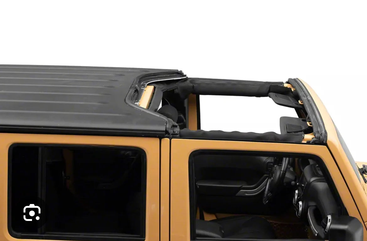

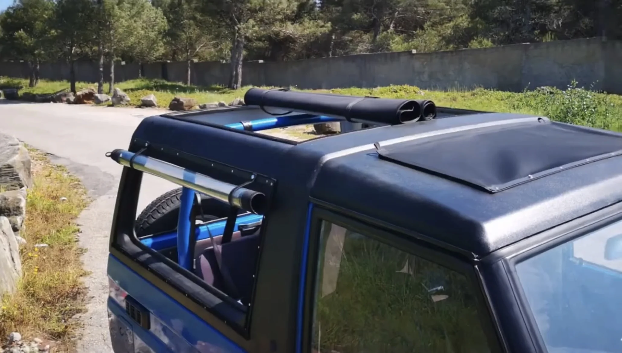

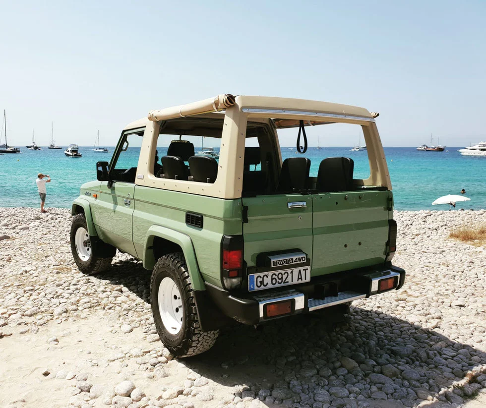

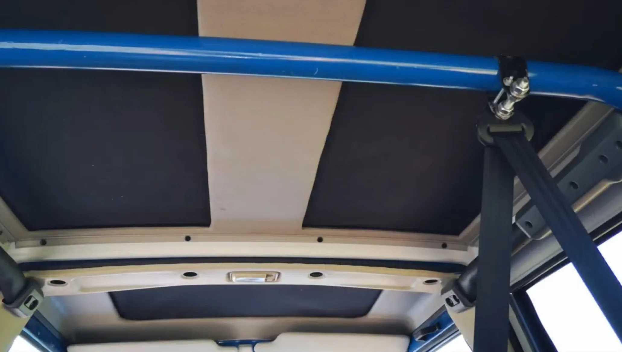

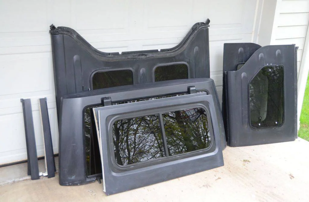

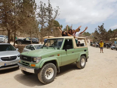

Some from the video. I know they are just soft top covering the openings, but there are ways to integrate the fiberglass top in it’s place.
That is super cool. I wonder if you could just use the cut outs for the top and then do the roll up windows on the sides. I like this better than what I was thinking. Thank you.
Absolutely. The video think works if you click watch on YouTube, shows him cutting it all out and that.

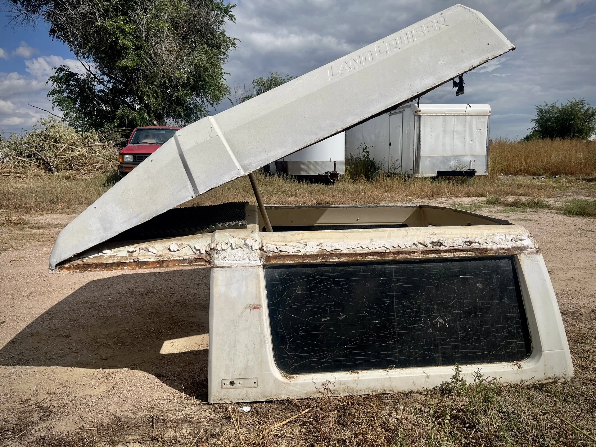

On my spare top I’m “one day” converting to a pop top, you can see how the back 1/2 is cut off fairly easily.

After seeing the ideas, I am thinking, sunroof over the driver area. Maybe resuse the sunroof cutout as the panel instead of canvas. Then the one cutout in the back (above the back seat) similar to the green truck above and use the cutout panels again, instead of canvas. I do like the side windows however I already have the slide windows which may be ok. So basically two holes, cut at an angle, so the panels reinstall easily.

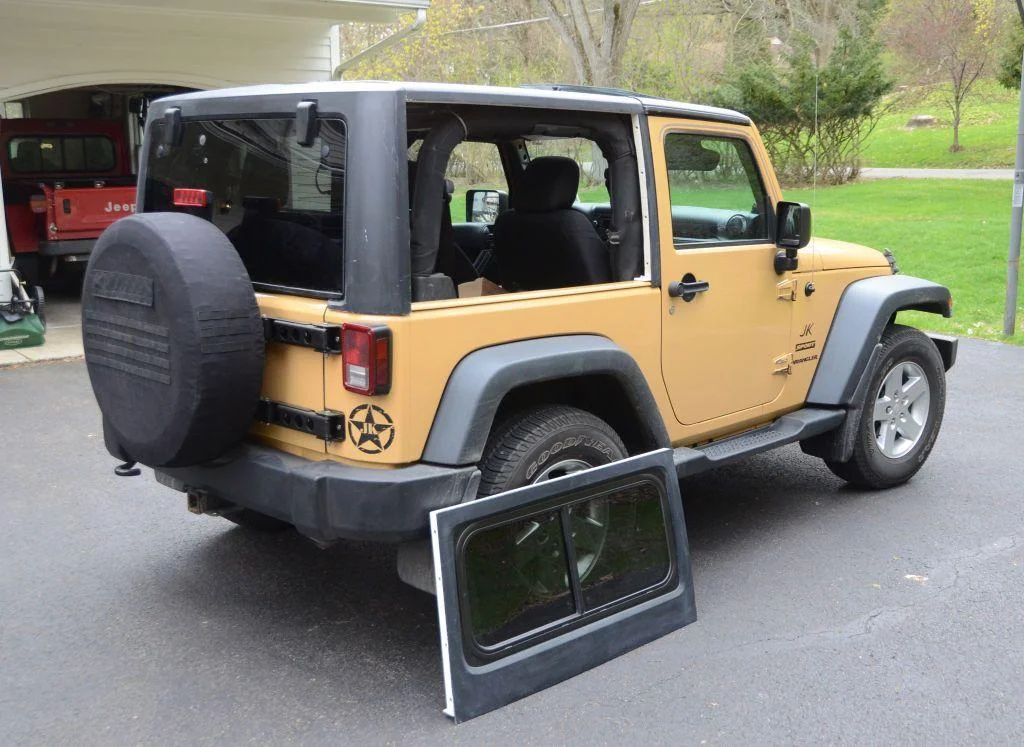

When I went down this rabbit hole I found a guy that does awesome fiberglass work on Jeeps. So you have to read a bunch of Jeep forum stuff but the guys stuff is awesome.
His designs have been licensed by other companies and Jeep I believe. Just a hobby for him.
Forum handle is jscherb google terms.
There is like a full build on this one if I remember correctly. Will have good info and how it’s designed even for just the window inserts.
