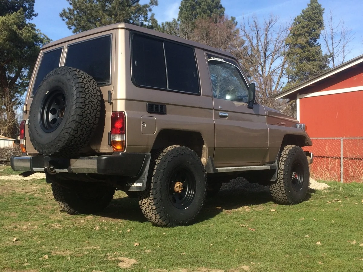

Anybody else’s frames looking rotten and rusted? Is there no solution to this? The SWB frames were discontinued and replaces with a frame that’s covered by rubber and doesn’t require butyl. I was hoping I could find a similar solution for MWB / FRP top.
This is the look I was hoping I could get.
I have a set of the rear window frames with out the glass out of a 70. Don’t think they will fit as you can see the hard top ones have a rounded corners, unless you are very good at working fiberglass and can add rounded corners to yours.
I think the only choice if you are not a superior fabrication shop is find some out of a parts truck.

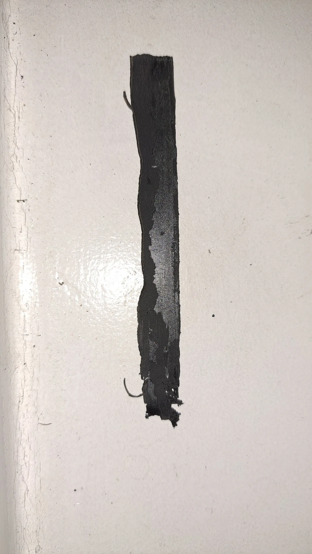

I just today had the 'pleasure' to do the rear window job again.. 🥴 Did it 3ish years ago. My left window developed a severe leak, which really sucks as the car was parked outside, because my garage is inaccessible due to construction work.
I used Sika 221i, a 1k urethane sealant (not sure it is available stateside). Worked great, unless you don't repeat my mistakes 🤣:
1. I had a little hole rusted trough the upper left corner. I had successfully treated the rust (as I saw now) by removing, rust converter and paint, but hadn't closed it, as it was actually all covered in sealant. Nevertheless I sprayed the inside of the gliding rail with FluidFilm. That was a mistake: The stuff made it trough the hole and eventually delaminated the bonding. Took 3 years, but eventually...
2. I had painted the frame with Brantho (similar to POR15). The stuff is 'dry' after a few days, but actually takes weeks to month to fully cure.
I now saw the paint had formed some 'orange skin' under the sealant, which was not bonding very well any more. I believe that formed due to solvents still evaporating from the paint into the bonding.
3. I found the FRP to be very smooth and the sealant not sticking to it very well. I guess, I should have roughen the surface.
All in all: Pedantic preparation of the surfaces are key. No fatty stuff and no solvents to be any near. ! Take your time!
Cheers Ralf
Pic's of the delamination and a piece of the old sealant where paint can be seen that came off the frame with it.
