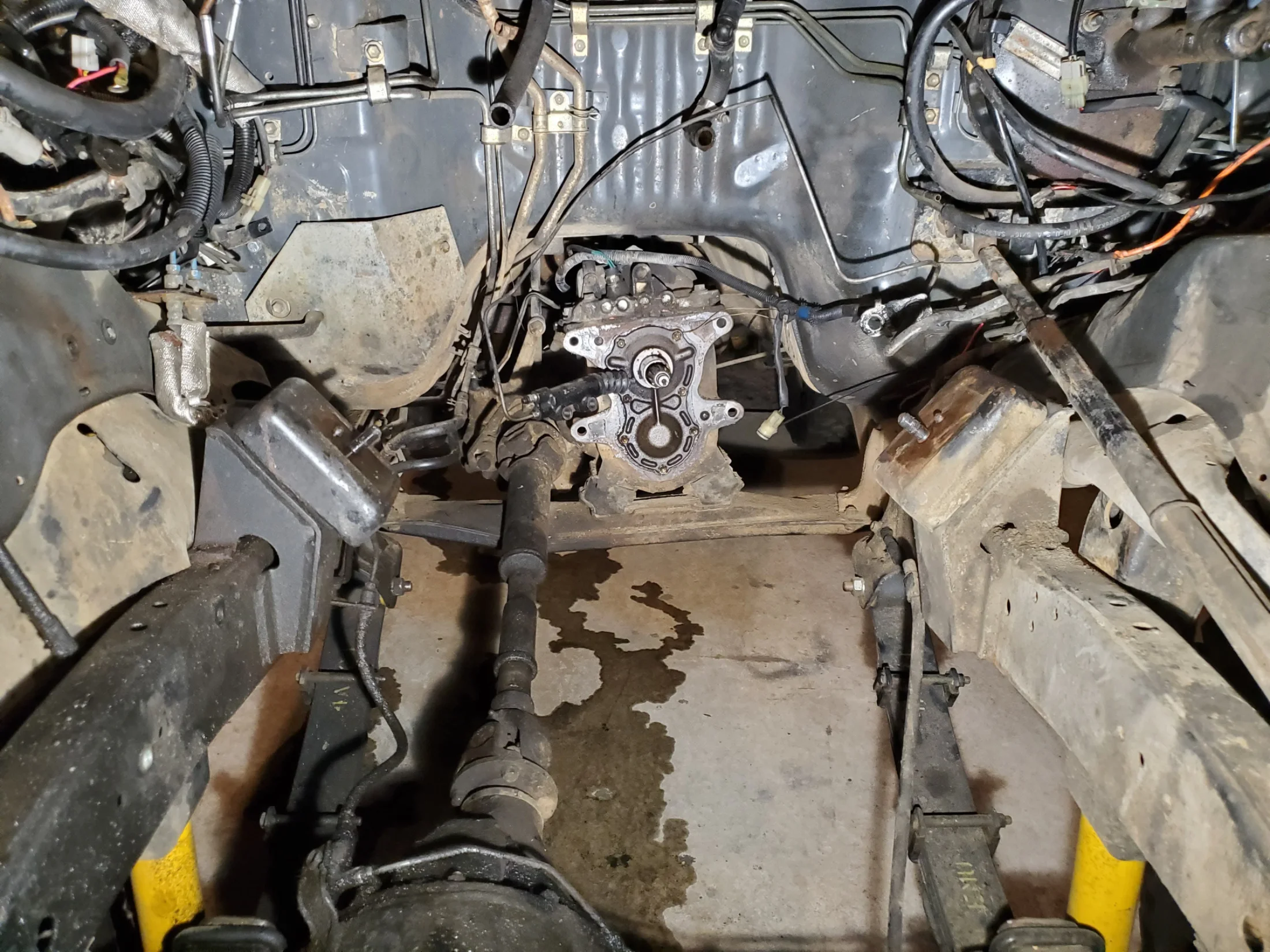

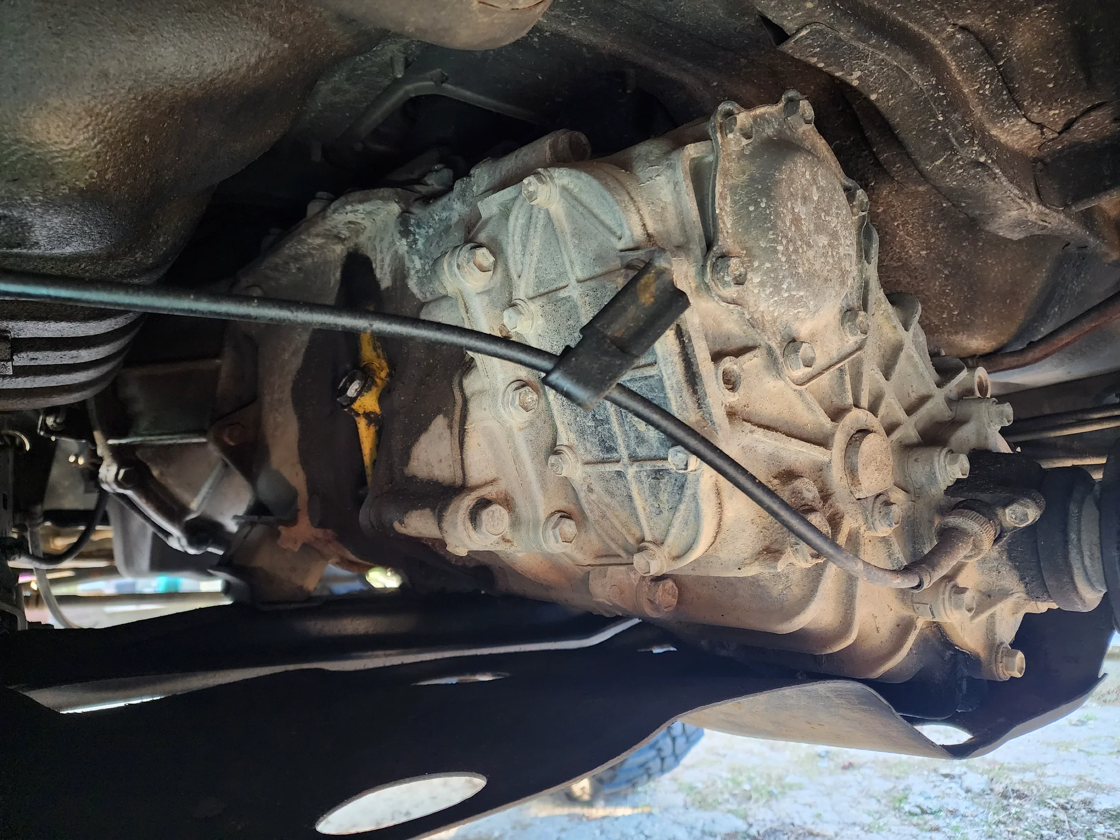

Hi,
1992 BJ73 VM 2.5TD - I believe the synchros are going in my gearbox..
Figuring out the best move forward, rebuilding or sourcing another box (which might be in the same position later..)
I am trying to find what gearbox ID I have and if I can source one from another Toyota. Struggling to find any part numbers on it!
Cheers
Looks like an H55f, but check the data tag on your firewall to confirm.
^^This, looks like an H55f. New H55f's are available still from Toyota.
Cheers, James
Yes, VM use the F/H input confirmed. I helped with installing a 2F into a VM-equipped BJ73
33030-60450 will be a direct replacement.

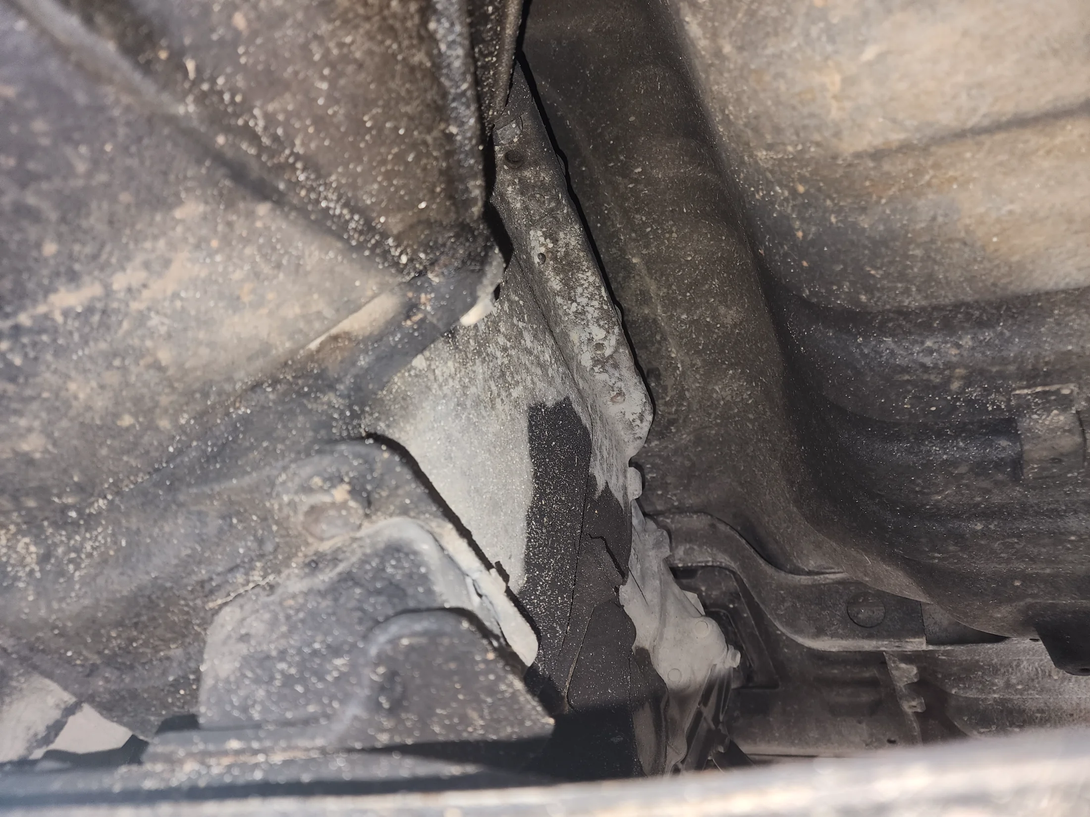

Not a great pic but you can kind of see the 10-spline
I can confirm that it is a 10-spline H55F. The bell housing is also marked "HJ."
