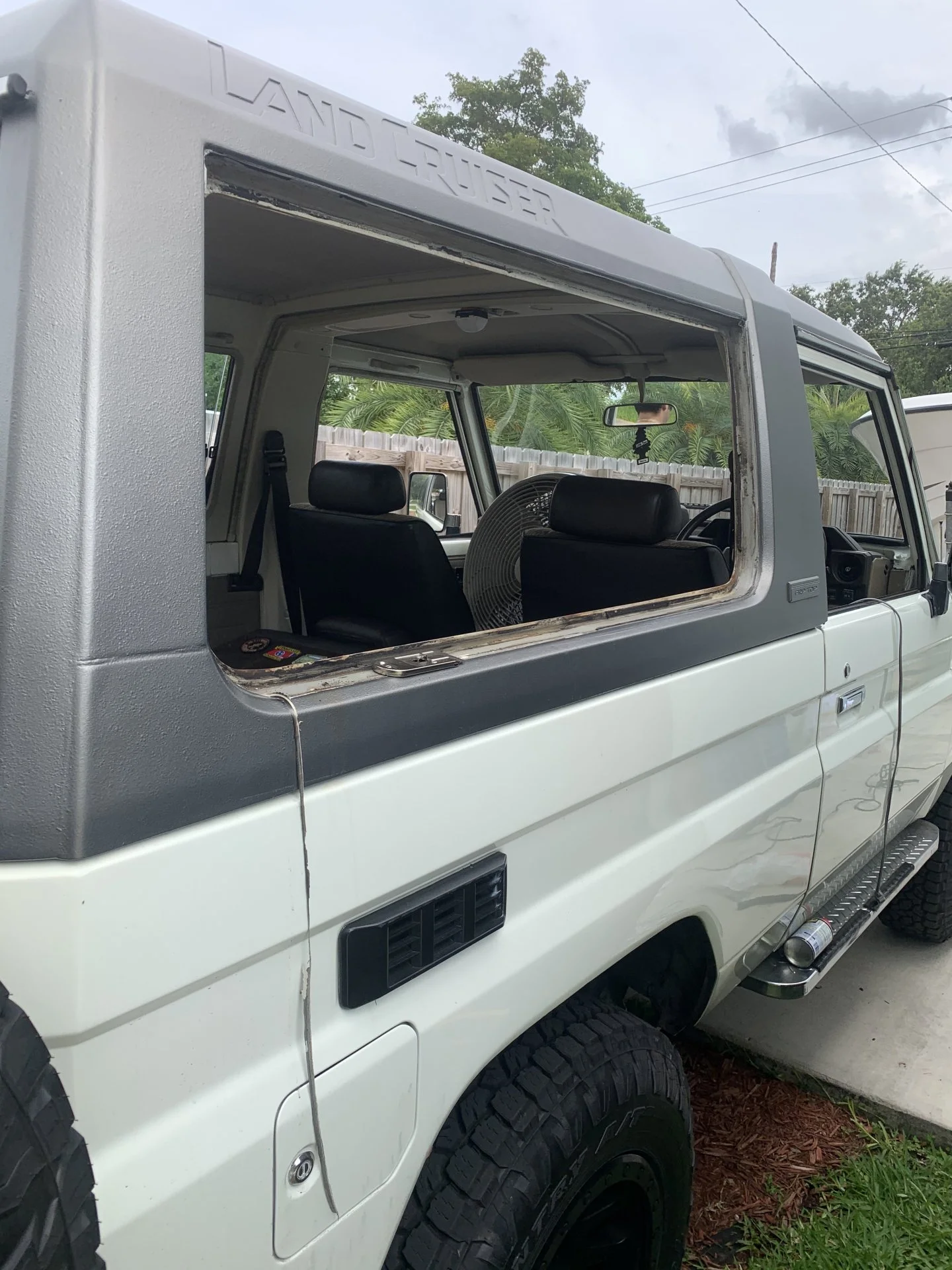

Here’s how it looks with the frame off, the previous owner had it caulked on very poorly so was able to cut around the frame and pry it out with a flat head screwdriver and some elbow grease. Taking the frame out is the only way to get the windows off to replace the weather stripping between the frame and windows. Finally no more leaking

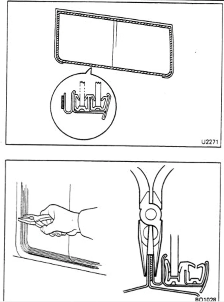

I still don't understand where this NLA 6279390K00 weatherstripping is supposed to go. The manual has these detail pictures (page BO-65) , where there is the runner visible, as well as the butyl to glue the frame to the FRP top, but no further weatherstripping.
On top of the page a whole assembly kit for the butyl is mentioned (08850-00065), which, on the other hand, I nowhere ever found in any of the usual parts catalogs.
** Maybe this 6279390K00 has been SUPERSEDED by this butyl ???

What FSM is this in? Mine does not depict this.
As I understand it, the NLA weatherstrip is squeezed between the truck roof and the window frame as depicted by the shaded area being squeezed by the pliers and is a butyl strip.
The pic I posted is part of page BO-65 of
"Land Cruiser Heavy Duty Repair Manual -Chassis -Body Production Dates 10/84 thru 1/90 USA & Canada Pub.No 36262E"
That's what I was suspecting... Butyl strip is easy to get. Wouldn't be any worries.
to replace it you will need to take the frame off the FRP top that’s the only way to change the weatherstripping because once the frame is off you can take windows off, replace the weather stripping then put windows beck on.
However, SeanBJ74 's comment says you need to take the glass (windows) out of the frame in order to change what he calls weatherstripping.
That would mean the weatherstripping is somewhere within the frame / around the glass. Which my manuals pics don't show or mention.
@SeanBJ74 : Are we both talking the same thing? Or are you rather referring to the runners where the glass slides in? That rubber piece is also depicted in my manuals pic.
(Original part no of the runners e.g. for RH 6275590K01, now superseded by 6275560040 and readily available)
Sorry for asking again, but taking it apart without a real understanding how to get it together again would be really PITA.

Correct. There is a butyl strip between the frame and the top and then there is the rubber on the inside that the windows run on.
The weather strip (channel) is available and left and right. The strip that was used to go between the top and frame is not available and was a soft rubber gasket with "stickum" on it I think. Someone early on in this thread scored one from Cruiserparts. I tried to get one too to see what it looked like and they sent me a completely wrong part with the Toyota part sticker mostly ripped off and then almost refused to take it back.
I have the window channel at the house and can check the numbers but I thought they were posted in the thread.
Thank You guys.
To me it's clear now.
Replacement parts needed are the runners / slide channel (RH 62755-90K01 now 62755-60040, LH 62756-90K01 now 62756-60040) and 2x Butyl sticky tape 9mm dia. x 2500mm to glue the frame back to the FRP hardtop.
Some sealant may also help.
I'll get the parts and then need to find some time to do it.
Thanks again.
