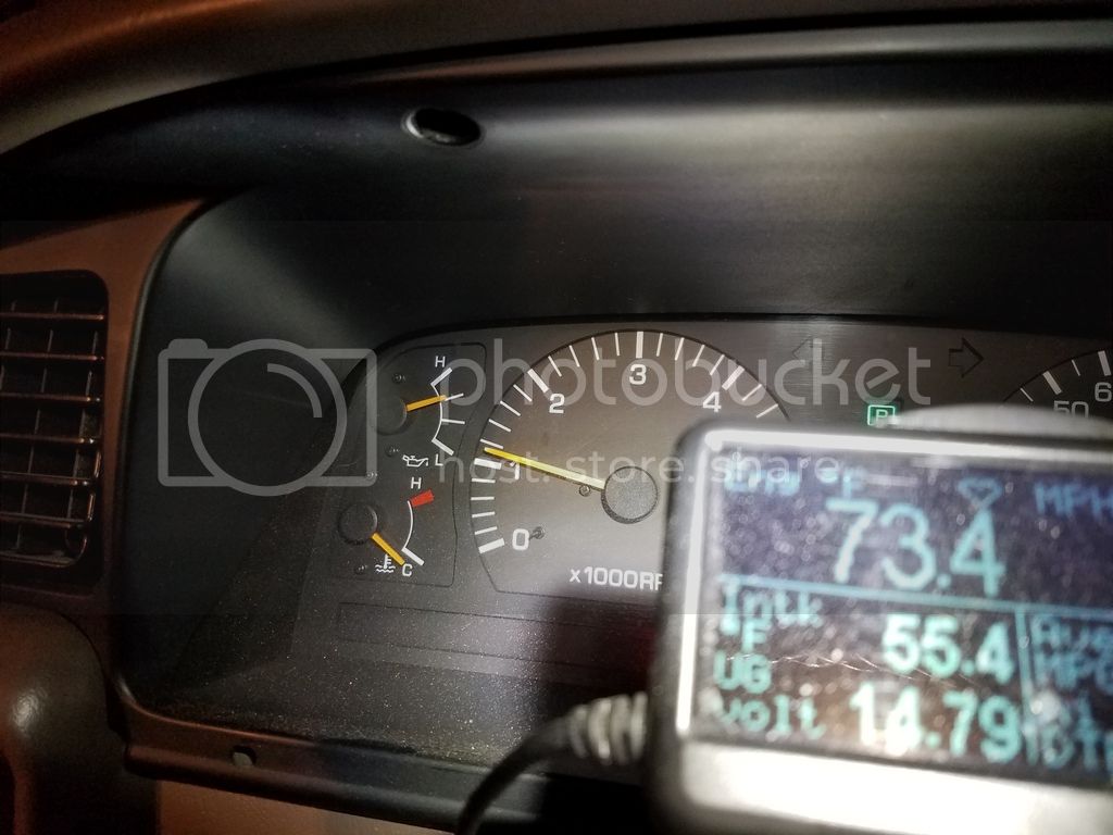

On cold start (temps around 40F) I'm registering nearly zero movement on the oil pressure gauge.
After warmup (coolant at full operating temp) oil pressure registers just below the first mark. Goes up and down with revs, but not above first mark, and not as much as was normal in the past.
In summary: Gauge shows no pressure on cold start, but shows some (low) pressure after warmup. Basically backwards from what is normal, and lower than normal.

The oil pressure gauge is VERY sensitive to battery voltage, when calibrating the sender the battery has to be hooked up to a charger. When first starting the engine the battery voltage will be lower than when the engine had been running for awhile. Such low overall readings indicate a problem with sender unit or hopefully not the engine anyways. A new sender should sort things out or pull and recalibrate your existing unit. Check the actual pressure with a master gauge for peace of mind before you do anything.

Found the sender ground lead (slide connector) seemed to be seated poorly. Cleaned up both terminals.
Dash gauge is reading steady on the first line now with little movement as revs change. Not sure if this is an improvement or just because the engine is still hot. Will check again in several hours when I can do a cold start.
Nobody local (I mean nobody) has a pressure test gauge in stock. Have to wait until tomorrow. Tomorrow will check with test gauge and change filter. And report back.
You probably just fixed it. I would squeeze the slider contact with pliers to make a tighter fit, and spray all contacts with DeOxit.
