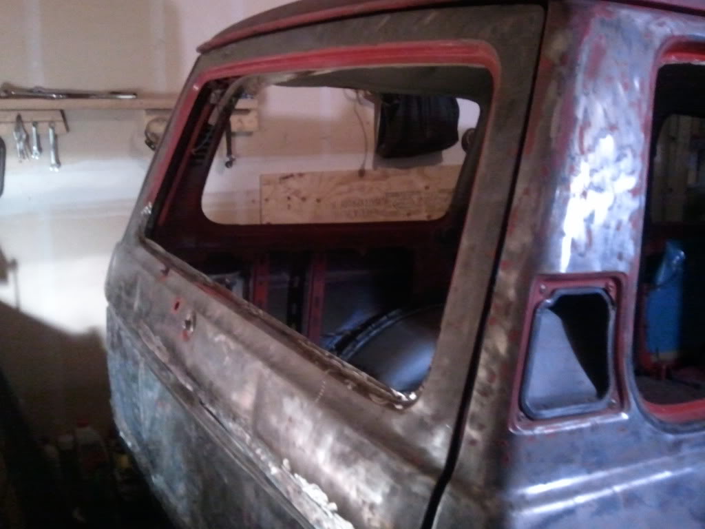

Worked more on the hatch today, what a PITA.
I've spend more time actually figuring out how I am going to fix it then actually doing it. Actually no, prep work takes for ever but then welding is easy.

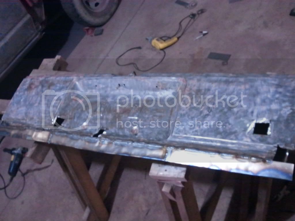

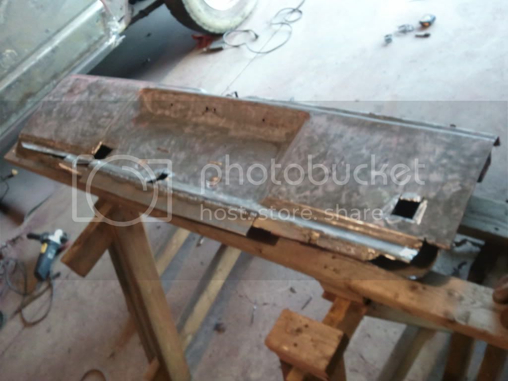

Start off by cutting bunch of stuff out:

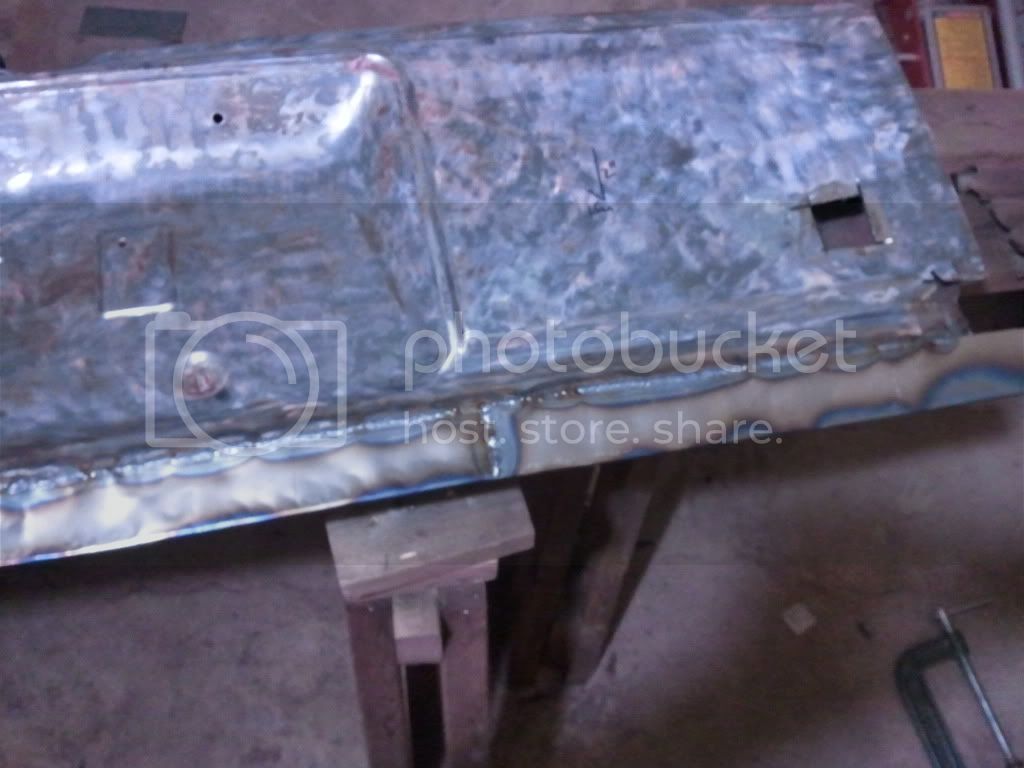

Here, I've redone the middle porting of it already
Unfortunately I couldn't get everything done but the bottom lip is done and dealt with:)

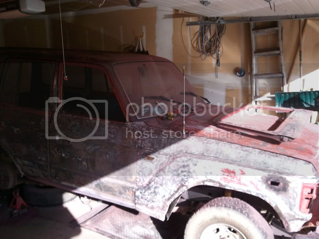

Finished the bottom hatch panel over the weekend. And started to strip down the top hatch, removed the glass out of it.
also mounted the front clip back on to the car, removed roof rack and clean everything up. Put the left doors on.
Need to strip down the roof, finish off the hood and it is ready for bondo:)
It starting to look like a car now:cheers:

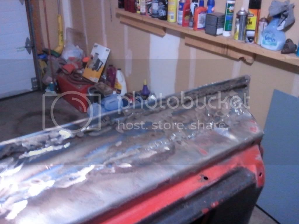

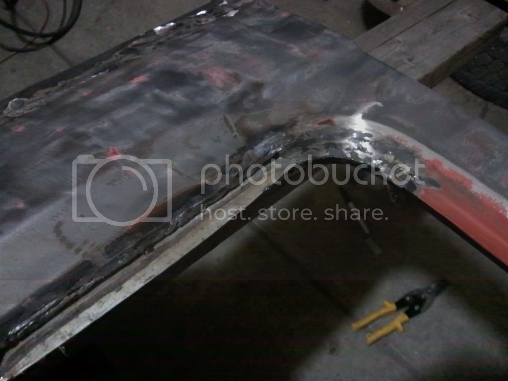

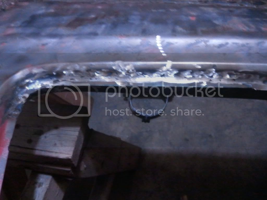

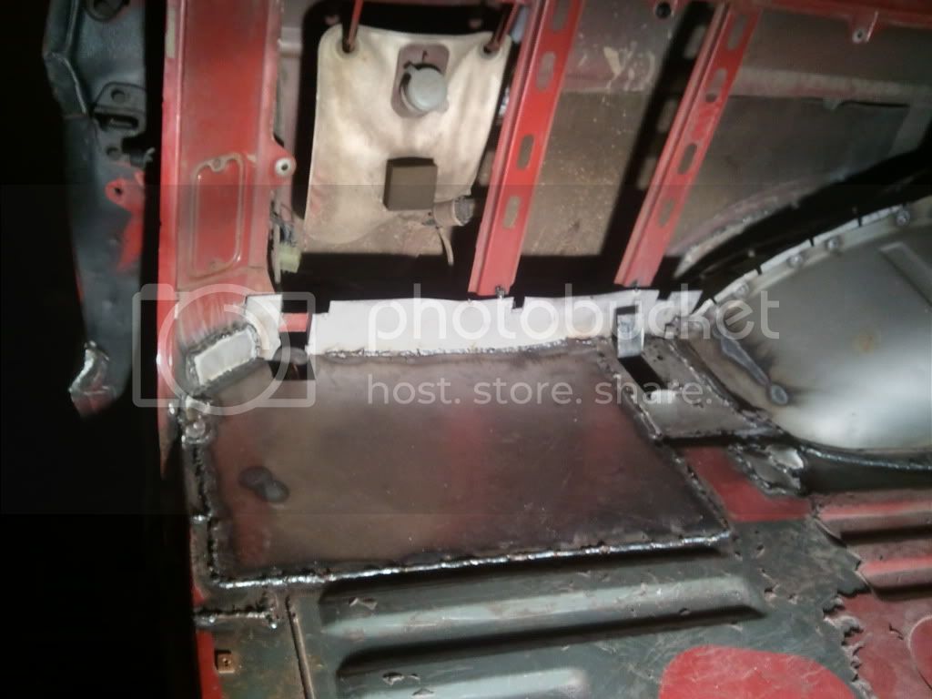

Closed off left rear conner today:

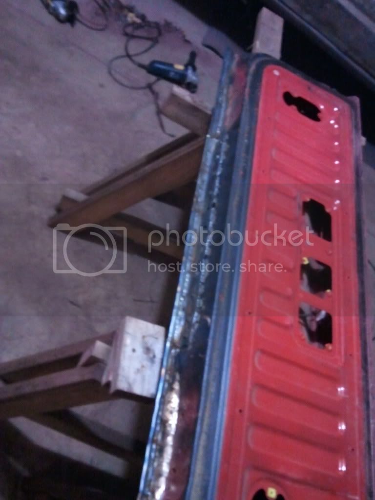

I love it when it comes together:) Finally finished off the rear top hatch. I think it took about 40 hours of work with half of it going into the lip that holds the glass:(

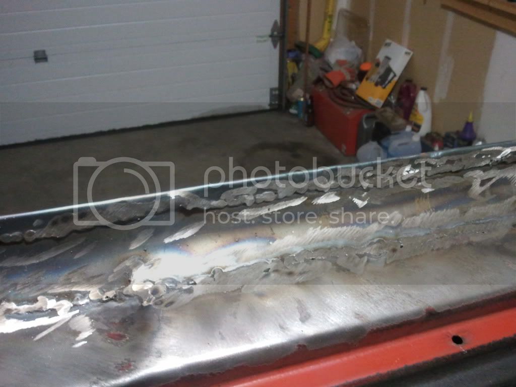

Here it is:
the other side:
Make sure you have heat high, you welds don't look like they are penetrating on the frame.
Grind a section to see if you have penetration.

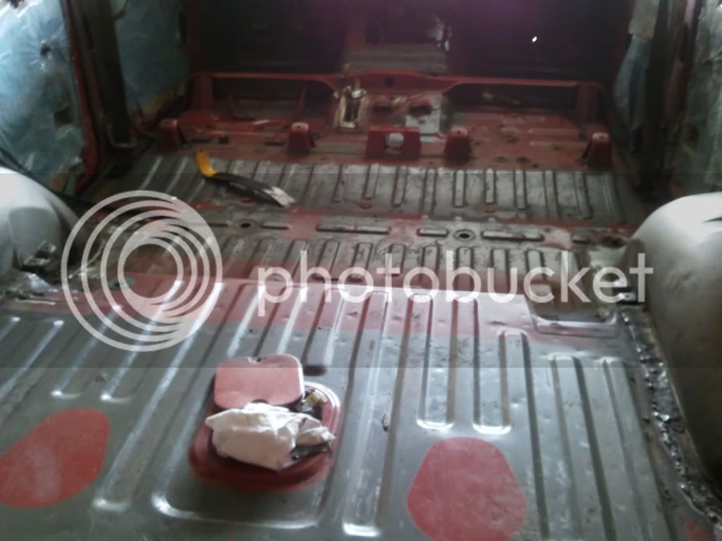

Cleaned up floor. Removed old floor rubber stuff (will replace it with fat mat probably later). Also managed to remove sending unit from the gas tank (all bolt were stripped)

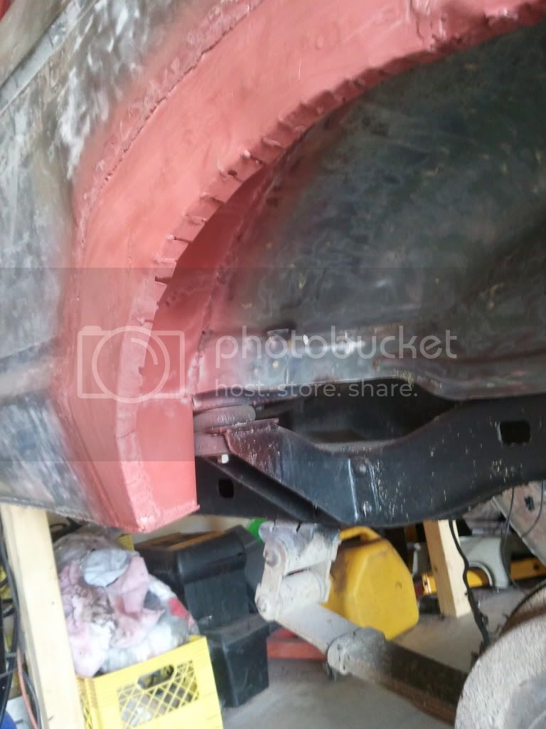

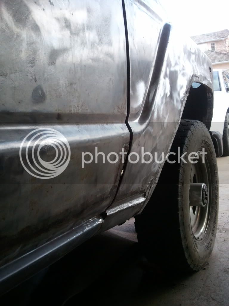

Fitted right front fender (had to redo the rocker panel at the front:( )
Finished of the rear fenders and prime those suckers.
Not sure if you can see it but rear quarter panel (behind the rear tire) is about 3" shorter then stock (it was easier to fix it this way) and it looks all right
