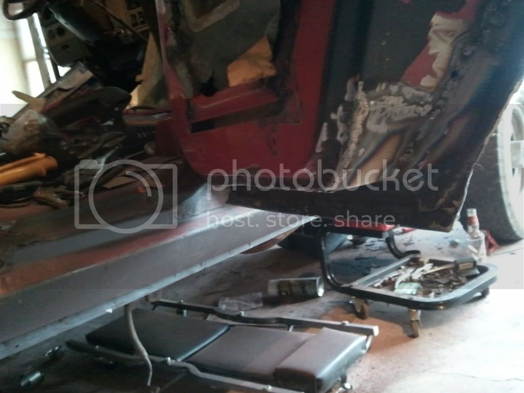

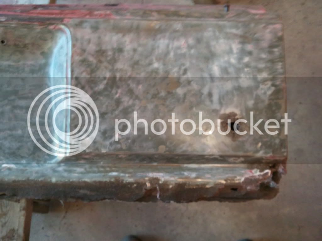

This spot was rusted through two layers (ourside and structural inside). Even though you don't see it but both are cut out and replaced in layers.

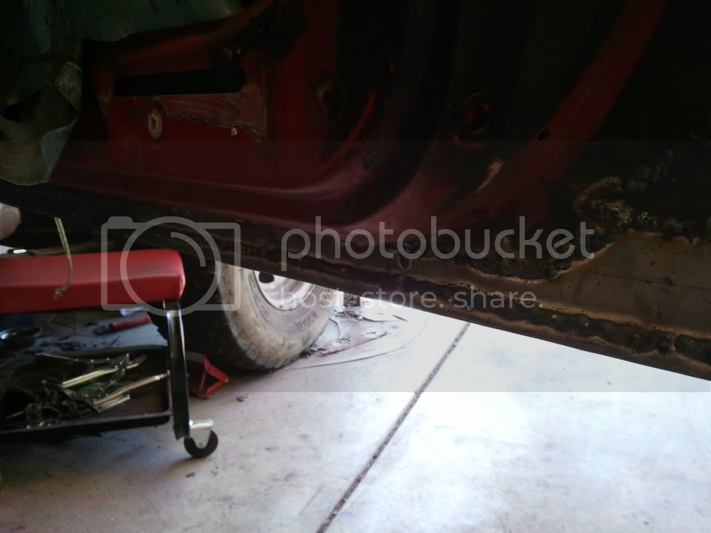

Next shot is an example of some metal work under the door. Trying to align everything is just PITA. But I am sure I can do better on the next door
And this is how it looks on the outside - you can compare it to the rear door that is not done yet
