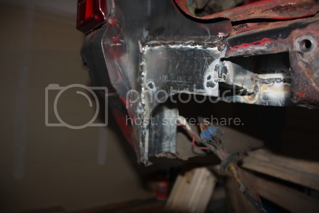

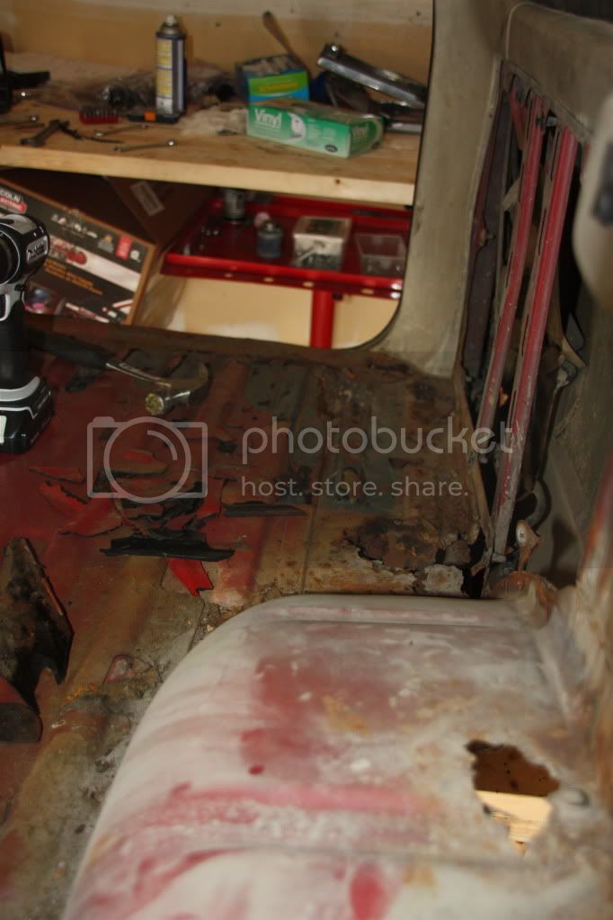

After that we started to work on what seemed to be like a simple floor pan repair in the left rear corner.... until we cut it open:( My dad has some mad sheet metal skills, most of the stuff in the corner he band out
The metal you are welding in, is it galvanized? If so I hope you are holding your breath while welding.
That stuff is terrible for you and it can really mess up your lungs if you breathe it in.
Good progress so far though.

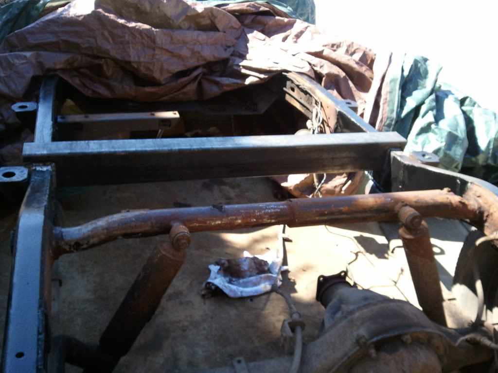

I have inspected the frame and figured that all 3 rear cross members need to be replaced. Decided to concentrate on the rear part of the frame for now as I don't want to remove the engine at this time (later when I need to rebuild it).
First I've cut out the cross member (one directly behind transmission) and portion of the inside. I had to go cut as much as a foot on each side of the cross member.
Sorry no progress picture - this the frame closed off and painted - new cross member will go on top
Other side
and the whole thing at this time
Also the whole thing was sanded before paint - what a pita

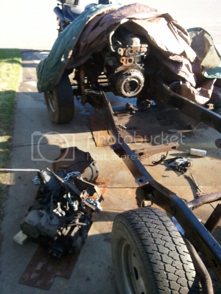

Removed transmission to replace main seal and clutch.... Man the clutch is brand spanking new - not sure where the oil is coming from. I am going to pull out the clutch to make sure it is not a main seal but I really dont thing it is leaking.
So I am puzzled what it is. Any ideas? My best guess is the engine gasket on the passenger side right bellow the manifold (big rectangular one).
Clutch itself is dry:crybaby:
You can see in a picture above that someone repaired shock mount tube in the past already but now it is totally dead.

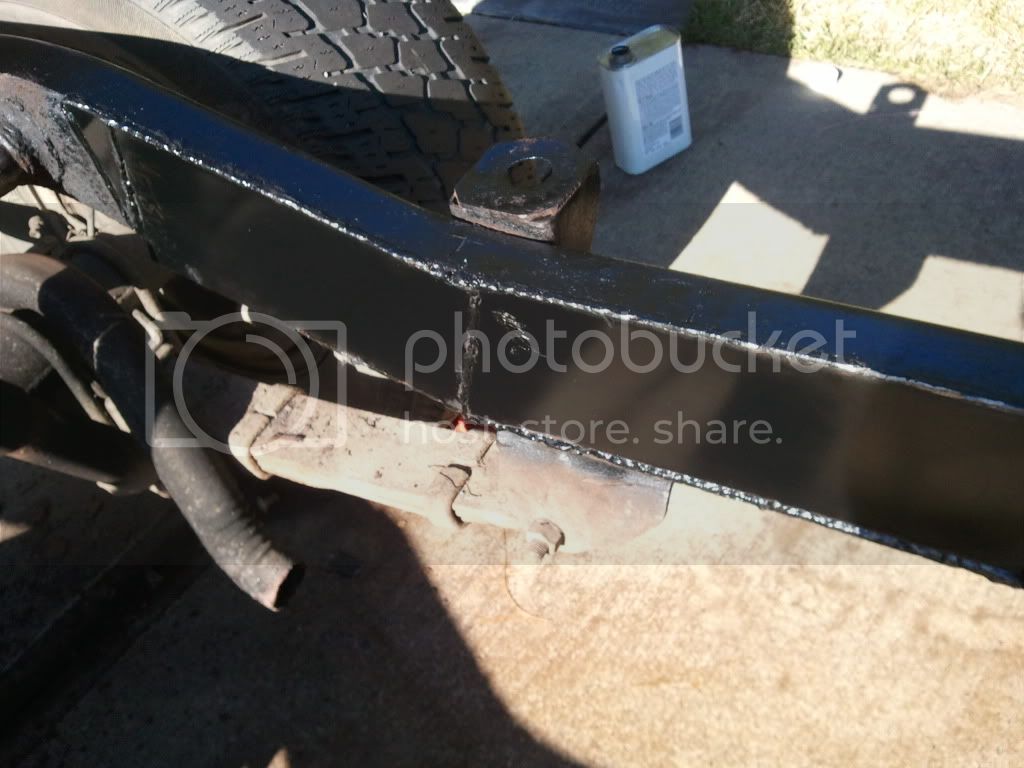

Fabricated new cross member... not much to it, but I am getting better at welding:cheers:
After that I've cut out shock mounts bought new 1 1/4 pipe at hammered it in. Man I though I would have to cut it out as it got stuck half way through
but eventually
I've decided to close off the rear section - sorry no pictures.
Now re sanded the whole thing and painted
but I've run out of paint:(
This is how it sits right now
