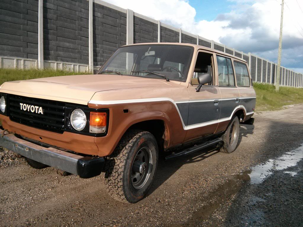

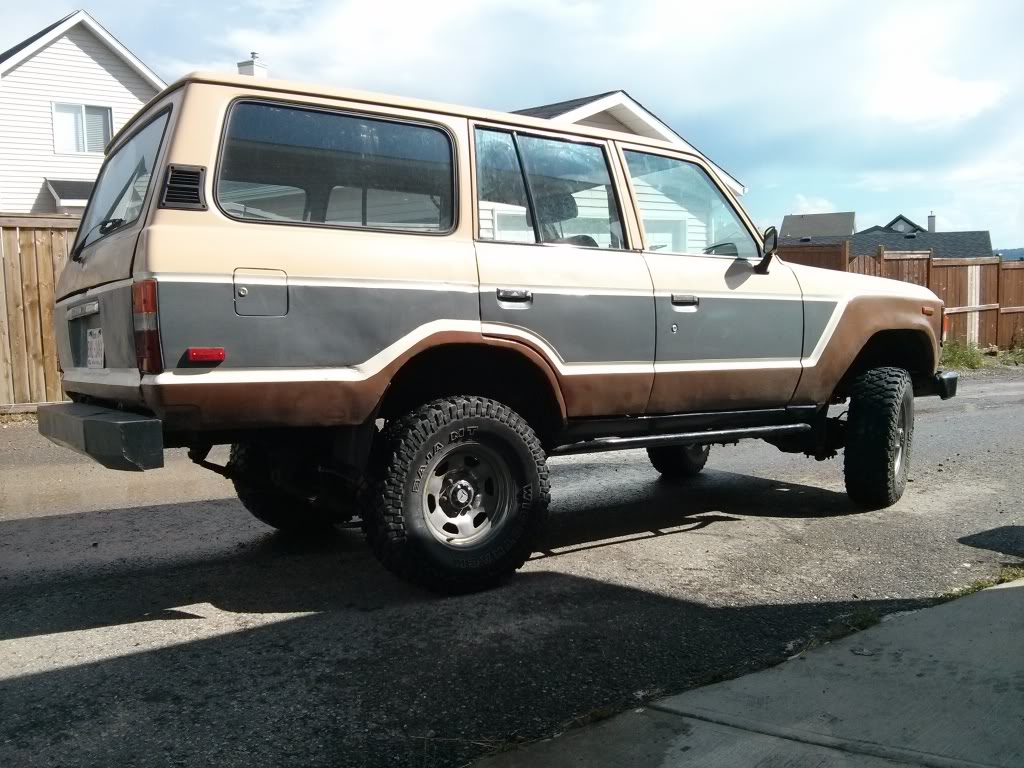

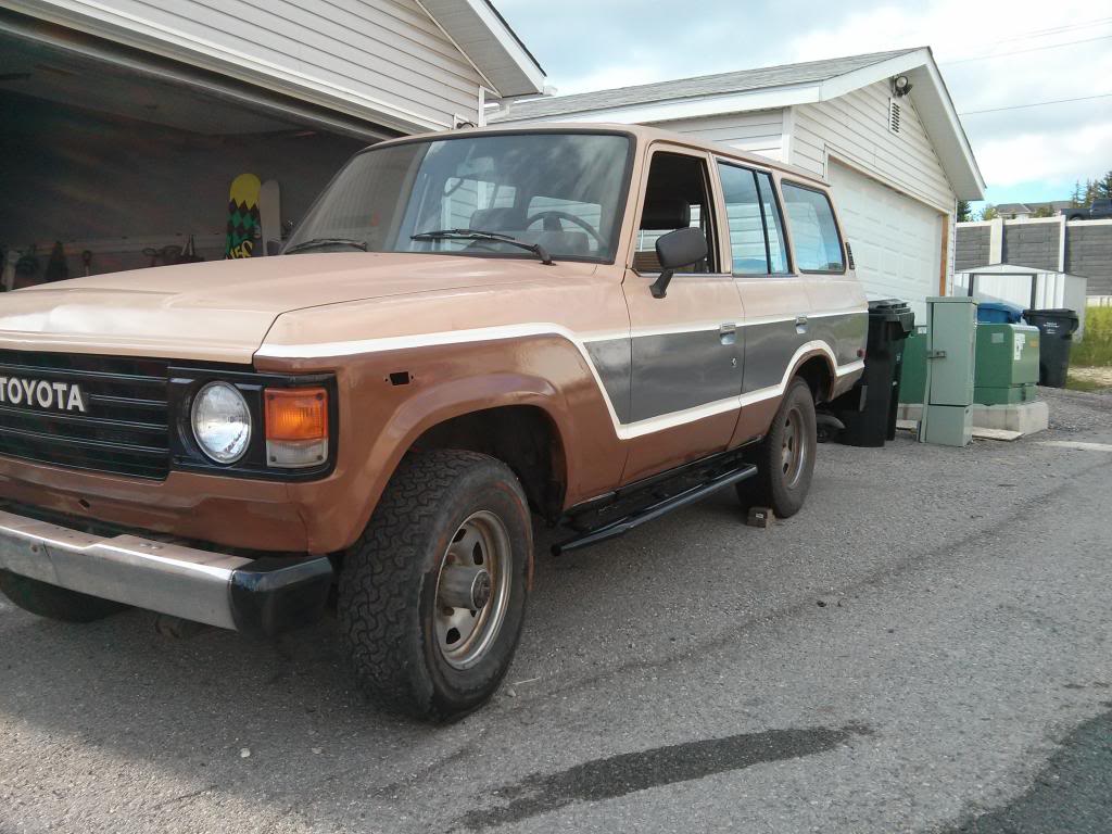

Rushing never helps I guess. I've painted the sliders last year when it was closer to zero degrees so paint didn't stick:(

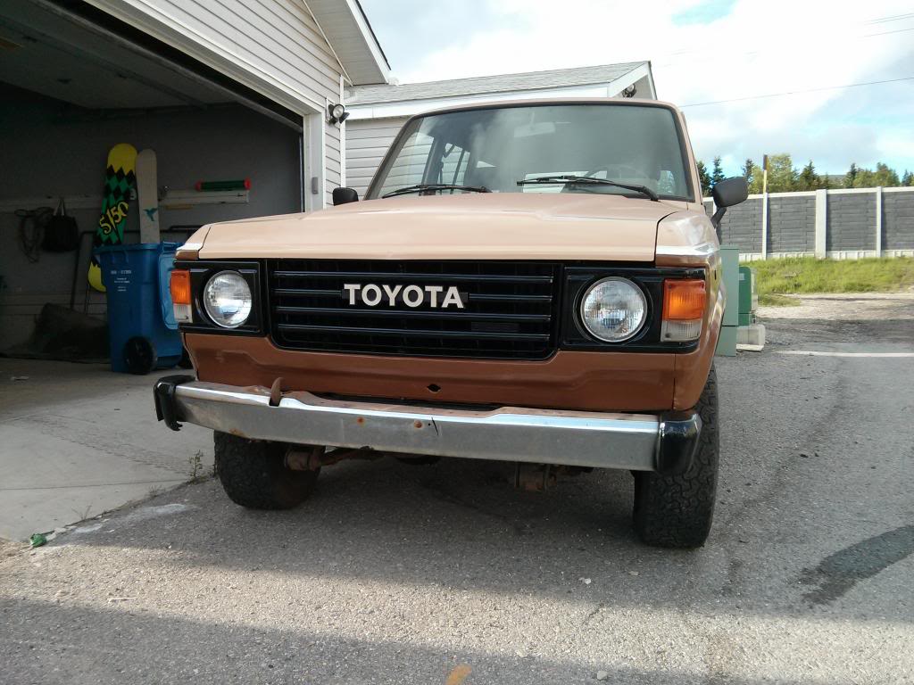

I little face lift is in order. I really like the black out grill and color schema but I do realize it is not for everyone:)
Let me know what you think

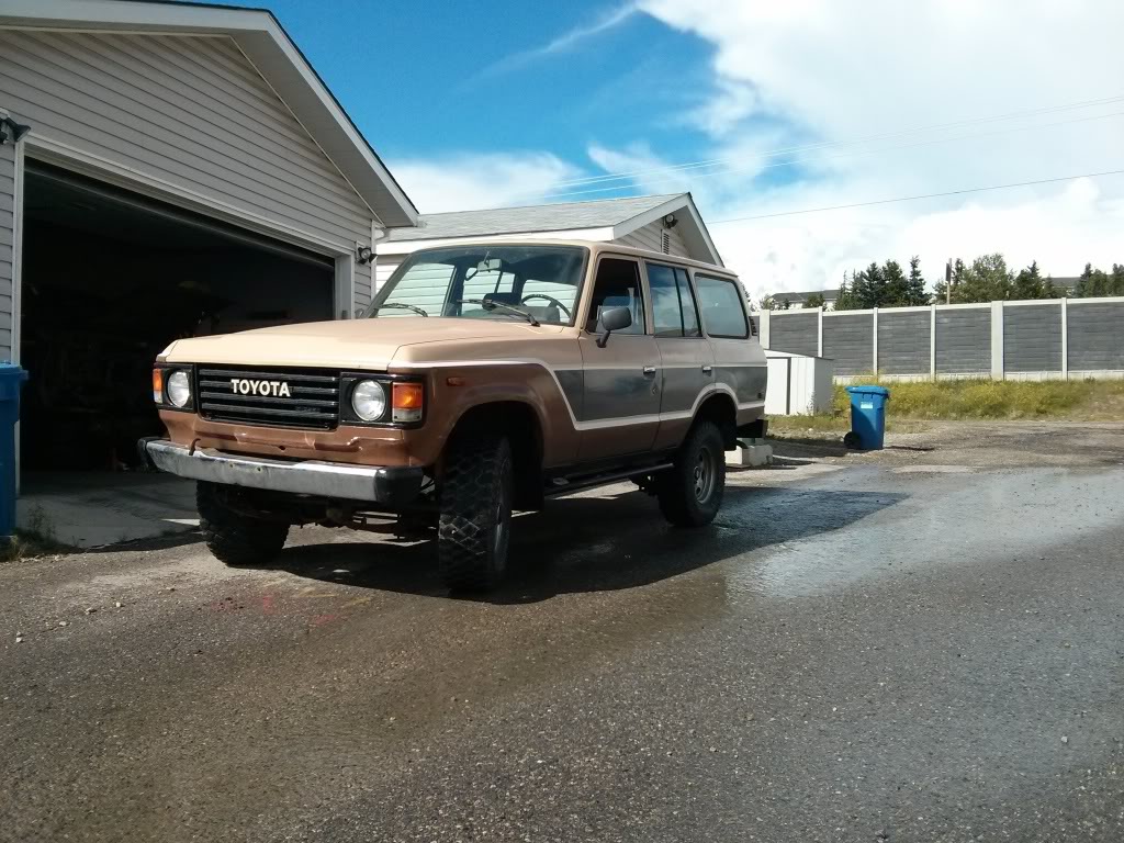

Is that a shackle reversal? What size tires?
Tires are 31 inch used so probably a bit less then that. As for shackles I am not sure if it is a reversal ones:( it is whatever came in a package
OK, no shackle reversal then. :cheers:

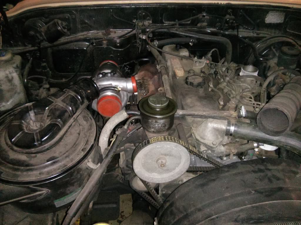

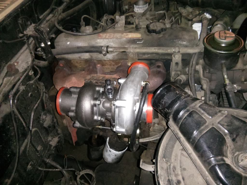

Wow that engine just spun me right out. No wonder you want to go turbo it's a bloody 3B!
Can't say I've ever seen a 60 with a 3B in it before. Then again I'm not in the states
Sweet! Cant say that exhaust flange looks like a turbo lebaron setup. Dodge did a bigger garret unit pre 89 then in 89 and up they had a smaller quicker spooling mitsubishi unit. Regardless turbo will be alot nicer to drive.

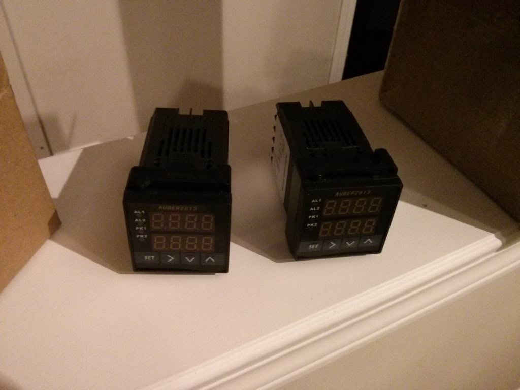

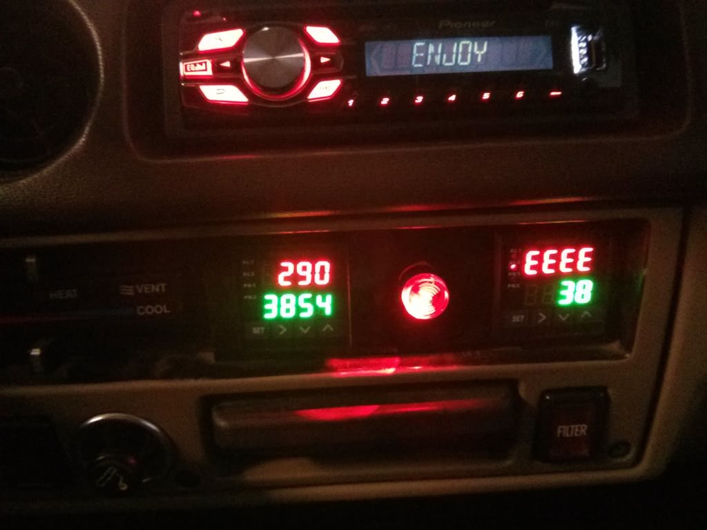

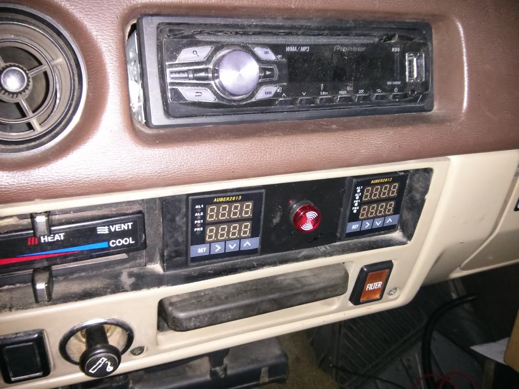

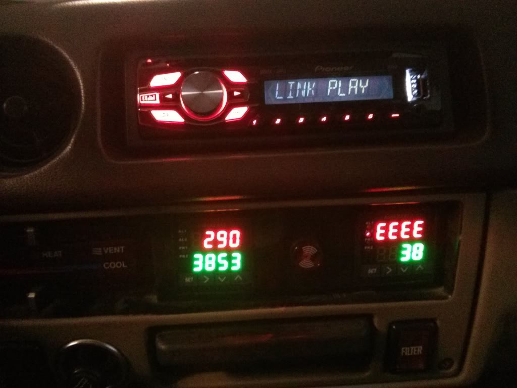

Got a chance to set up the gauges in this crappy cold weather. The fit nicely under the ashtray:
Got EGR, Boost, Oil pressure and coolant temperature going. Gauges still need to be set up (MIN/MAX) but otherwise good to go.
Also the alarm in the middle is definitely on the loud side, not sure if boss will approve it screaming when the engine is starting (oil pressure low alarm when ignition is on). Is it possible to set up a delay on this?
