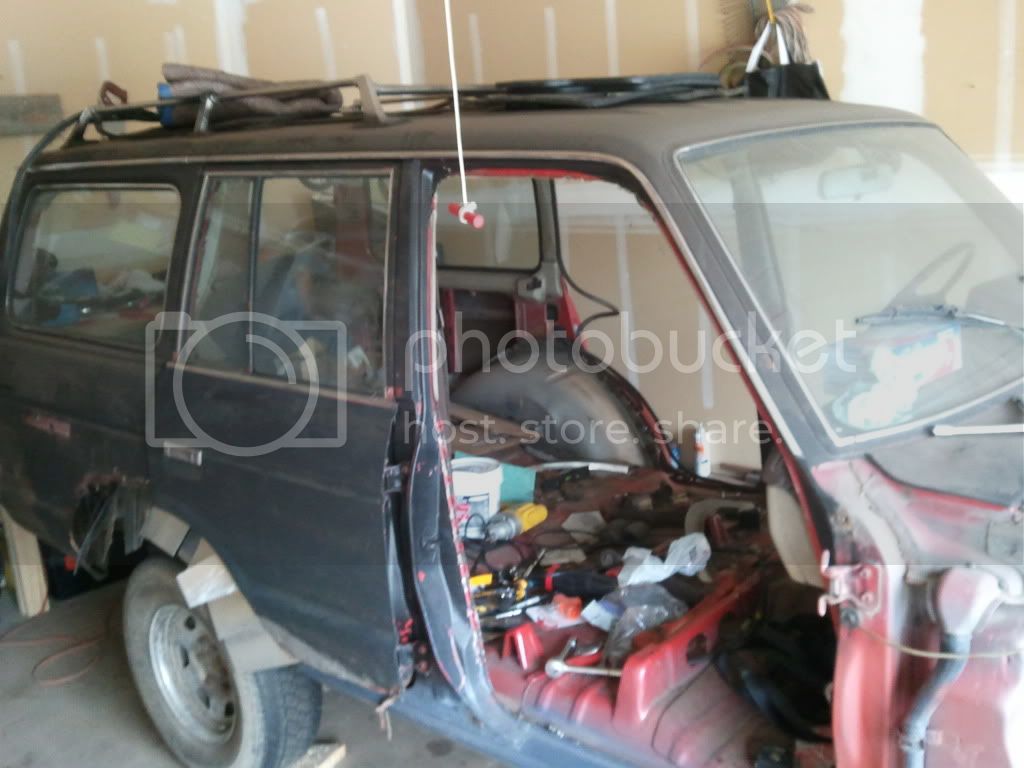

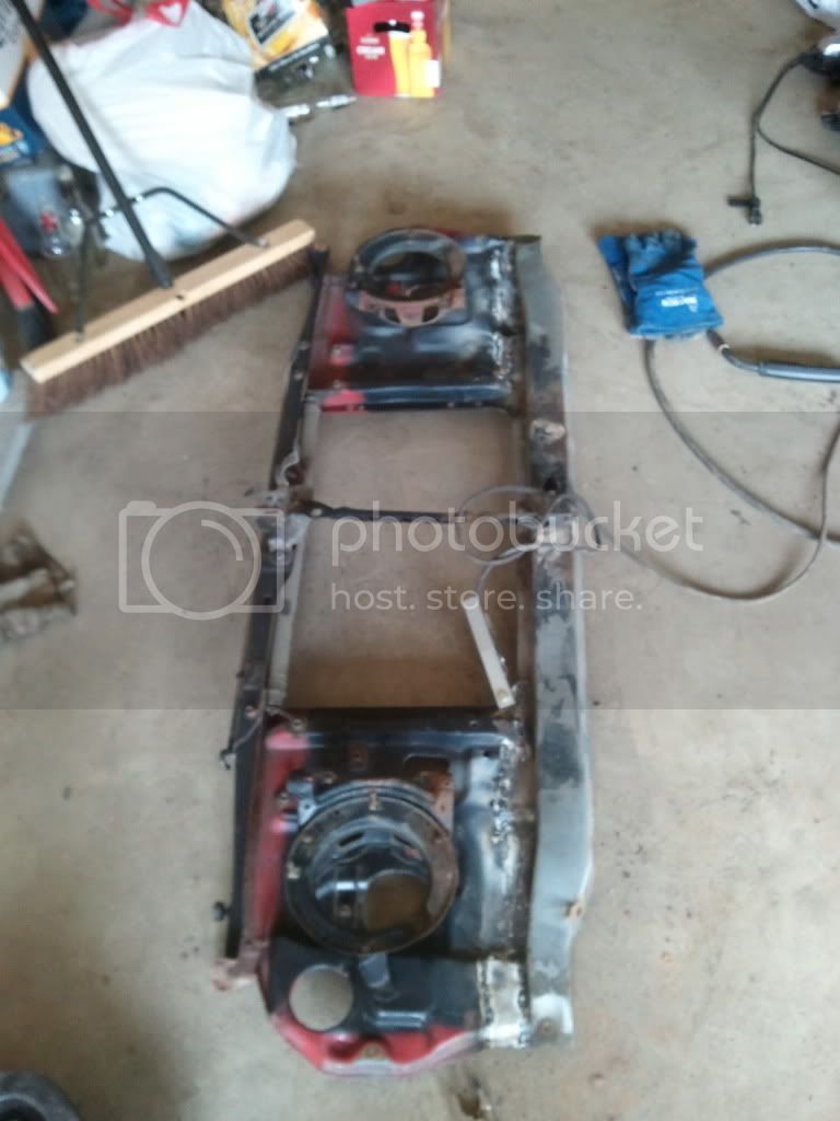

it's been a while since I've posted an update here. Now it is time in a project when you put tons of hours in but have almost nothing to show for it.
Anyhow, first of all body is back on the frame. After somebody complained to the city that you are not allowed to have garbage in front of the house - reffering to the frame. :hhmm:
I still can't get use to how low body is, compare to the height it has been on:)
You can't really see it here, but I've used good old Canadian Hockey pucks for body mounts. Worked great and cheap:)

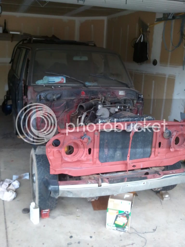

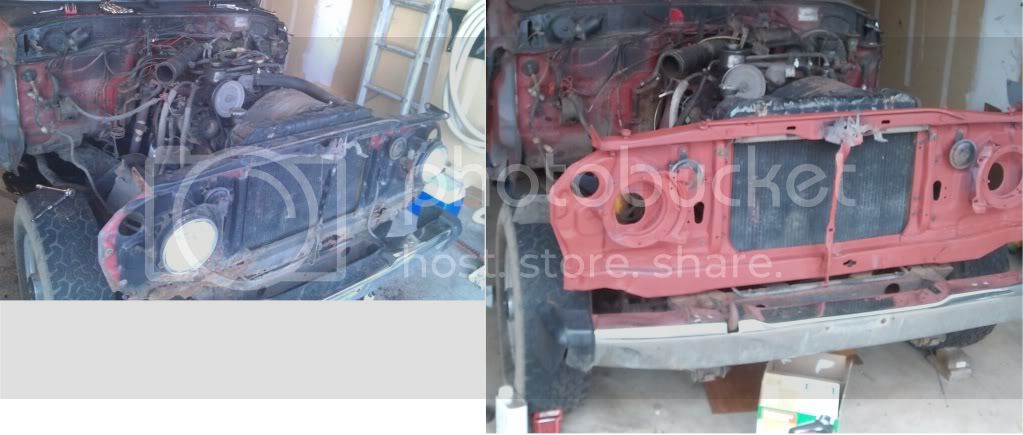

Turned my attention to the front clip now:
Replaced completely rusted rad support:
Here it is primed and installed:
Right fender is the very rusted but what can you do, I am not in a mood spending 300$ for a new one.

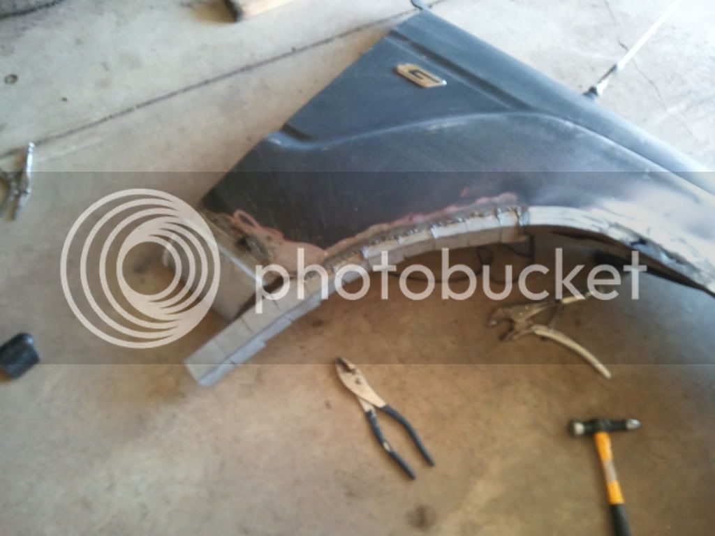

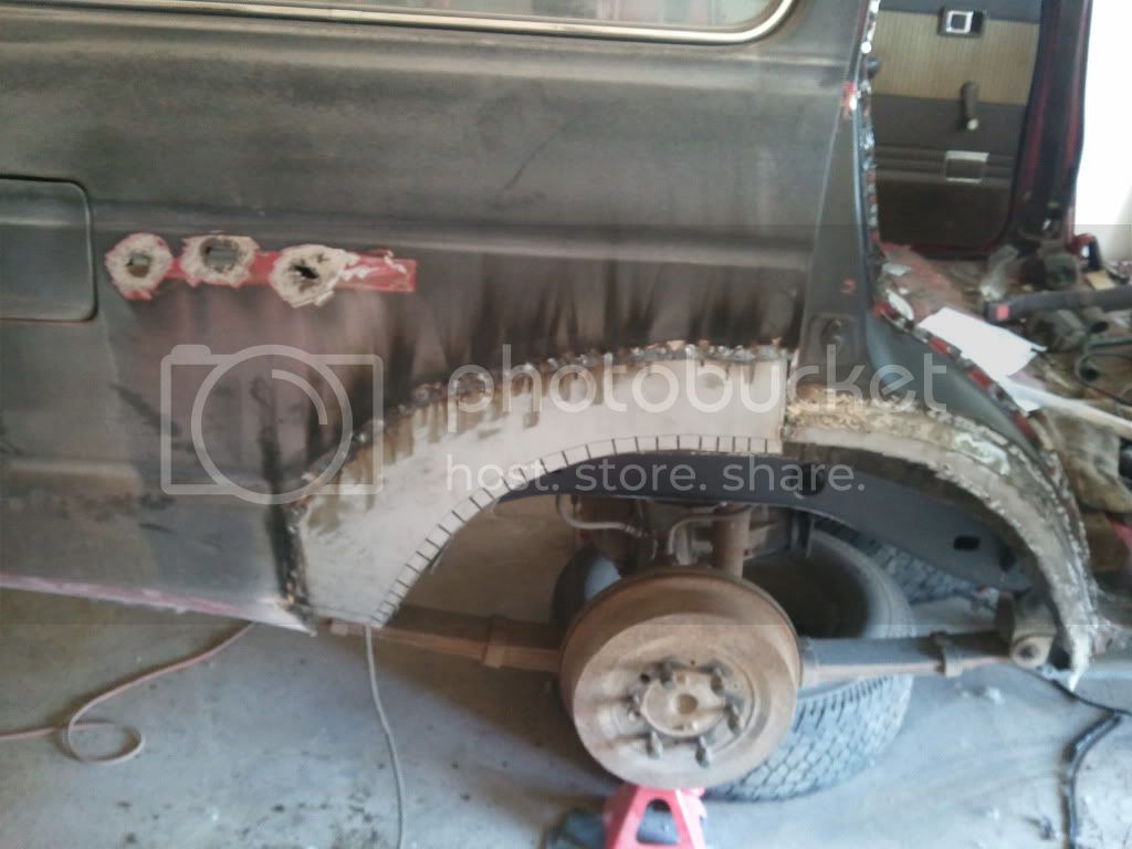

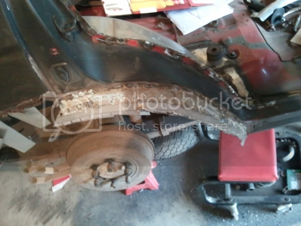

If you had the money, could have purchaced a shrinker streatcher to do the curve in that inner wheel well to side wall patch.
I thought my truck was bad, wow, you have it much worse :) Good luck and remember make it look good.

I want to learn these skills but sure I could have bought a clean body from CA but wth:)
I'll do my best, fender is almost done now - starting on quoters shortly

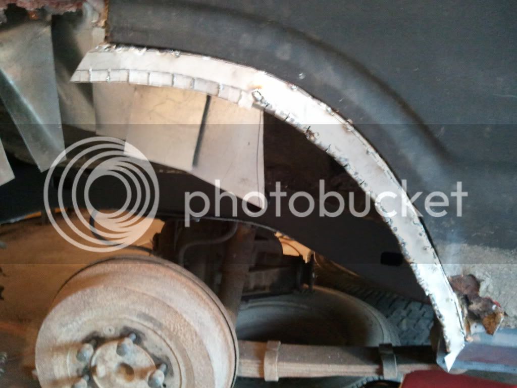

Couldn't wait and started on dog legs. It is painfully slow but coming. Right side is way worse then left for some reason.
Here is a work in progress:
Any tips on welding upside down?
Best tip I can give for welding upside down is a be watchful of drips, be sure to wear a lot of cover.
Take it slow and you should be fine.

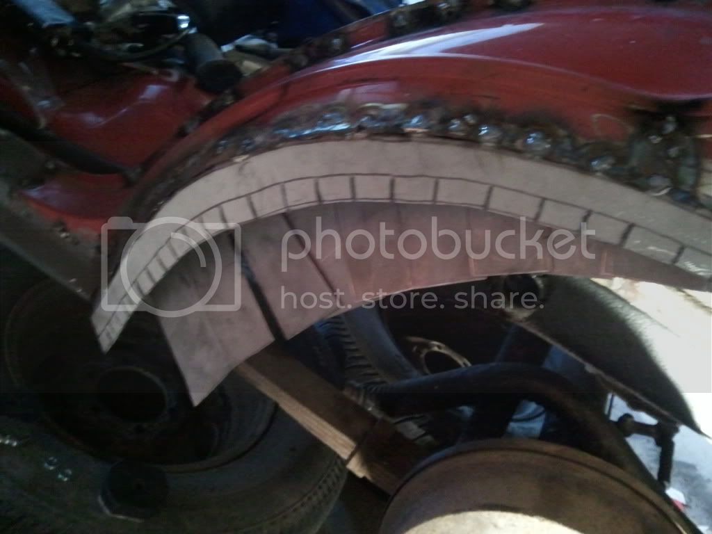

I really hate to tell you, but all those overlapping seams are going to hold moisture and rust out FAST. Looks like you could have cut the inner and outer as a big "c" shape? I agree even a cheapo shrinker/stretcher and you could have made those panels in one piece. I just hate to see a bunch of work ruined by one or two winters worth of moisture. Also, someone asked if any of it is galvanized. Please, do NOT use anything galvanized. Steel is cheap, your lungs arent. If you must use galvanized, grind off the coating first wearing a mask. The dust bad, but the fumes are deadly. And drink lots of milk afterwards.
Thanks guys. I am taking it easy with galvanized stuff - I only had one piece of it and it is all done now (except for inner wells).

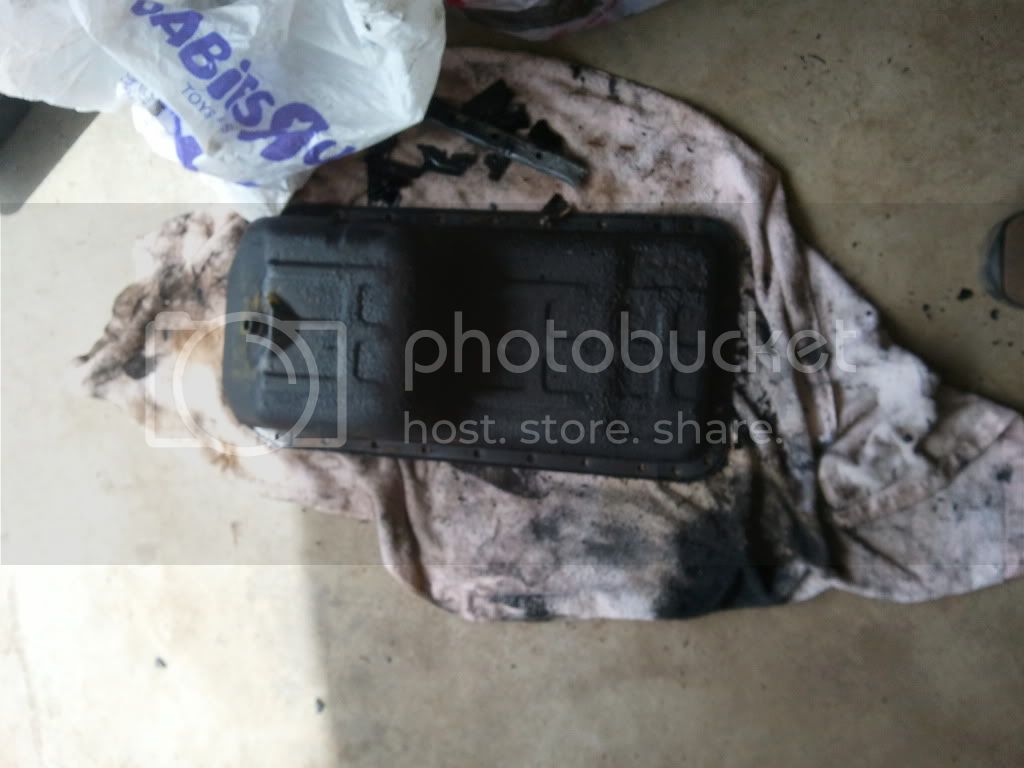

Also, I am planning to replace oil pan gasket this weekend. Does any body knows what the torque needs to be on those bolts? Also since the gasket is cord do I need to put any sealant in there? Any other tips would be appreceiated

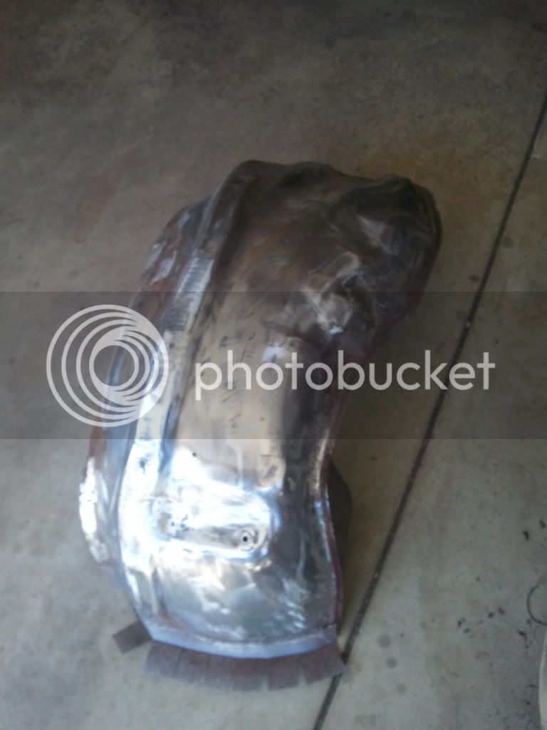

Ok, finished off welding at the front and getting ready to paint inner wells
Also I've replaced the oil pan gasket, I must say what a pain
We've also been busy on the rear quoters. So far it is coming out ok, but will see the final result.
Last few weeks were just too busy so didn't get much done. Rear quotes are done and dealt with. I am a muster of welding upside down these days. If I were to do it again I would buy or fabricate rear inner fenders from a single sheet.
