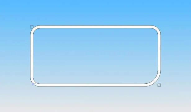

Since I still have the BJ42LX sliding windows that I thought would fit (they are ~1/8" to 1/4" to small on the mounting surface), I needed to design an adapter. This adapter would be sandwiched between the hard top side and the window frame.
The only question is to the width of the adapter. I need to make sure it fits in the indented region of the hard top side panel where the window sits.
Does anyone have the glass out of a around 1974 hardtop and can measure the height and width of the indented area for me?

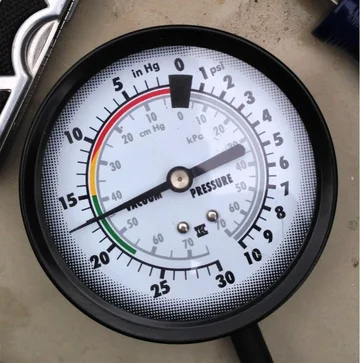

On a serious note, I've thought about your scenario a couple of times since Thursday. I don't think you have ALL the information yet on which to make your final decision. I REALLY think you should get ahold of a compression tester and get some 'hard' numbers on that motor. You shouldn't need 25 degrees of advance to get 15" of vacuum.

Did a cold check of compression. Results are as follows:
#1 - 155
#2 - 130
#3 - 130
#4 - 117
#5 - 130
#6 - 145
I'll do a warm test tomorrow or Thursday.

Did a compression test after idling for a few minutes to warm up the motor.
#1 - 157
#2 - 142
#3 - 137
#4 - 125
#5 - 132
#6 - 152

This was part of the diagnostic to establish current motor state.
Compression doesn't seem to be the root cause of the low vacuum.
Vacuum reading was better during the test at around 17, though this is a different gauge.
This was without changing the current timing (25deg advance). Choke off idle mixture was rich at about 12.5 AFR.
