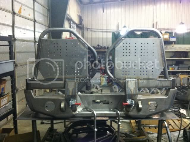

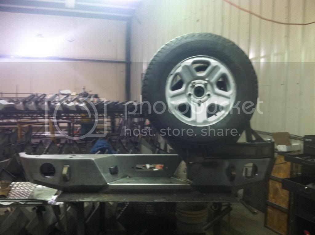

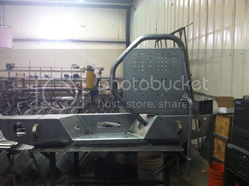

All,
Earlier, I was given some pics, from EXO, of their dual carrier for the Taco. This setup is similar to the Tundra. Initially, it seemed too 'crowded' and overbuilt. Don't get me wrong, I believe the EXO carrier system to be one of the more stout offerings out there, but to my eye, I am glad that the overall width of the Tundra is wider and stretch things out a bit.
I was wanting a modular approach, where I could have options in terms of choosing armamentaria. I feel as though a dedicated tire carrier would be one dimensional. EXO seemed to have understood this in their design. With the use of a grid configuration, There are many ways I can utilize this mount.
My initial concern is with the back-up camera / shroud. I have sent them a pic, with measurements, of what I needed to clear the factory back-up camera. I have grown to really appreciate this option ~ call me spoiled. I find it a major time saver when hooking up the trailer. In addition, it provides an added measure of safety when backing up with kiddos everywhere...My preference is to maintain the location of the camera, however, if I have to move it, so be it...Here are some initial pics of the EXO bumper for the Tundra. Yes, this is mine.
I did not want to go with dual carriers at this time. I feel as though the single is going to be fine for me. It will require some thought on what I end up with ~ good problems to have at this point. Needs are Hi-lift jack, pelican case with recovery gear, the Armstrong GMTK toolkit, or a Rotopax cell. Options, options, options. That is what I like to have.

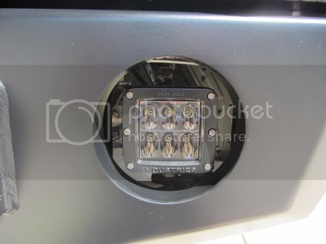

Also, I have decided to take the Rigid industries Dually D2 off the Baja Rack and I will place 2 D2s in the supplied light mounts. I found the Dually D2 with the diffused pattern to wash out when placed low, and I prefer a more directional beam when backing up. It is perfect for overhead lighting, but not for backing up. I'll see when I get the rig set up.

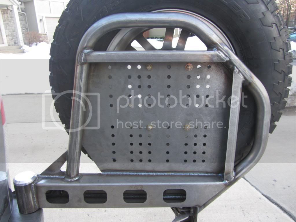

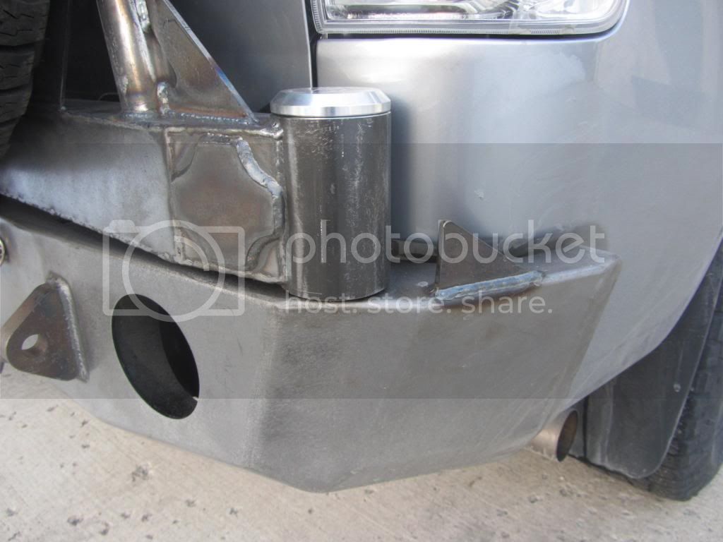

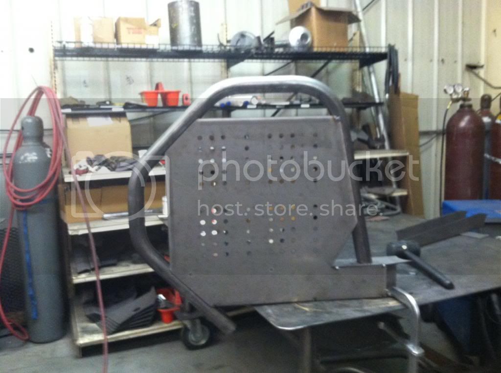

All,

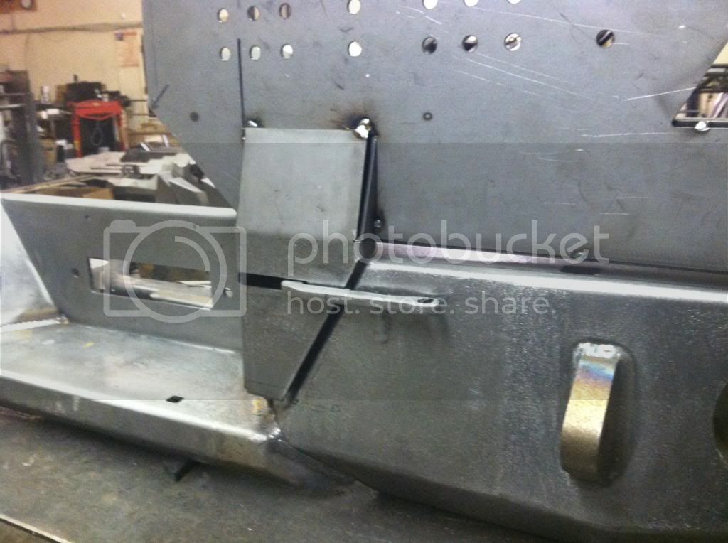

I just got some pics of the bumper and the latching system. This process has taken time, however, the end result is worth the wait. I am going to 'tweak' the carrier at Atomic fab, then to RML powdercoating, then installed. Tweaks will include a modular case rack ~ pelican with recovery gear, a swing down table and a rotopax. Also, I'm going to fab up a locking pin system so I can lock the tire carrier at various open positions. I'll have to see when it gets here...
EXO fabbed up a custom latch system. Originally, the latching system on their ExPo Tundra was electric, and was riddled with problems. So this is their solution. From what I understand, it is mechanical and far more reliable. I'll be the judge of that. Here are the pics...**not the most focused pics in the world** I'll get better pics when its mocked up on my rig.

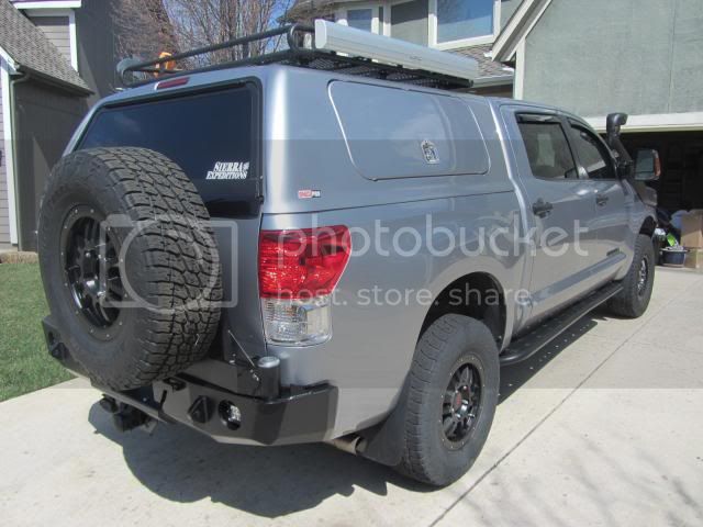

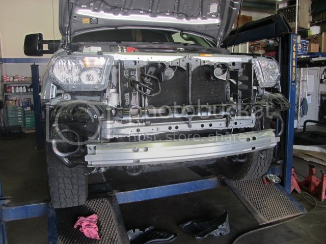

EXO bumper is on...mock up only.

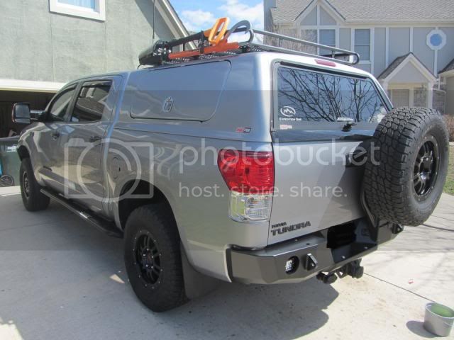

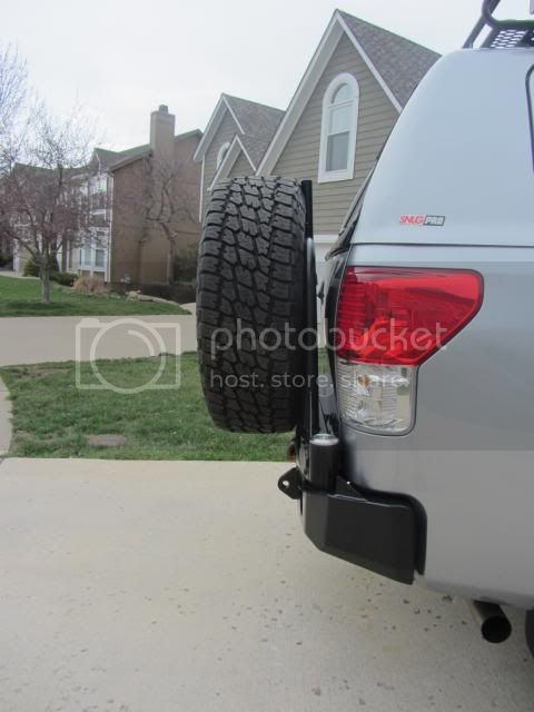

All,

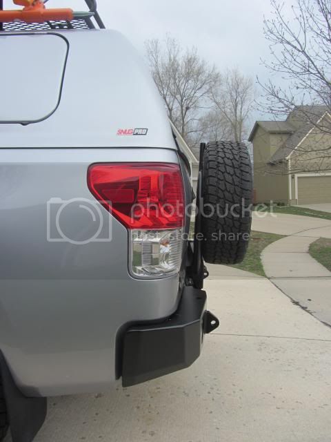

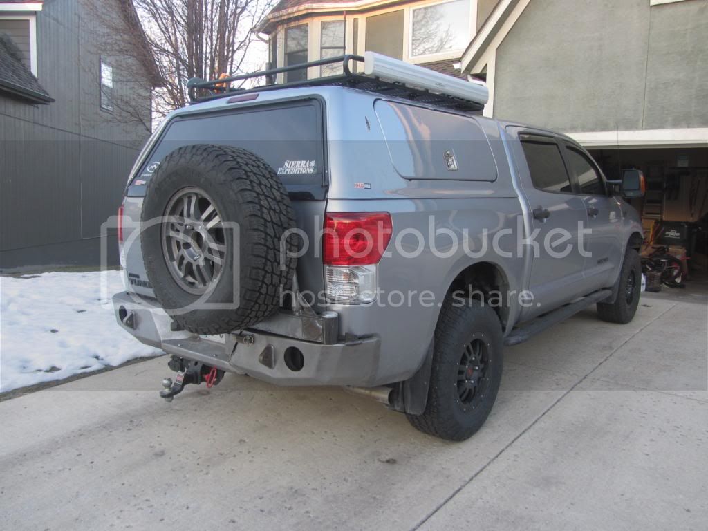

Here she is. I just got back from Atomic Fabworks and I have the bumper on in raw metal. Why? Well I wanted to have the bumper on my rig for a short amount of time to work out any 'bugs' that might exist. All in all, EXO makes an exceptional product, and I am VERY pleased with the results. I have waited patiently for 10 months now, and if I had to do it again, I would without hesitation. I would rather wait and get it done right, than get a product that was rushed to make a deadline.
A special shout out to the guys at Atomic Fabworks (Steve, Brandon and Kelly). They have exceeded my expectations once again. They really care about the installation ~ even down to the smallest details. They had the insight and expertise to avoid issues that I did not even think existed. That comes with experience and care...By the way, Atomic's race team placed 2nd overall (barely edged out of 1st) in the King of Hammer's stock UTV class. Not only do they work hard, they play hard as well. Congrats to them all.
Now back to the topic at hand. Every aspect of this bumper reflects quality, engineering and artistry in one stout package. It is overbuilt ~ PERIOD. What I appreciate are the simple lines, however, don't let that fool you. This bumper and swing out are BEEFY and I have no hesitation in winching with these bumpers on. They are that strong.
After the process of replacing my stock 'bumpers', I would like to offer a word of caution. The OEM bumpers that are on your rigs currently are WOEFULLY inadequate. I did not realize how thin the metal was that make up the OEM bumpers. It is all for cosmetics and having the ability to crumple at the first sign of resistance. Deer vs. Tundra OEM bumpers; the Tundra would win, however, you will have a TON of damage depending on the size of the deer...Just sayin'. The rear tow hitch is the only thing in the way between your family, frame and the rear ender...Yikes. Not anymore in my house.
I chose to go with the single swing out because one is plenty for me. I like the utility of the single and it keeps the spare within close reach. I didn't snap any pics of the the bumper on the pallet. I was too excited to get this thing on and ready to go. Anyway, onto the pics...
As with any install, we had to shim and tweak a bit. I don't think that this is avoidable. The tolerances of this bumper were as tight as a one-off custom job. I ought to know, I had custom bumpers installed on my previous rig that took 9 weeks to fabricate and install. I think that EXO's ability to maintain their tolerances while doing custom work is one of a kind. Don't let the fact that these are 'mass produced' scare you off. They are that good...

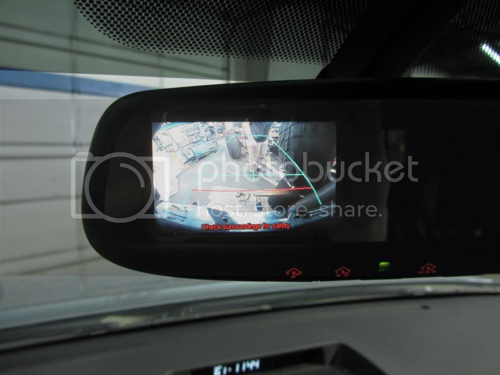

One concern that I had was the obstruction of the back-up camera with the spare tire. My tire is a 295/75 r17 (33") and I did not know how this was going to interfere with the camera. I will admit that I am SPOILED with this piece of technology ~ especially when I'm hooking up my SHERPA II. Here is a picture of my rear view camera. Not too bad in my opinion.

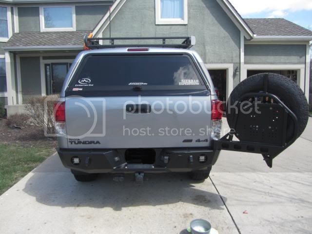

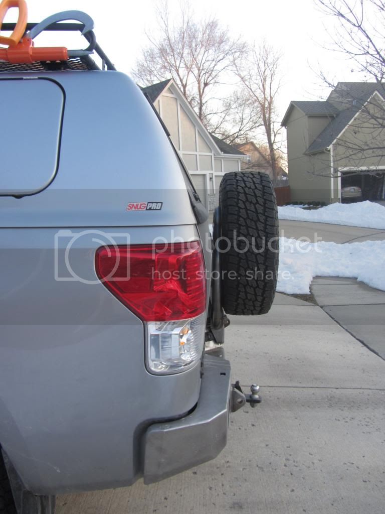

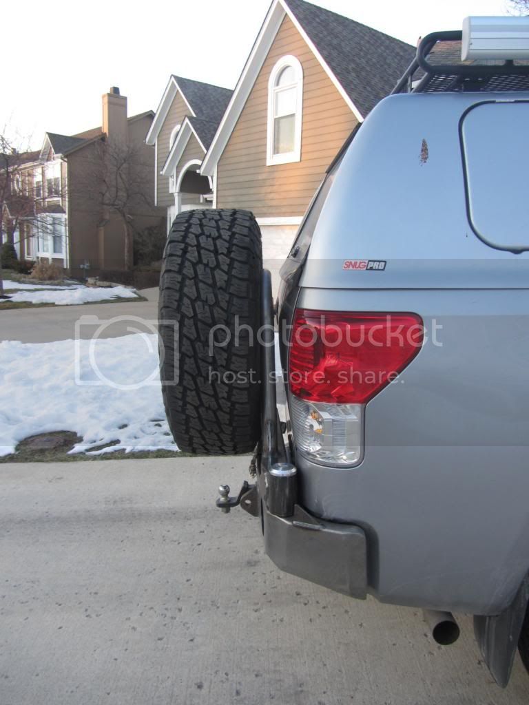

Finally, here are some driveway pics...
Prior to the trip to the powder coater, I will be having Atomic fab up a fold down table and a locking pin system that will prop the carrier at various open angles. As usual, I will post up pics when I get them.

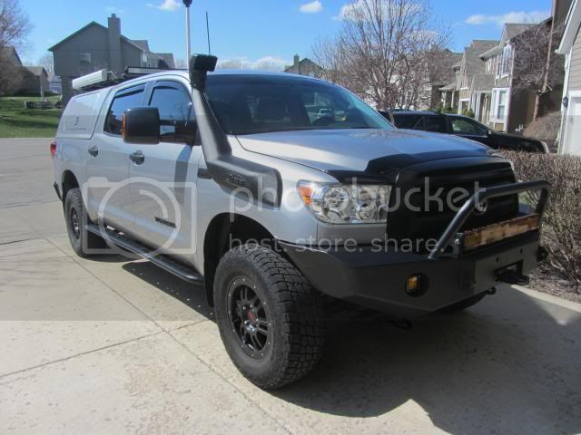

All,

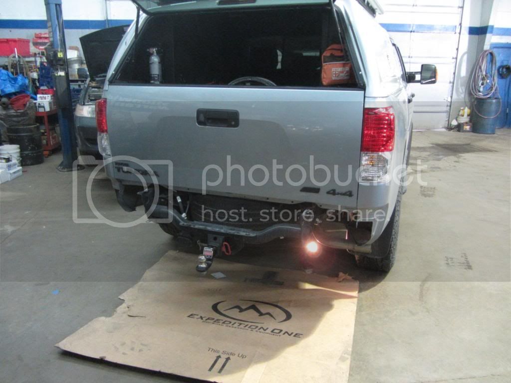

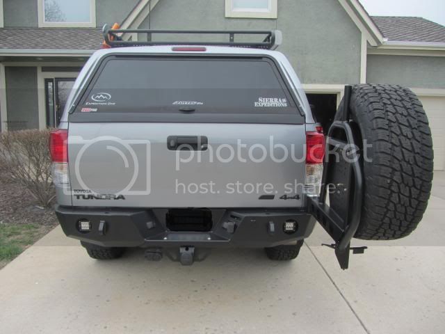

Just got my rig back from Atomic Fabworks on Friday. I had the EXO bumper installed following completion of powder coating at RML powdercoating. During the trial period, my bumper rusted from the freak snow storm + KS salt. I had to hit it with naval jelly and WD-40 Specialist rust inhibitor to prevent the surface rust. I was surprised how fast surface rust builds. It took two days for it the turn a lovely matte burnt orange. In retrospect, I should have sprayed the inhibitor sooner, but live and learn. My next bumper on my next rig will be done differently :ylsmoke:...
RML premier powder coating has this new dustless hydro-blasting process available. It is an alternative to traditional sand blasting. My understanding of this process is that it enables the blaster more control of the media and pitting of the blasted surface is decreased dramatically. It consists of water, tiny glass particles and a rust inhibitor. The glass disintegrates when it hits the surface. The end result is a surface smoother and more accepting fo the powder coat. According to RML, it is far more efficient, and is approved by all major paint manufacturers. My bumper looks like a fine mirrored surface. I recommend this process highly. If you are not local, I recommend you ask your powder coater about it. It is the newest process available, and RML is one of the first in the country to implement it.

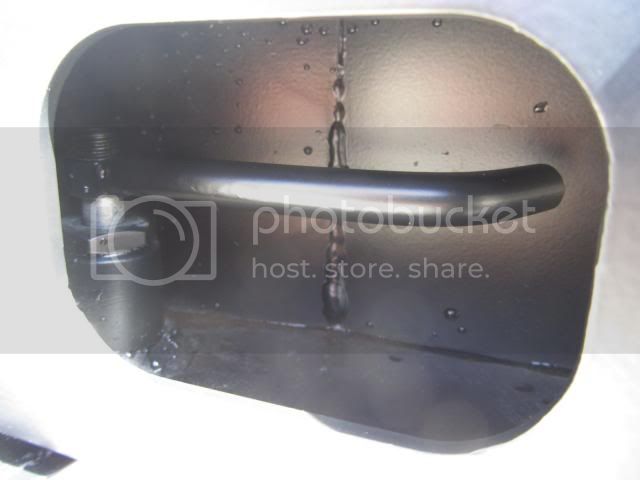

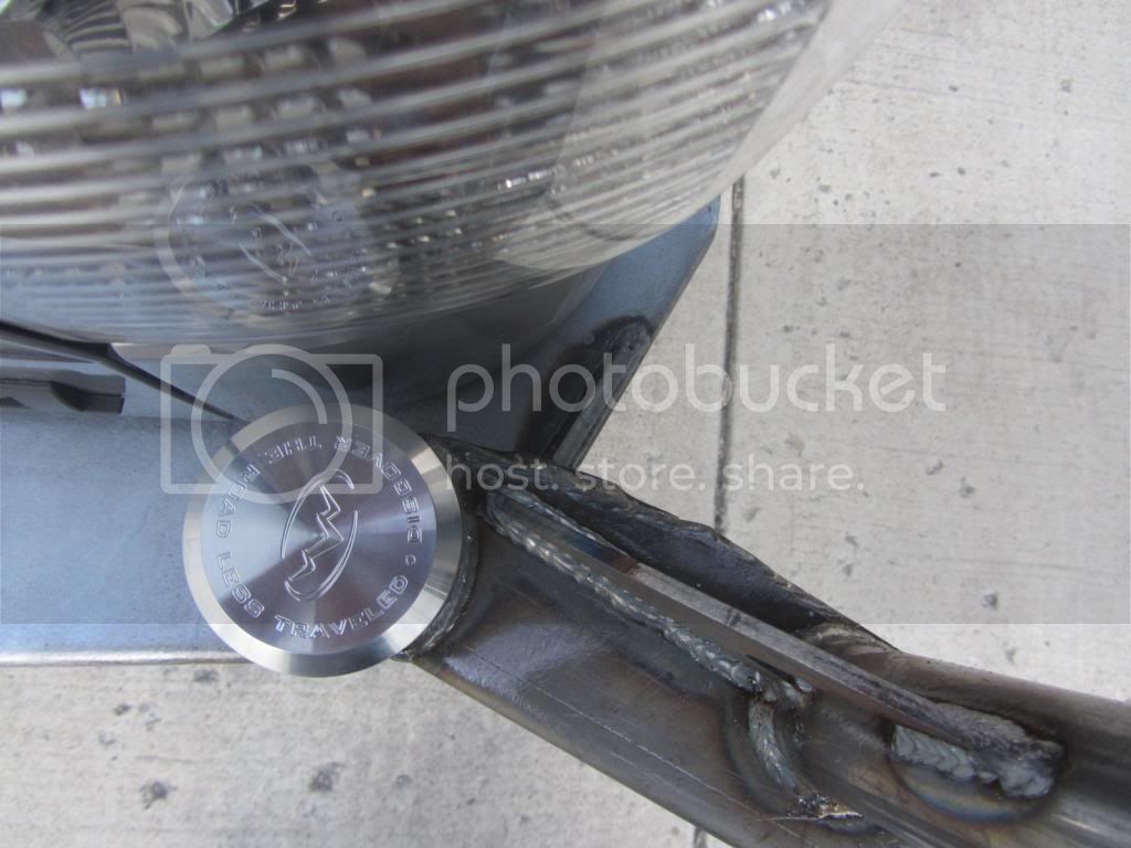

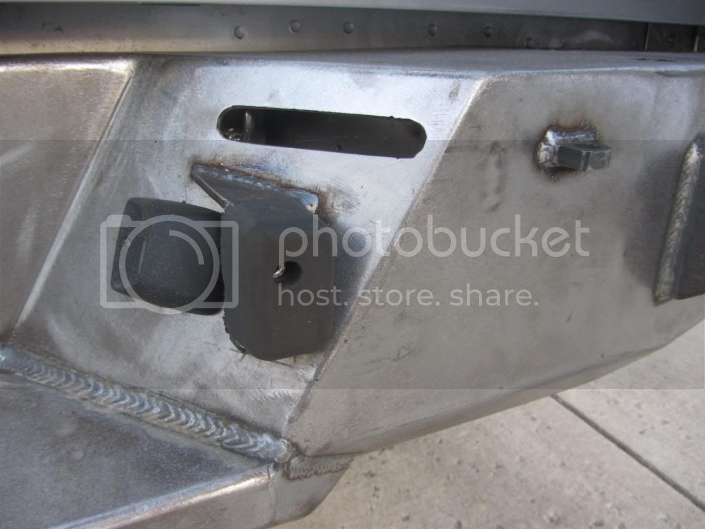

I had atomic tweak the EXO bumper before they installed it. Specifically, I had them weld a stop, a catch system (that would allow the tire carrier to be 'locked' in several positions), and a mount for my Dually D2 light stand. I wish I had done this for my Sherpa II trailer, however, I did not have any experience with tire carriers before my trailer build. Anyway, I wanted three positions available: 1) locked so that I could leave the tailgate up to gain access to the back with just the window open 2) 90[SUP].[/SUP] for the tailgate to fold down 3) open all the way without having the spare ding my tail light. The locking pin is a slick setup. It consists of a spring loaded pin welded to an L handle. This pin will pop down into one of the three holes in the locking plate.

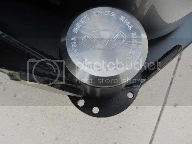

I wanted to wait on putting a pic of the latching mechanism of the EXO bumper. As I said before, this is an engineering marvel, and props goes out to EXO for fabbing this up for me. This was a one-off system that the head fabricator (Robert) had thought up and developed. I'm glad that I waited. Knowing what I know now, if you are thinking of buying this bumper with tire carrier, DO IT. To my untrained eye, it looks complicated. Yet to every fabricator/mechanic that has seen this latch was impressed at the ingenuity required to do this. I believe the bar has been raised for rear custom bumpers with a spare tire carrier. I will put this latch up against any other fabricator out there doing this ~ period.

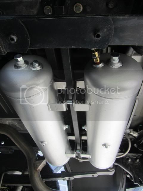

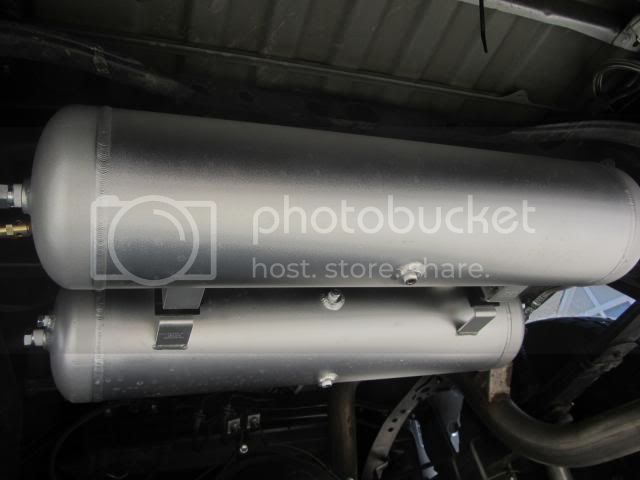

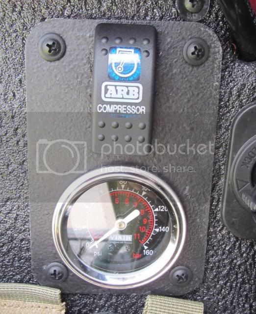

OBA: My wife bought me the ARB twin compressor (CKMTA12) for my birthday :wings: I am a blessed man. I coupled this with two 5 gallon anodized aluminum tanks. These were mounted in the spare compartment under the bed. I decided to go with the stainless steel braided hose for the entire system. After using this yesterday, I am surprised at how hot the hoses get. Anyway, Atomic fabbed up a custom bracket for the mounting and plumbed the whole system. They did a great job as usual.
Snorkel: I am a big fan of snorkels. I had one on my 3 gen 4runner and I found a screaming deal on one for the Tundra. I acquired it from Brian Jowett of Jowett engineering. THANKS BRIAN! This snorkel is made for the 200 series Land Cruiser, but, it can be made to fit the Tundra as well. Since not all Tundras are the same, we had to make a trip to the hardware store for some additional fittings. Finally, we got it to work. I can now participate in the Central Overland trips in Spring ~ High water mark + Yacht club...Many, many props out to Atomic for helping me out with these projects...Class guys that treated my rig like one of their own. Highly recommend them. Here are some eye candy pics of the snorkel and bumper. Enjoy!

Nice work! Your air tanks caught my eye, if you don't mind, where did you source them from.
Thanks, Ron
Thanks, Ron
Ron,
I sourced the tanks from bagriders.com.
Regards,
BWJ

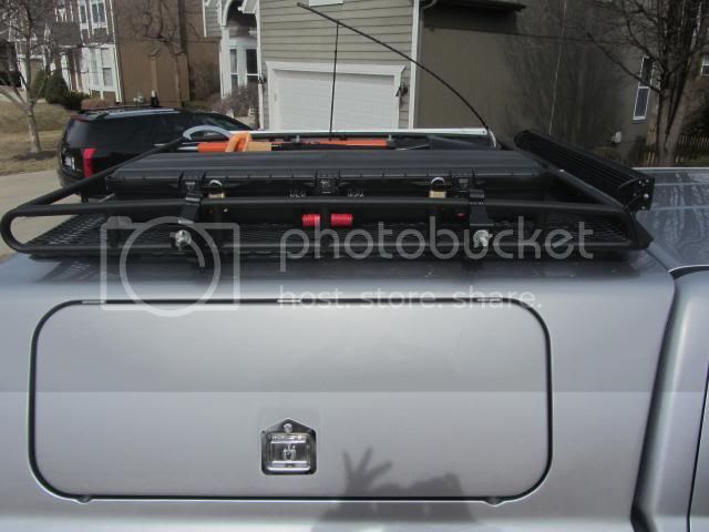

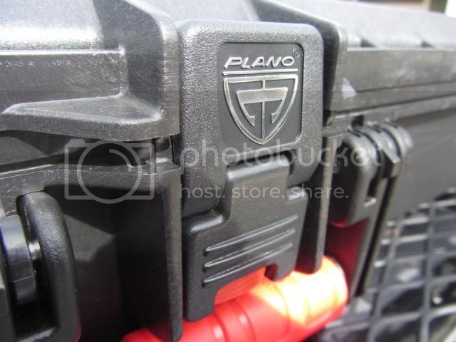

I have been quite busy in the off-season with various other projects, however, the modding bug is still present in my system...Recently, I cam across a great deal on an all-weather gun case at my local Wal-Mart. This is the bigger brother of the double pistol case that I got at the Bass Pro shops catalog outlet several years ago. It is molded in a material that is not as robust as a Pelican, however, my recovery gear never complained so I bought case. It was $ 69 + tax. There are several nice features that include the following: pressure relief valve, a sealed gaskets, pick and pluck foam and dual lockable hinges. I chose to mount this case in my Baja Rack and I bolted it down with 5 u-clamps. The holes are sealed with Pell door / window flashing tape. I will have my recovery gear more accessible if the tire carrier / tailgate were to become blocked.
Here is the original case with my recovery gear in it.
<a href="http://s164.photobucket.com/user/bigwapitijohnny/media/Tundra/photobucket-14183-1321223864968.jpg.html" target="_blank">
I was able to reuse the picked foam from the double pistol case without any issues. The case is big enough for my synthetic rope extension, my tree saver and snatching ropes. The sesamee locks tuck right into the case itself...

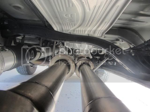

All,

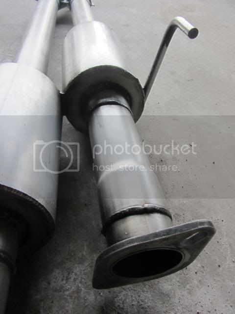

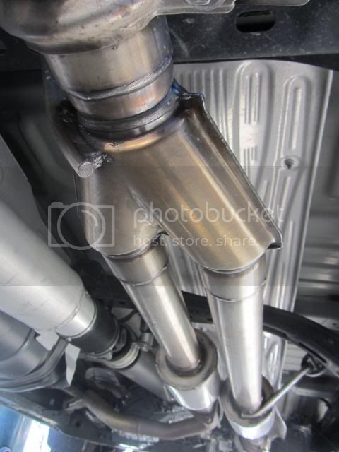

I just got through with installing my 8" Bamuffler system from Keith Carty and Dirty Deeds industries. Keith makes these exhaust systems by hand, and these are considered the gold standard in Toyota Tundra circles. I chose to get this new exhaust due to Toyota making a very restrictive OEM muffler, as well as, me wanting my rig to 'exhale' a little easier performance wise. I will not post up drone / no drone videos because I believe this to be redundant. Keith has been VERY helpful is deciding what system to get, and he was spot on...I was looking for a 'Wolf in sheep's clothing', and the 8" system, with the Helmholtz resonator, was just the ticket. I was fortunate enough to get in my order when he was ahead of schedule. Got my system 1.5 weeks ahead of time. UPS dropped off this 'mummified body of sorts' on my doorstep 1 week ago...wife and kids were concerned about what the UPS man delivered...
I have NEVER seen a package this carefully wrapped ever. His packing tape bill must be horrendous. It took about an act of Congress to get this system unpacked...As you can see, the weld beads are like a stack of quarters. This thing is all beef with everything made of stainless steel. I opted for the "Cleveland special 2.0" due to the heavily salted Winter roads in the Midwest.
The install was not TOO bad. I am not mechanically inclined at all, however, this was pretty straight forward. I am not going to share how long it took though...;)The tough part of my install was the rusted / seized bolts. Nothing that my FUBAR and breaker bar couldn't handle :D. The system is literally 'bolt on' with no need for my big hammer to persuade things. Hangers were in the perfect position...
I decided to hold off on the Helmholtz resonator for a couple of days just to see how the drone was. In my opinion, the drone was TOO much for me, and I was starting to have a little buyer's remorse.
Yeah, I'm too old and it was too loud. Following a quick call to Keith, he reassured me that the Helmholtz will make it all good again. I sealed the flanges of the resonator with Permatex Ultra Copper RTV sealant, and it fit like a glove. Following my install of the resonator, the drone in the cab was just like stock, if not better. I called Keith to congratulate him on being a genius and that the 8" system was the right one for me...
I have since installed a Hypertech interceptor (HTI) tuner as well. My Winter mpgs numbers since the additions are VERY good. During the Winter prior to the additions, I would average 11.4 - 11.8 mpgs. With the HTI and the 8" Bamuffler system, I'm getting 13.4 mpgs...Better mileage + sounds like a beast = happy, happy, happy

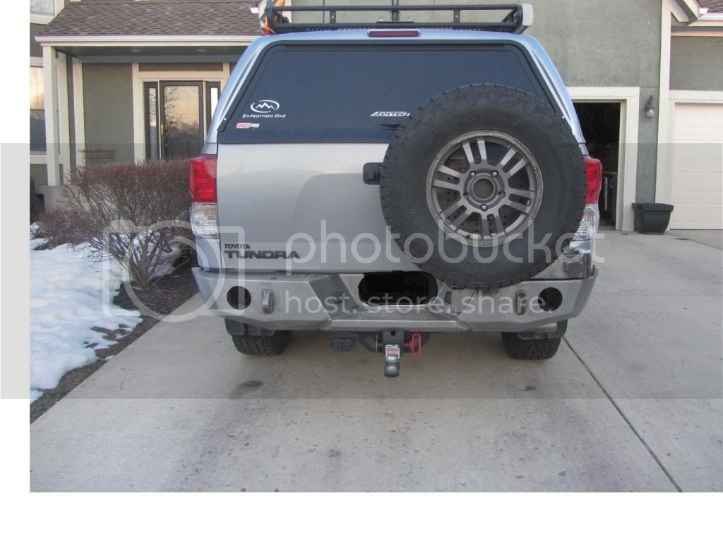

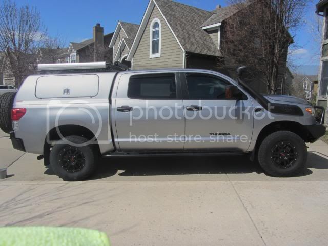

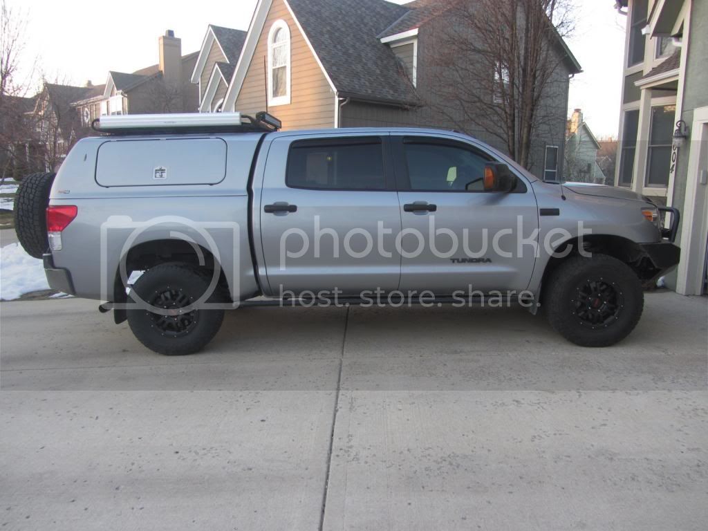

All,
I had noticed awhile back that my rig was getting heavier as the armamentarium grew. I could notice a distinct 'sag' from the side shot. Driveability has never been an issue ~ Tundra has been rock solid. However, I am getting to the point of asking myself "What do I truly need?". I can tell you that this question is leading me down a path that I have never really considered or thought of too much. Do I REALLY need a cant hook AND felling lever? Do I REALLY need 2x 5 gallon air tanks? Hmmmmmmm. To be honest, I guess everyone goes through this simplification process at one time or another. There is something to be said about intellectual and armamentarial simplification...Anyways, onto the pics.
Here she is several months ago. Notice that she is a tad below level in the rear, kind of a 'California' rake.
The problem is more noticeable from underneath the rig. Even with 2" rear shackles + 1" Deaver add-a-leafs, I could see that the original leaf springs were not getting the job done. Notice the first spring is inverting and the second is flat...Yikes.
I made a quick call and sent a photo to Wil at Sierra Expeditions. He recommended OME Dakar HD leaf springs with the add-a-leafs. I have had these for quite sometime now, and I here are my thoughts. The ride is smooth. Again, more of a supple feel when going over bumps. That being said, she is heavy. I took my rig over the Continental divide last summer, and it did just fine. I never had an issue at all. First pic is coming into the Great Sand dune after Medano pass. Second pic is having lunch at the Alpine tunnel...
One issue that I am having is the leafs squeak. It is awful. I have since contacted arbUSA about this issue, and they recommended that I place marine grade grease in between the leafs. I tried conventional grease, dry graphite lube, etc...all to no avail. I used one whole tube of this stuff, and it seems to be working so far. A slight squeak is detectable, but it seems to be improved markedly.
Now, I can see that the leafs issue is better than before and my sag is eliminated.
BEFORE
AFTER
I am looking at new ways to lighten the weight and simplify. I am realizing that I really don't need to carry the kitchen sink. Stay tuned...
