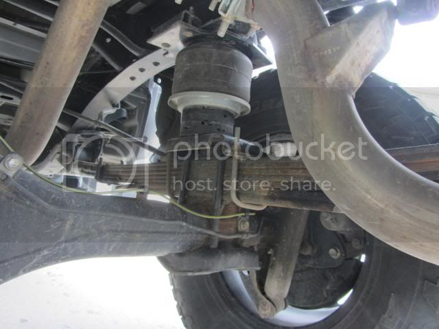

Daystar airbag cradles - I was concerned that the lift that I had was a little too tall for my airbags. I currently have Old Man Emu HD leaf springs and an OME add-a-leaf + coachbuilder 2" shackles. This combination works well, however, I was concerned with my Airlift loadlifter bags being too taught. I could have added another 1" spacer disc, however, I was growing concerned with the taughtness of my bag without any articulation. Here is a pic of my bag with the truck sitting in the driveway.
These cradles will allow for articulation due to not requiring the bag to be affixed at both ends. These fit the diameter of my Airlift bags and I went with it. Here it is now...
