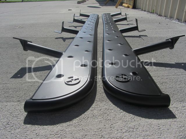

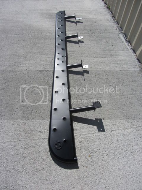

Here are some preliminary pics so far...I am glad that I gave Atomic a shot. They have exceeded my expectations thus far. These are 86" long, made from 1.75" tubing and bolt on. The overall profile is such that they sweep a total of 2" wider than the width in the front.
As you can tell, there is a slight bend in the rear of the slider as seen by the arrows. They did this to tuck the slider under the bed a little tighter...RIGHT ON!

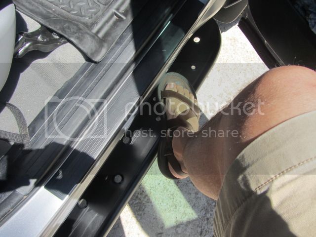

I wanted the slider to serve as a step as well. My son has dinged his shin several times getting in, and my wife wanted to push the slider project up due to difficulty getting into the truck ~ NICE. I went with aluminum five bar for my previous sliders, but after the bed liner coating, traction was not too good.
So, I decided to go with a raised dimple pattern along the entire length, and a more dense pattern where you would step to get into the rig...good traction for all.:D

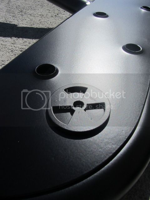

Finally, there is a little schwag from Atomic. I had them CNC cut their logo and will have it welded by the radius bend to serve as a 'traction' puck ~ arrow again. This will afford me some traction when I want to access the BajaRack.
I'm going with a matte black powder coating this time. I get the sliders installed in 2 weeks. Cannot wait...I'll post up pics when I get them installed.

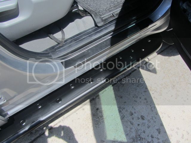

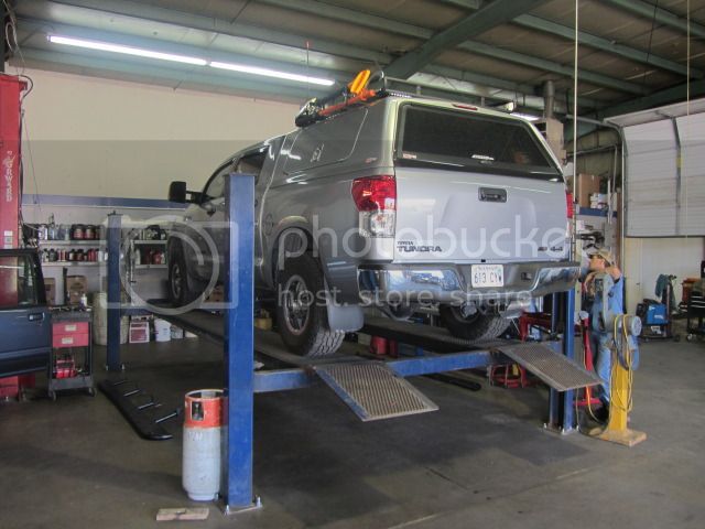

I got the sliders bolted on yesterday at Atomic Fabworks. They got them back from the powdercoater, and they are exceptional. It's almost a shame that these are going to be beat on, but oh well. Anyway, ON TO THE PICS!
I had a choice between 3 different hole patterns for the top plate. Atomic drew them up and sent me a detailed schematic of each pattern. I am glad that I went with this pattern over anything else. The raised dimples provide great traction so far, I am curious to see if this will change in the rain. Access to the BajaRack now is no longer an issue.

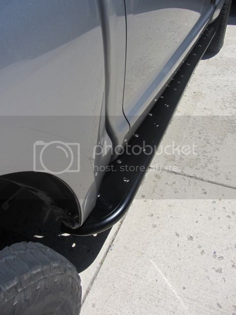

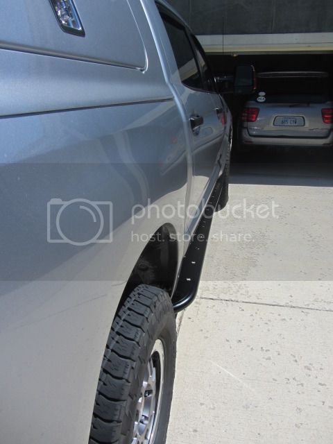

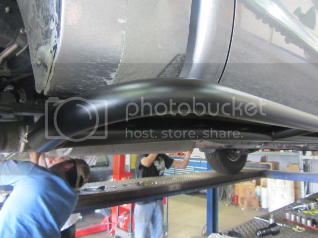

There is a slight bend in the rear of both sliders to sweep down and 'flow' where the bed dips down behind the cab. I wanted a kick-out in the rear, but I wanted one that kicked out gradually. To my eye, I really like how the kick-out sweeps outward over the rear half of the slider.
The sliders are 6 inches from the pinchweld up front and 8 inches at their widest. You can see that these accomodate my 'paw' well.
The sliders are mounted using grade 8 hardware and custom fabbed brackets. All in all, Atomic Fabworks did an excellent job. If you are in need of any kind of fabwork, give Atomic a call ~ http://www.atomicfabworks.com/. Ask for either Steve or Kelly.
