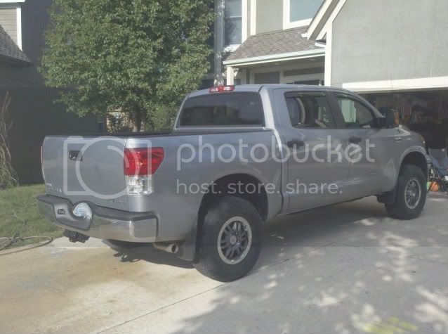

Here it is. 2011 Tundra CrewMax / 4x4 / 5.7L ~ 381 hp / 401 ft/lbs of torque. My broker lined up a great price for my rig and a great price on the Tundy. I found a tundra grade with a sunroof / upgraded stereo with BT technology / backup camera and some other stuff...Most Tundys with this setup retailed for 10K-12K more...:wings:
Anyway, on to the pics...
I sold my Wet Okole seat covers and ProComp wheels seperately, and I have some money...Let the mods begin...:coffee:

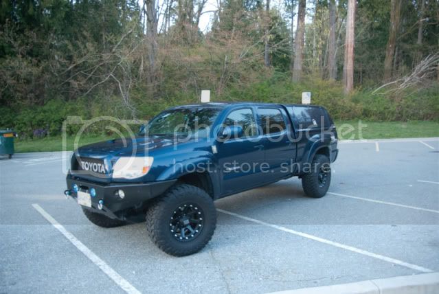

As usual, I was not able to find any pics of Tundras with this kind of shell...Closest pics I could find was a Taco...

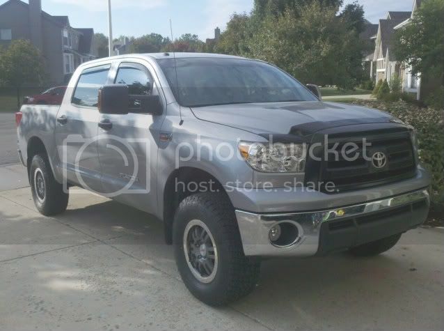

I have since upgraded my mirrors to tow mirrors. They are the bomb. So solid doors on the sides will no longer be an issue. Eventually, I will add the Frontrunner rack overhead and slap an awning on it as well...I'm going to go see one of these in person in a couple of weeks. If I like it, it will be ordered.

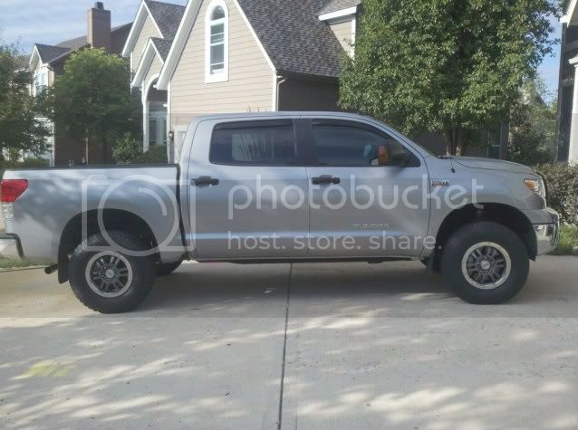

Toytec Ultimate Kit and 33s are on...
All,

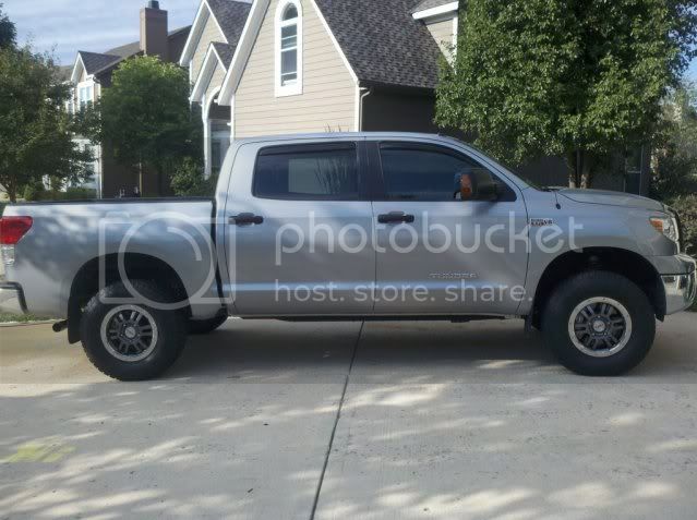

I installed the Toytec Ultimate lift last Friday, and I just got the rig back with the 33s aligned over the weekend. I chose to go with Toytec because of their reputation and quality kits. I have had good luck with Bilstein shocks on my 3rd generation 4runner. I could have built my kit 'a la carte', however, Toytec had just the right one. I went with a deaver add-a-leaf due to the constant load of my Snugpro shell, tools and equipment. Install was a breeze, the directions were easy to follow, and I really like the stance of my rig now.
I had to adjust the skid plate slightly with my grinder on the passenger side to clear the slight rubbing issue of the 33s.
According to the tire calculator ~ Ejelta.com: Tire Size Calculator, the 295/70 r17 is bigger by 1.69% than the 285/70 r17factory tires. I feel as though this tire size fills out the lifted 3/1 Tundra rather well. Alot different ~ AND BETTER than the stock wheel/tire combination.
Stock:
32s: Caveat ** These tires had 40% tread left on them...**
33s:
Stock:
32s:
33s:
Stock:
32s:
33s:

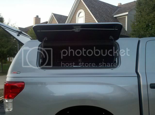

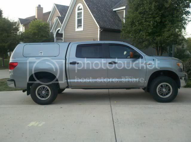

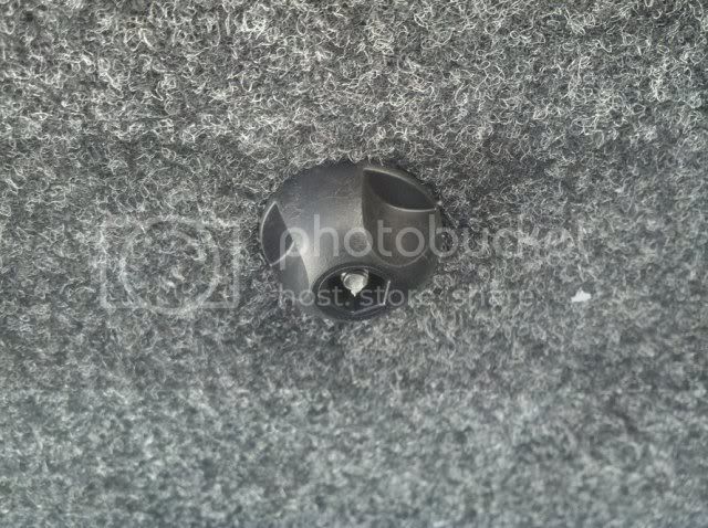

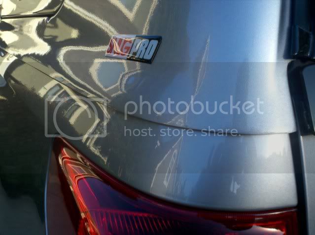

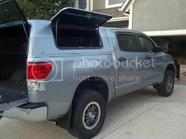

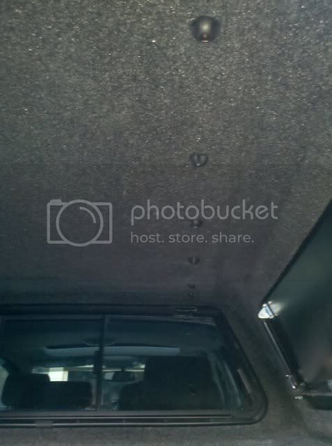

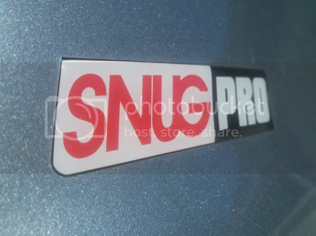

I just got the SnugPRO shell on today :wings:. I am very pleased with the fit and finish. I was not aware of all the small details that come with this shell. It is expensive, however, not too much more than the other commercial or lesser 'consumer' options. I won't bore you with the pics of the shell off the truck...Enjoy!
Finish is SPOT ON! From my understanding, SnugTOP has a very close working relationship with Toyota. The patterns for their fiberglass molds are digitized ensuring extact body contours. At one time, the SnugTOP shell was a factory option. Dealer warranty issues killed this though...This shell matches the lines of the Tundra perfectly, and the finish is exceptional. I could not be happier ~ Oh what a Marty McFly feeling!
Side profile:
Angle:
Front angle:
Yakima track system is installed at the factory. Roof weight capacity is 500 lbs. It is reinforced with wood, as well as, 2 honeycomb layers of fiberglass. Attachment points are rounded nylon nuts...I may scrub these and go with heavier duty hardware...
Solid fiberglass doors with locking T-handles.
Approximately 1" Fiberglass 'skirt' that overlaps the bed of the truck to minimize ingress of moisture.
Next up is custom wood shelves to hold my armamentarium...Off to the cabinet shop :popcorn:.

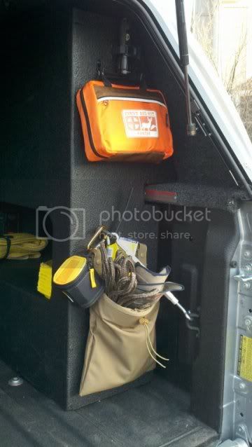

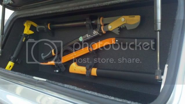

I just completed my cabinet project for the most part. I ended up doing it myself after I talked to the cabinet maker. Albeit it took me about 5x longer...I found that woodworking is somewhat 'therapeutic' and relaxing. The price of the overall project was about the same as the cabinet shop quote, but this also included me buying a router :wings:. I got these coated with Ameraguard, and with QuickFist clamps, I think it turned out well...
There are two shelves that make up this system. One opens to the bed, the other opens to the side access doors.
Anyway, onto the pics. Sorry about the phone pics, they look alot better on my phone.
I wanted something that I can remove if I had too. These can be removed by simply loosening several turnbuckles. The cargo openings are going to be 'covered' with Powertye cargo nets. I chose this net due to the openings being 2x2 inch squares as opposed to the usual 3x3 inch squares. Hooks and other hardware is going to the powdercoater and will be gloss black...
I found a Quikfist mini holder to mount a cheap Costco Tactical flashlight above the first aid kit.
Driverside tool shelf - I chose to mount my various camping armamentarium here...SORRY FOR THE POOR EXPOSURE!
I used both the QuickFist Mini 'Old style' / Mini / Original clamps. These are the bomb...
Passenger side tool shelf - I have my wrenches and other hand tools here. The depth of the shelves are about 13" at the base and then 5" at the crest. I found a tool bag at Home Depot that fits this to a tee. Also, my Pelican 1450 case is a perfect fit as well. Cam buckle straps will be ordered on Monday, and I'll cinch these down with 1" footman loops...
I had some time on my hands and mild weather so I knocked out some other projects as well. I'll post pics of this next...To be continued.
