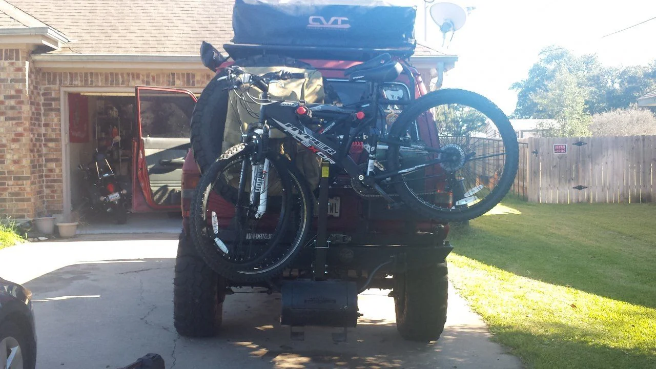

figure out a configuration to take my bikes and the bbq pit. Gonna be a great Thanksgiving camping trip.

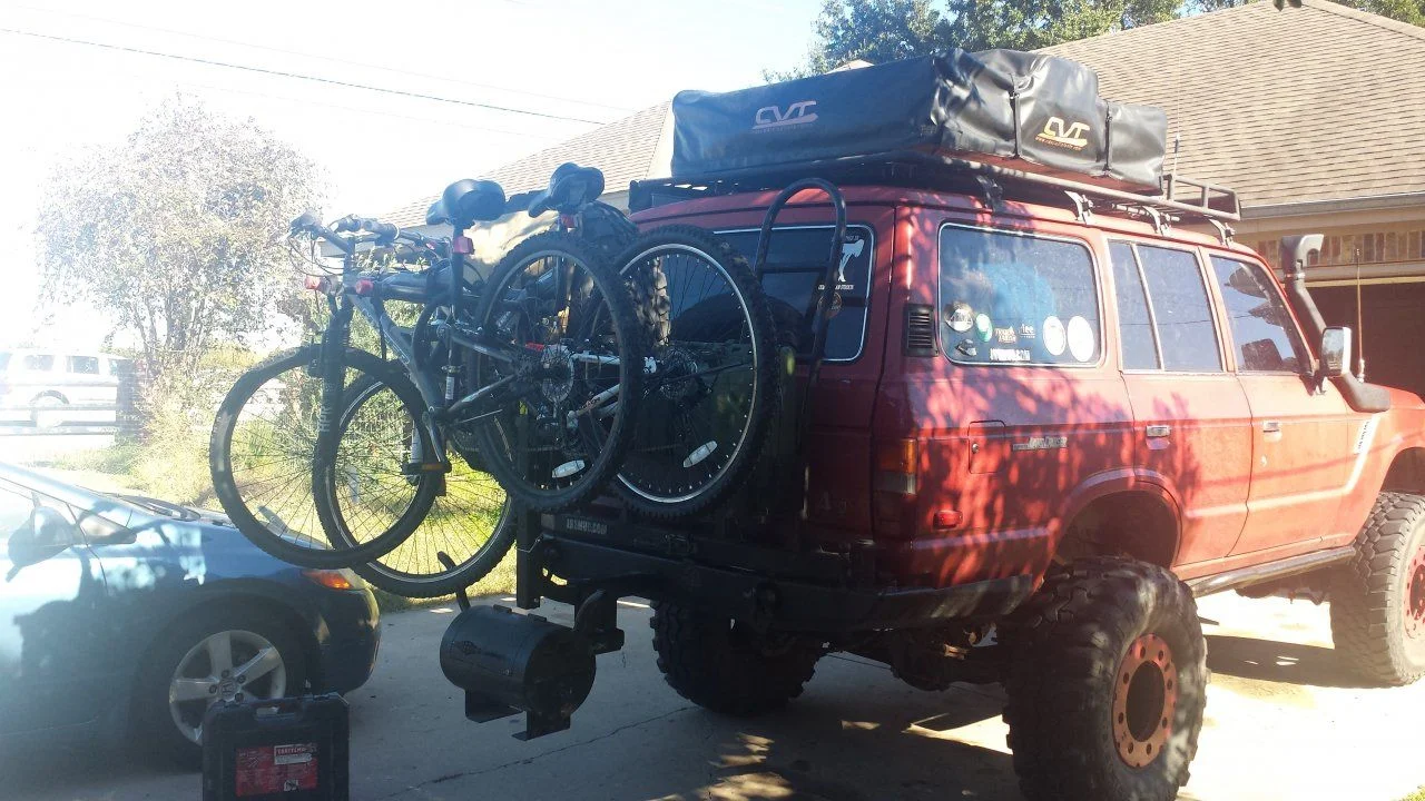

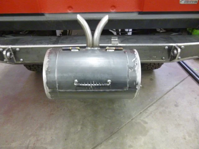

Details to the hitch mounted bbq??? I have always wanted to homebrew one like that but never had the time
This is courtesy of @reevesci , Best welder I've never met. Send him an idea and he'll make it happen. You can also get the details in my thread, I'm fixing to start driving so it will be a while before I respond.
Thanks Mike!

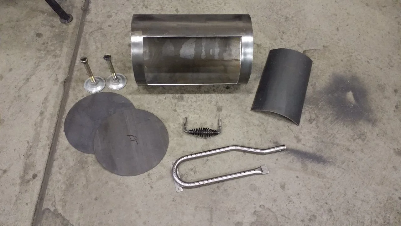

I've made a couple for the MUD guys.
The one for my 100 rig will be a dual fuel--- gas and charcoal/wood.

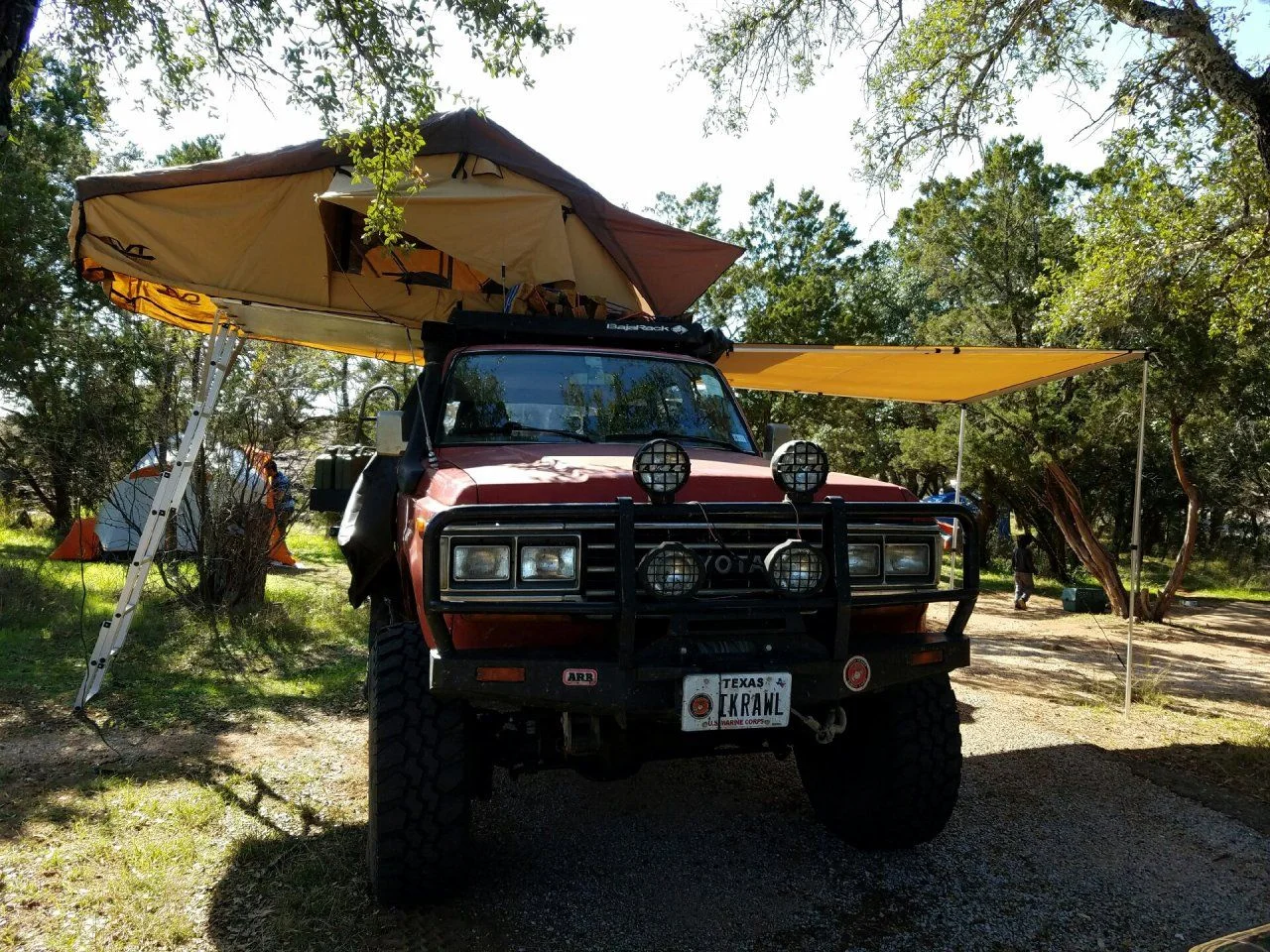

Got there early so I can pick where to set up the RTT. After that I put up my 8 man tent for the rest of the family.
Had to back it up over the concrete stop so the awning wouldn't hit the tree.

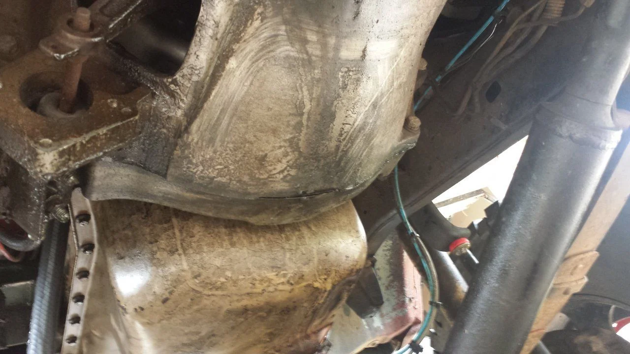

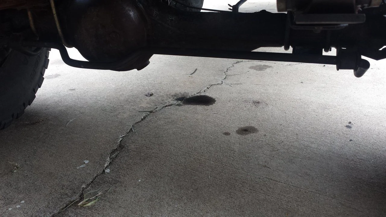

And now for the annoying news. Since I've gone to New Mexico I've developed a slow but consistent drip. I can't tell if it's from the rear main seal or the transmission box since it seems to pool around the bell housing.
It's hard to tell, but there's a drop at the very bottom of the bellhousing where the oil pools then drips to the driveway. I'm beginning to get some real flack about it so I guess it's on my immediate plan to fix. Here's my question, do i have to pull out the entire engine to do teh rear main? If so they I might as well replace a few other things like the motor mounts and probably do a bypass for the rear freeze plug like @ boots4 so when the time comes it will be ready for the second turbo.
Do you see any drips at the back of the #4 cylinder valve cover?
Yes, either the engine has to come out or the transmission has to come out to do the rear main.
No oil at the back of #4 cylinder valve cover :frown:.
Only other place it could come from is the pushrod cover behind the injection pump. Any oil coming from the DS of the engine towards the rear of the block?
Some other spots I can think of: I've fought with a leaky turbo oil drain that had oil traveling to that same spot under the bell housing. So check the passenger side of the engine too for leaks. Could also be an oil pan gasket.
I have it narrowed down to either the pan is leaking from the rear, the rear main or possibly even the transmission is leaking into the bell housing. Need a weekend to figure it out.
You could smell if its gear oil, no?

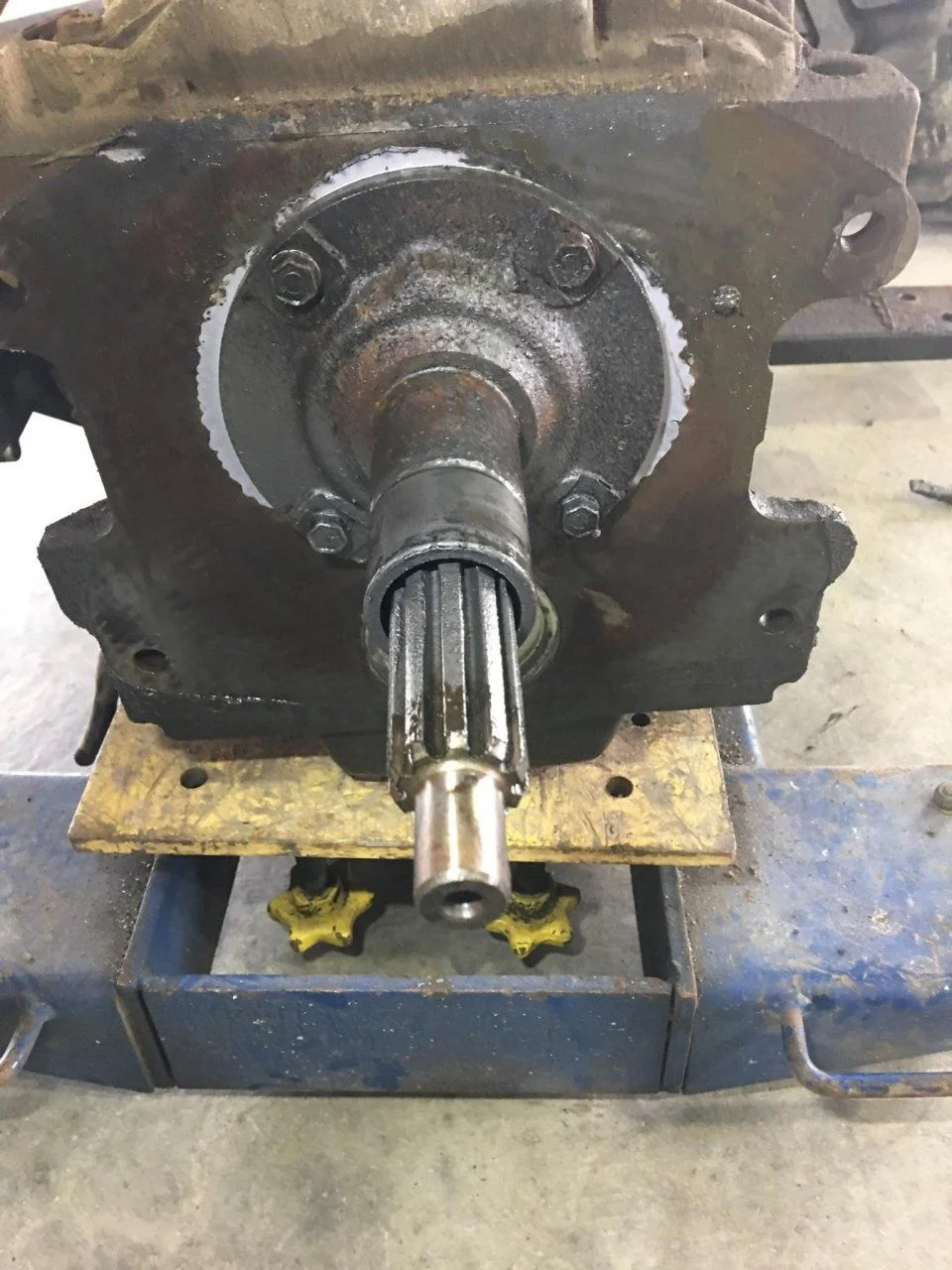

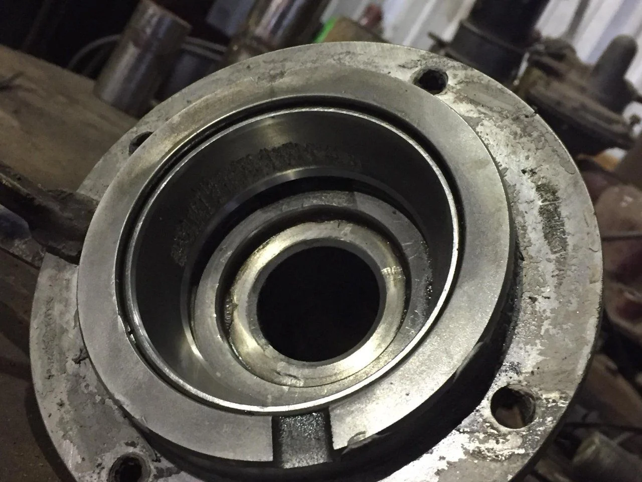

Tranny is out for an input shaft seal.
