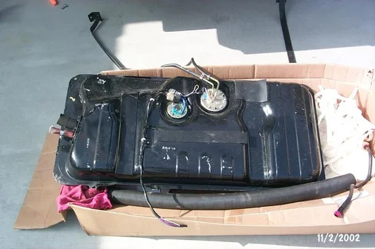

The OEM aux tank is about ~10"x20"x40". It basically fills the full width and length between the frame rails with enough gap (1" or so) to prevent any rubbing.
I want to note that I omitted a number of tanks that were close to the 40" frame width in going through the ones I extracted last evening. Now that I understand better the dimensions of the OEM tank, it might be worth browsing those tanks again for a, ahem, tighter fit.
My concern with tanks near the extreme width that fits between the rails is getting the mounting to work and having access room to attach fittings, hose, wires, whatever. On the other hand, that's where you can gain capacity versus a smaller, easier to mount tank. It's a little difficult short of getting a tank and trying to fit it to say exactly what gives you the biggest bang for the buck without being a PITA to mount properly.
Looks to me like the Toyota subtank mounts on brackets or attaches directly to the frame. IMO, that beats straps, which many tanks use, although I can see going either way personally. Having a tank the closely fits against the frame rails does facilitate using brackets instead of straps.
It also looks like the Toyota subtank mounts towards the rear x-member? This leaves space between the axle and front of the tank and reduces capacity somewhat, but simplifies tank construction and mounting. Several of the tanks I cited as candidates yesterday actually looked like they can utilize some of that space by already having a "notch" out of that corner of the tank (right front of space where exhaust is routed through at an angle on the 80), probably to similarly clear the exhaust in the original application. These will generally also be the higher capacity tanks.

I just got home and went and measured my truck. With the amount you cut out of the rear frame, the exhaust would get in the way. No I suppose I shouldn't say it will not fit, but it would have to either hangdown below the exhaust or the exhaust would need to be rerouted.
The more and more I look at this it seems like the OEM subtank is fine for a diesel powered truck. Seems to avoid a lot of hassle and I can't think of a situation where I'll need more than it offers.
Anyone with a 4x4labs bumper remember that an OEM aux tank won't fit.
I know that a local has the same exact setup: 4x4 lab + oem aux tank so I'm guessing pretty much plan N play.
