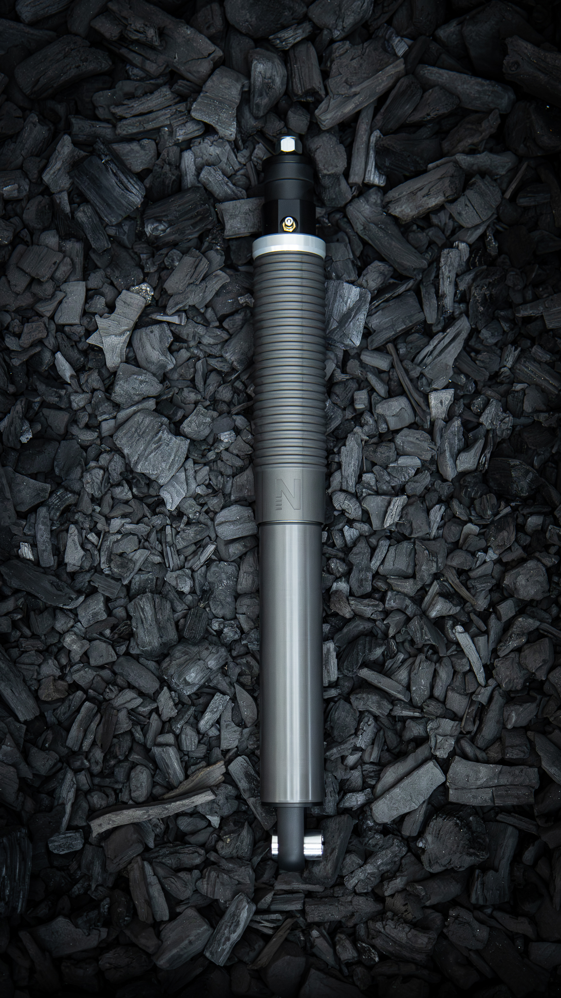

I am really curious about Nimbus oleo-pneumatic shocks. Not a ton of reviews on them yet as I believe they are pretty new.
What am I missing? Oil + Nitrogen like many shocks on the market?
^ you don't understand, it's a french made shock with oleo :)
