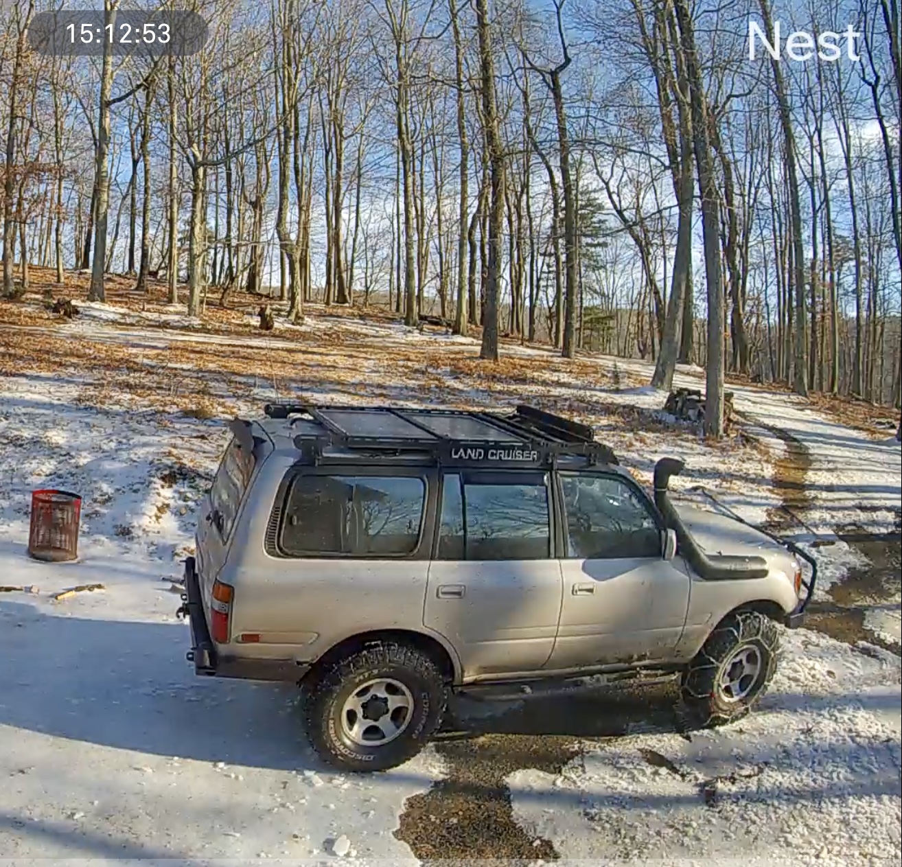

I bought these. I'll keep you posted.
I have those. They work great for me. You’ll want to run them on all four wheels.
Cable chains are the lowest profile, so least chance of body contact. Standard chains have more traction, taller profile, and a bit less civilized/ noisier, bumper. Vee bars are even more rude, but best on ice. Absolute best chains I ever had was a full set of semi truck chains that I traded a bunch of firewood for. Very rude and body clearance is risky, even after I shortened them to fit snuggly on my tires. They worked like steel paddle wheels.
I only bought them for front. Hopefully I'm good.
