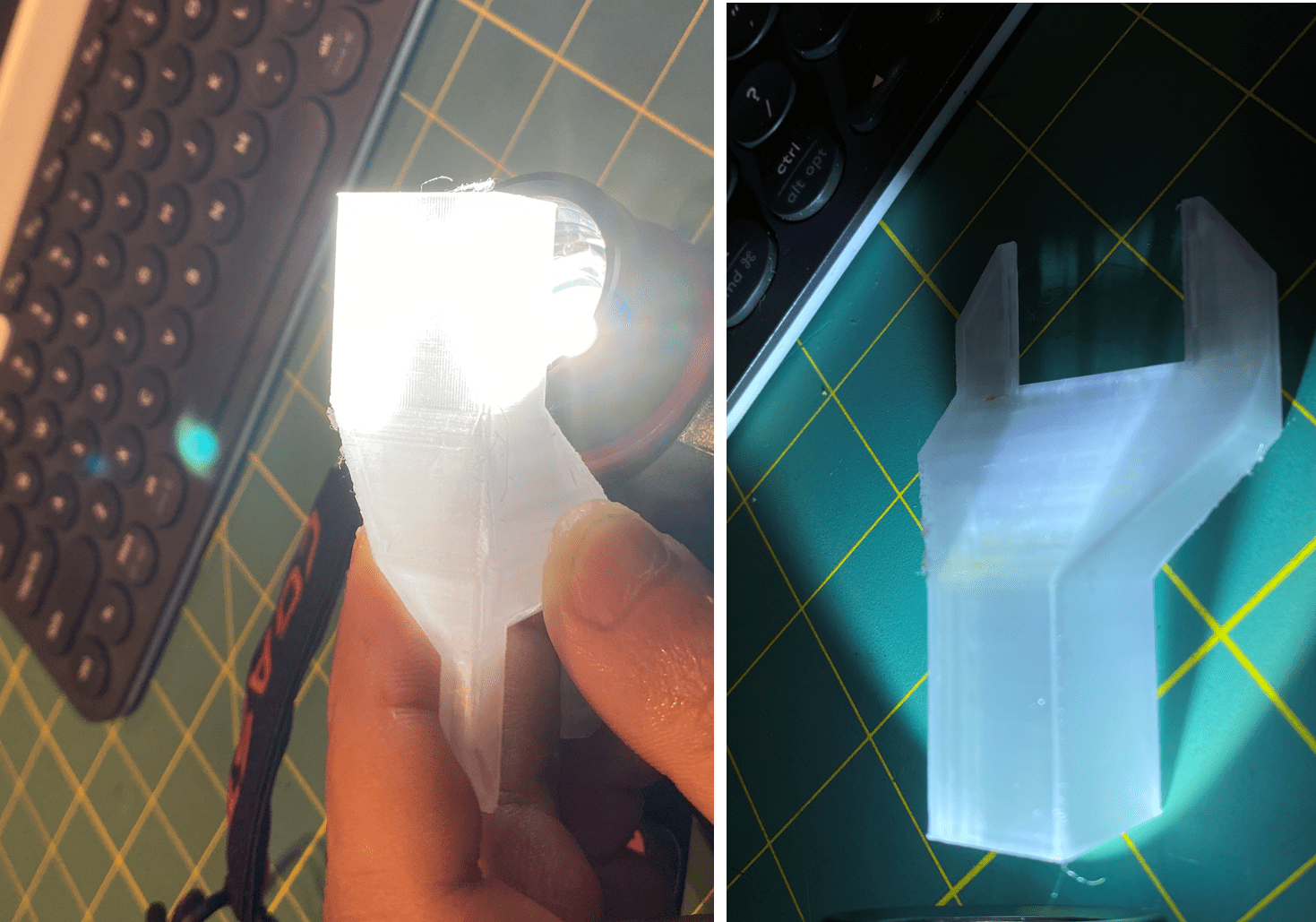

Hey @BenCC , I may have missed it within the thread, but are you able to print say, a button or switch cover with translucent material?
What I have in mind would be something like the rear vent window switch, with the ability to light up the open/close ends, instead of just the center as they are from Toyota.
Not fully translucent. But light can shine through..
This is also my need. I cannot tell the open/close status of the rear vent window most of the time in daylight.
