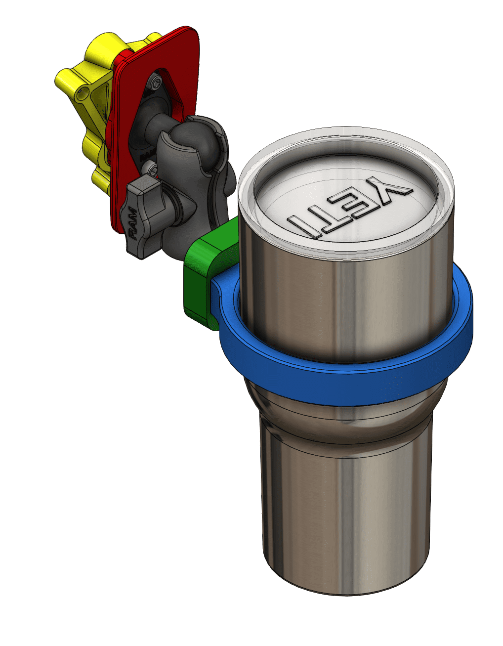

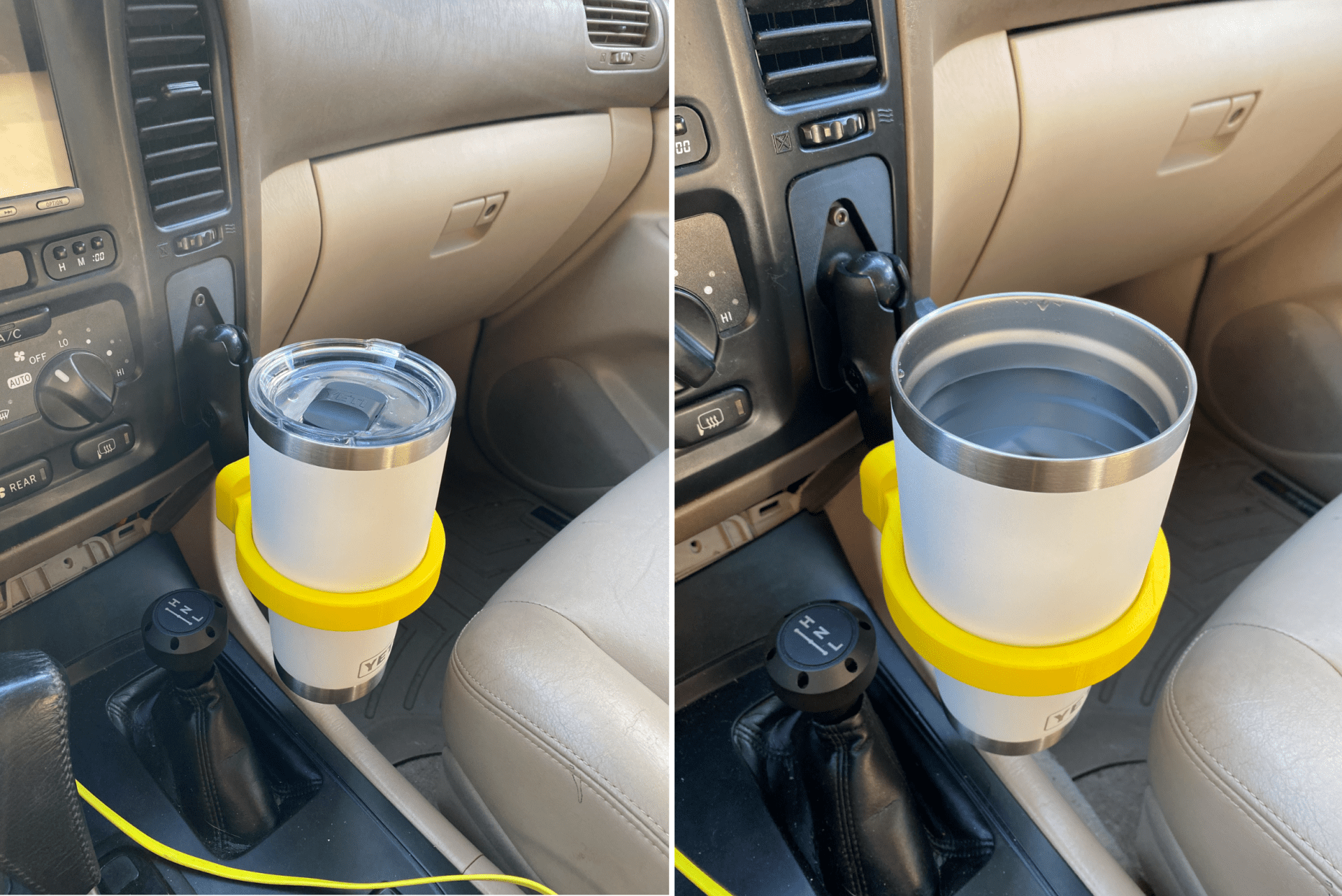

Perhaps 2 ram mounts for 2 cup holders? Tbh I don't really think there is much need for snitches in the back but coffees and water bottles foe the kids. Yes fast charger and inverter outlet is excellent!
lol
Yes we can put two RAM mounts there or a two-cup holder on a single RAM mount.
I may need to mount two switches there for aftermarket seat heating pad.

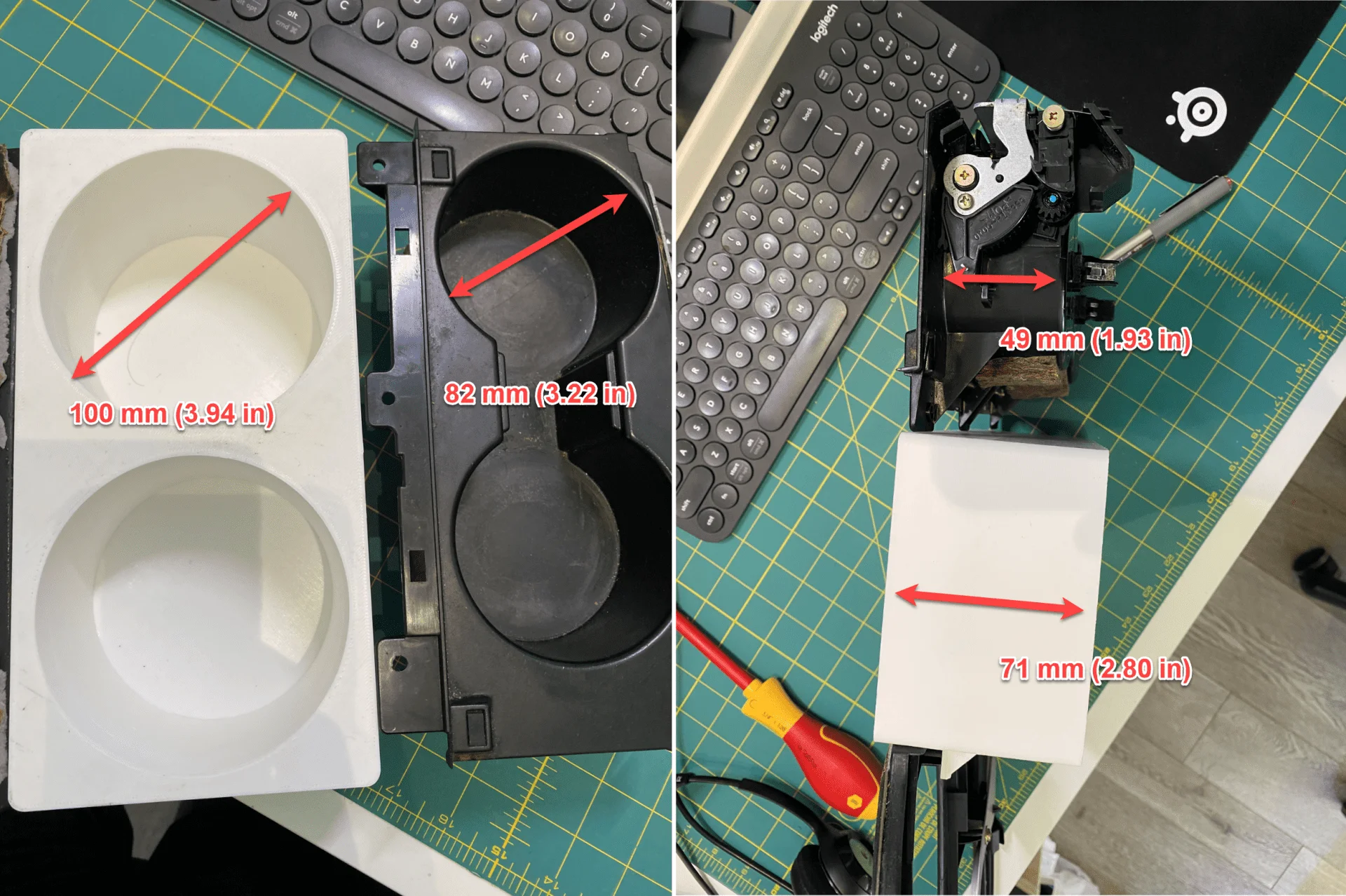

Update on the drawer delete/replacement.
I never use the factory drawer/cupholder. The reason is that it is too shallow to hold a drink. When the drawer is retracted, there is almost no space in there for storage. After removing the drawer, I see some space behind there for a small power inverter. Plan is (1) make a versatile face plate that could be configured based on individual need, (2) mount a small (150W-200W) power inverter behind the face plate.
The cupholder design is not completed. I put the prototype to illustrate that the cup holding function can be retained.
Comments please.
A more robust and modularized design.
The blue bracket is fixed directly to the sheet metal behind the plastic factory panel. This gives a solid foundation for the RAM ball to hold one or two drinks. For comparison, M7V1 and M7V2, attached to the plastic panel, are only for mounting lightweight 12V or 120V outlets.
The faceplate can be configured based on individual need. The configuration is on the CAD level. The faceplate is still a solid single printed part.
More testing is needed.

Based on the measurement, this should fit.
