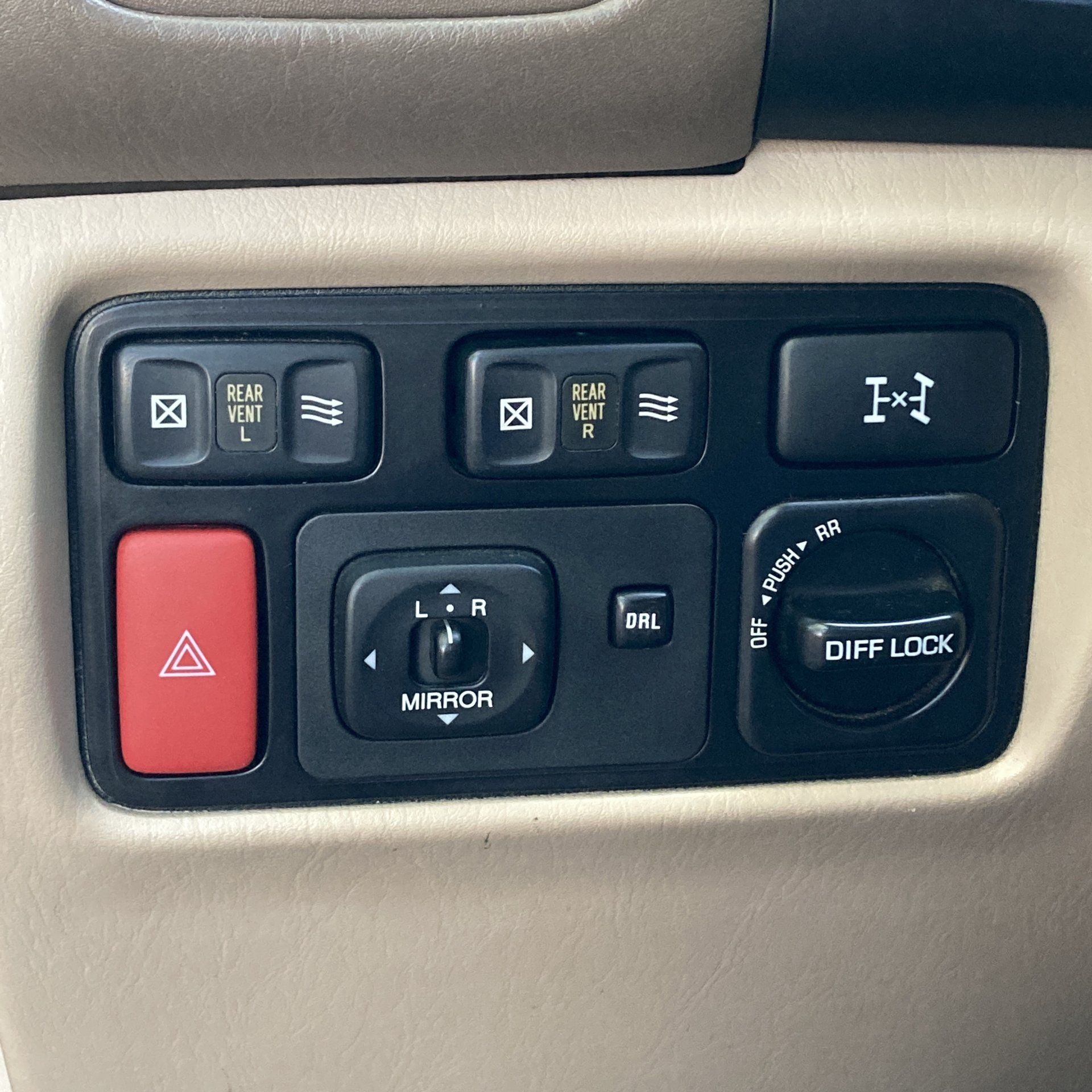

I don’t. Why do we need to move two switches to the right side and add one switch back to the left?
good point - this is me over-thinking an idea. I am putting a front switch for camera and figured the left side would be easier - but maybe the right is simpler and less jumbling things around. Scratch my idea, thanks.
No I was just curious about your application.

Has anyone installed the window switches in an 03+ LX? Looks like the physical switch and plastic piece are different between early and later models

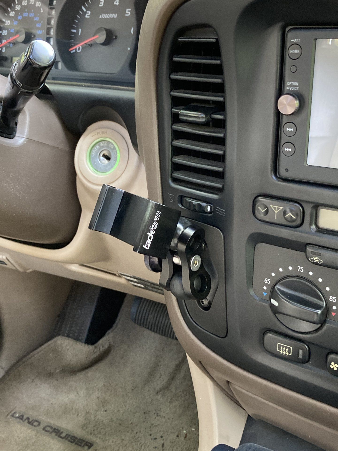

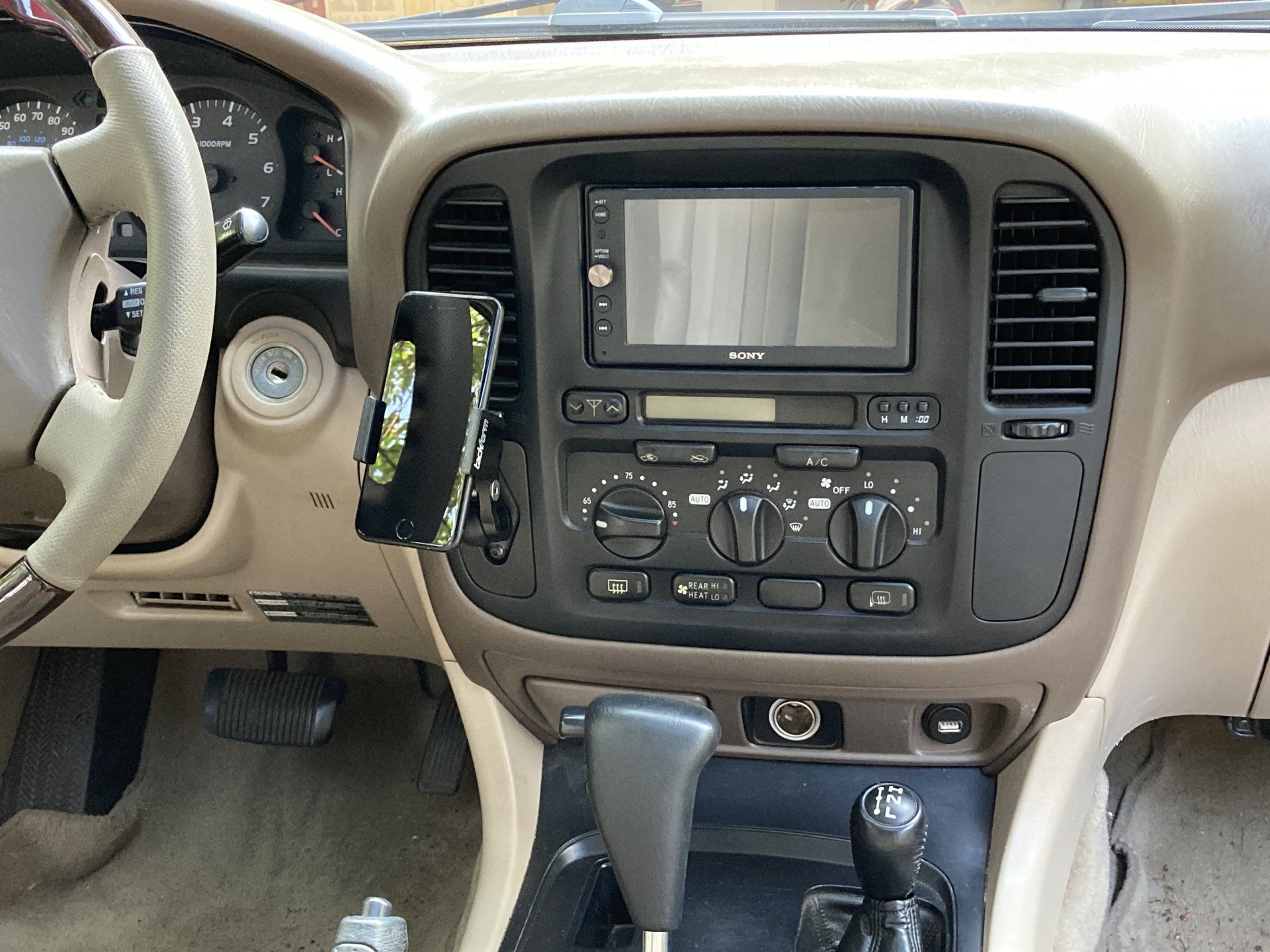

Installed @BenCC’s M2V2 Left Ram Ball mount and a phone holder. Relocated my Hazard and CDL switches to the left side panel. More complicated than it seems... had to re-wire some stuff, add a relay, and modify the internals of the new CDL switch to be push-on/push-off instead of momentary.
View attachment 2367672View attachment 2367673View attachment 2367674
Hazard switch P/N is 84332-26120, CDL switch P/N is 84725-35050.
Ball arm is:
Phone holder is:

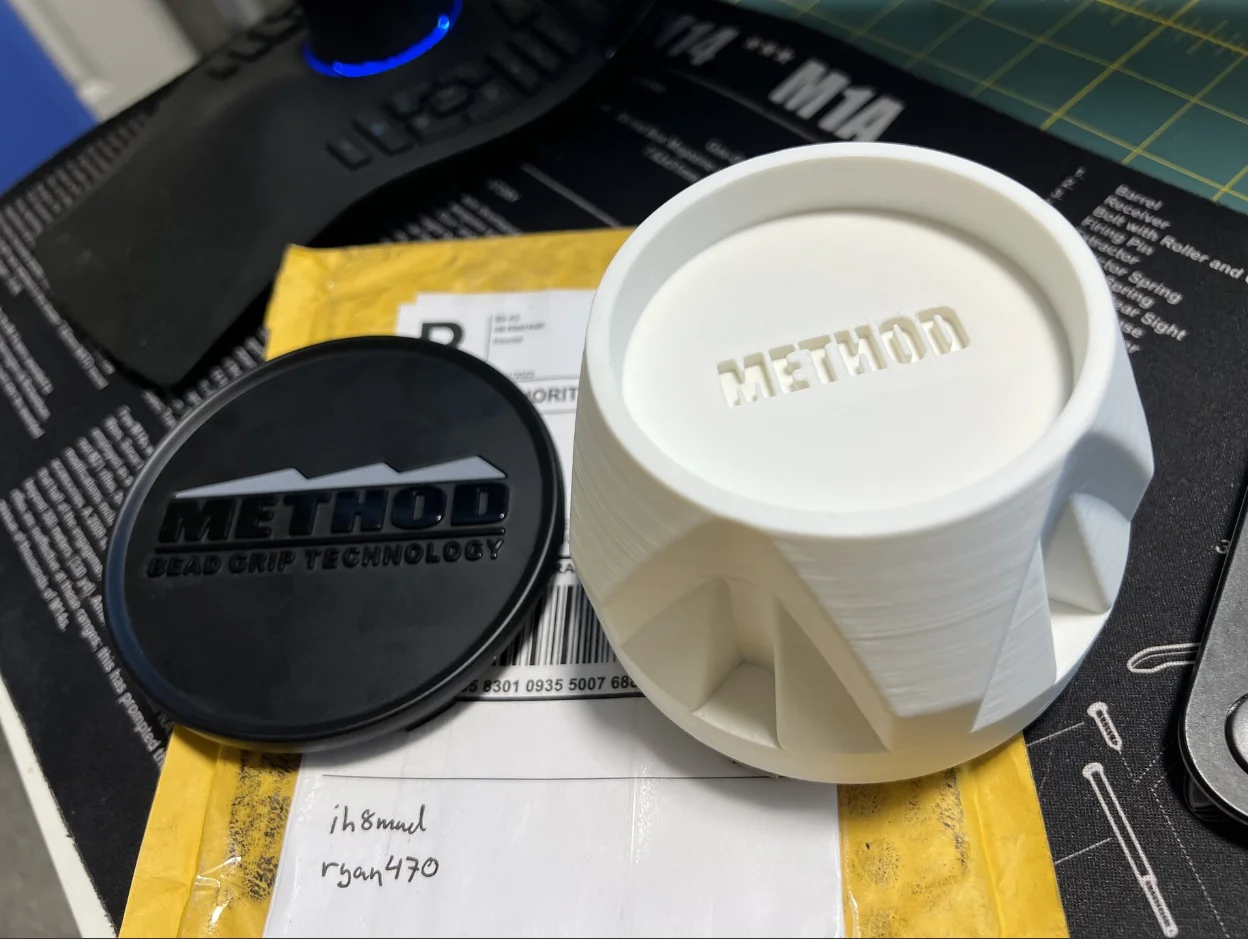

Working with @ryan470 on Method front caps. This is the first prototype. Ryan will test it on his truck.
