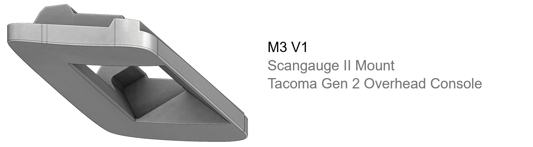

Make 3: Scangauge II Mount for Toyota Tacoma Gen 2​
M3 V1 Scangauge II Mount for Toyota Tacoma Gen 2 Type 1​
M3 V2 Scangauge II Mount for Toyota Tacoma Gen 2 Type 2​

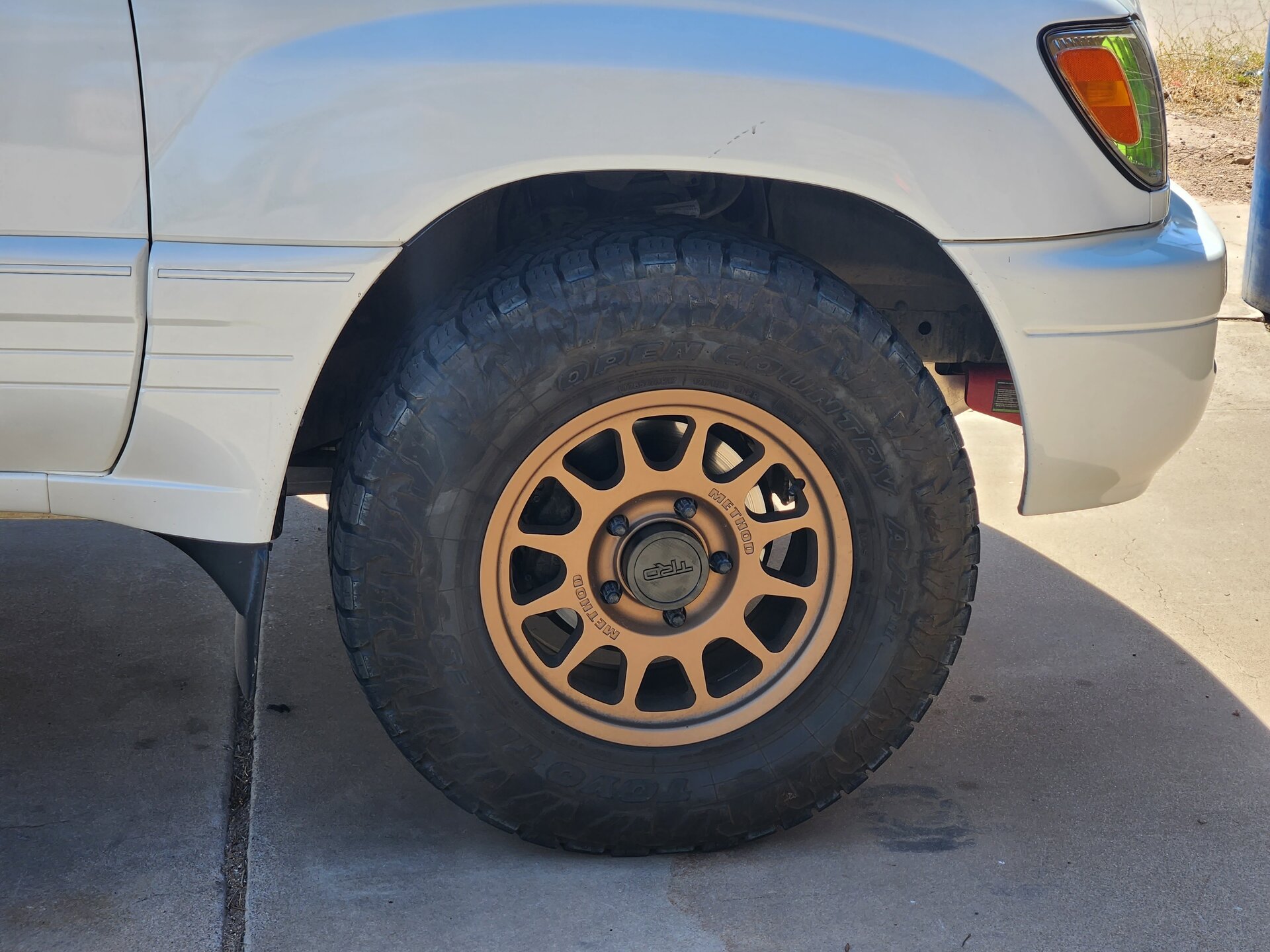

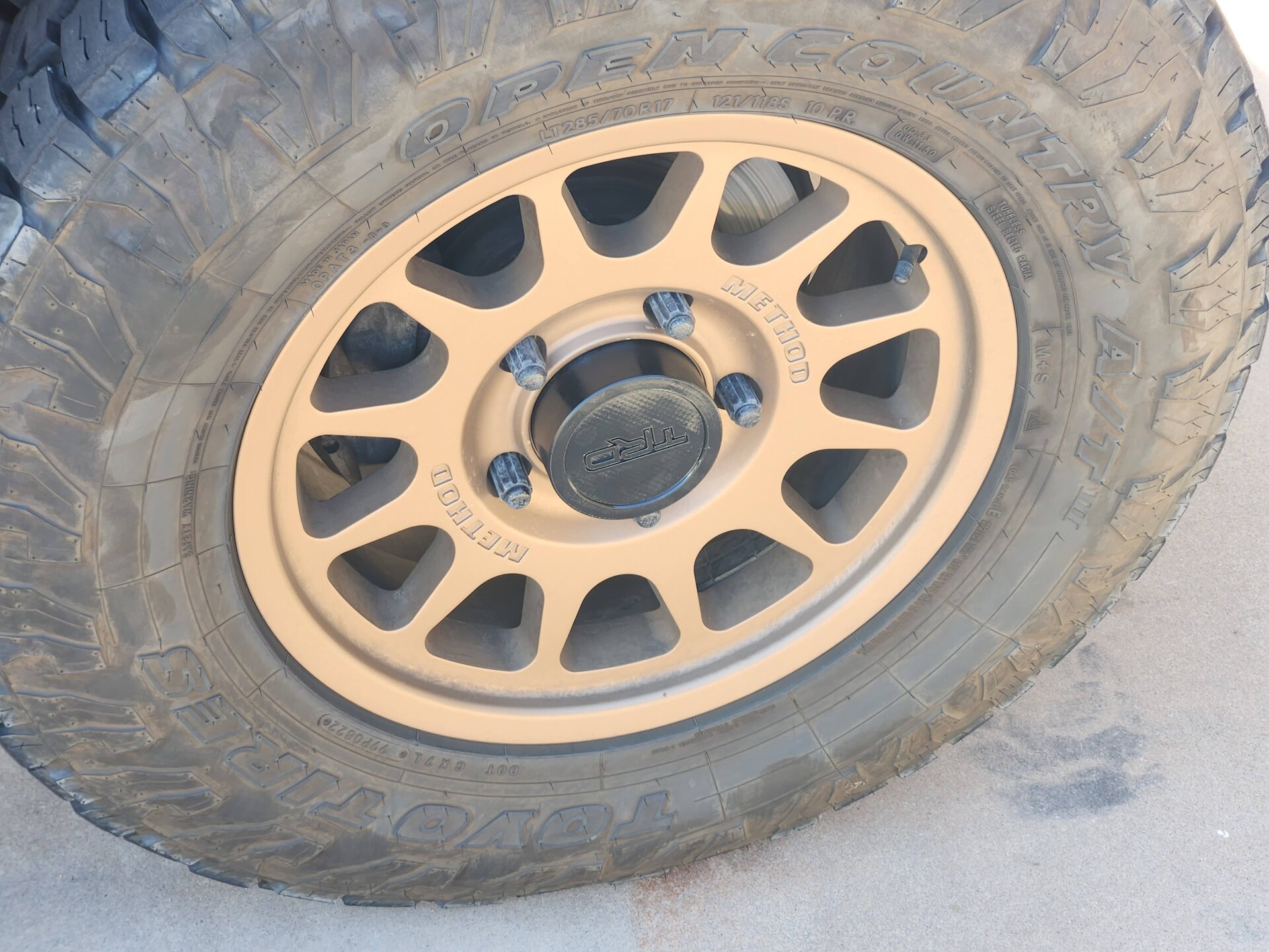

Make 26: Wheel cap for Method NV Wheel​

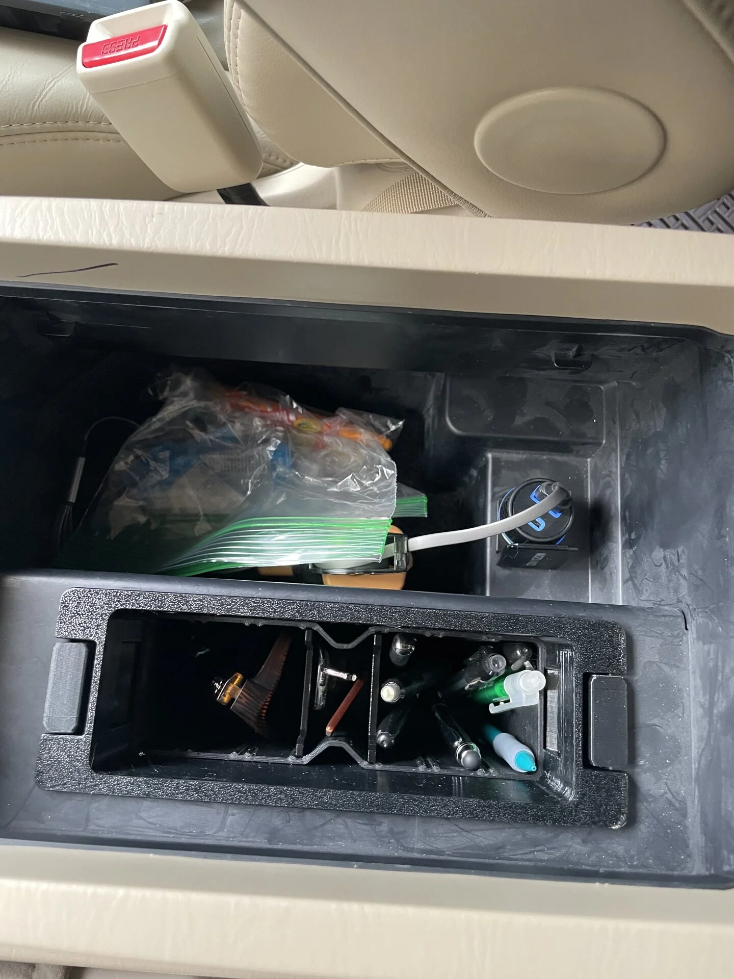

Make 46: Center Storage Deep Hole Utilization​

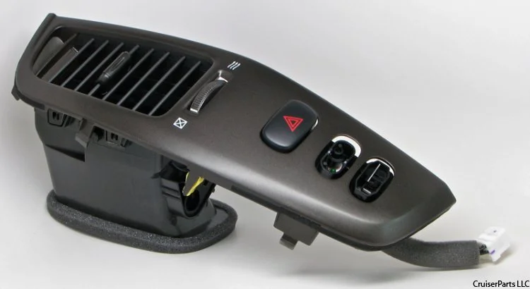

Have you ever been asked or toyed with making the left and right radio trim pieces for 2003-2007 year models? From what I can tell the air vents are removable from that trim piece.
Lots of possibilities there. Could design the lower half of them to compatible with the M2's.

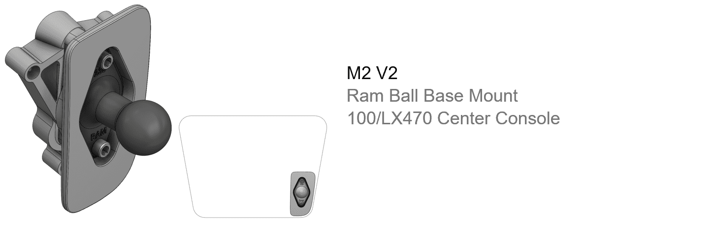

Make 2 V2: Ram Ball Base Mount
1. Overview of the Final Product
This is the final product, M2V2, installed on my truck.
RAM Diamond Ball Base:
Someone else may be interested in a 17mm ball (Garmin standard) that fits the Make 2 Ram mount. Many phone mounts these days use a 17mm ball.
Here is the only 17mm ball I could find with the diamond base. I ordered one and it fits the mount perfectly:

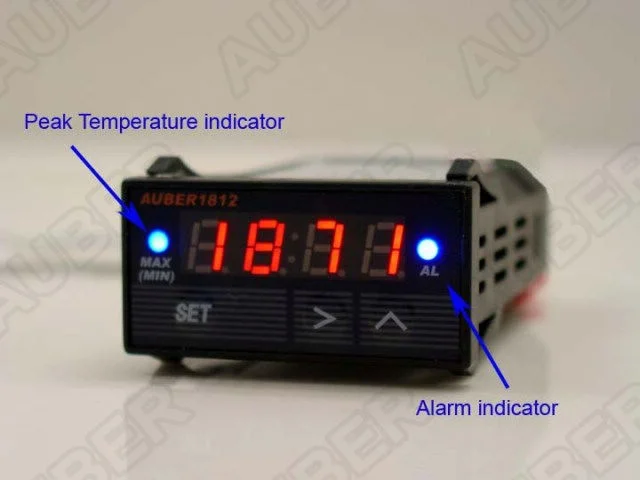

I have been trying to figure out something to neatly mount a 1/16 DIN panel mount EGT for the diesel 105 now with a 1HD, Mister Blue. The unit is from
@cruisermatt found a great location for the unit in the diesel pickup 70 series:
But I am at a bit of a loss for the 100 series. I'd prefer the console or dash rather than the overhead.

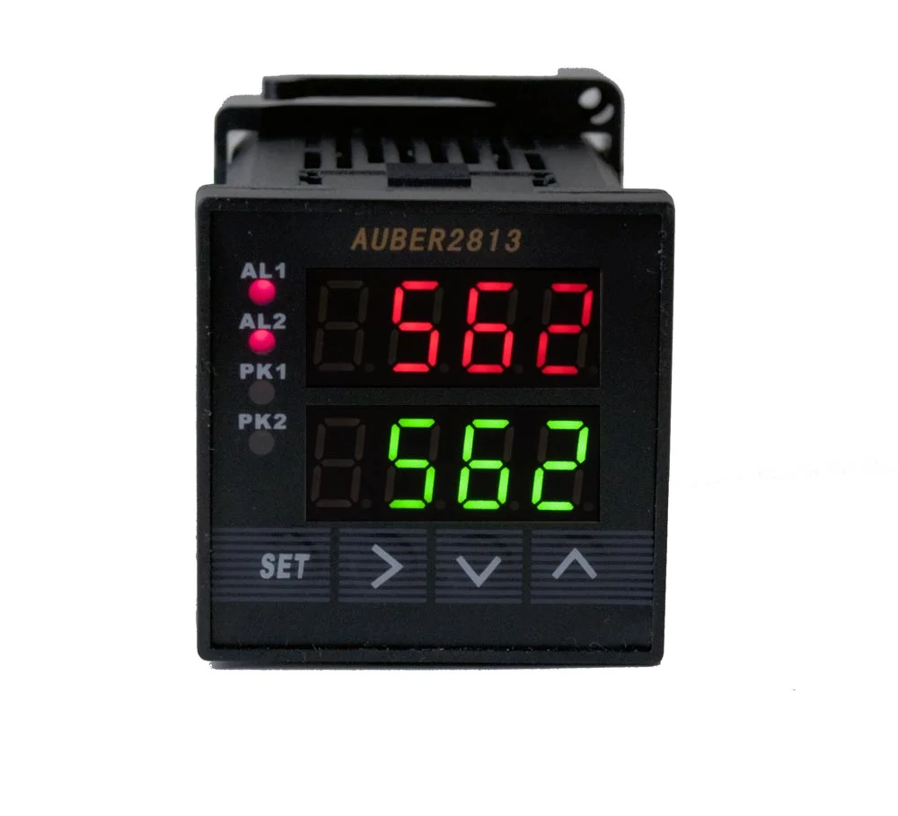

The displays are from Auber Instruments and they make a variety of useful gauges in both 1/16 and 1/32 DIN sizes--commonly used in industrial automation. I'd love to add an accurate digital oil pressure / oil temperature set and an accurate water temp. So ideally the solution would accommodate multiple gauges.
1/16 DIN
1/32 DIN
But I think openings for three 1/16 DIN gauges would work well. They are small, only 48 x 48 x 85mm (1/16 DIN). One of the nice things is that the Aubers' have an alarm output so on the wish list is an additional round opening for a large 'alarm' light, which I think can be ganged together so any of the gauges' alarms would turn it on to attract attention.
