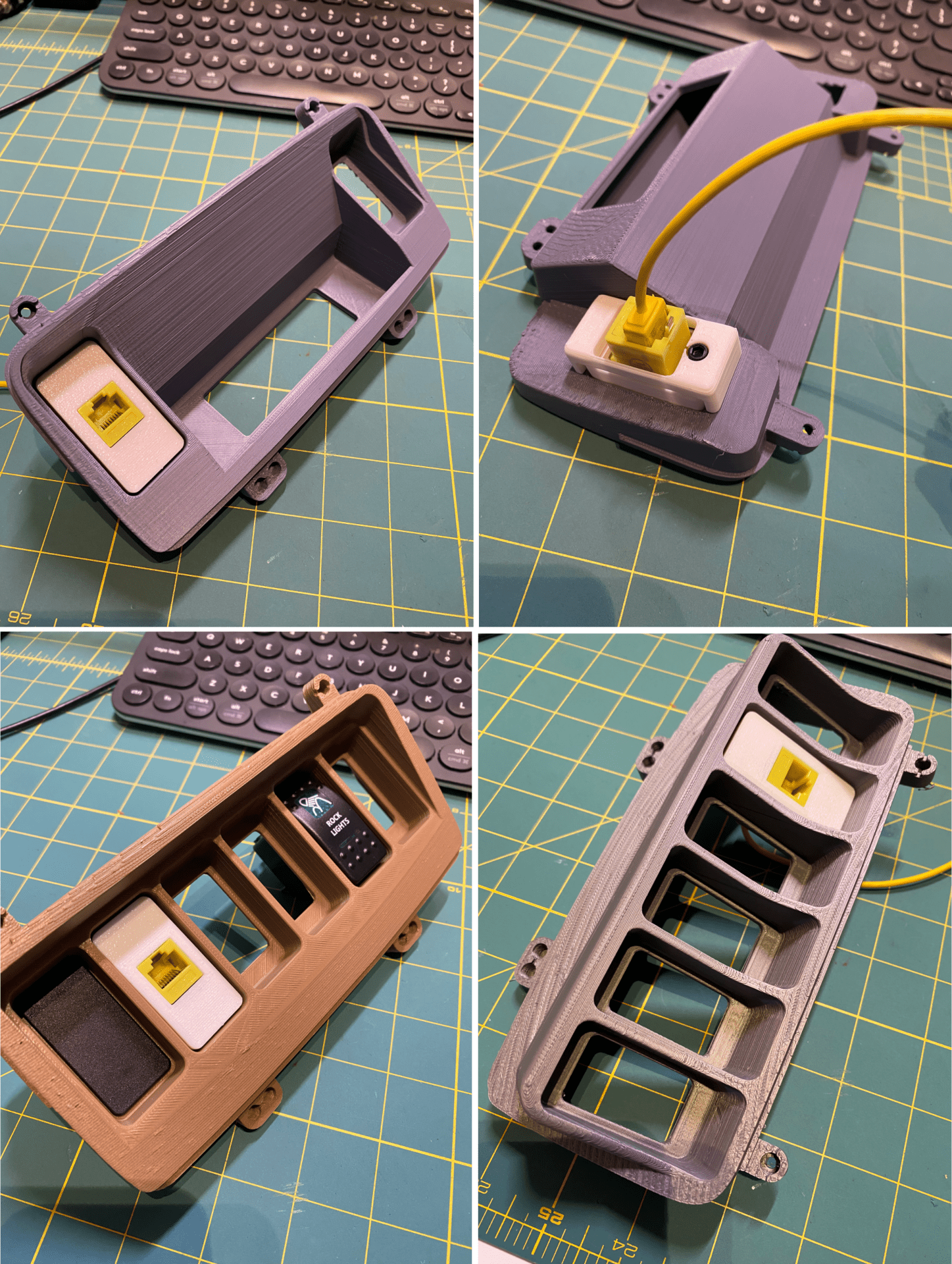

@BenCC .... have an idea about a mod to the overhead Scangauge mount. Mic on one side (already available) aaaaaannnnnnnddddd a mount for a Cat5 plug! I want to mount my GMRS radio (MXT275) in the back of the cab and then run a Cat5 line all they way through the cab, up the A-pillar and into the overhead console where I could have a Cat5 plug. I could quickly plug in the mic when on trails and then unplug it and stow it in the armrest when daily driving. I prefer the mic up high.
Phototyped. The coupler snaps in really good. Final product will be printed with black PETG.

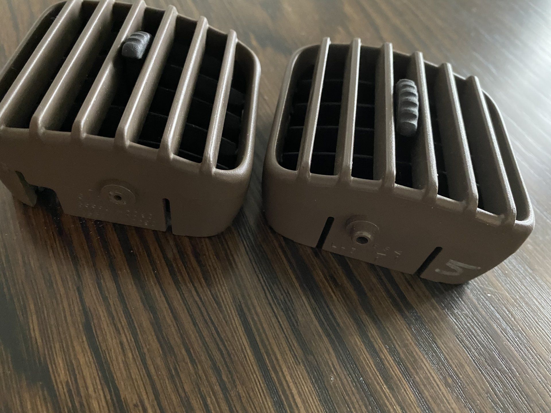

Hi Ben-can you design a fix for broken tabs on our 100 series vents (see picture). Those little tabs over time break off from heat and use. Maybe you could sell them in a 10 pack just to have on hand for fixing or aging cruisers. I can send you a vent to make a prototype.
How do you get those out? Withouit breaking them!

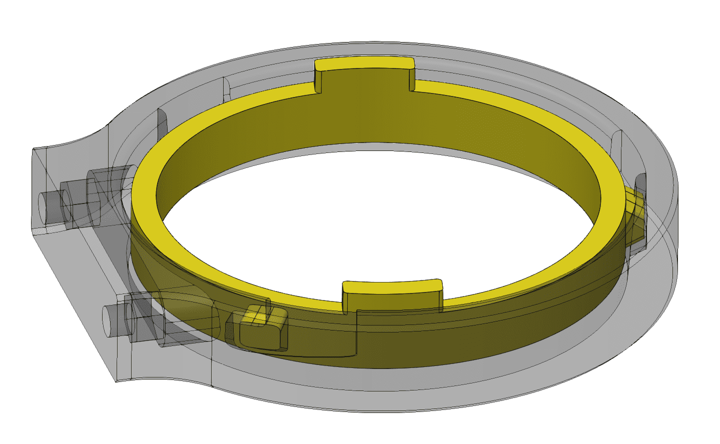

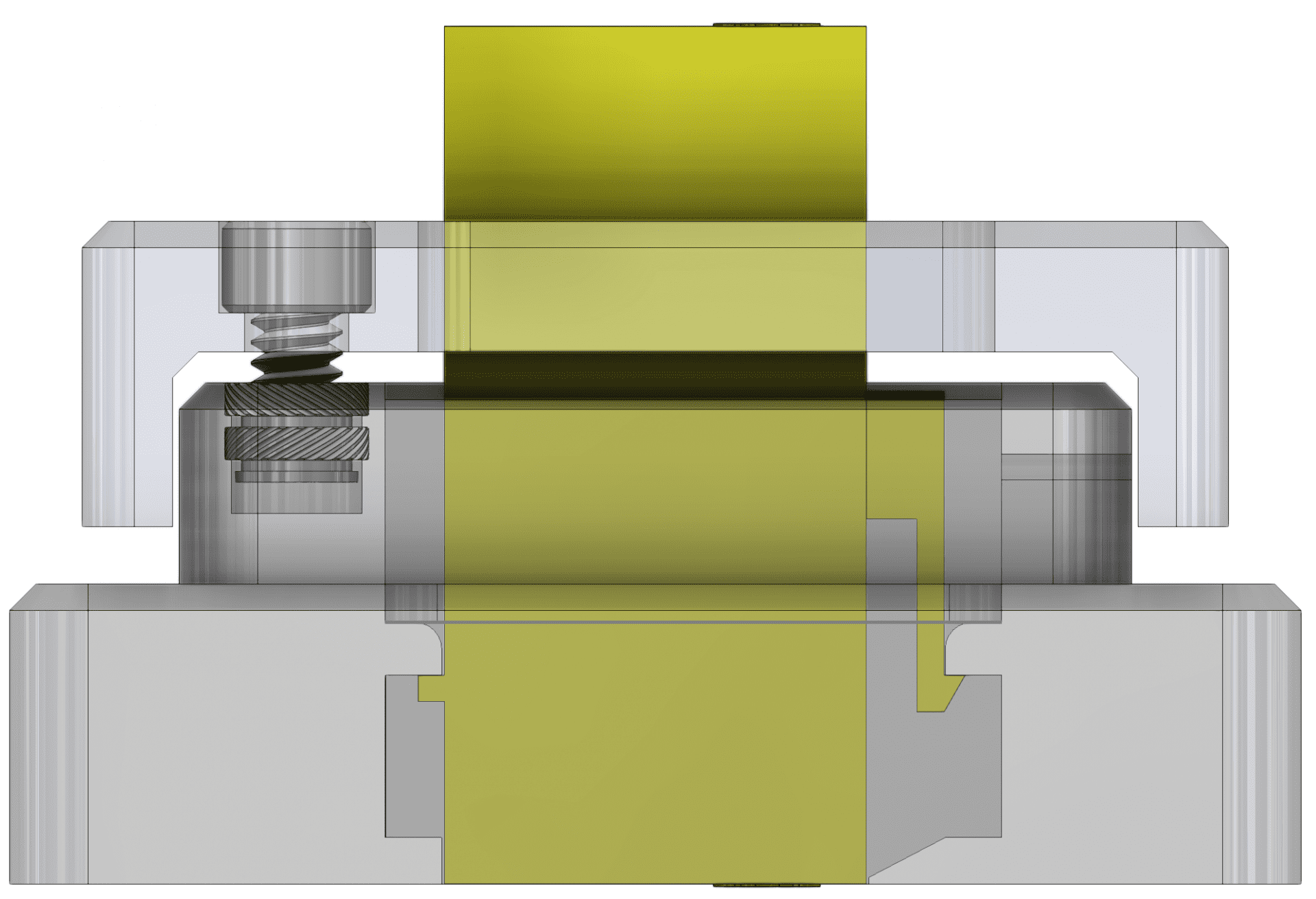

I think I come up with an adaptive/adjustable cupholder design. Basic idea is to use replaceable locking insert to accommodate different sizes. Click the video.
Planning to have two to three different sizes of inserts holding from very small to very large cups.

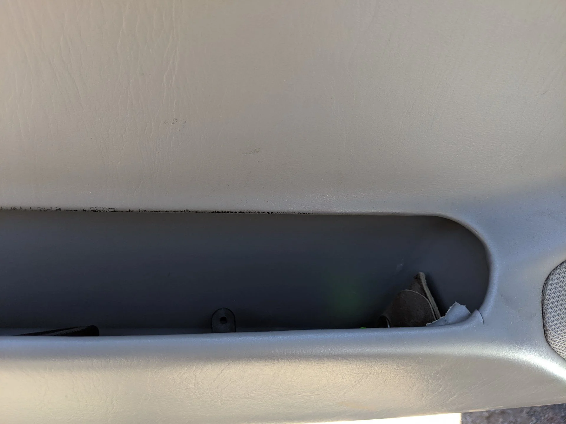

Hey Ben, how about producing something to fill part of the door slot: a) to store small items and b) to keep the slot from compressing and eventually cracking. Happened on my last truck and it's starting to happen in this one. Just a thought.
Great idea!
