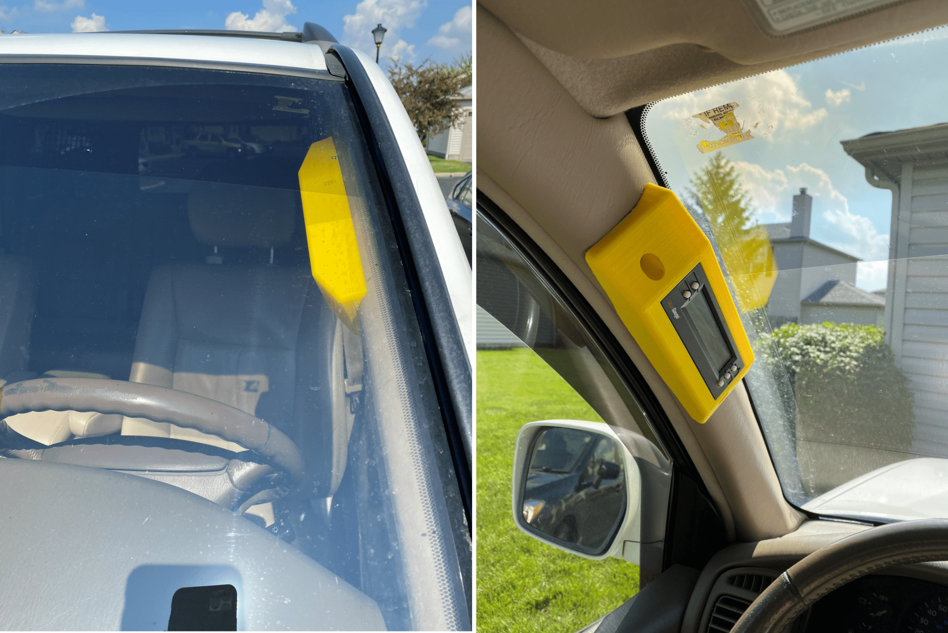

Great looking product. Will probably be contacting you soon.

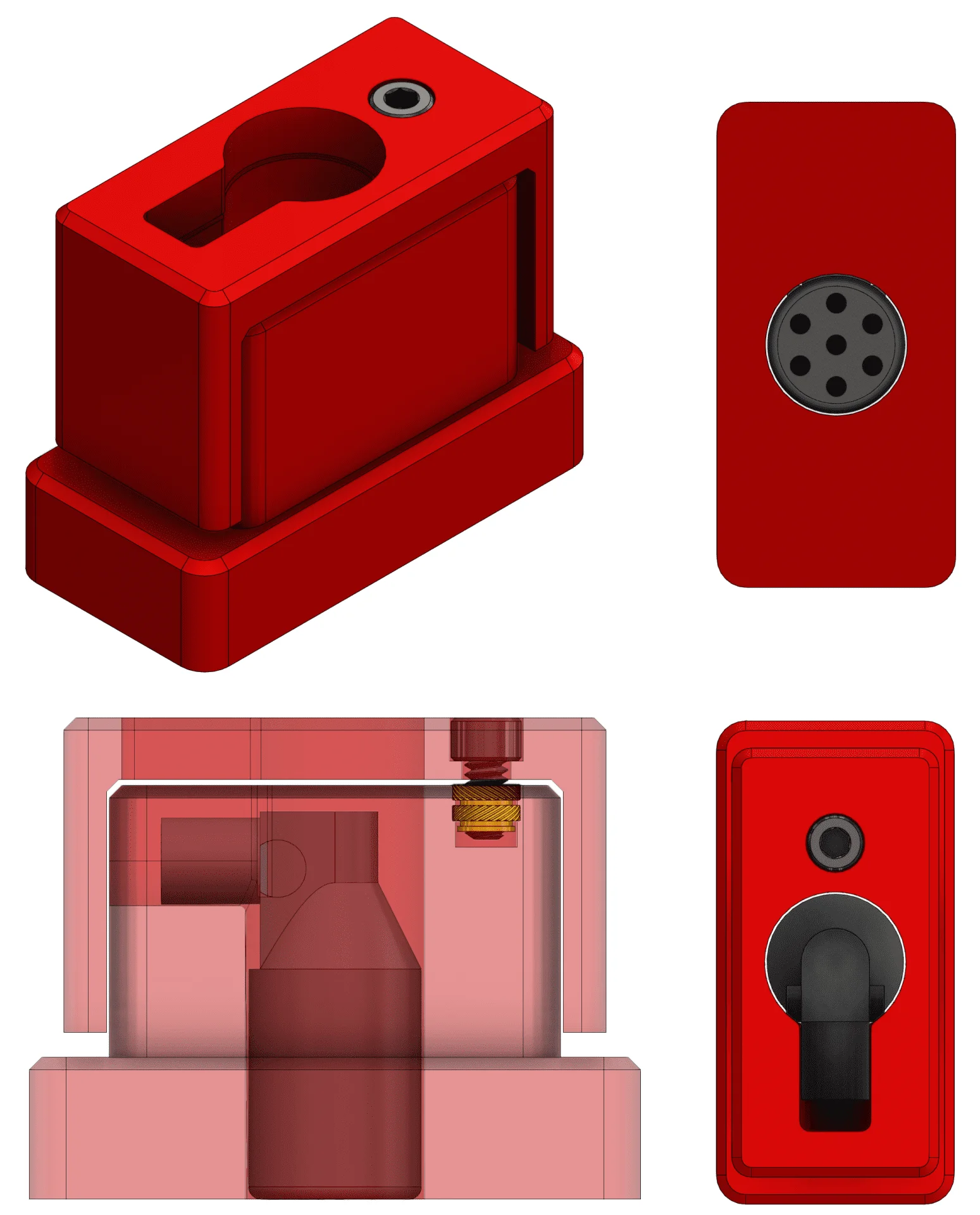

The amazon link didn’t direct me to the specific mic you used. Can you post another? link?
The forum seems to be removing the specific links. Just tried to post the link myself.
Search Amazon for "FingerLakes 3.5mm". It should be $9.99 + shipping.
This one??
Just press quote or reply to the message and copy and paste this part into the Amazon search box.
[ MEDIA=amazon] B015KY5J7Y [ MEDIA]
FingerLakes 3.5mm Microphone Assembly Mic for Car Vehicle Head Unit Bluetooth Enabled Stereo Radio GPS DVD
MUD does weird things to Amazon links. The links work if you use the Insert Link button though.

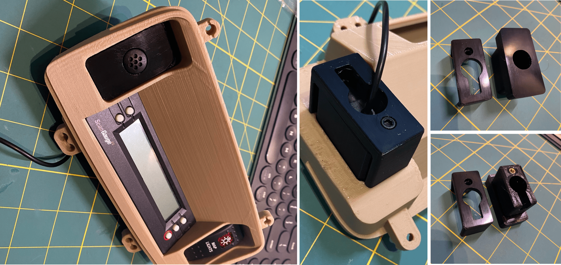

First picture. I like it! 👍

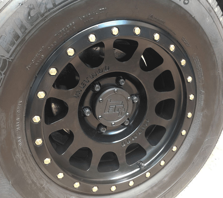

Fitting and fasteners are all good?
The fasteners are great. The fit is perfect. I'm cleaning up some of the mess I had with the other caps. I had to use RTV inside the caps to seal up gaps on the old caps. These are much better.

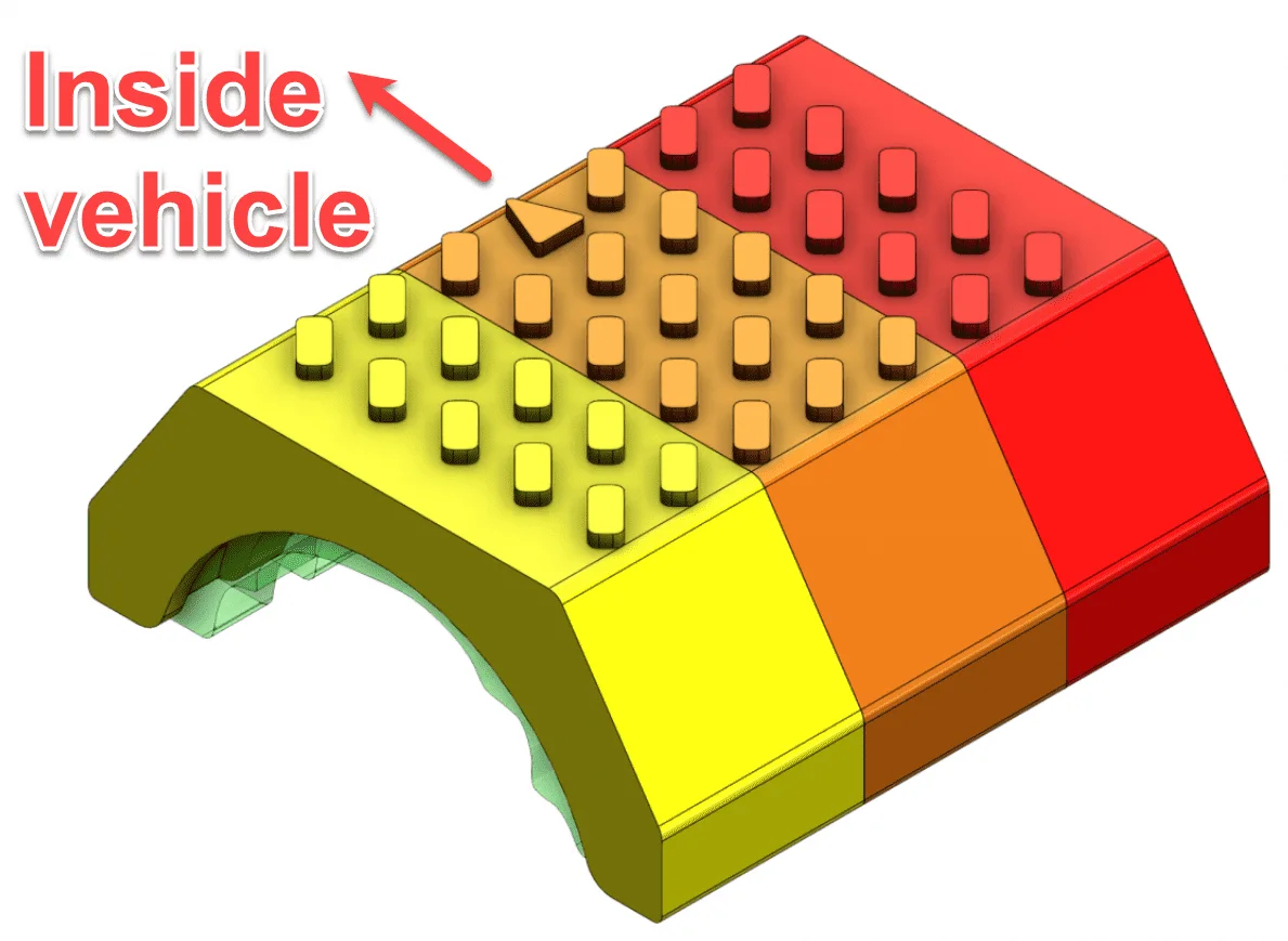

1. Overview
Photo credit @jlm43

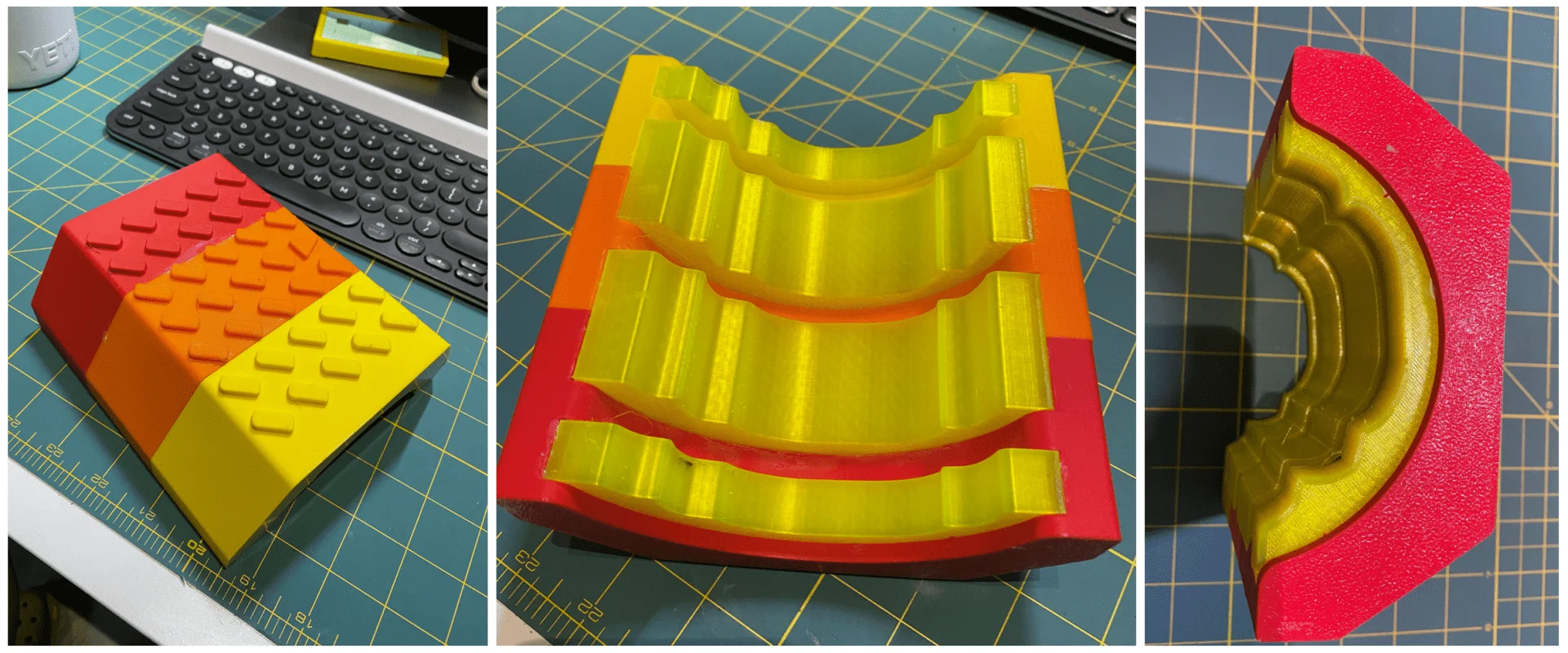

2. Material and fabrication
The liner(yellow) is printed with the same material used to make the facemask tensioners. The soft material is used to protect the door trim and paint. But it is not too soft so the white hard plastic part will not be in contact with door panel under load. The maninbody is printed with PETG.
The mainbody is glued from three parts. This makes the assembly much tougher than a single print. The liner is also glued to the inside of the mainbody.
3. CAUTION
Set the step properly on the door trim with the triangle pointing to the inside of vehicle.
Always face the vehicle when climbing or descending.
Always hold the roof rack with at least one hand.
Step at the center of the step.
Do not carry loads that might make you lose balance.

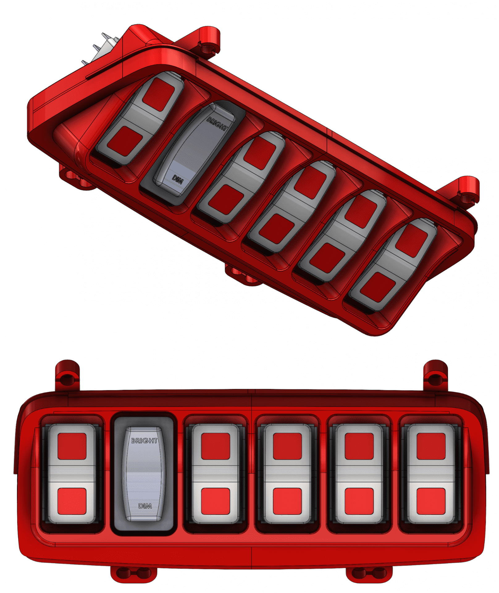

Oooooh! This is pretty neat. I'd probably think of some other things to put in there but the mount is nice. How deep would rocker switches be vs the SG? Could they be a thinner profile?
Rocker switches are thicker than SG actually. Have to leave space for the terminals and wires.
Realized that I have never posted this make.
Make 4 V4: Rocker-switch DEEP Mount with one slot for LED dimmer for Toyota Land Cruiser 100 Series
1 Overview of the Final Product
2 Purchase List to Complete the Installation
Rocker Switches
Panel Plugs
Dimmer:
https://www.carlingtech.com/sites/default/files/documents/LD-Series_010713.pdf
Search "Carling Dimmer" on ebay.
Video:
The flickering is only in the video. I cannot see it with my naked eyes.
Wiring diagram:
3 Purchase
$75 + USPS Priority. Printed in tan or grey ABS or PETG. PM for direct Paypal payment.
50% discount if you purchased M4V1, M4V2 or M4V3.

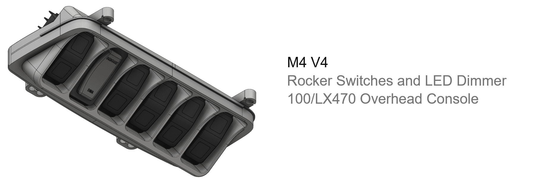

Rocker Switches
Panel Plugs
Dimmer:
Video:
Wiring diagram:
3 Purchase
$49 + $7.9 (USPS Priority). Printed in tan or grey ABS or PETG. PM for direct Paypal payment.

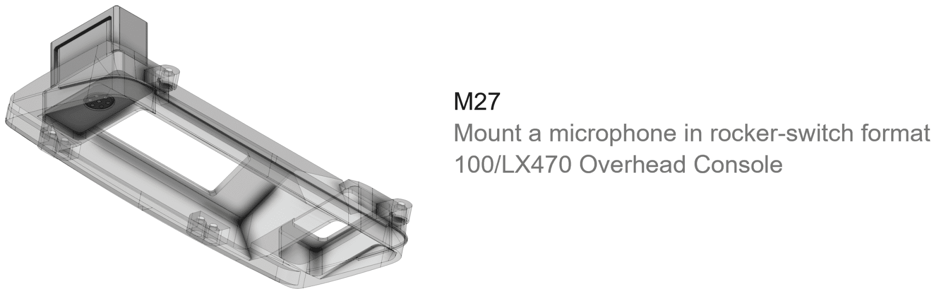

Aww man. That would’ve been a great idea for the second switch blank on the mic/Scanguage II build. Ah well, great idea though!
