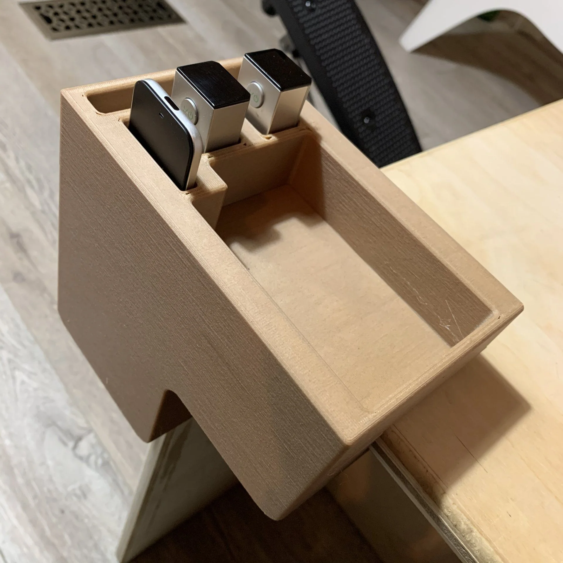

Make 7 V2 is finalized. I am taking orders.

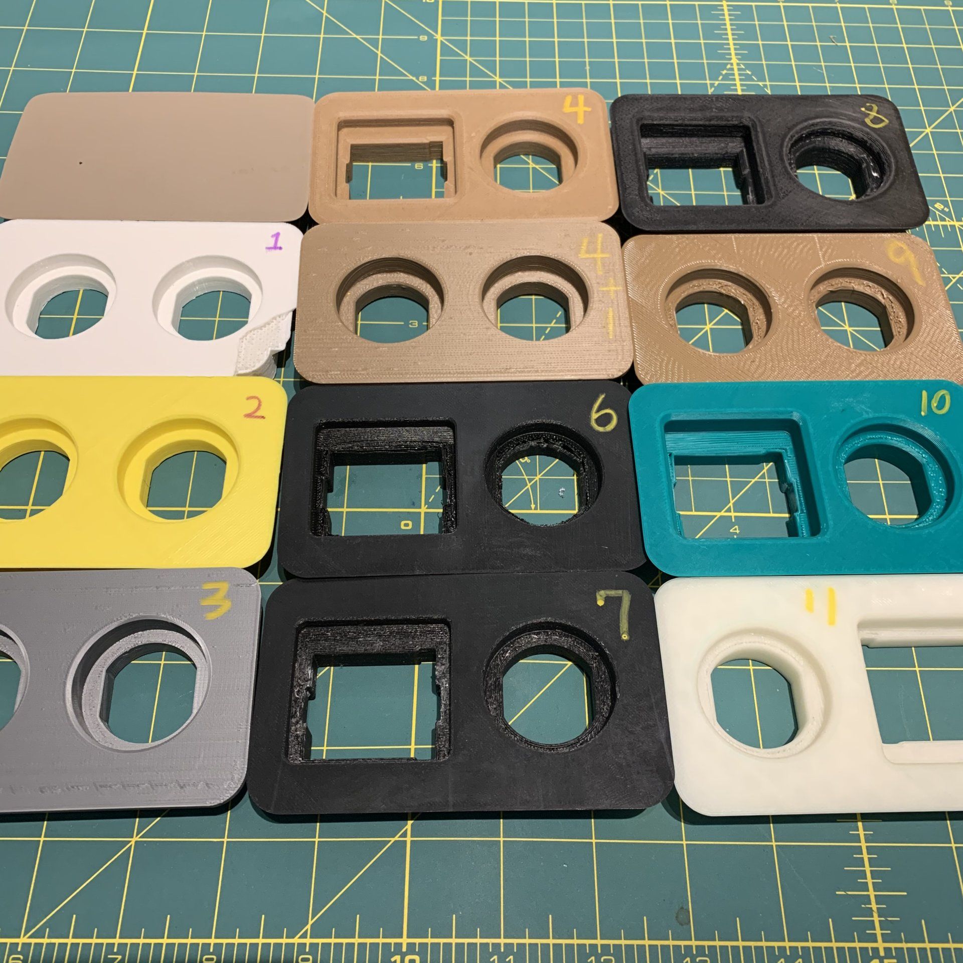

Multiple prototypes have been made to test the dimensions, surface printing method, and materials, etc.

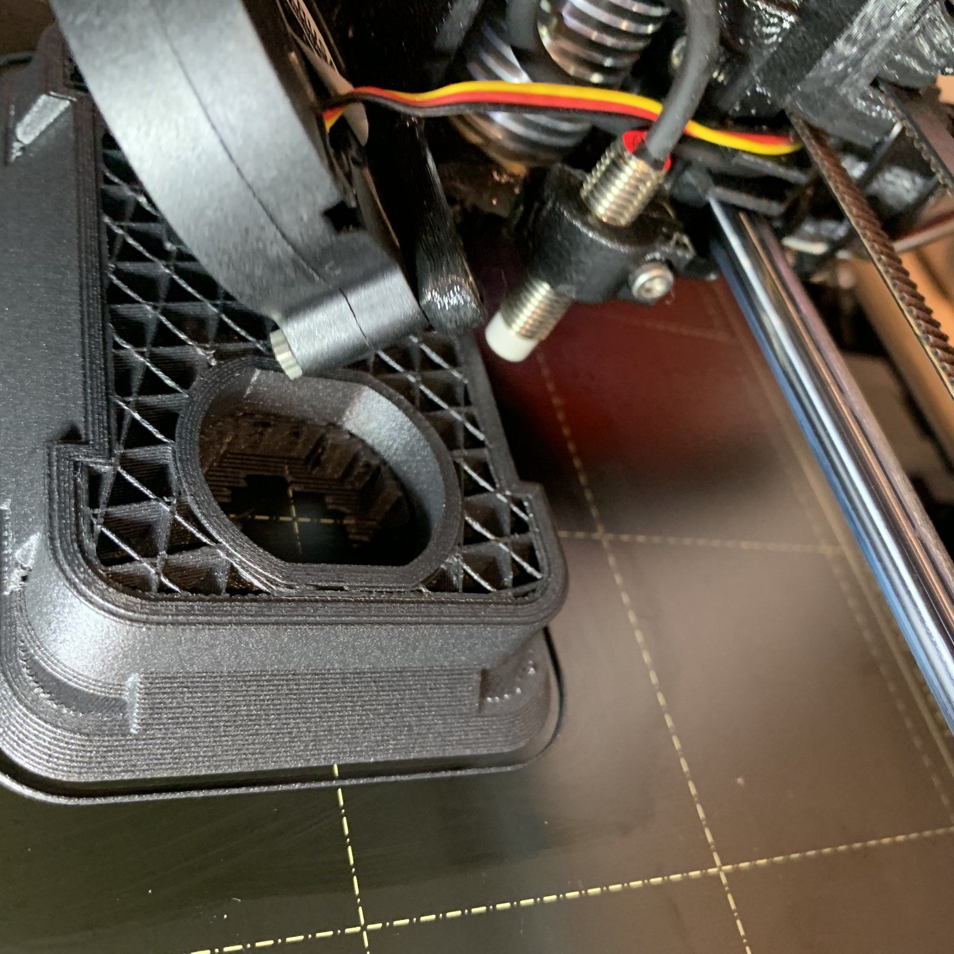

Being printed with carbon fiber PC.
PM for direct paypal payment.
$19 Print in ABS (Tan, Grey, Black)
$29 Print in Carbon Fiber Polycarbonate (Black)

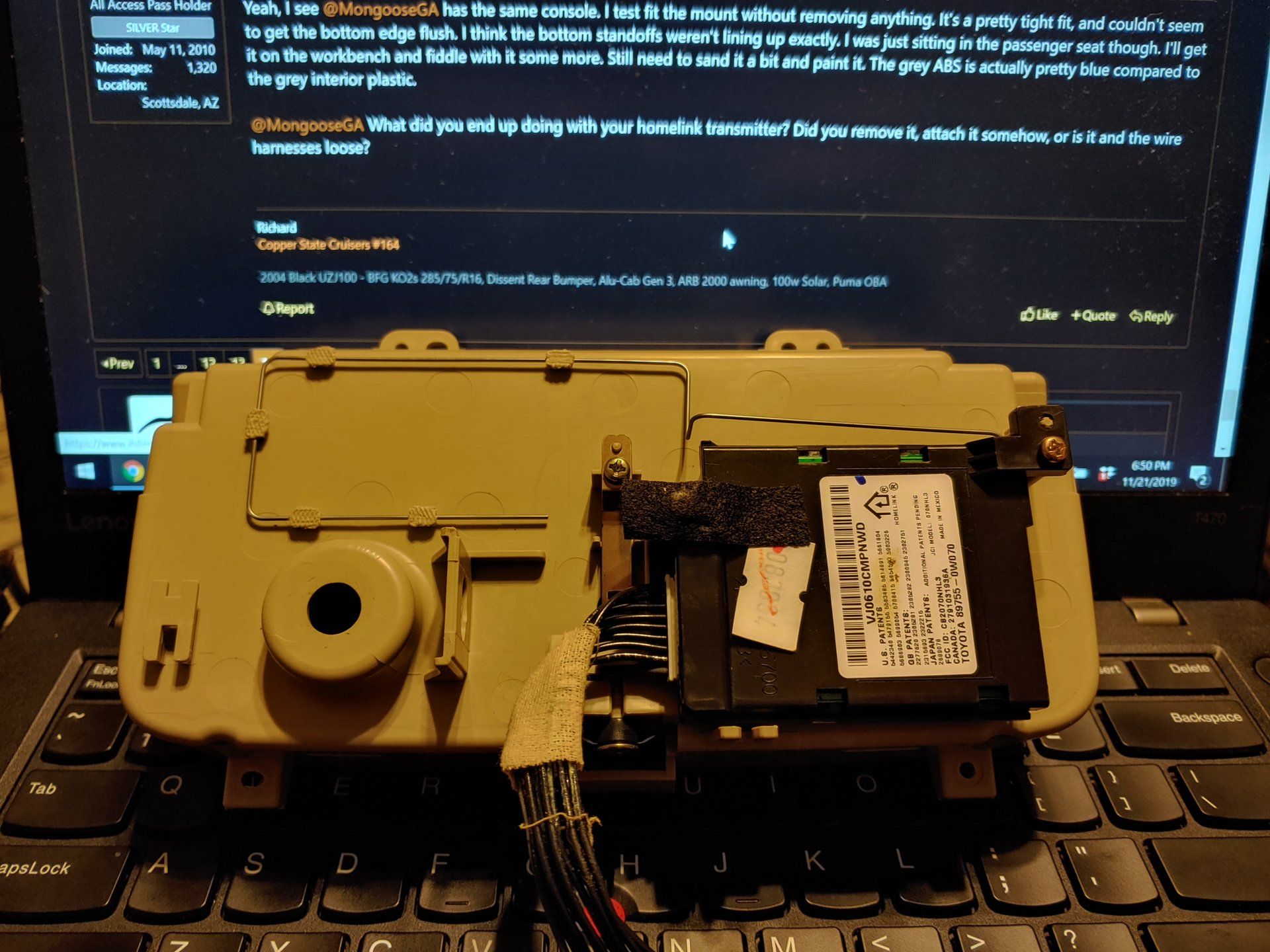

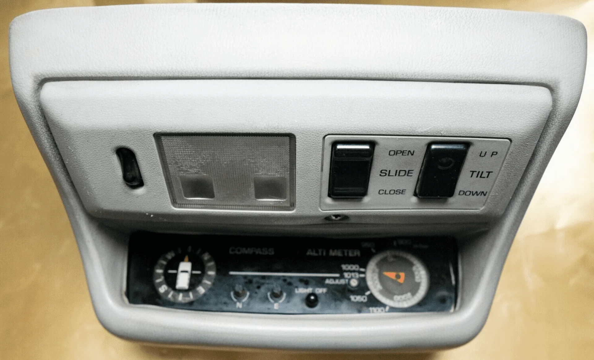

Sorry to say I won't be much help here. I took it off completely with the sunglass holder. (For sale, by the way. Perfect operation and condition. PM if interested.)
The other connections you're seeing are most likely for the console lights or sunroof controls. I reconnected everything besides the homelink system and everything works just fine in the console.

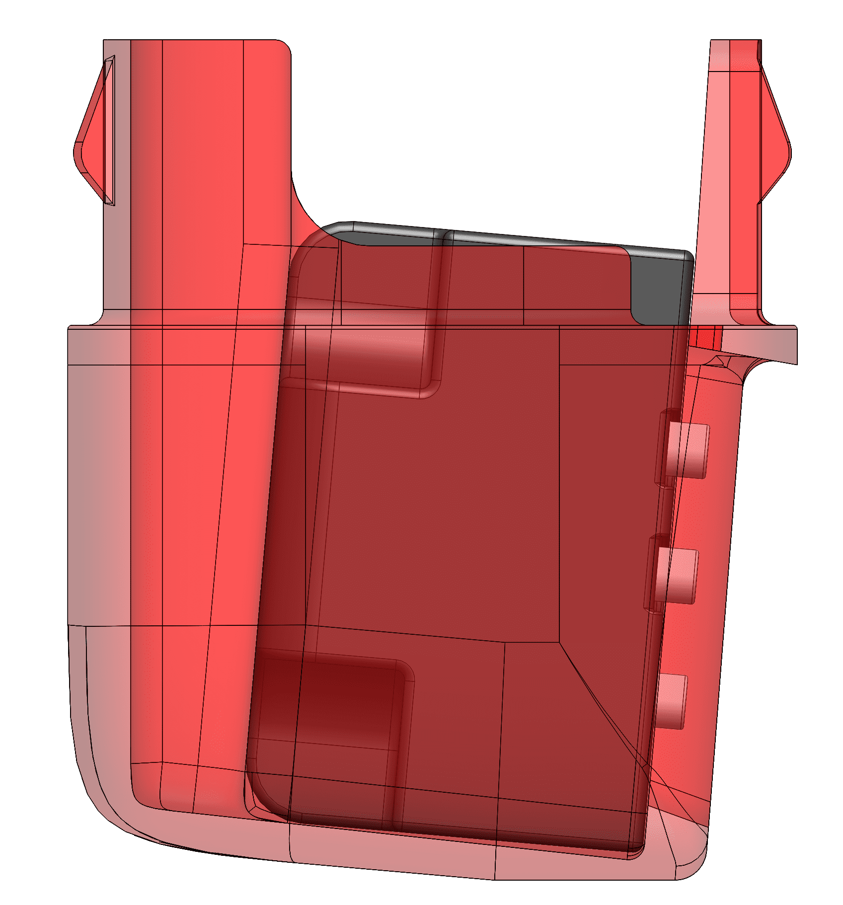

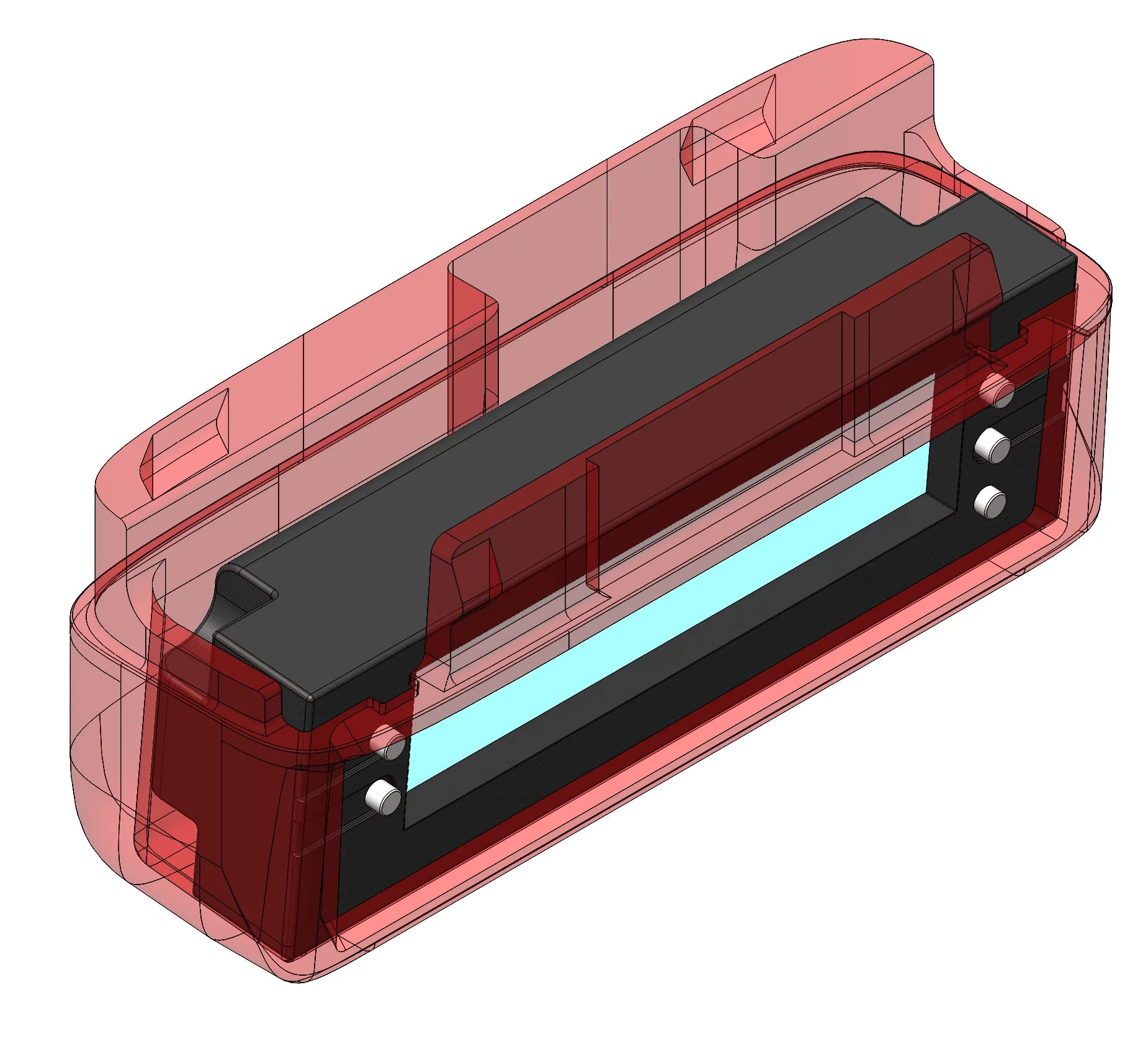

Update on the Scangauge II mount on the mini Homelink console.
Ignore the rough surface. For now, all prints are done in the fastest way with no care on surface finish.
The opening is small. Although you can insert the scangauge in there like @Jczajka showed in the following photo, designing a structurally rigid mount to securely mount is another story. There is basically no space left between the scangauge and the overhead console opening.
The goal is till to make a mount that looks factory. I made a brief survey and this one popped up.
Inspired by the overhead console on 80 series, the scangauge is placed almost vertically (10 degrees offset angle precisely speaking). The scangauge slides into the mount, and the mount is connected the overhead console.
Let me know what you think.

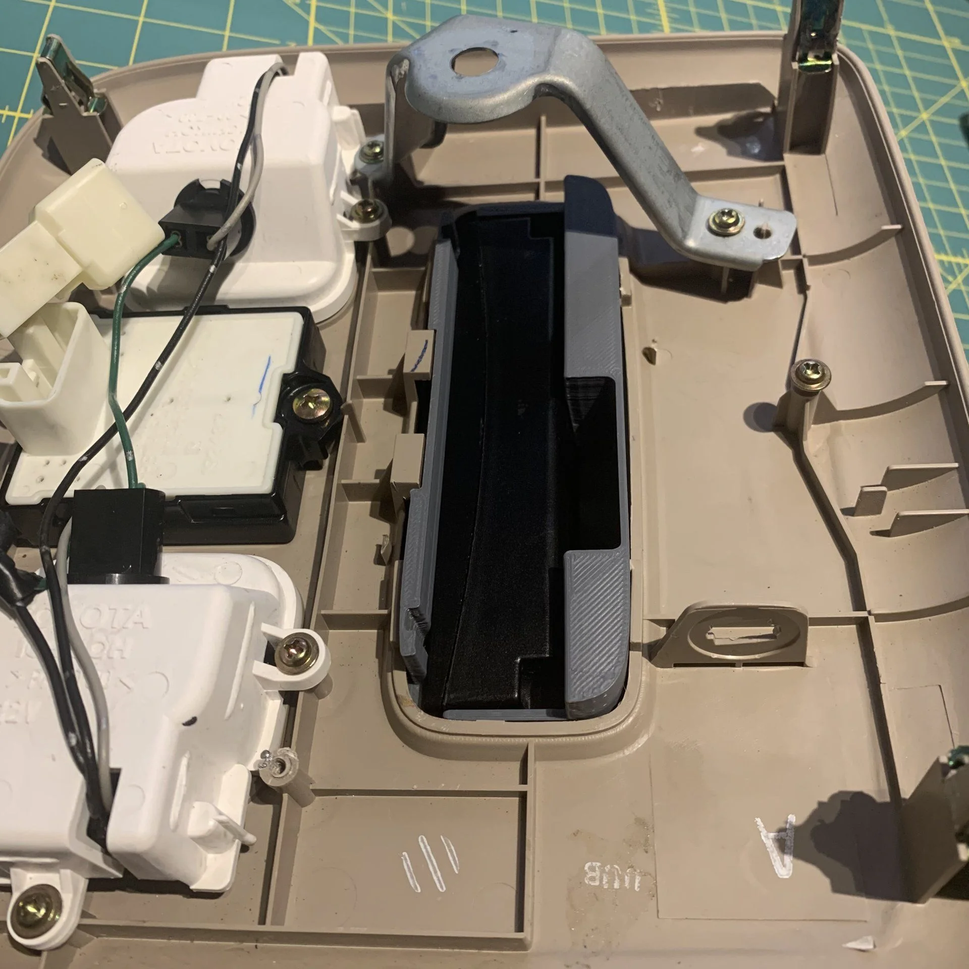

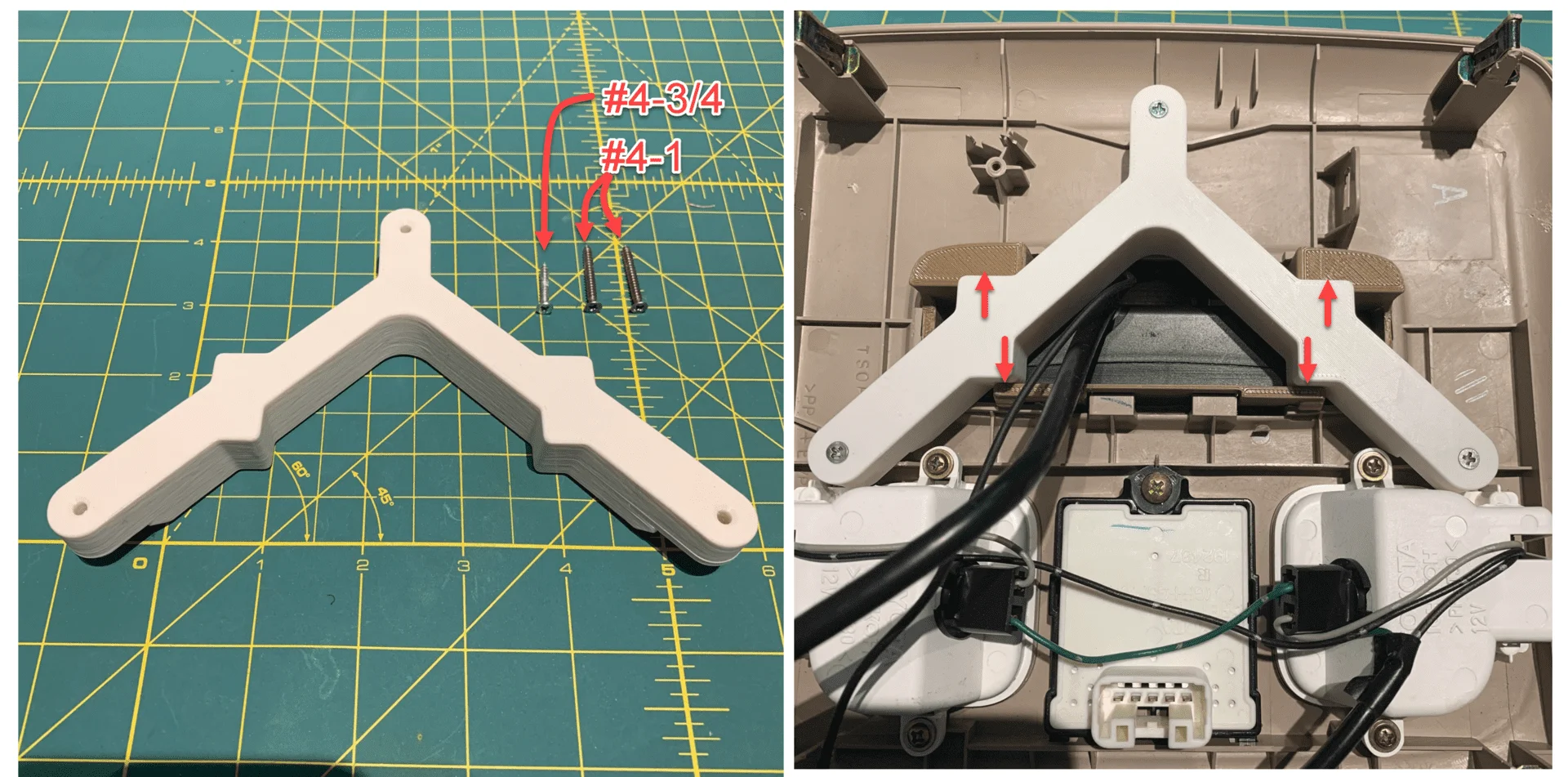

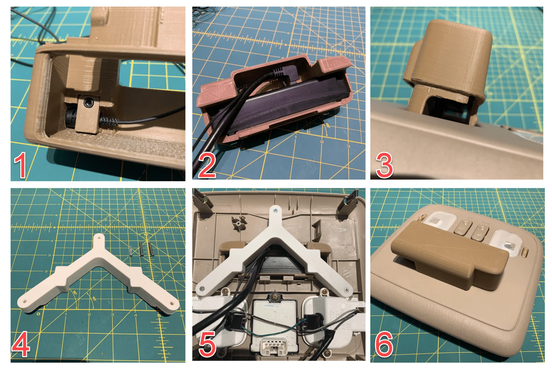

Original plan was to attach the mount to the overhead panel through snap fit. But I don't think it is secure upon inspecting the prototypes. I added a "wishbone" bracket to mate with the overhead console utilizing three existing holes. The wishbone enhances the security of the snap fitting. No rattle at all.
Steps of assembling.
1: Secure the microphone.
2: Attache the Ethernet cable and slide the Scangauge II in the mount.
3: Snap into the overhead panel.
4: Have the bracket ready with screws.
5: Attach the bracket as shown in picture and tighten the screws (One #4-3/4 and Two #4-1, included).
Note: Don't over tighten.

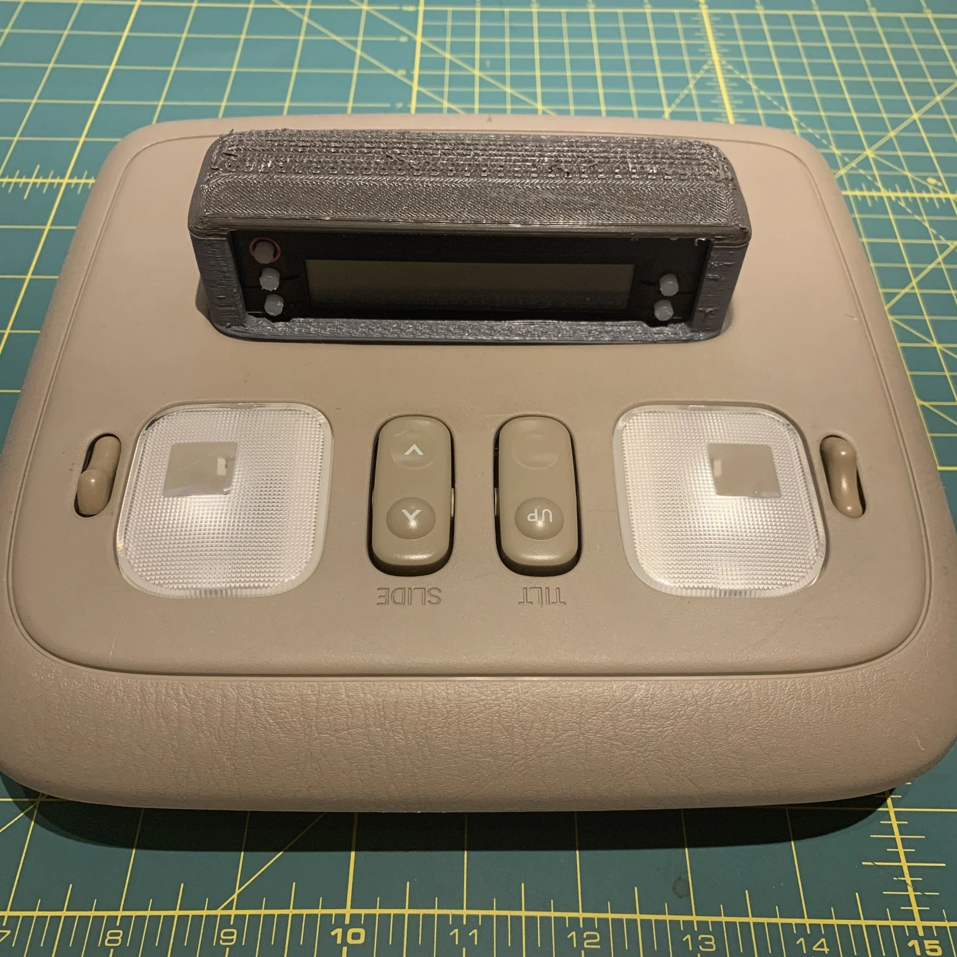

6: This is to show the complete assembly. No wires are visible.

That's sweet!
Might block the mirror a little is my only concern. I could see the bottom of the Scanguage in the mirror when I had it just jammed in there.
It will be nice to have it solidly in there now and the built in mic is super cool.
Note: there were two little cross members that span the the short side on the opening, that I cut out. Just snipped them with some cutters.

Yes I have that concern too. I will try it on my truck.
