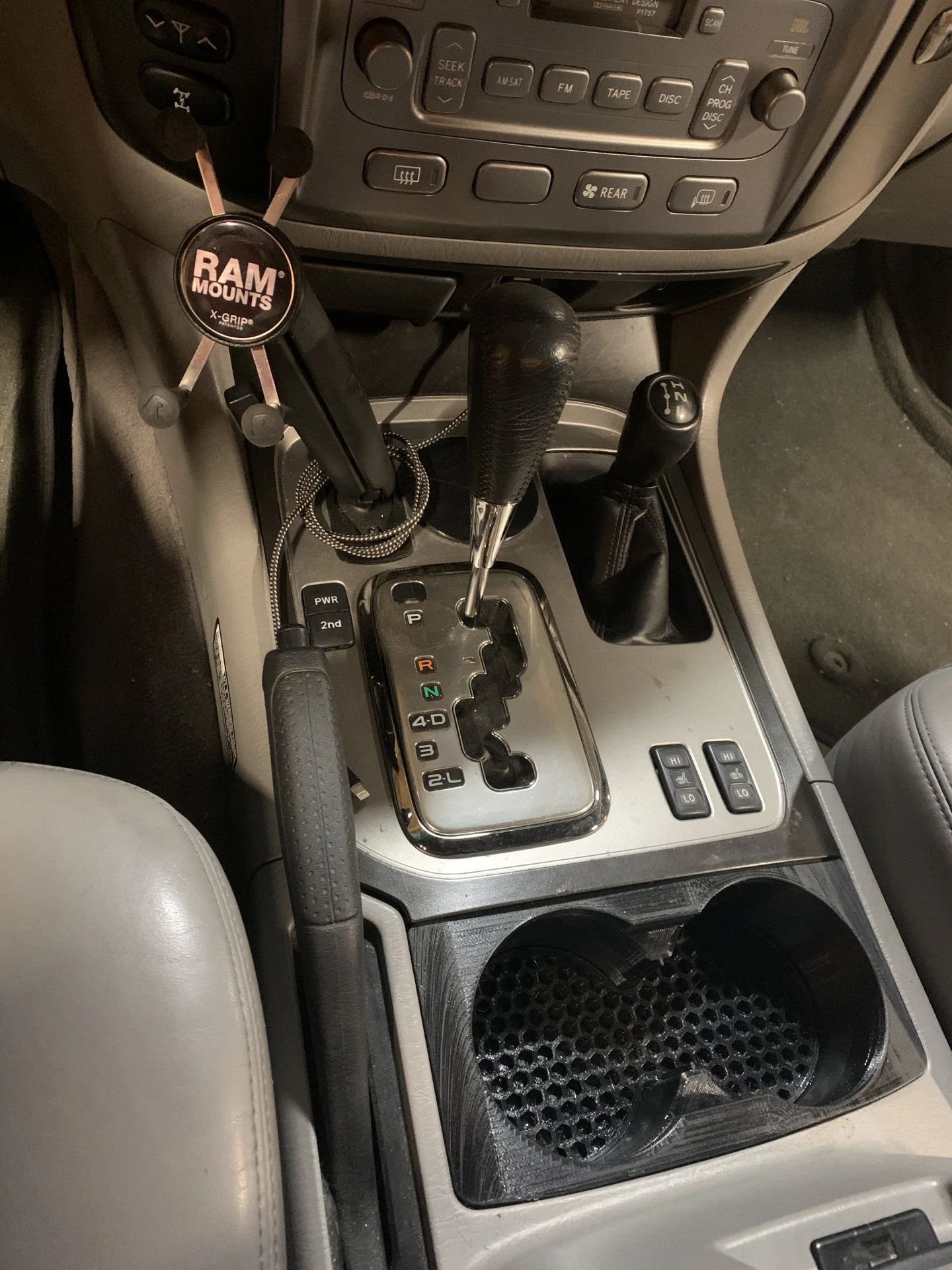

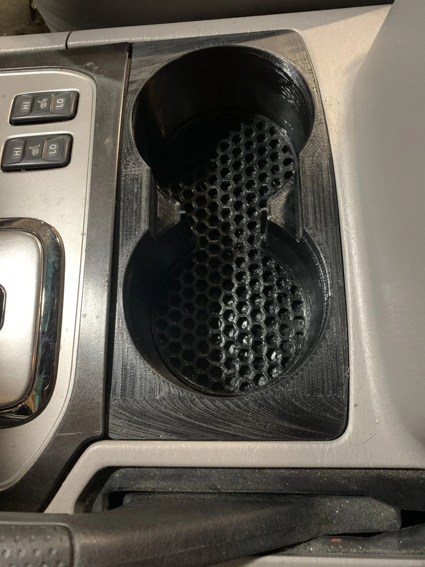

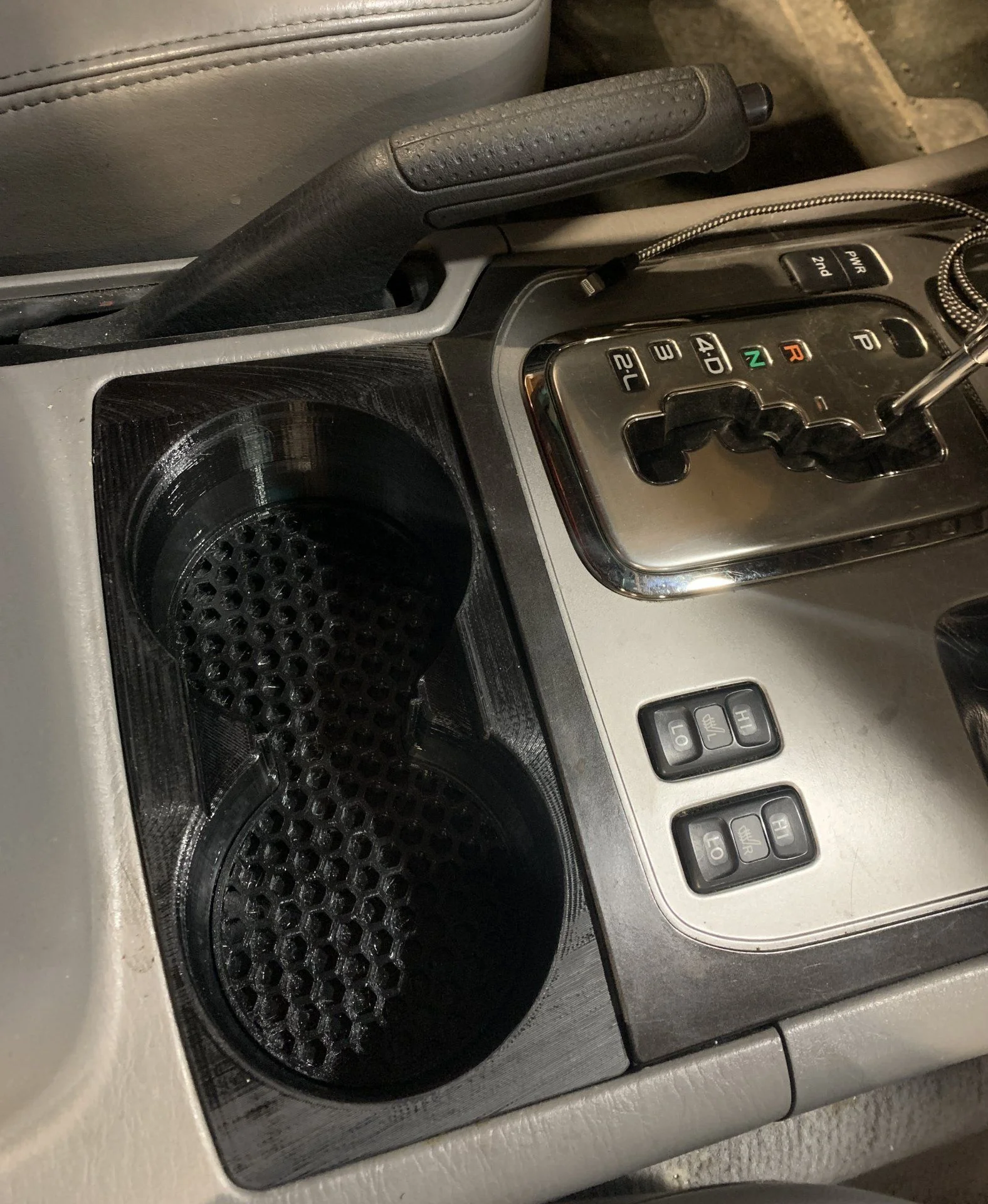

Also, since have been running the prototype cupholder for Ben all these months, I am happy to say that I have never noticed the bottom of my cups getting hot (did a 3hr wheeling trip yesterday) nor is there any oddities or anything that I can report. She is as solid as the day I installed her. Ben was nice enough to send me out a finished version of the cupholder (mine still had the phone/pen slot) with the pads so when I get a minute this week I will install that as well. I am sure there will be more random odds and ends from Ben in my future...
I appreciate your comments on the cupholder. It helped a lot shape the final version.

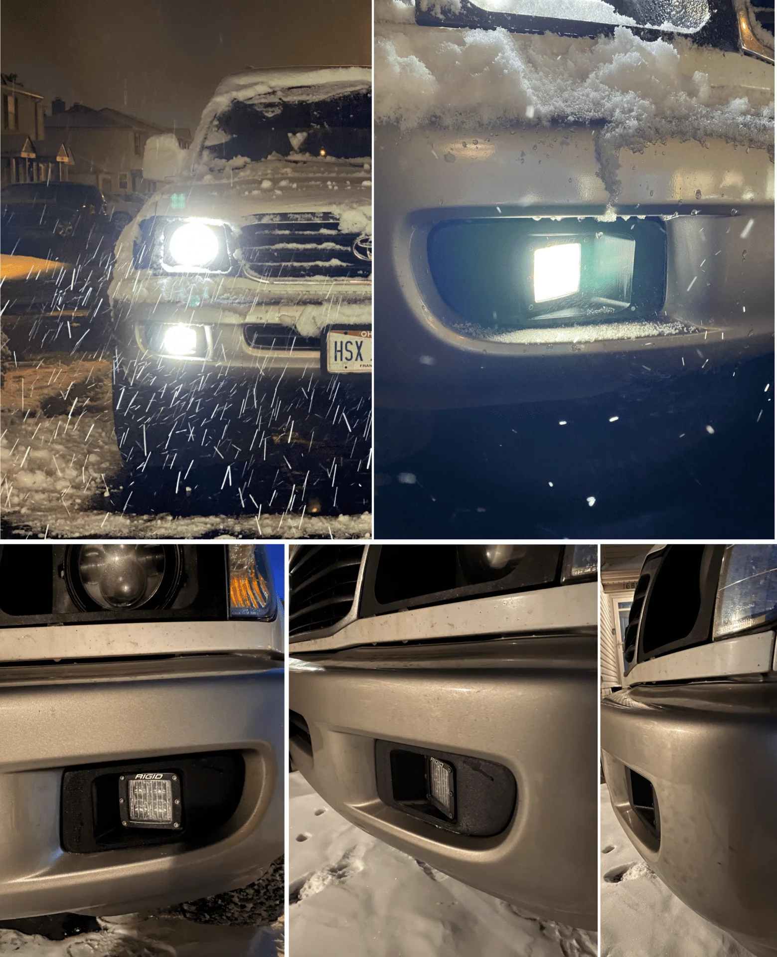

The design of the fog light mount is all done. I have also tested them in snows. They held up good and no rust on the fasteners. I am going to post them in a few days.

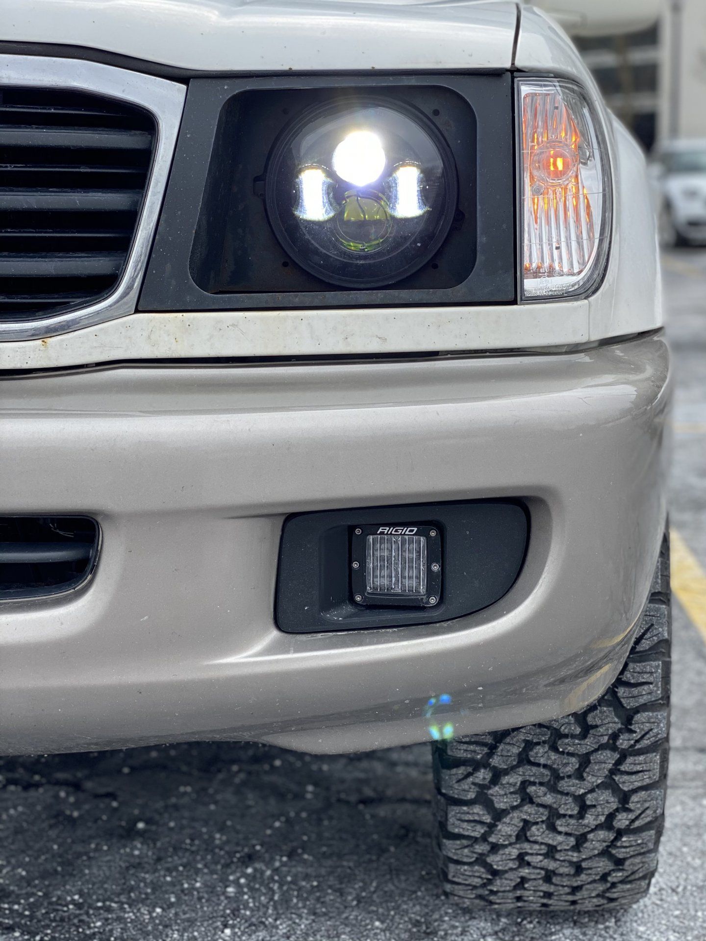

Making the 100 a little more user friendly, one mod at a time. Thanks Ben for giving us some useable cup holders! The change pocket ram mount for the phone, paired with the BT-45 module, definitely helps as well.

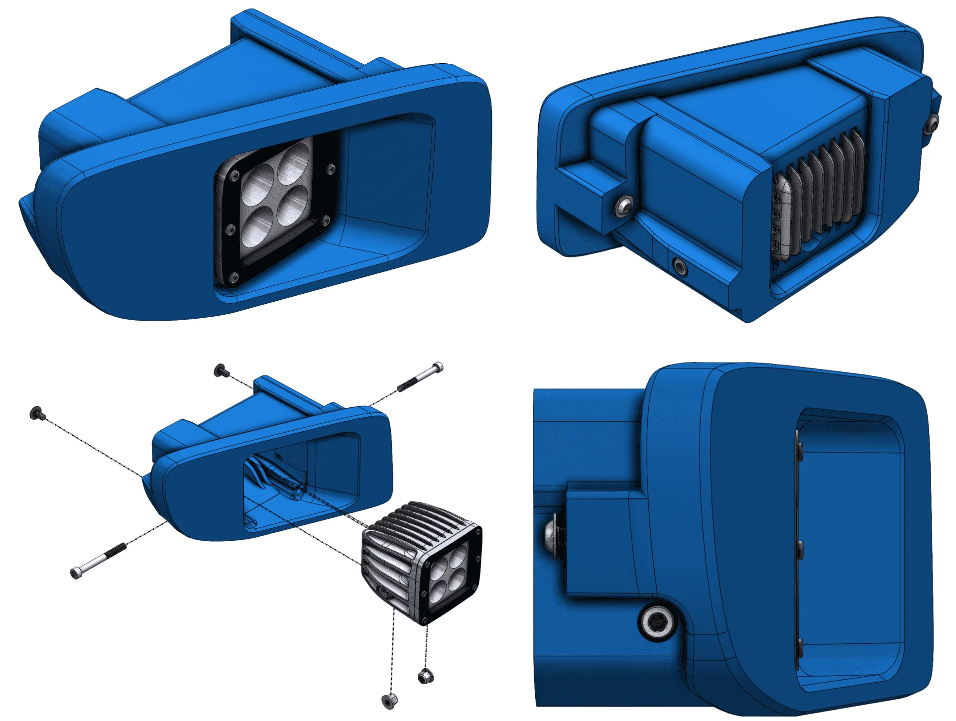

Make 19 V1 Fog Light Mount (Rigid D2) (editing)
1. Overview of the Final Product
2 Introduction

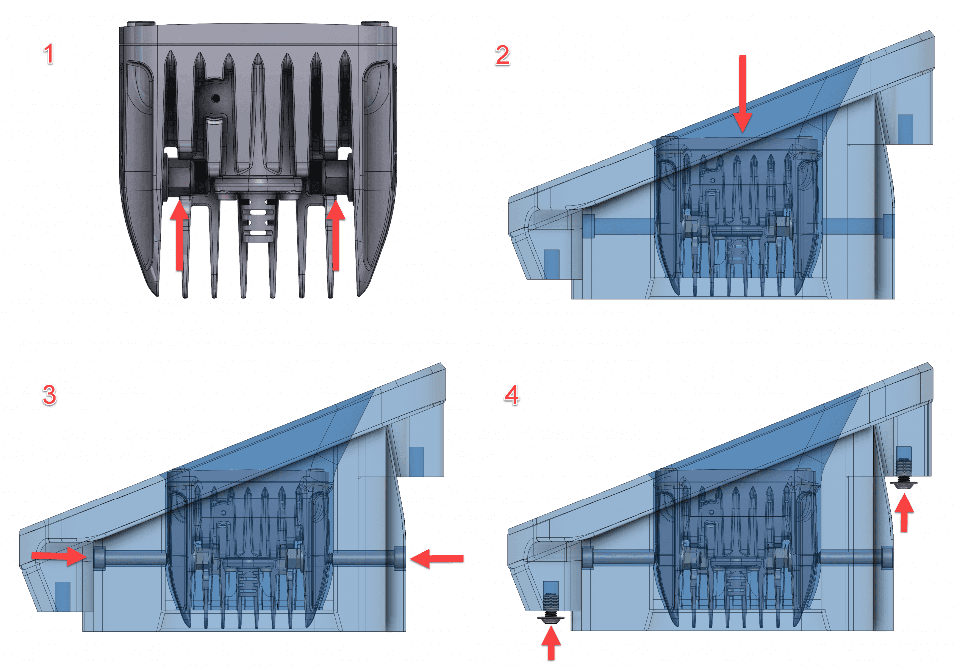

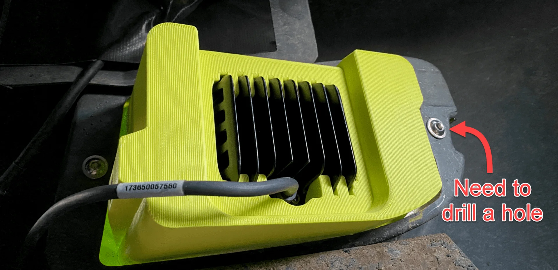

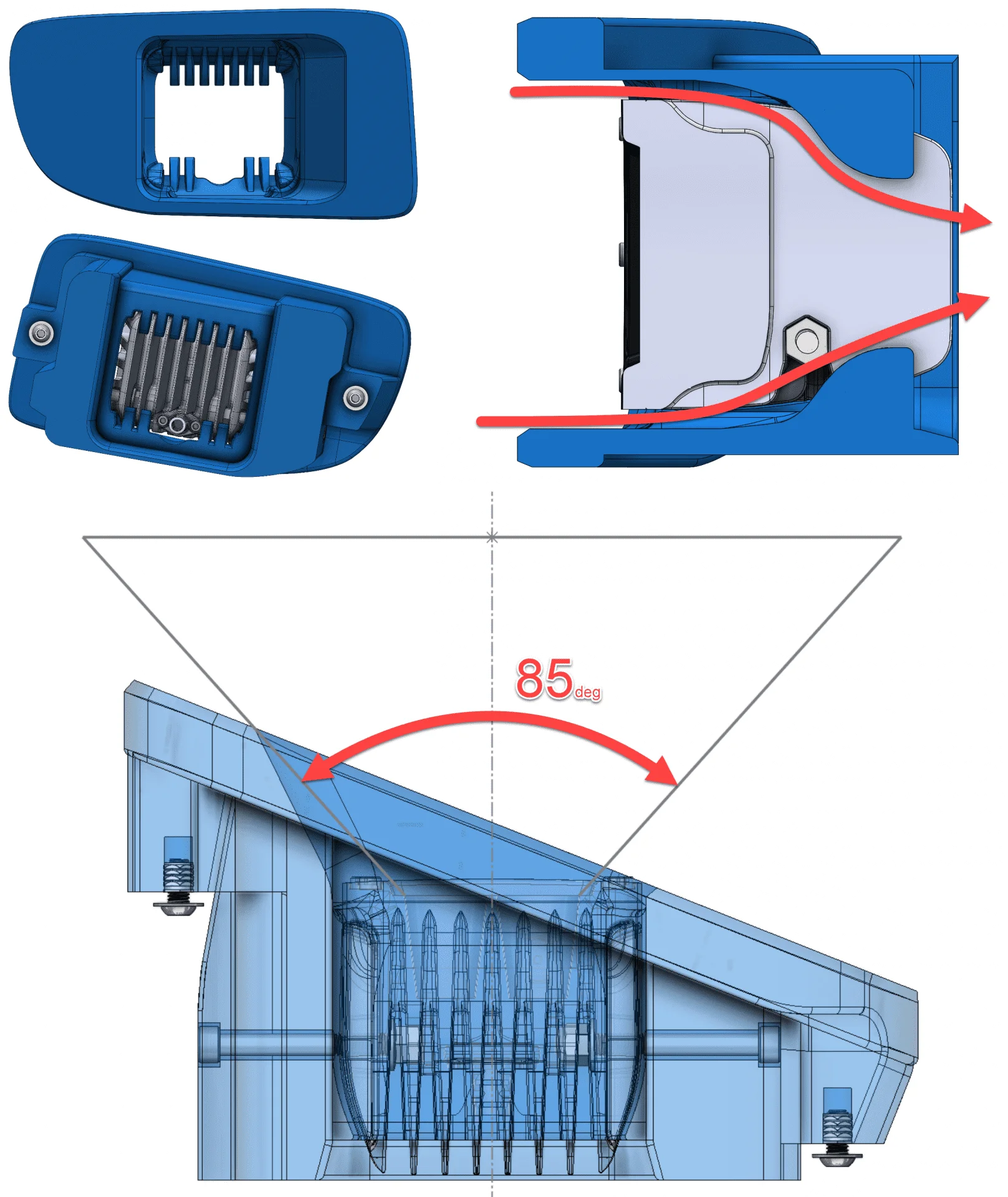

The fin/teeth structures are designed to force air to flow through the heatsink. The fin/teeth structures are not necessary for D2 lights to work. But for 3d printed parts, it barely adds to the fabrication cost. D2 fog lights are recommended. The mount is designed to accommodate the wide light pattern (85 deg).
3 Installation
Harness adapter:
Recommend LED pods:

Very excited for the fog light mount! Looks awesome. What setting is “fog light test 3”?
How much will those cost you think? Only the Rigid D2 fit in those?
All videos were taken with D2 Fog lights installed.

I am calculating the material and print time cost.
Yes only D2 and its knockoffs fit.

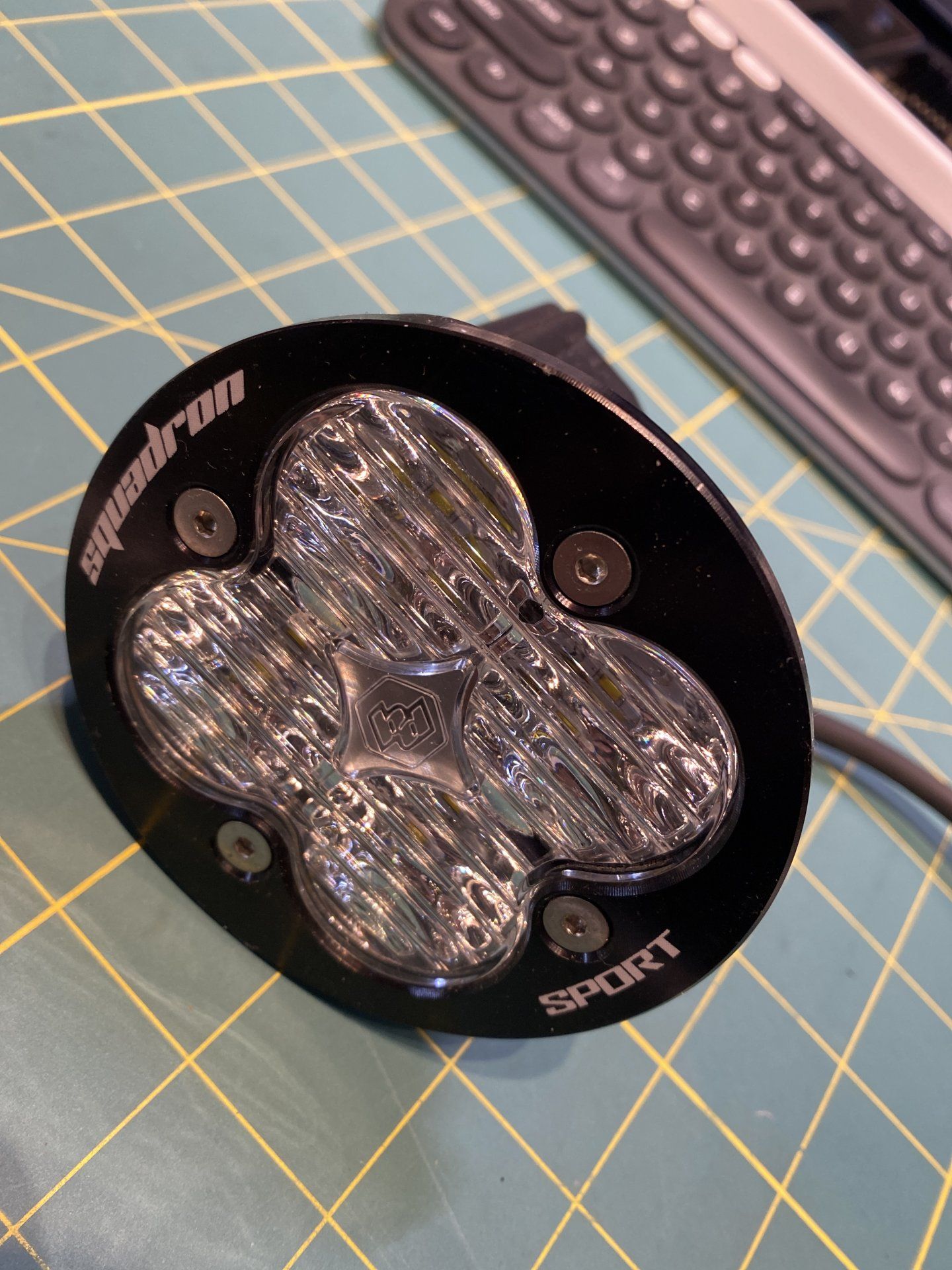

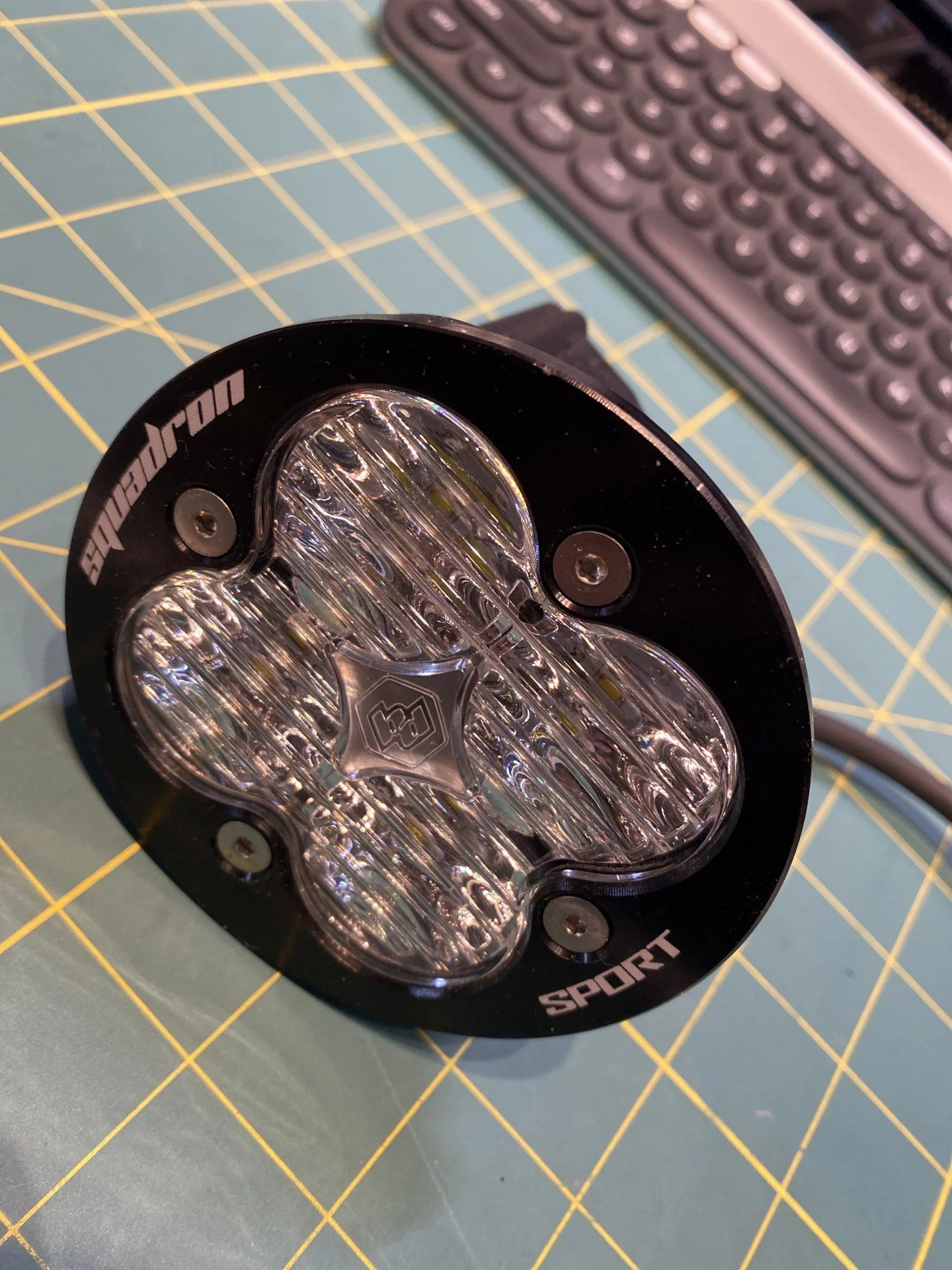

Yes. Working on it. But the light I have is Squadron Sport. Are they same?
Looks like the light you have is the Baja Squadron-R Sport. The Sport and Pro difference is the lumens...the Pro and the Race are much brighter, but the housing is identical.
One issue may be the round house. The square housing is much more available. Also wouldnt a square housing fit your 3D part better then a round one?
