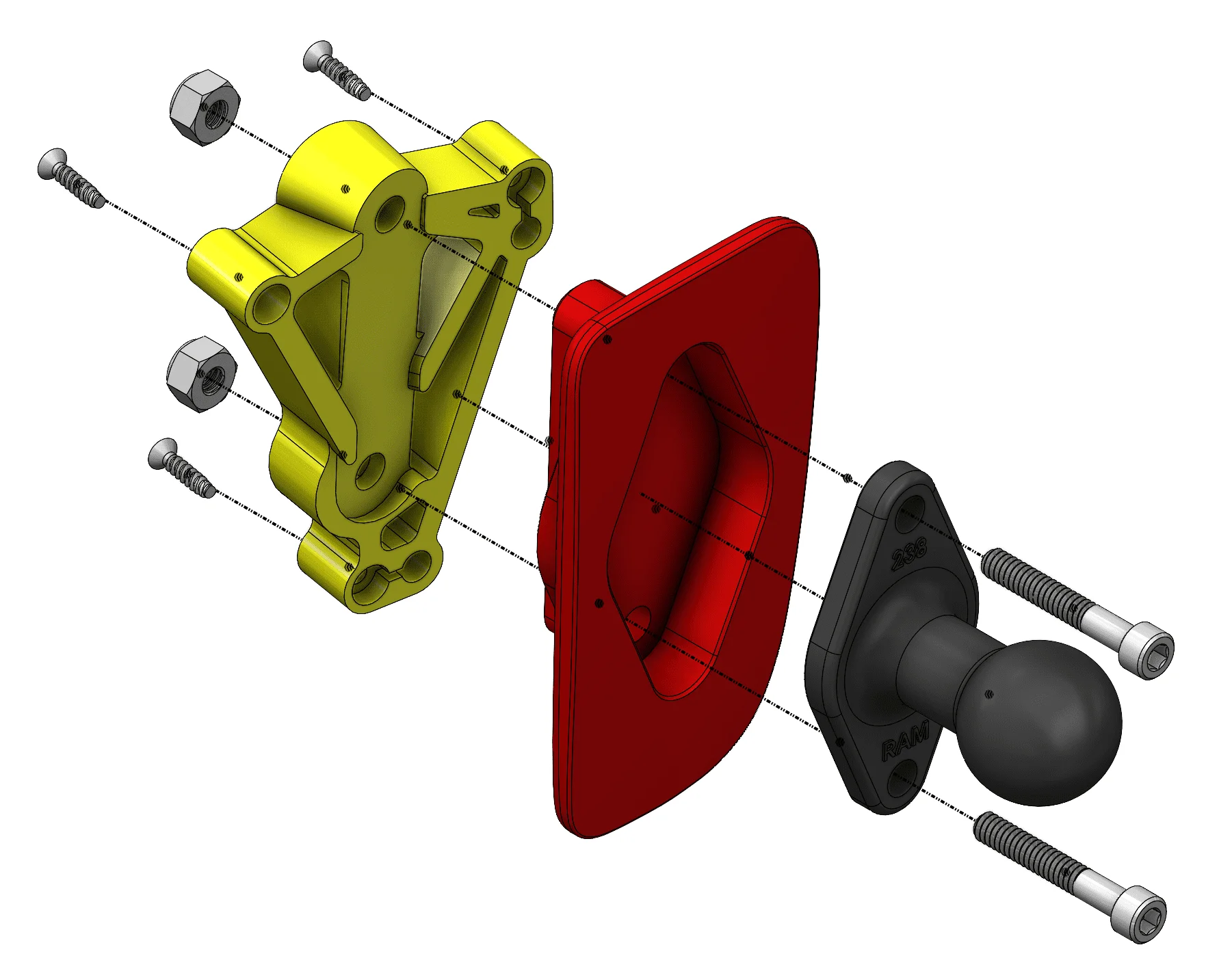

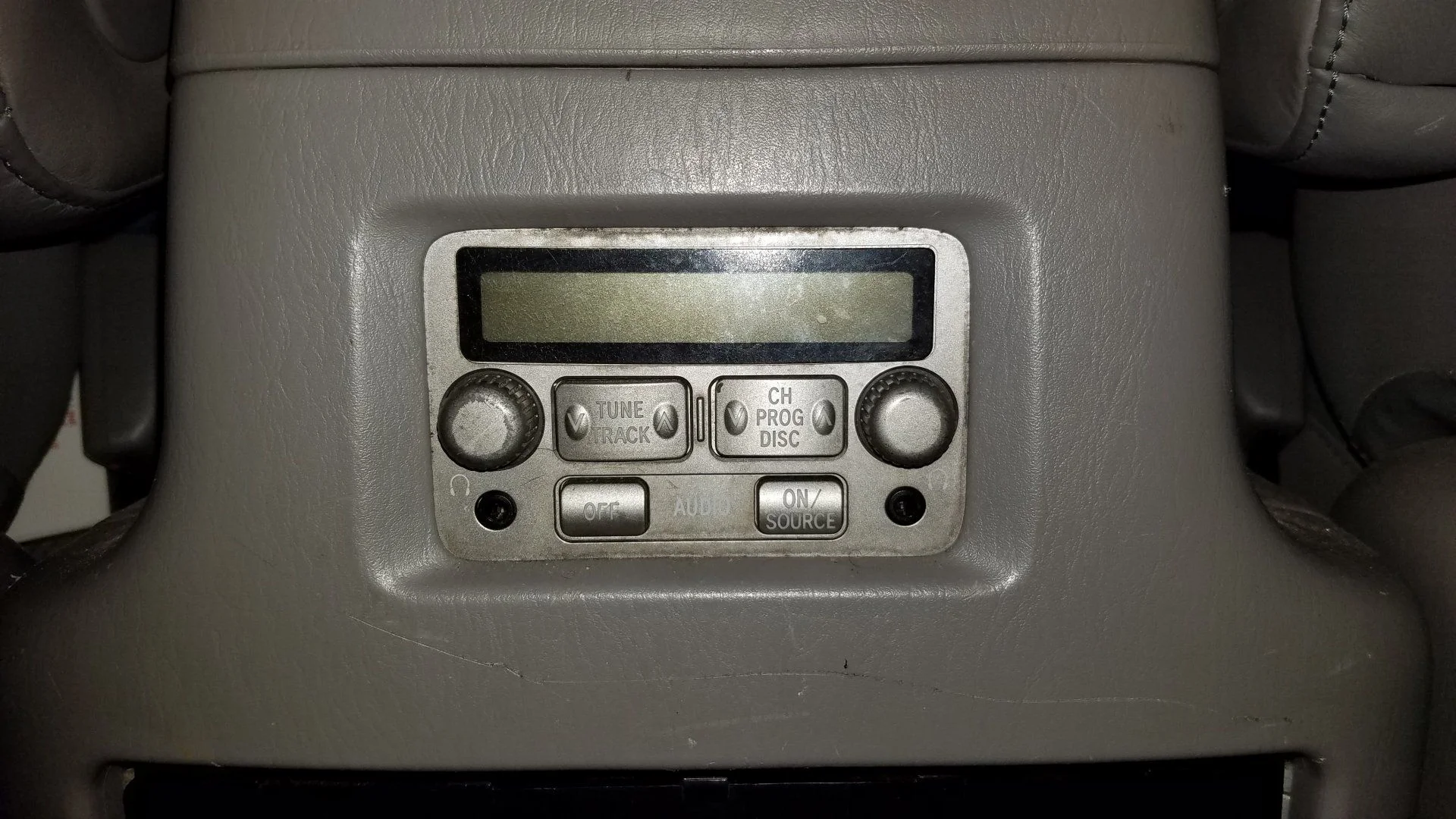

In the previous design, the face plate was fixed to the factory panel through three thermal inserts and three nylon screws, as shown in the following picture. I was worried about that in very low and high temperatures, thermal inset may have problem providing secure fixture. The portion of the factory panel where the face plate is fixed is very thin, which is another concern.

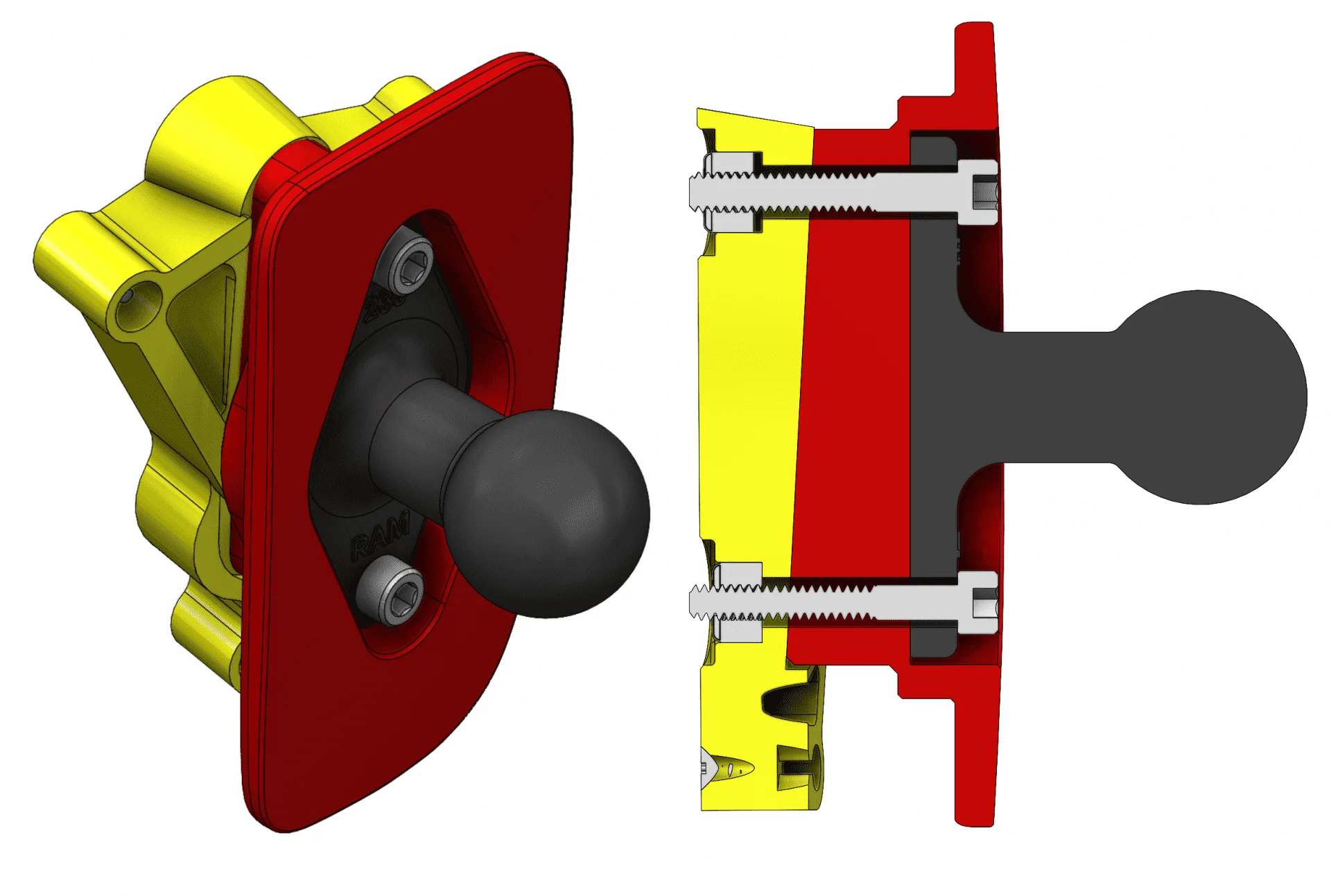

The new design uses a bracket to reinforce the factory panel. The three new fixture point are much stronger. The following screen shot shows the overview of the new design.

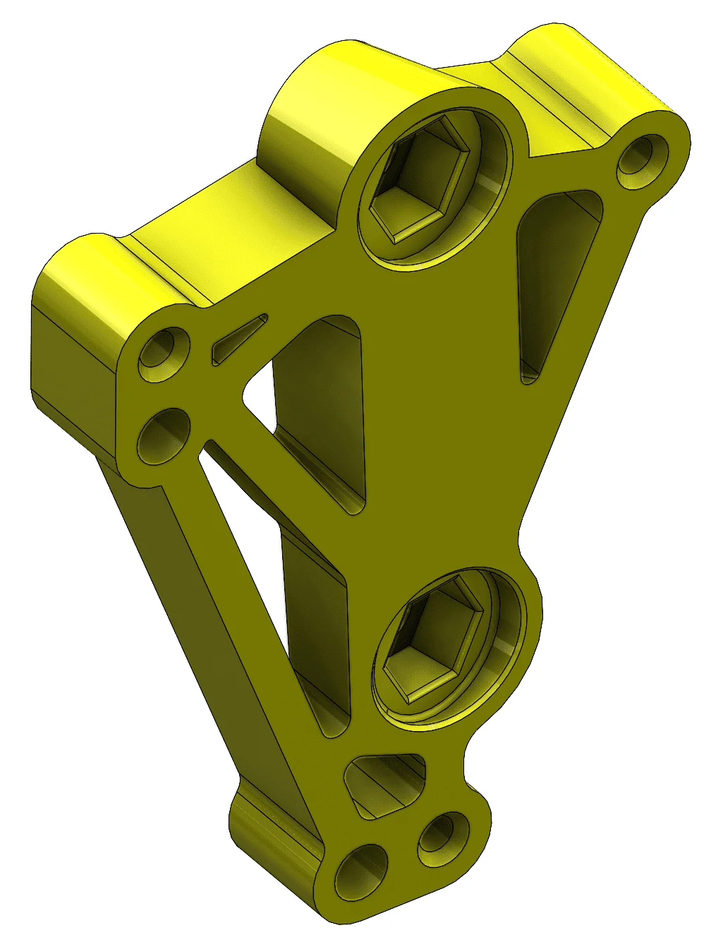

This is the bracket which mounts at the back of the panel.
This shows a prototype of the bracket installed on the factory panel. All fasteners are 18-8 stainless steel and will be provided.
Three #4 Flat Head Thread-Forming Screws for Plastic
Two 10-24 Nylon-Insert Locknuts (Black-Oxide)
Two 10-24 Socket Head Screws (Black-Oxide)

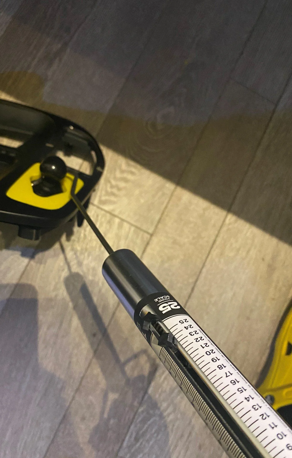

The design was tested with my scale. It handled 25 lbf like a champ.

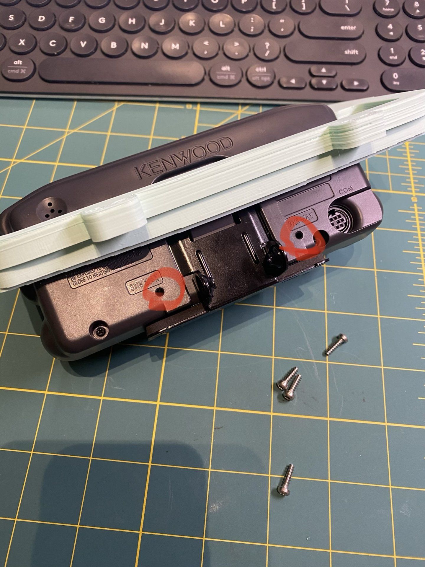

This head unit is huge compared to everything I have ever mounted in the overhead console. For good visibility, the unit is not fully recessed into the mount and a tilt angle is used. It may block the rearview mirror a little bit. Have to comprise sometime. I don't have a radio on my truck but I am seriously considering this model.
The unit has many contours to match. It took about 15 design iterations. The one in the upper left corner is the first prototype. The white one in the right lower corner is the final prototype.

wonder if anyone knows if the 710G and previous 710 heads have the same mount configuration?
710 710G 710GA other 710 series should share same body. There are four holes labeled 3x8 on the back of the unit. Two of them are used.
