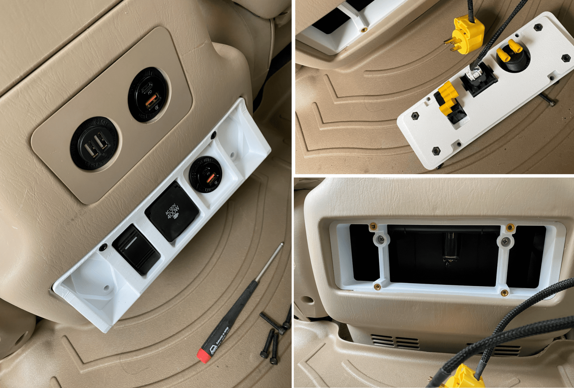

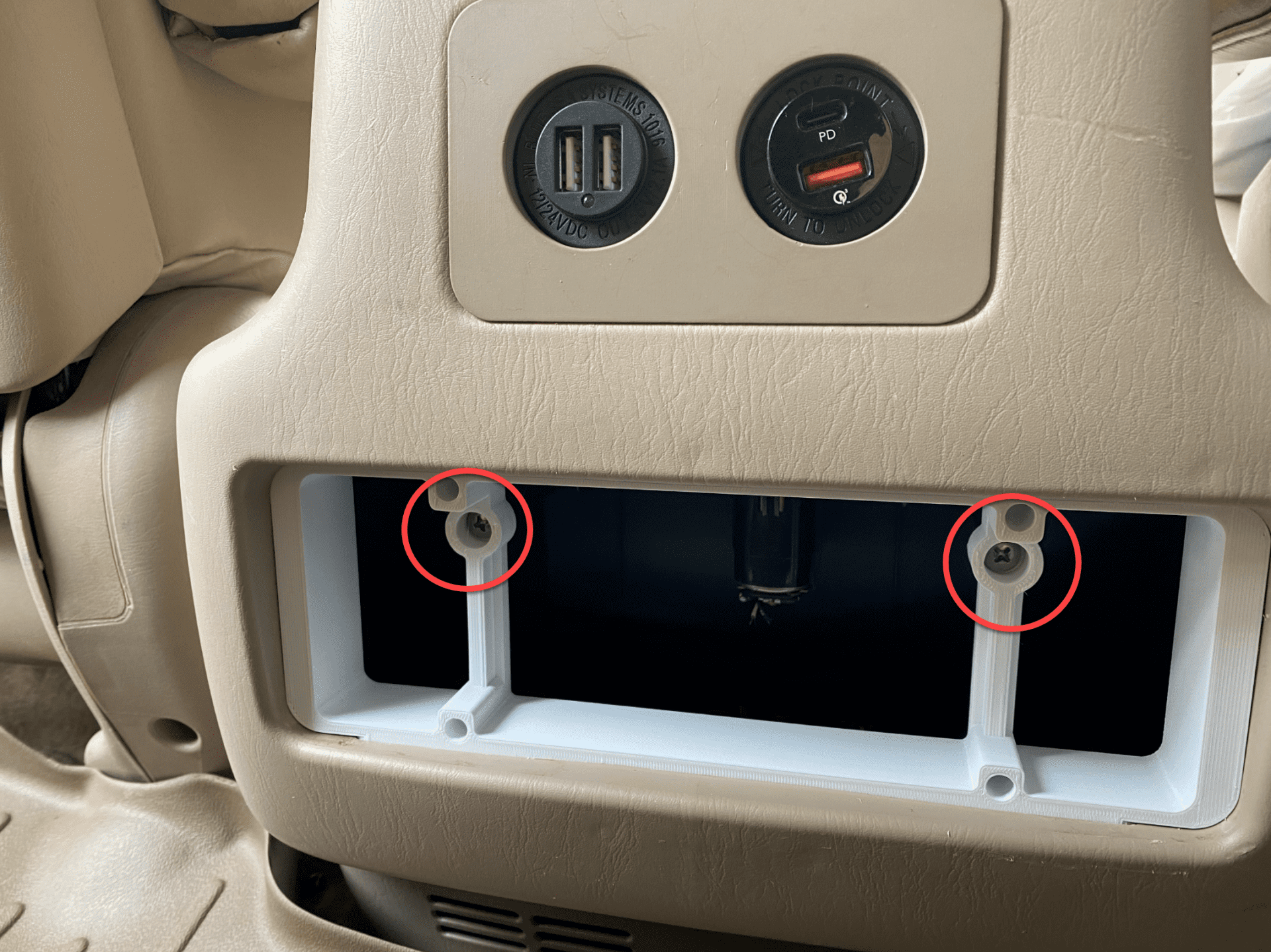

My make suggestion (you get to pick the Make number):

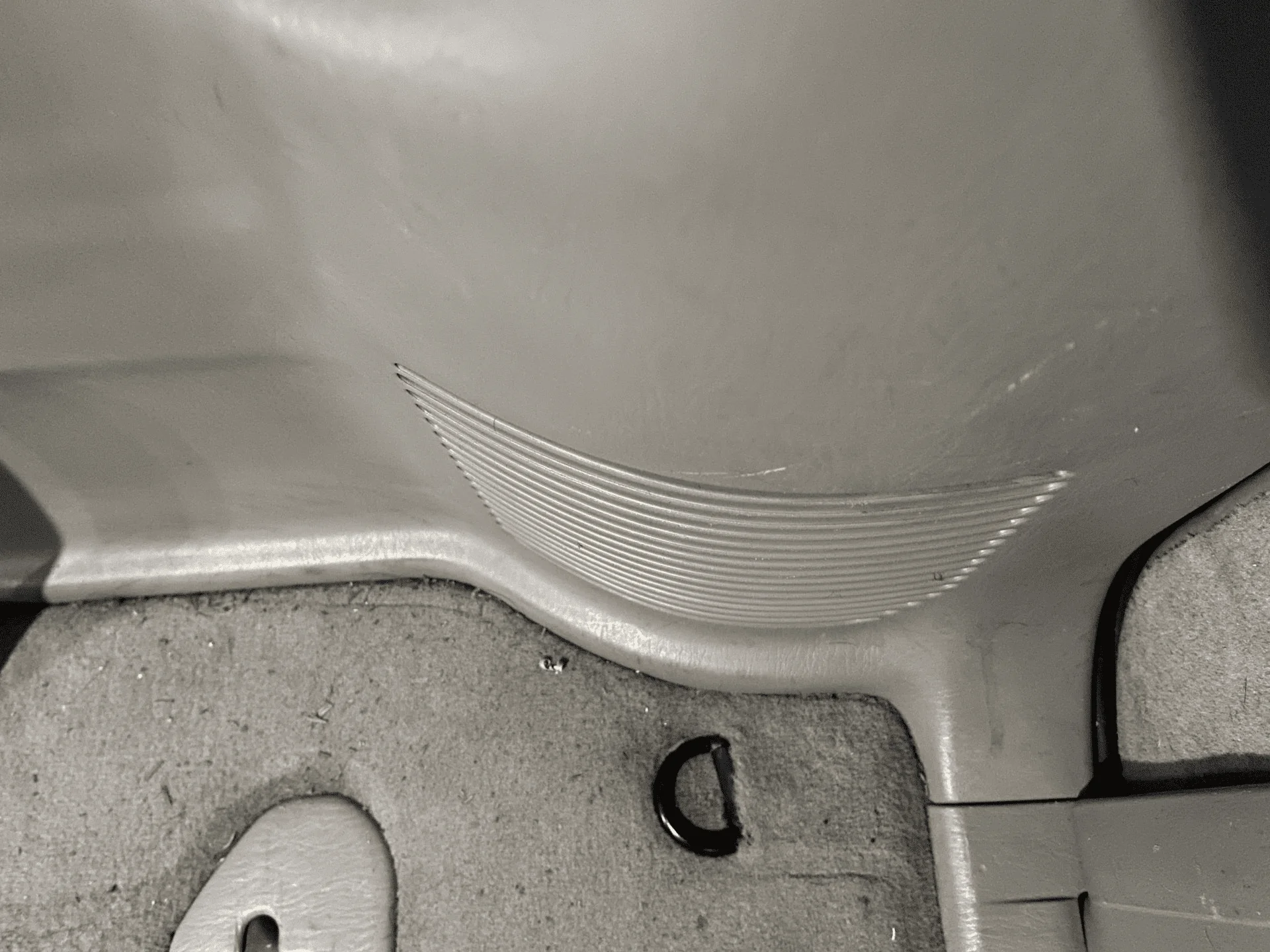

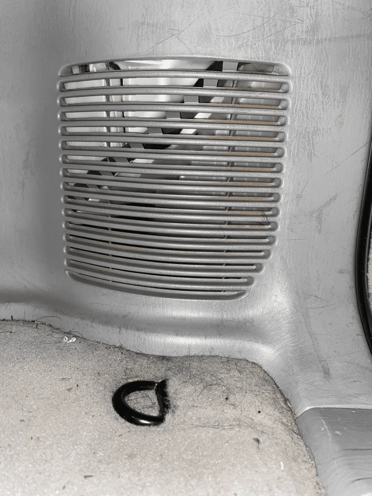

A snap on cover that prevents items from blocking or restricting air intake for those with rear A/C
(might look like a secondary grill or the cover could be perforated or customized with logos/text...might check copyrights first)
My issue: On a short trip, my dogs and their blanket got moved in front of the air intake of the rear A/C
(given enough time, a/c performance may be effected and components may freeze-up with reduced airflow across that evaporator)
My thought on how to resolve: If there were a snap on grill cover that held firmly, but only protruded an inch...that might prevent this issue even when blocked by gear or other items
My design thought: simple and basic and would utilize 4 tapered clips (low to medium force) that attach to the existing fins
Of the material choices you have, what could be thin and flexible so you would not need to match the curvature?
If the Make were "flat", it might be much less work/time than if there was a radius/curvature to maintain
But if flexible, it could bend to fit...and a center post "limiting" deflection once installed = pushing at center of make or an object pushing on center could not flatten the make and defeat the purpose (see "issue" above)
This Make might be the easiest one yet, as nothing need be removed, wired or installed = pop it on and go!
Appx measurement for this is 6" x 6" square
And with Summer here, it might be a "hot" seller :)

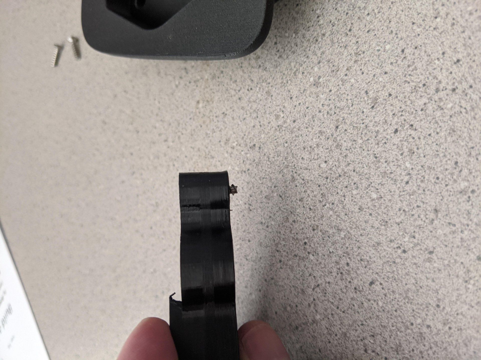

Just received my M2V2 (through YotaMD), and it looks great. Couple questions. The ram mount is just a mm or so shy of fitting. Am I better off shaving the ram plastic or the filament material?
The screws that where provided to secure to the trim panel seem a bit short. I like to have at least 3 threads engaged if possible, should I get longer screws or just machine the build piece a bit?
Anyone who has done the install tips or tricks?

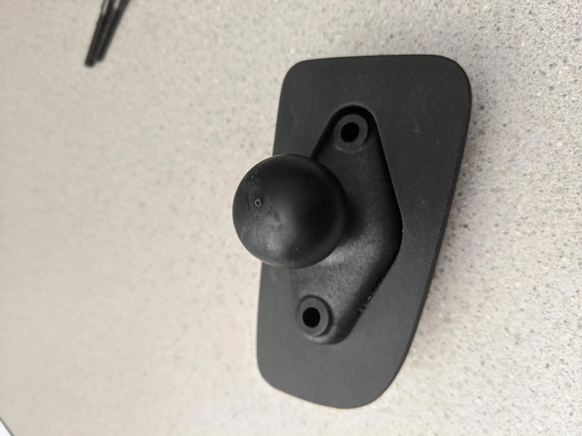

Where did you purchase ram ball mount from? I purchased the one that Ben linked in the Make thread and it dropped right in. Is it RAM brand?
It was one I had already from Amazon. It is Ram branded. It's really close TBH.
Interesting... honestly mine just fit perfectly so maybe yours is older one that had a bit of variation? Problem I could see with trying to shave it down is that it may misalign the holes for the bolts.
I can help out here. We just had another customer with similar questions.
1. The RAM mount you have there is not the one we recommend. It *can* fit (some filing on the RAM mount may be required), but it's a little wider at the base and ultimately not intended to fit. That's the RAP part number in your pics and the BenCC part is designed around the RAM part. Both made by RAM mounts - one is composite (the RAP part) and one is metal (the RAM part).
@BenCC has already made CAD revisions and future shipments should accommodate both RAM mount types.
2. The screw length. I agree and @BenCC is proving out some longer screws to make sure the longer ones don't cause an unforeseen problem. For what it's worth, others have tested the product and had success with the current screw arrangement.
If you can just snag the RAM part off Amazon (i think it's $7), that would be the easiest solution.

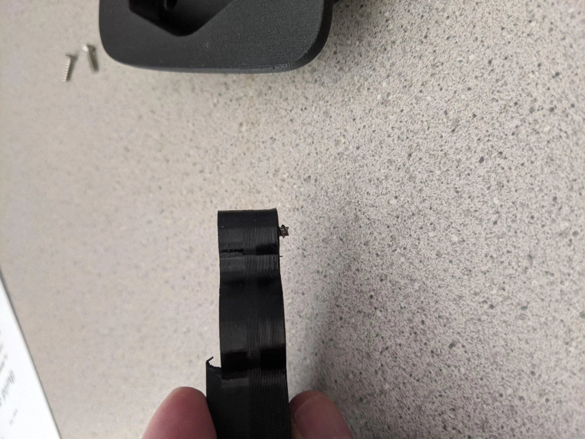

I had the same problems with the same mount. Took a few minutes with a file to make it fit. I went to Home depot and bought 10-32 screws that were 1/4" longer. The composite RAM mount is different from the Aluminum ram mount and requires some adjustments. Worked great after that.
Thanks, zip zip with the dremel and its all good. I had to take some material off the back as well for the bolts to work but no sweat. Also on the screws, I was looking at it backwards and there are actually dimples on the correct side so it seems you get 3 threads in there, so it feels pretty secure.
As @suprarx7nut mentioned, I have revised the CAD to accommodate the composite RAM mount.
Also modified the CAD to let the three small screws protrude a little more.
The two larger bolts I used are 10-24. In future versions, we will include 1.5 in long 10-24 Instead of 1.24 in long 10-24.

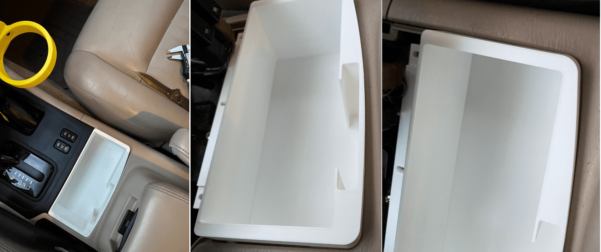

Update on the cupholder.
This is a very primitive prototype to test the fittings with the center console panel.
Some design goals:
(1) No foldable cover (space taken by the cover and its mechanism is released for larger and deeper cupholders)
(2) Match factory panel contour
(3) maybe a modular design for placing cellphone, wallet, etc
Update
Matched the factory opening contour.
Update
I personally really like the functionality of the stock butterfly piece. It allows me to run a small coffee cup on up. The depth is an issue and overall greatest width. We found you can remove the butterfly to fit a Nalgene bottle.
My ideal world: something slightly wider to fit larger vessels. Also something deeper. But keep the functioning butterfly or remake. I dislike the idea of the inserts. They are large and require storing or having multiple versions on hand.
A typical road trip for involves drinking from multiple vessels. Nalgenes, coke bottles, cans, coffee cups, insulated mugs. Etc.
Just my $0.02. Otherwise I think it’s great and a huge improvement.
Also everything else, as always, is A+.

How about anderson plugs?
The end deflection of a cantilever beam under concentrated end load is PL^3/(3EI). Assuming same load P, shortening the length of the beam is the most effective measure to reduce deflection. Also using stiffer material (higher E, modulus of elasticity) and designing the beam cross-section effectively (higher I, moment of inertia) such as I-beam would help to reduce the deflection.
On M2V2, I considered all the above factors. For L, the RAM ball mount is recessed so the end load is closer to the effective supporting point. For E, I asked @suprarx7nut to use stiffer material. For I, I don’t have any control on RAM arm.
To reduce vibration, I would recommend use shorter RAM arm and position the phone/Pad as close as to the dash.
