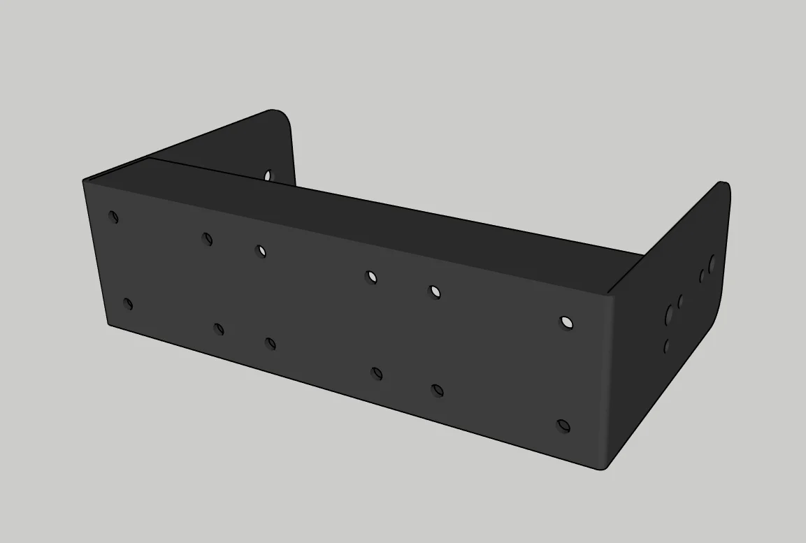

A steel frame fitting into the DIN cage, like a stereo. With AMPS pattern holes for mounting three Rammount AMPS Plates onto it.

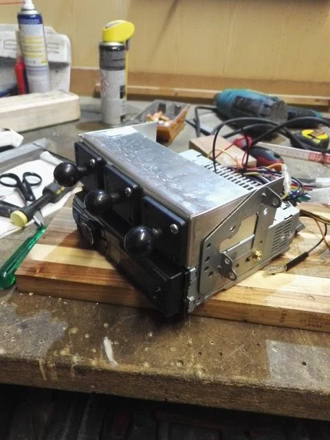

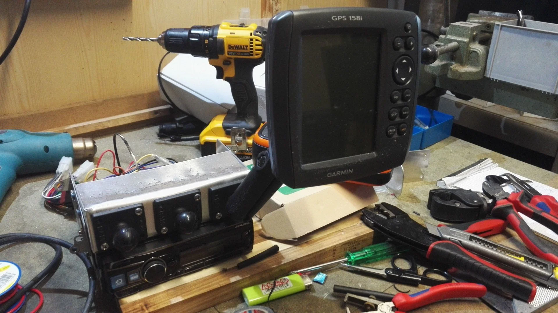

So I did a prototype - took some aluminium sheet and hammered this prototype together:
1949439
1949440

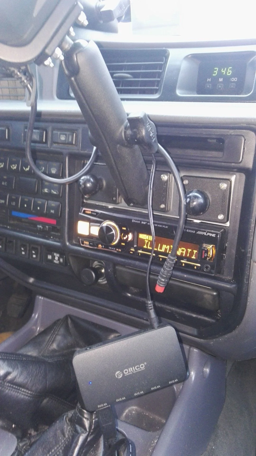

Mounted:
1949441

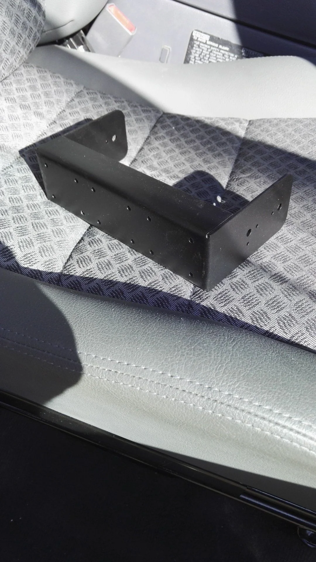

Quite sturdy but the looks are ugly. So went to a metal shop and ordered one piece laser cut and powder coated - black, certainly.
1949442
Paid CHF 200 (I feel a bit ripped off, I even delivered the DXF for the laser cutting machine).
If anyone thinks that is a useful thing and wants to build it himself ... lemme know, PM me for DXF / Sketchup.
If anyone (preferrably in Switzerland) can do some powder coating for me ... lemme know too!
