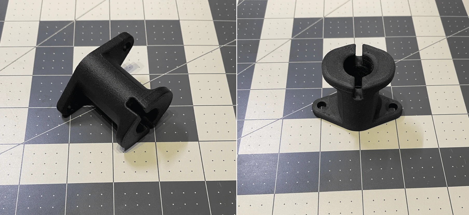

The fog light mount holds up great in open environment.
The amber LED is another project that I want to replace the tuning signal. It functions as turn signal on city road, and as widespread-pattern light off road. It is in very early stage. The red mount is the first prototype.

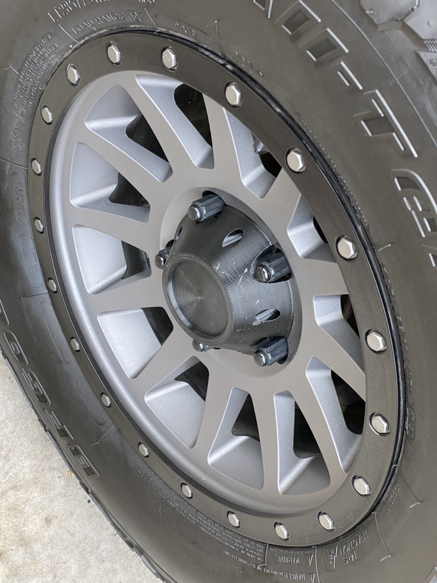

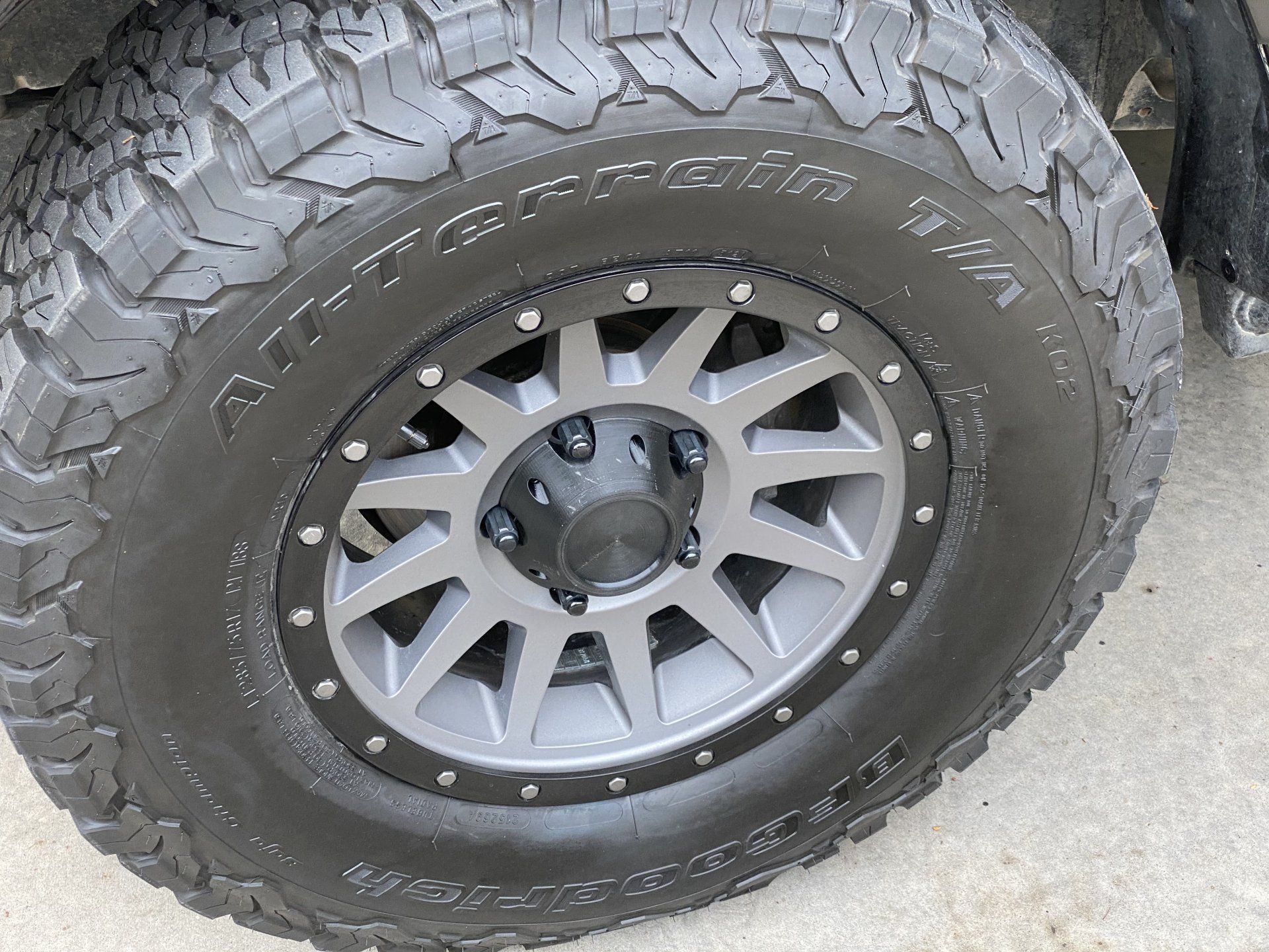

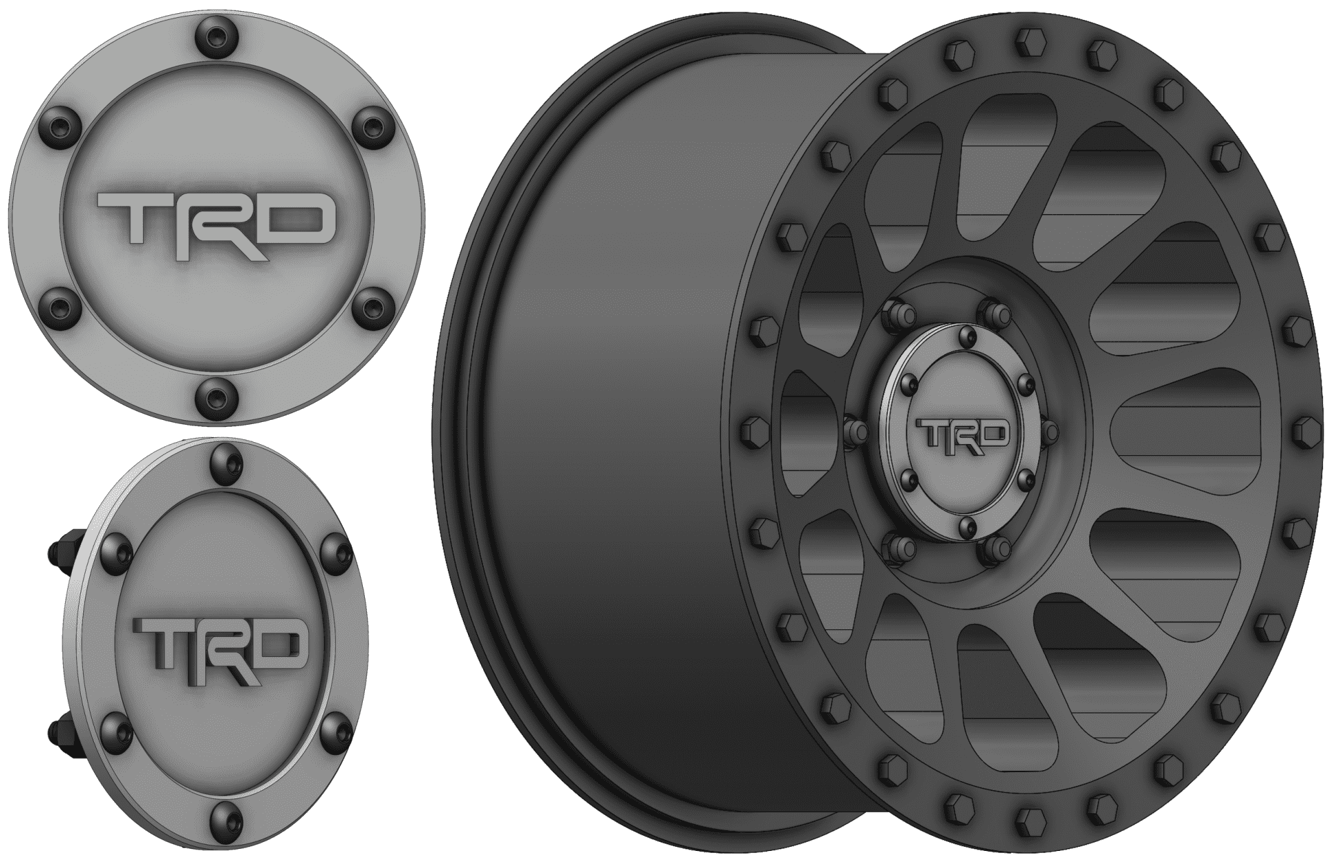

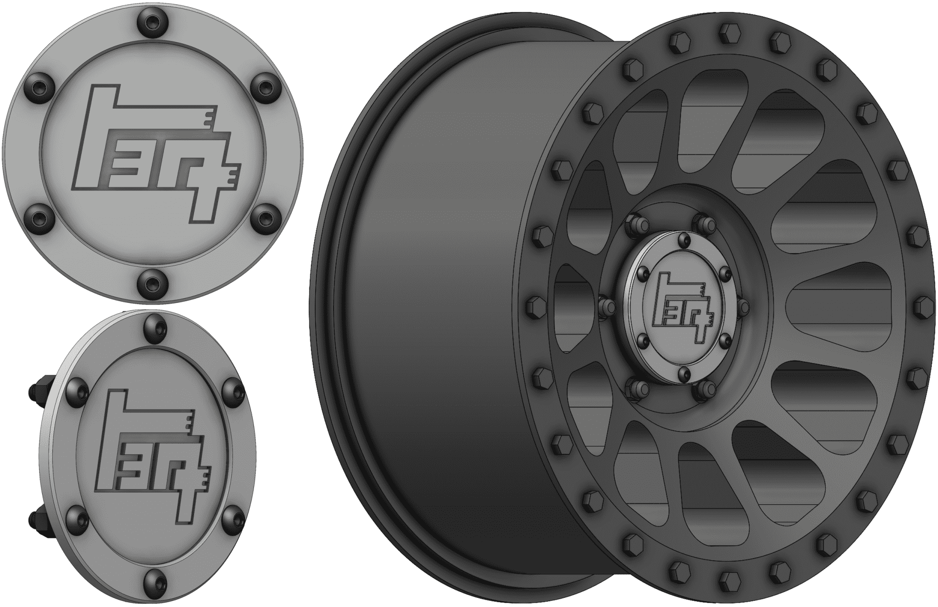

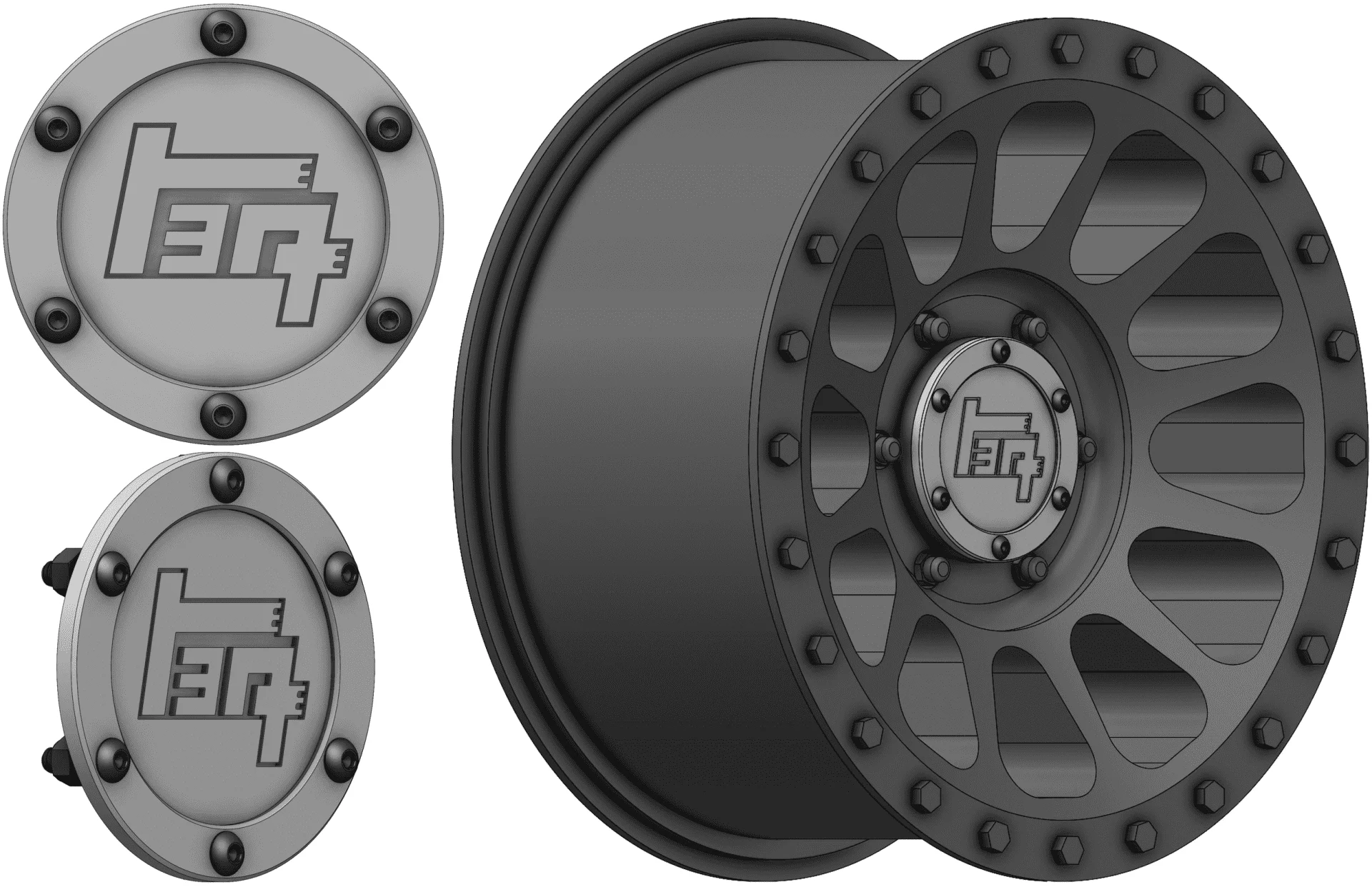

Make 26: Wheel cap for Method NV Wheel
1. Overview
Photo credit: @OwnerCS
M26V1
M26V2
M26V3
M26V4
M26V5
M26V6
2. Material and fasteners
Carbon fiber infused nylon
All 18-8 stainless steel fasteners
3. Purchase (Incomplete)
I'm close to ordering some Method 701s, just waiting to see what the best BF sale is. Will these caps also fit the 701 wheels?
Honestly, I have no idea. But I can print a quick prototype of these caps in cheap material and send it to you. If it fits, @suprarx7nut can print a set for you in the high-end material.

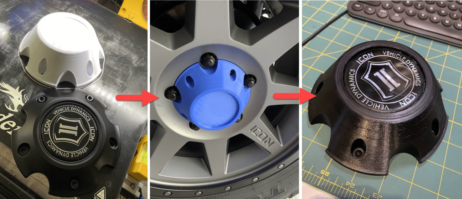

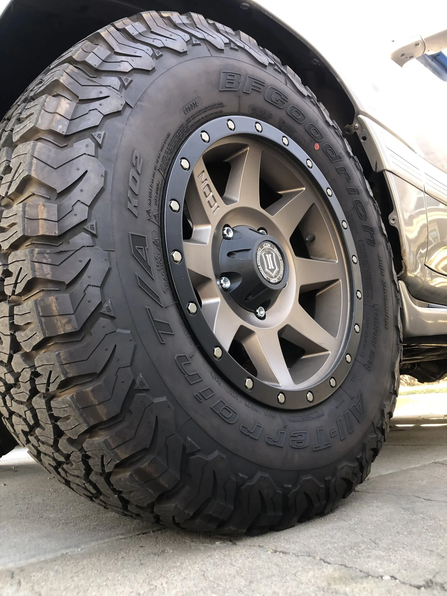

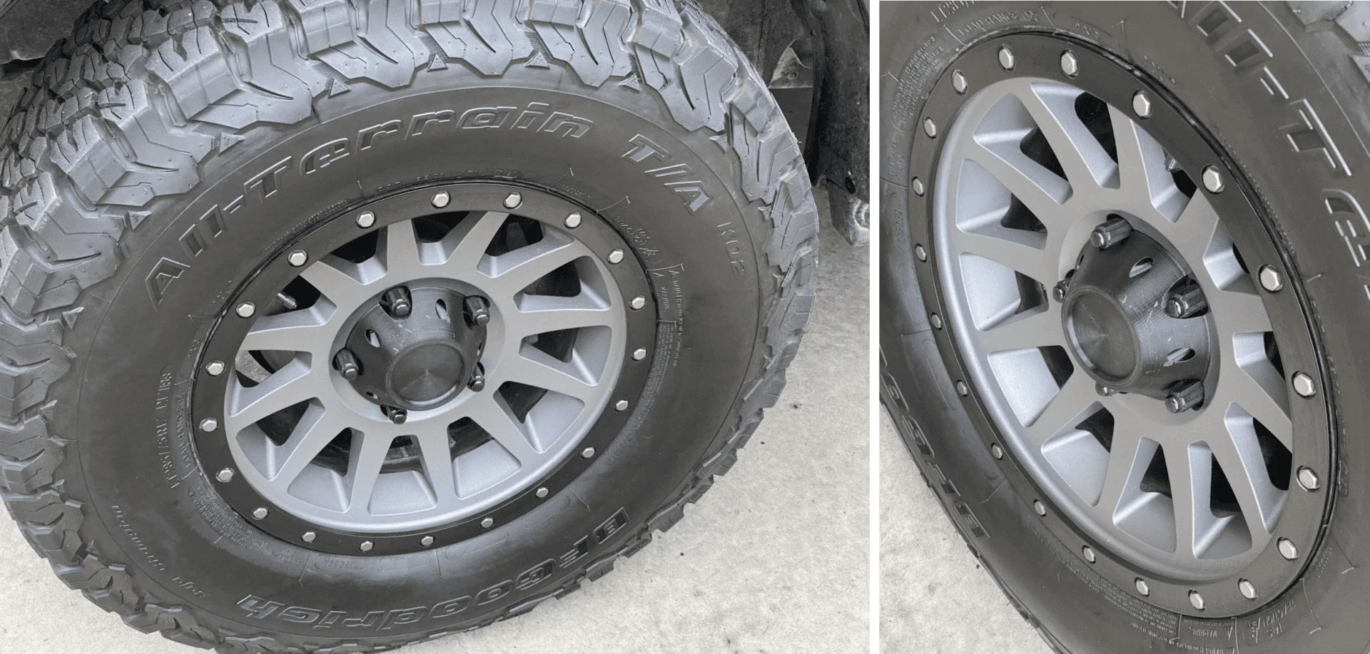

More props for @BenCC. He made these front wheel caps for my Icon Compression wheels. For future reference, Icon Rebounds use the same caps.
Let’s see how it holds up after the winter. Do you have snow in your area?
No snow here. The most it will see is a few weeks of ski trips.

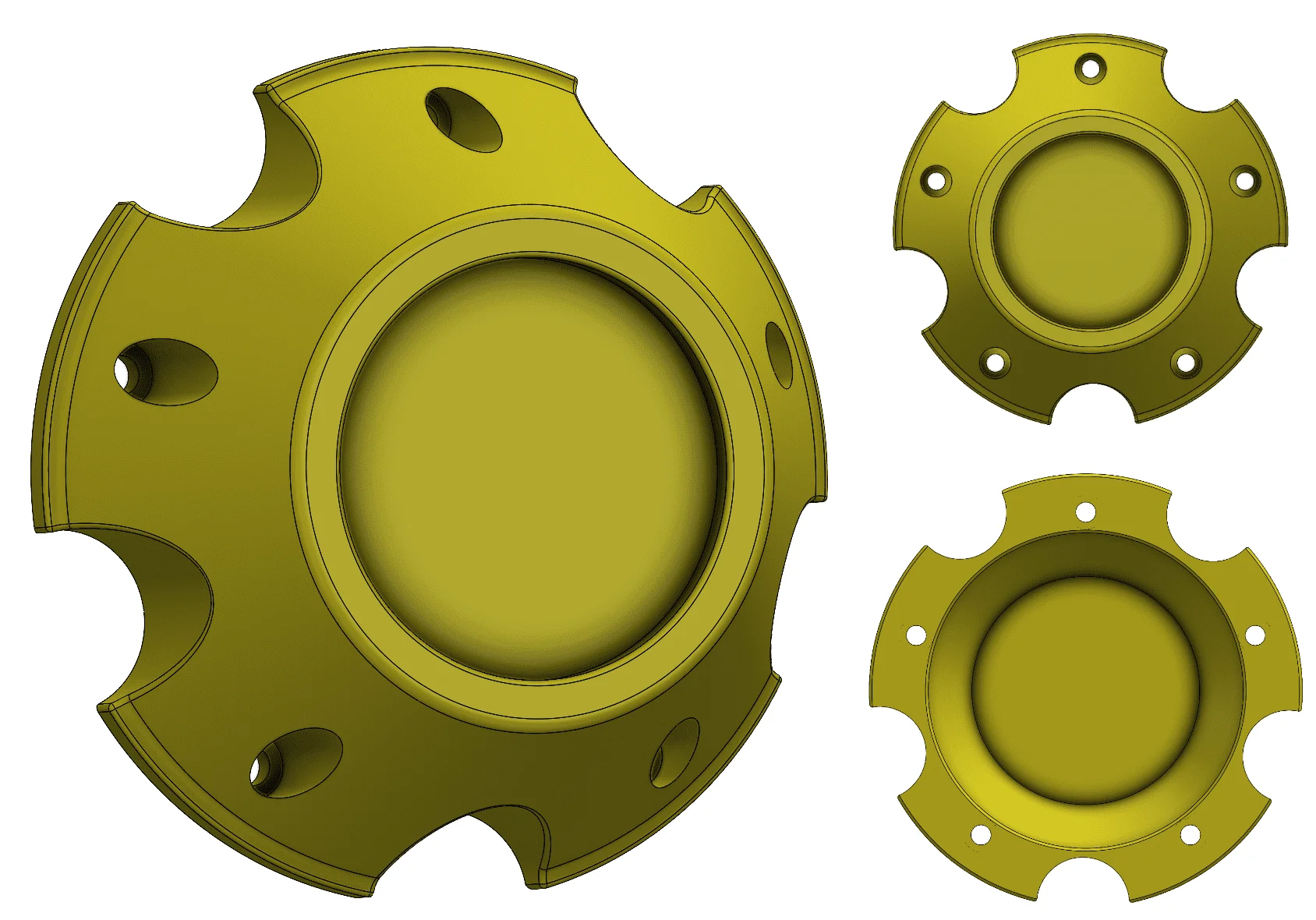

Make 37 Icon Compression/Rebounds Wheel Caps
1 Overview of the Final Product
Photo credit to @LandTuna
Photo credit to @larryt.
2 Introduction
The caps work on Icon Compression/Rebounds wheels. Thanks to @Dparo. He mailed his wheel cap to me. With a couple of iterations, M37 finally has all its dimensions fitted with the wheel. You can reuse the sticker from the original caps.
3 Purchase
$100 for a set of four caps plus shipping.
PM for Direct Paypal Payment.

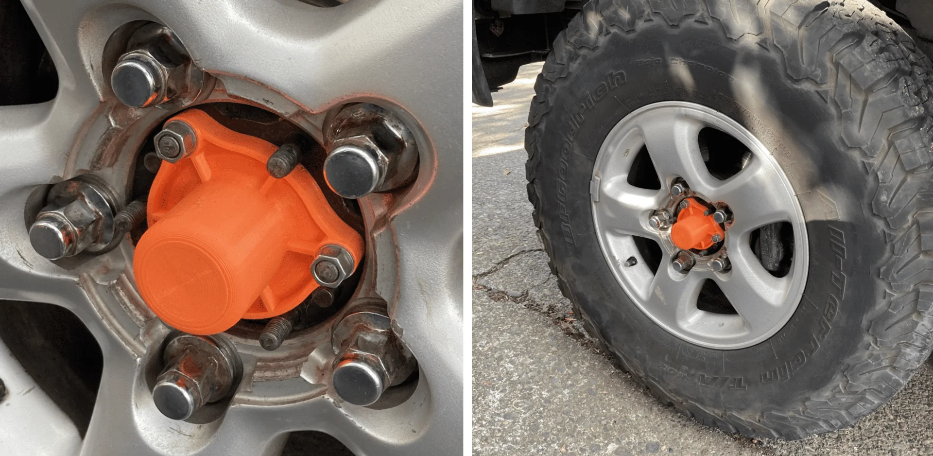

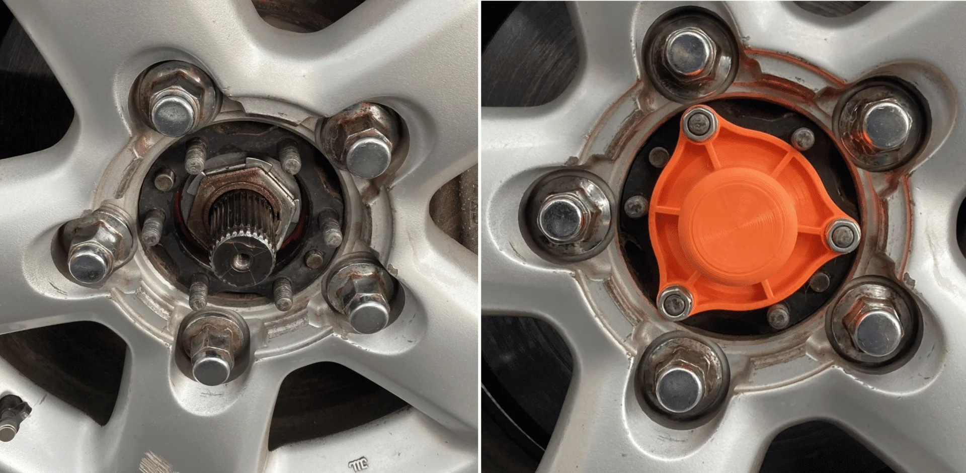

Make 42 Dummy Flange
Photo credit to @Ayune .
2 Introduction
M42 is simply a splineless drive flange to use in case of a blown front diff. It protects the front bearings from water & debris while limping home. M42 is more of an emergency-use product.
@Ayune designed the part and we worked together on a couple of prototypes to get it correct.

It should be noted that, in addition to removing the front drive shaft, BOTH front wheels need a dummy flange to isolate a blown front diff. So order in pairs. :)
YUP! They should be sold in pairs for sure.
