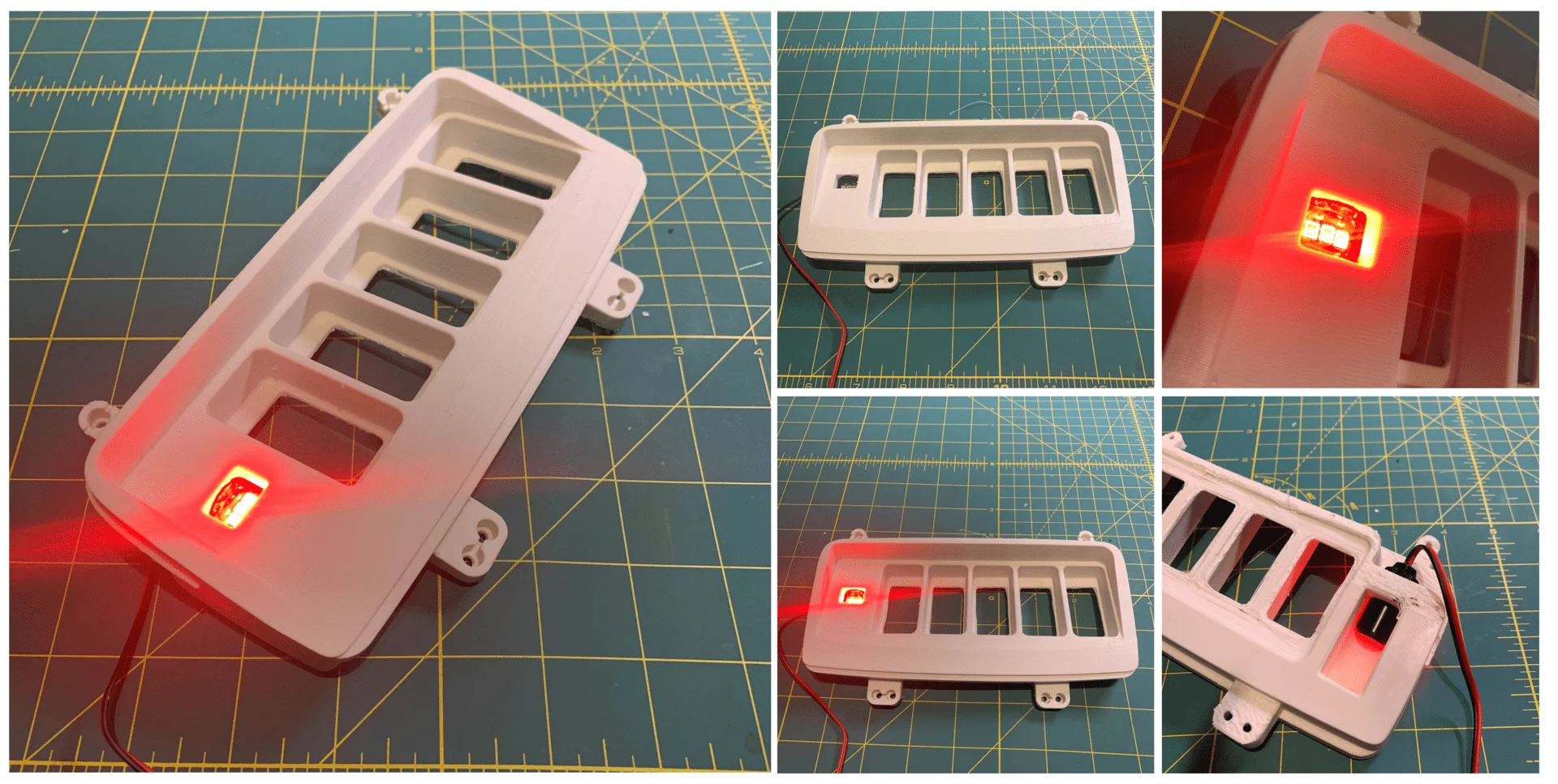

M4V2.2 Introduction
This is to address one request of adding a red map light.
M4V2.3 Design and Fabrication
This a derived design from Make 4 V1.

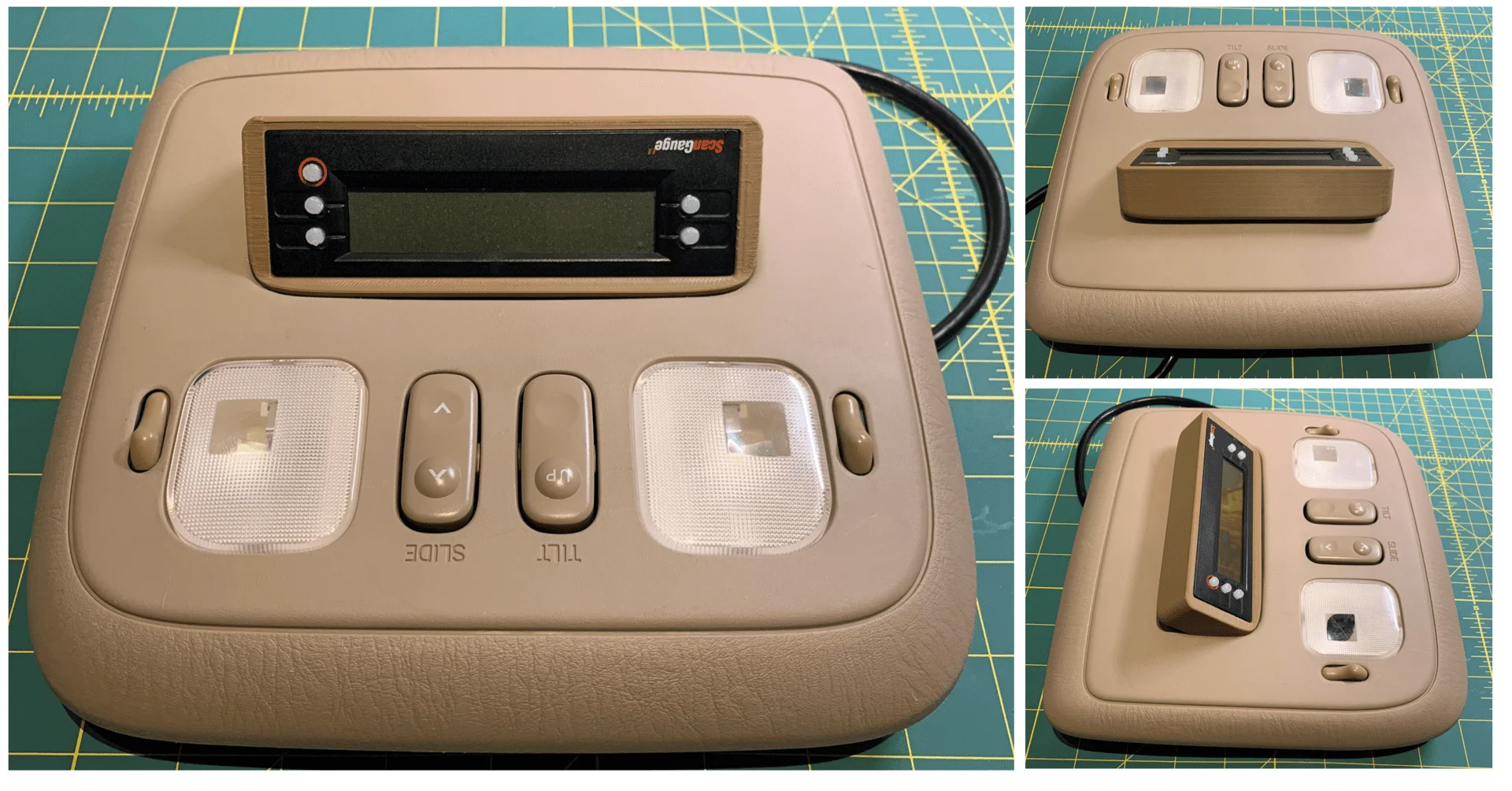

Make 12 V2: Scangauge II Mount for Mini-Homelink Overhead Console
Overview of three versions
M12V2.1 Overview of the Final Product
M12V2.2 Introduction
M12V2 may have limited view angle. This is designed to have a better view angle.

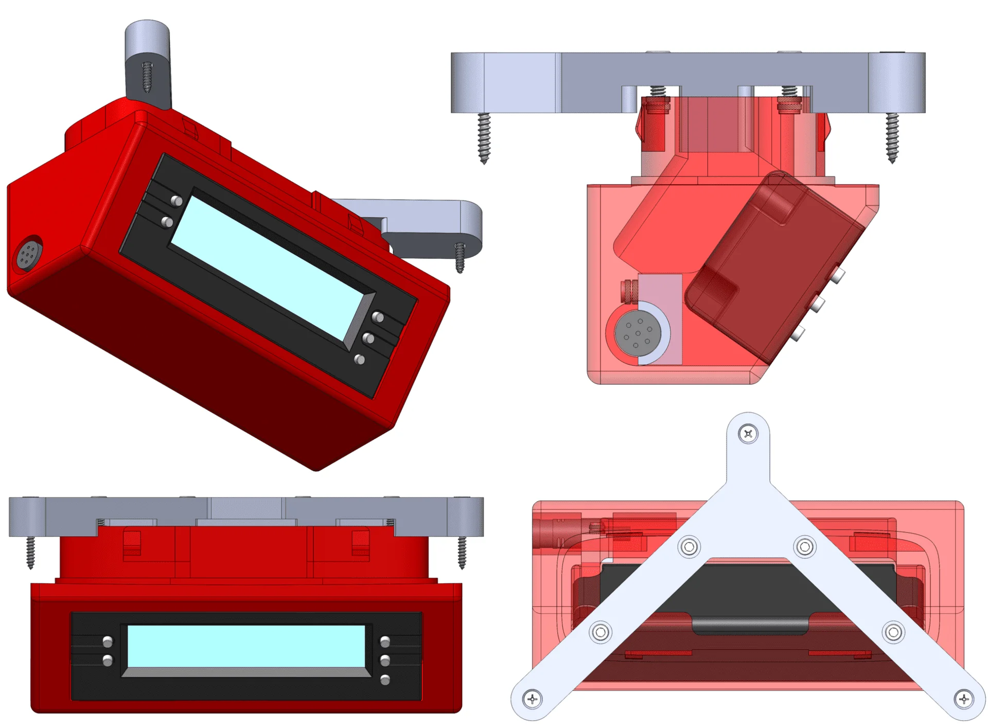

M12V2.3 Design and Fabrication

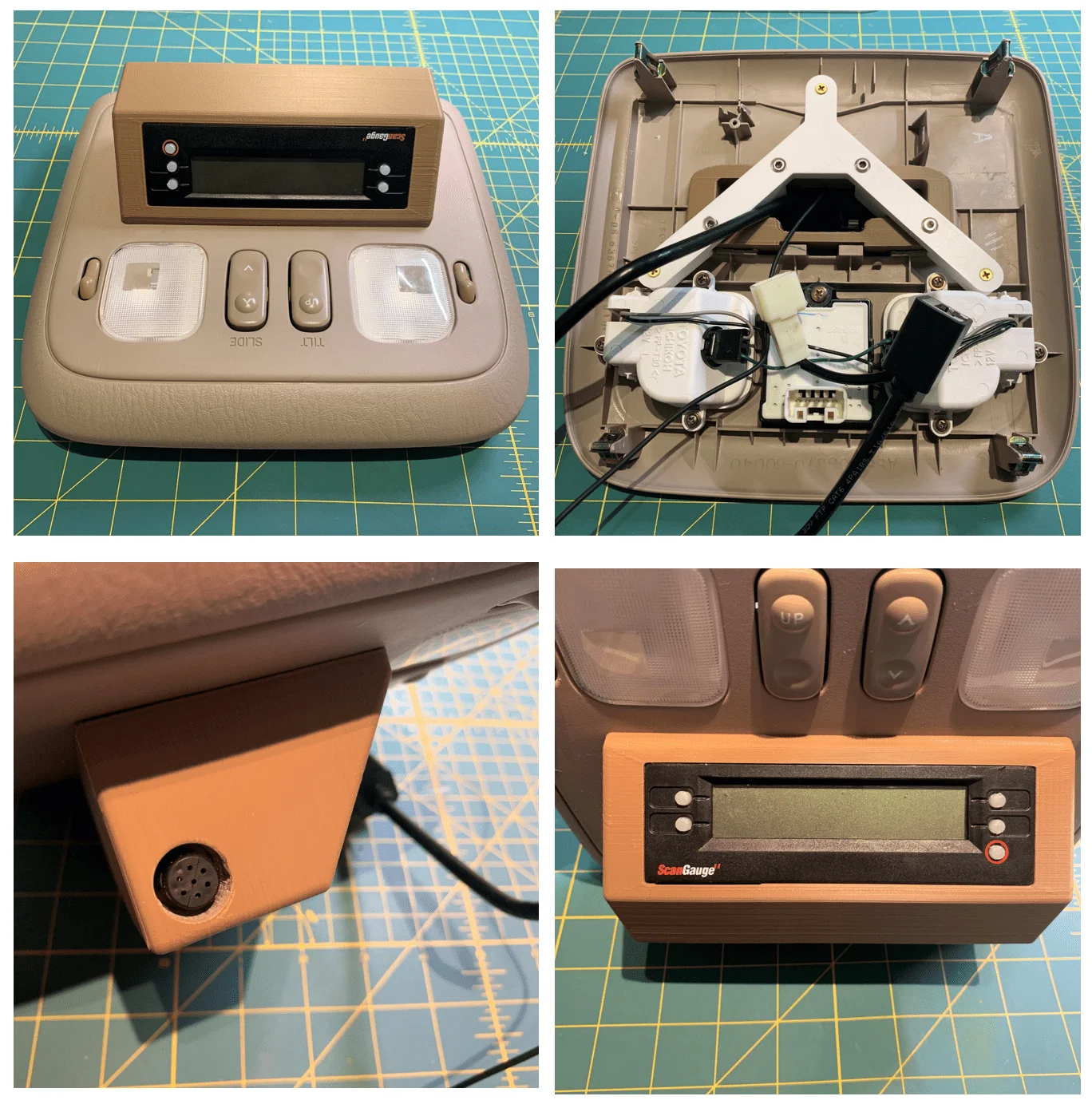

Original plan was to attach the mount to the overhead panel through snap fit. But I don't think it is secure upon inspecting the prototypes. I added a "wishbone" bracket to mate with the overhead console utilizing three existing holes. The wishbone enhances the security of the snap fitting. No rattle at all.

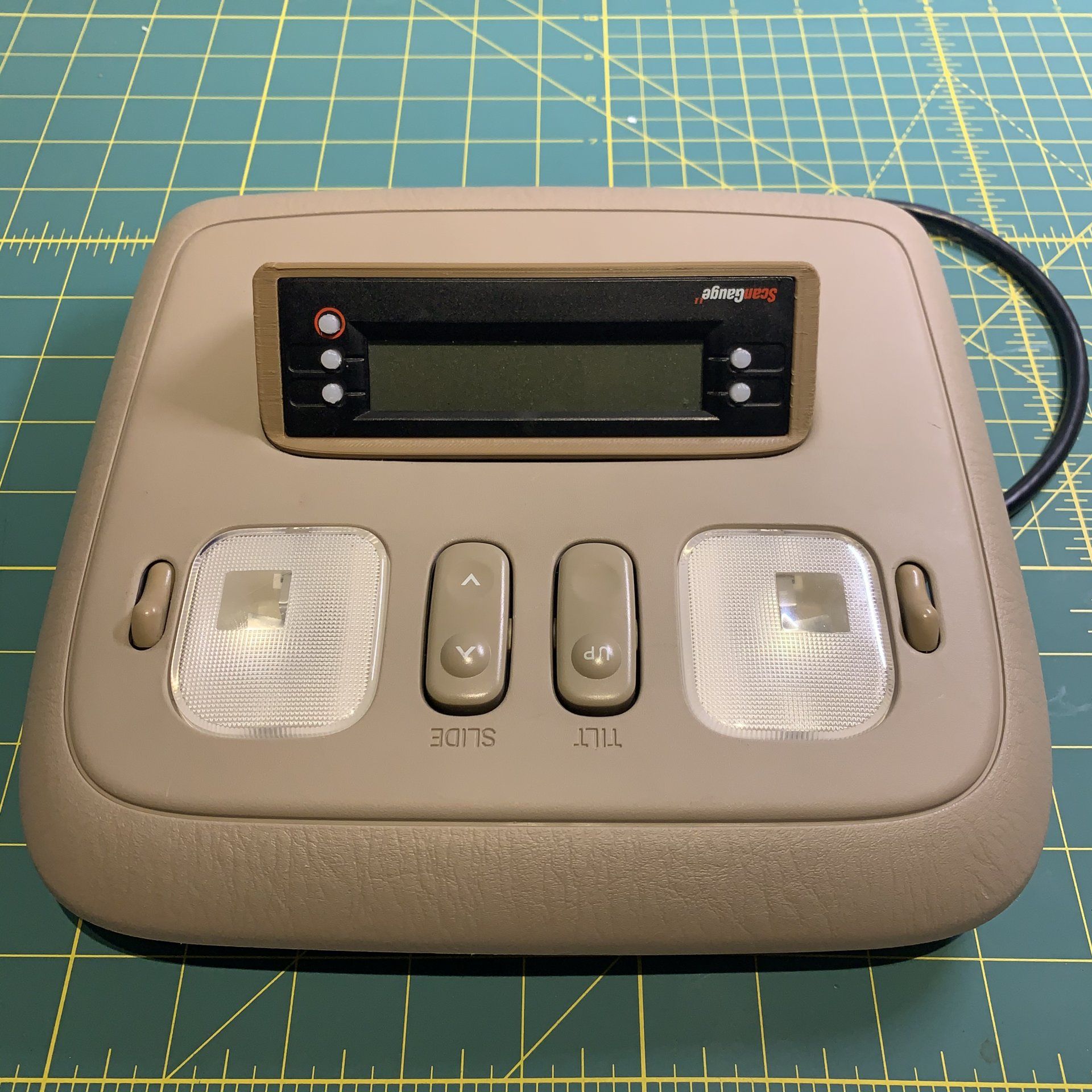

Make 12 V3: Scangauge II Mount for Mini-Homelink Overhead Console
M12V3.1 Overview of the Final Product
M12V3.2 Introduction
This is a minimalist design by positioning a big portion of the Scangauge inside the overhead console.

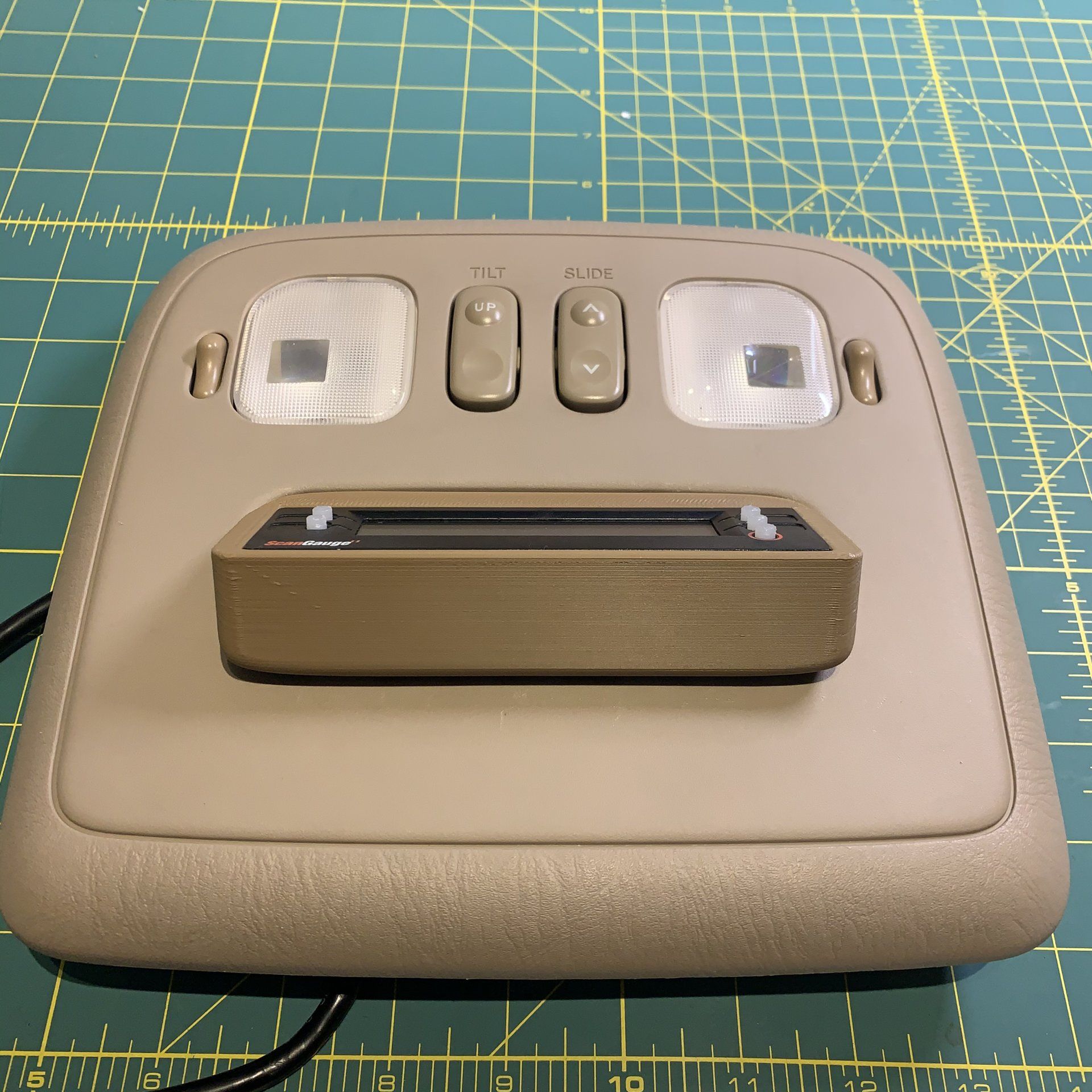

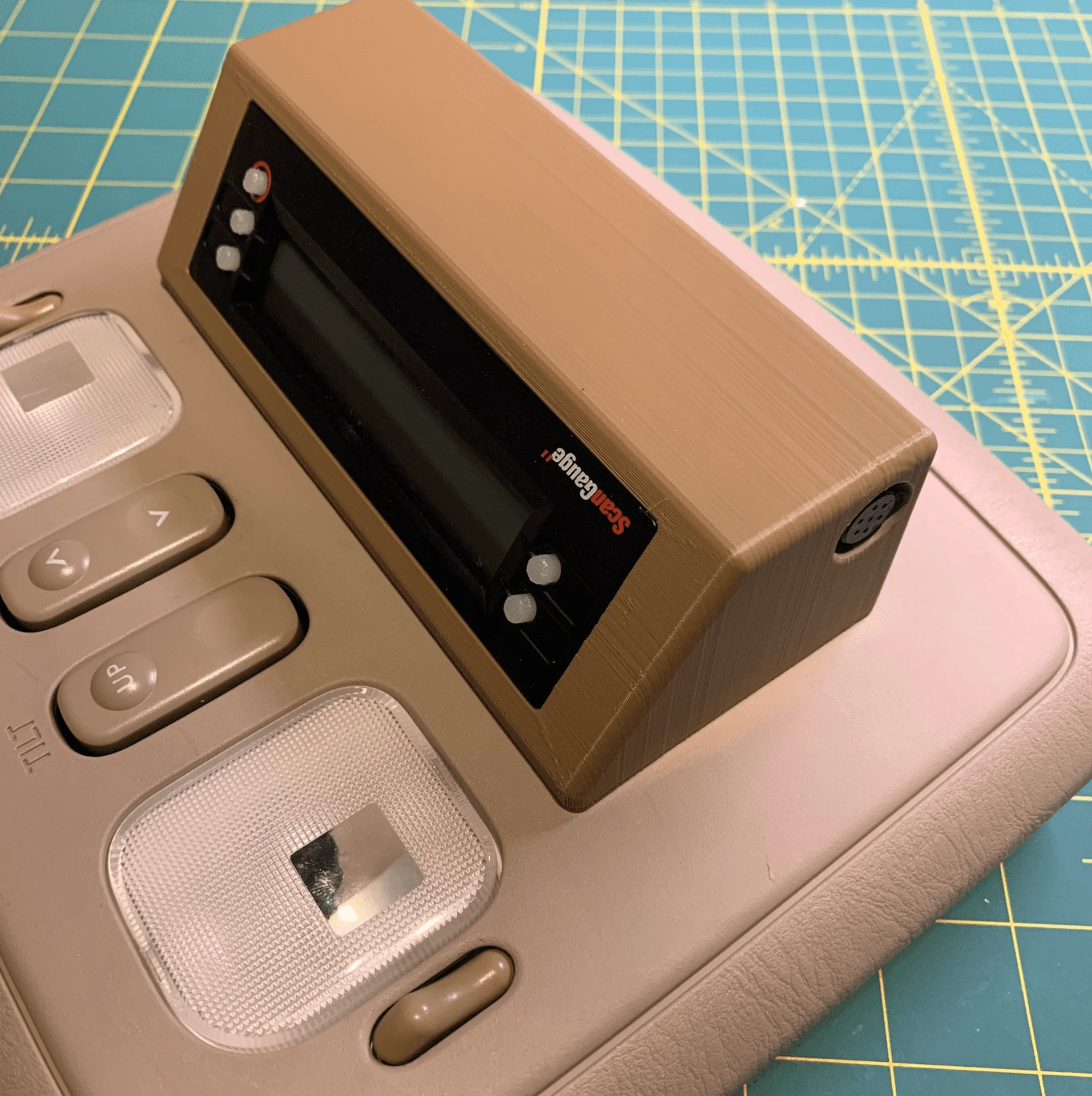

@BenCC I’ll be hitting you up for one of these soon. Will likely have a request for a bit of custom.

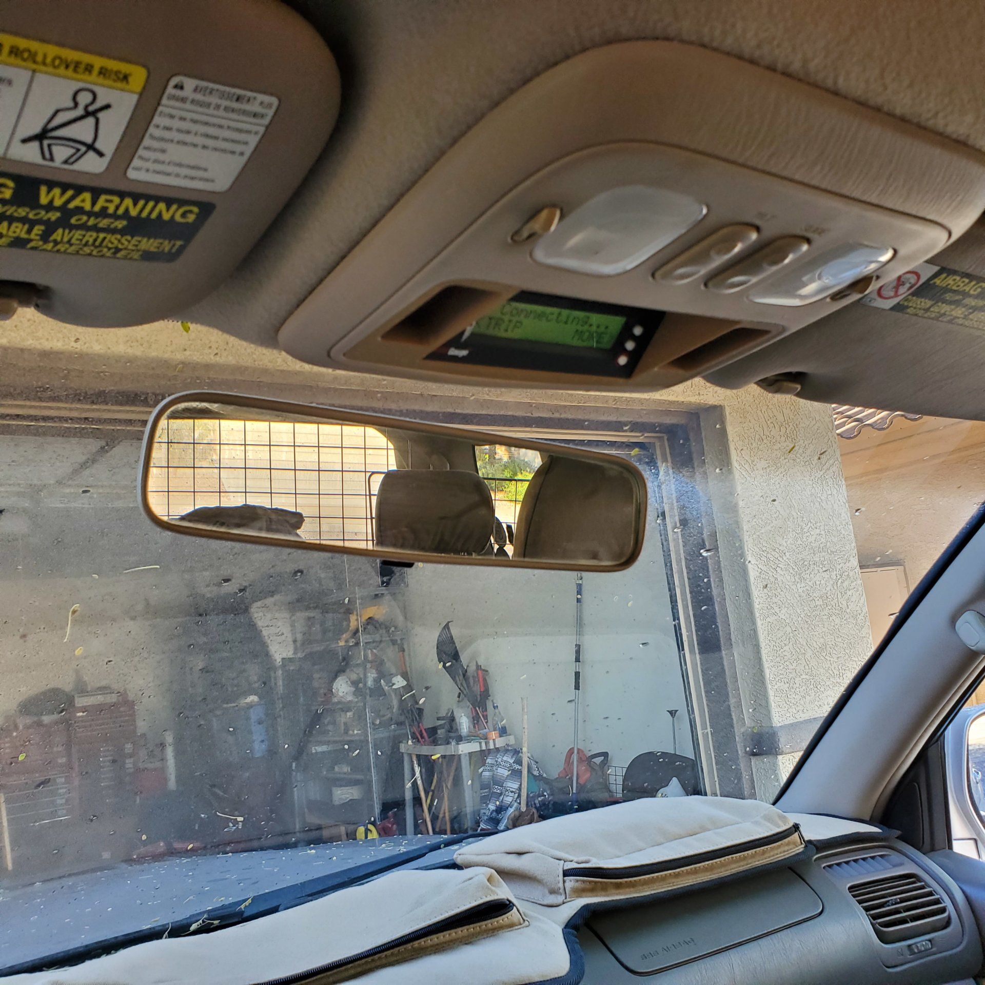

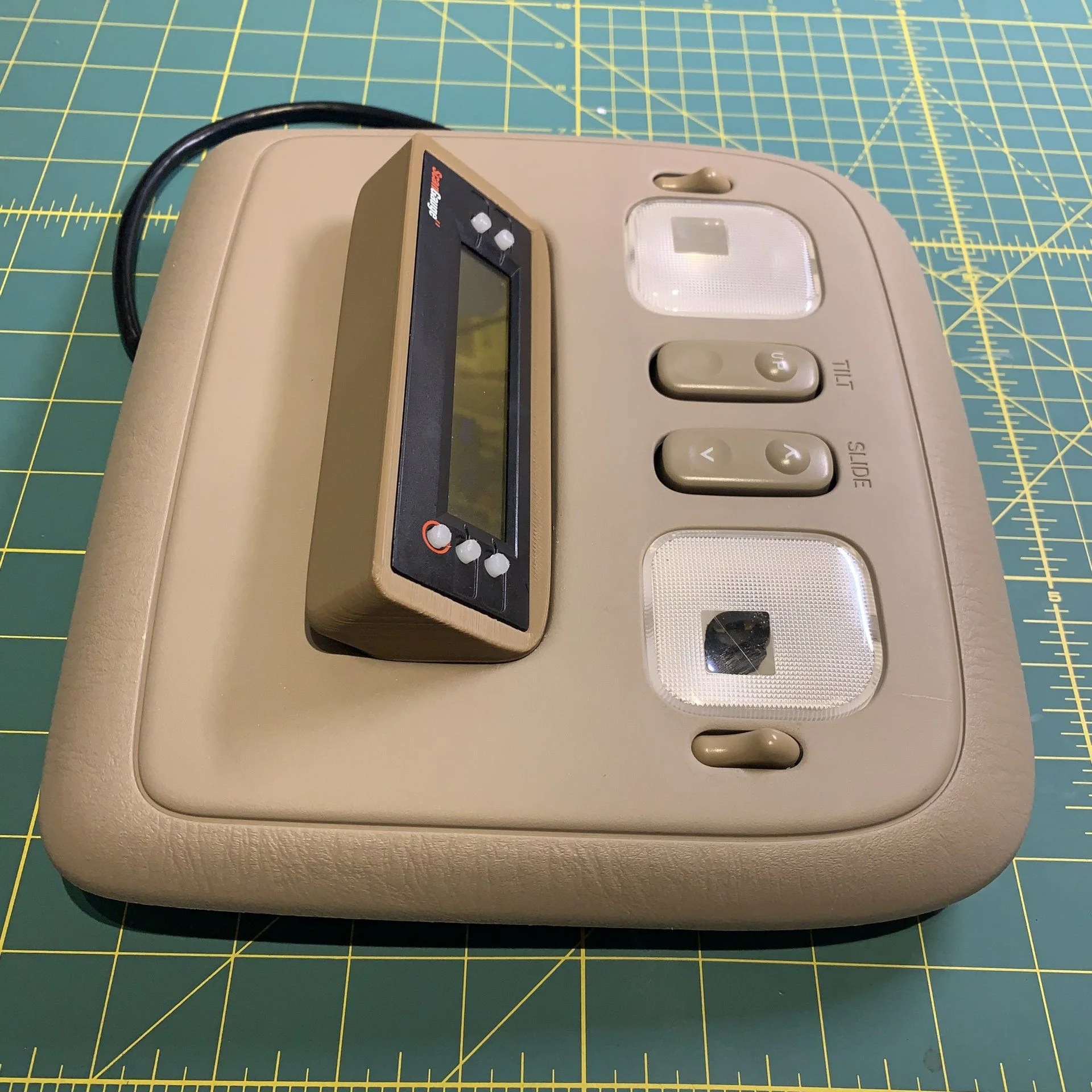

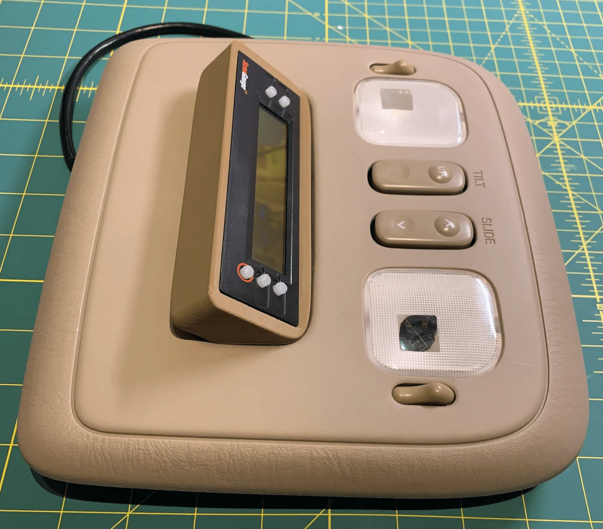

Still need to paint but this a revision Ben made based on my feedback it has a 35 degree angle and is pushed further back to clear the front ridge. It gives better visibility for taller or upright seating positions.
I tried to take a photo from my line of sight to give best representation. This is much better than before because I was losing about 25% of the top screen. If you are concerned about losing sight of the top left button then don't get one with aux button. I won't changethe buttons so the benefit of the aux and slight loss of visibility works for me
I tried to take a photo from my line of sight to give best representation. This is much better than before because I was losing about 25% of the top screen. If you are concerned about losing sight of the top left button then don't get one with aux button. I won't changethe buttons so the benefit of the aux and slight loss of visibility works for meView attachment 2153527

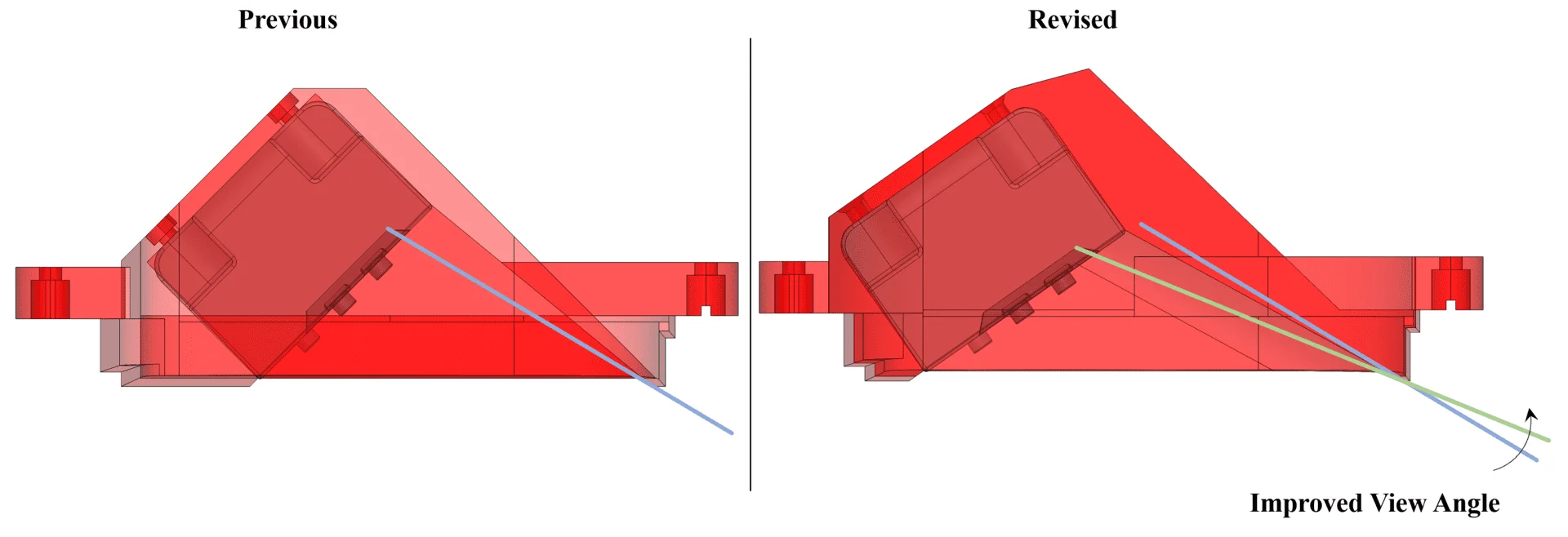

I am glad the revision works. I revised all the designs to this configuration (pushes back, and tilted to 35 deg).

Do you also have the limited view angle? If so, I can print a revised version for you and send it to you for free.
And I want to make an announcement here:
Anyone that has purchased a Scanguage mount, including Make 1, Make 5, and Make 11, and has limited view angle such as lose the top 25% screen, message me. I will print a revised version for free. Shipping is also on me.
