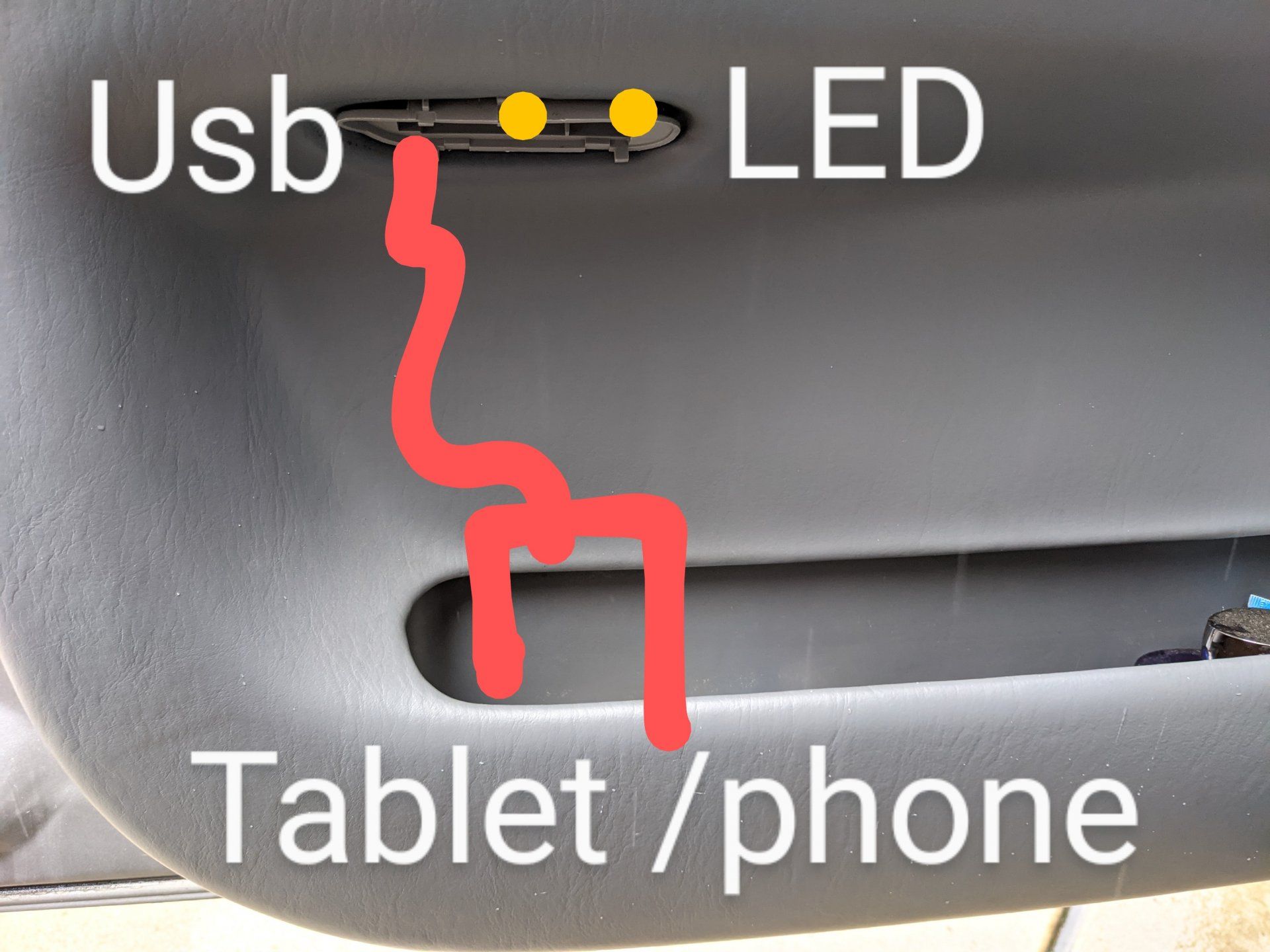

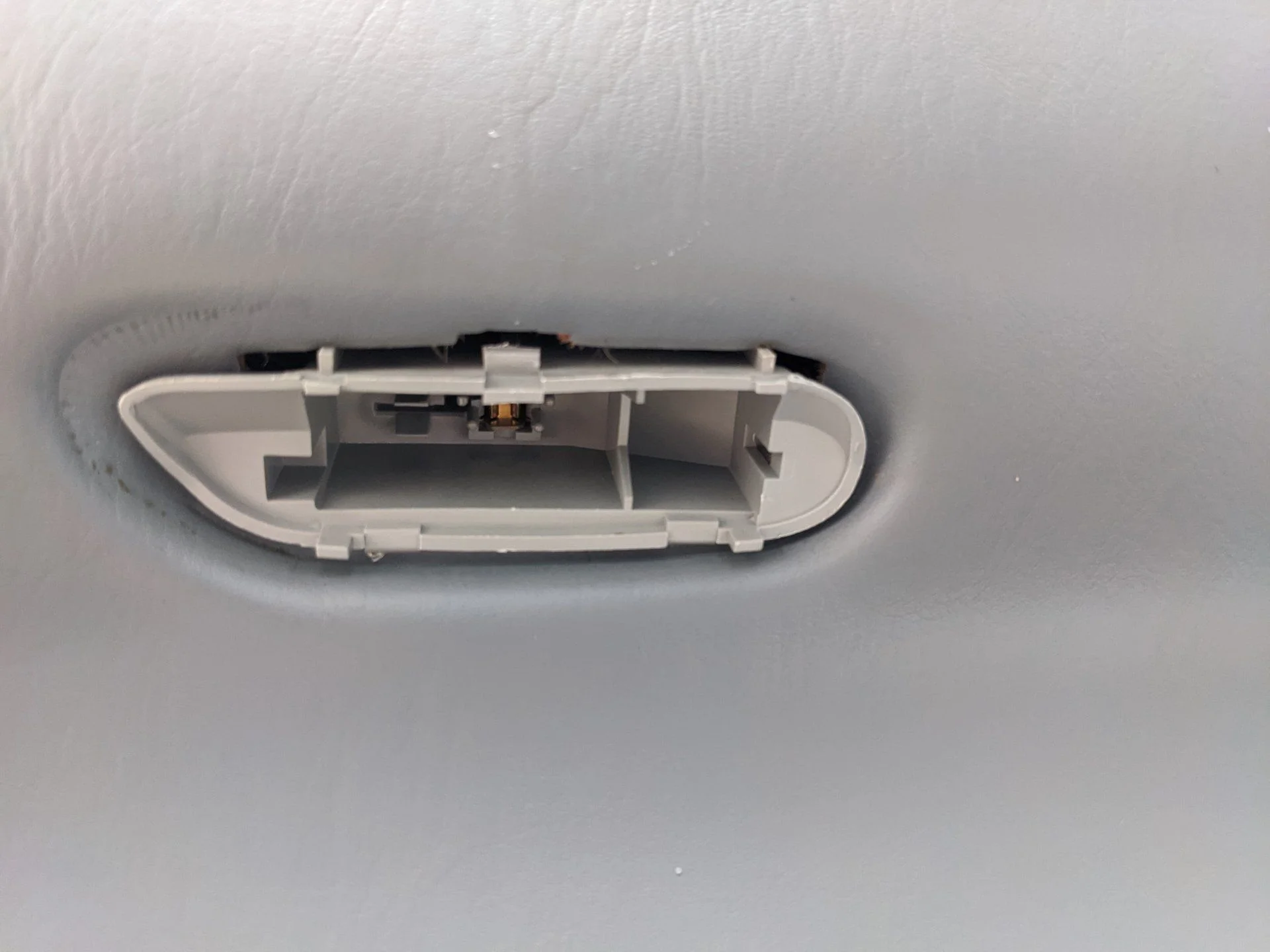

Hoping this part is next :bounce: USB/light on door light. The lenses become brittle and break the only option is to buy the entire assembly.

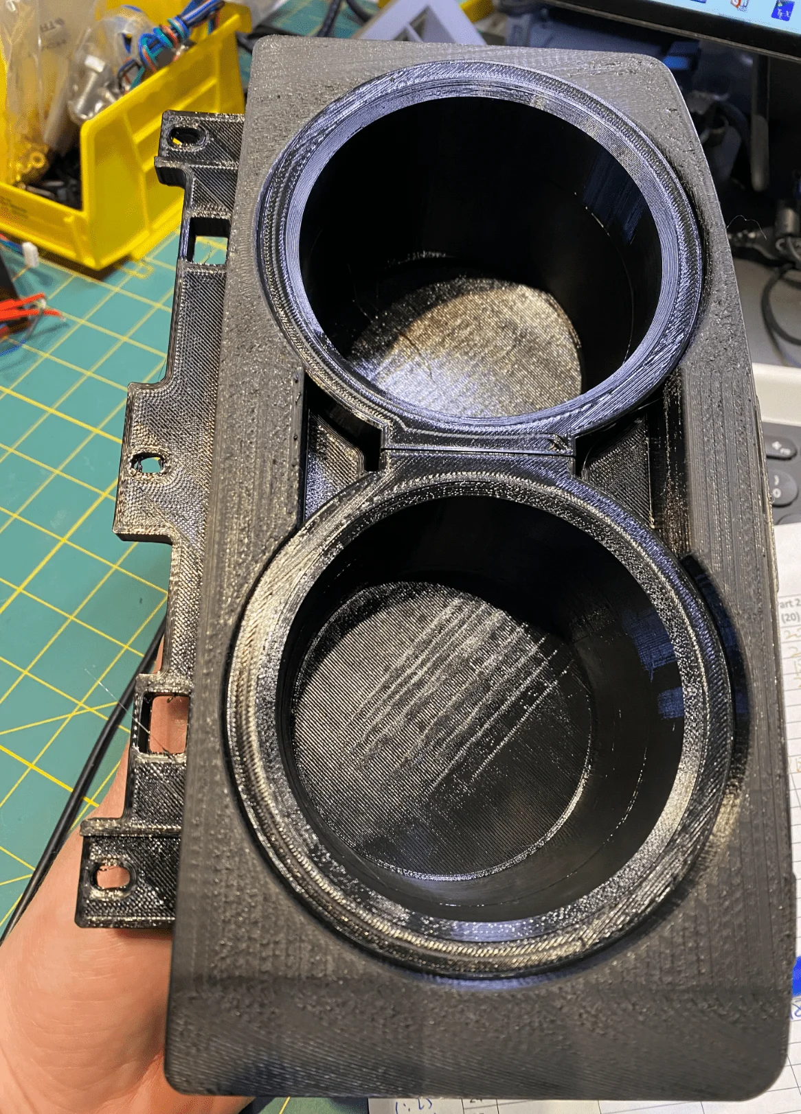

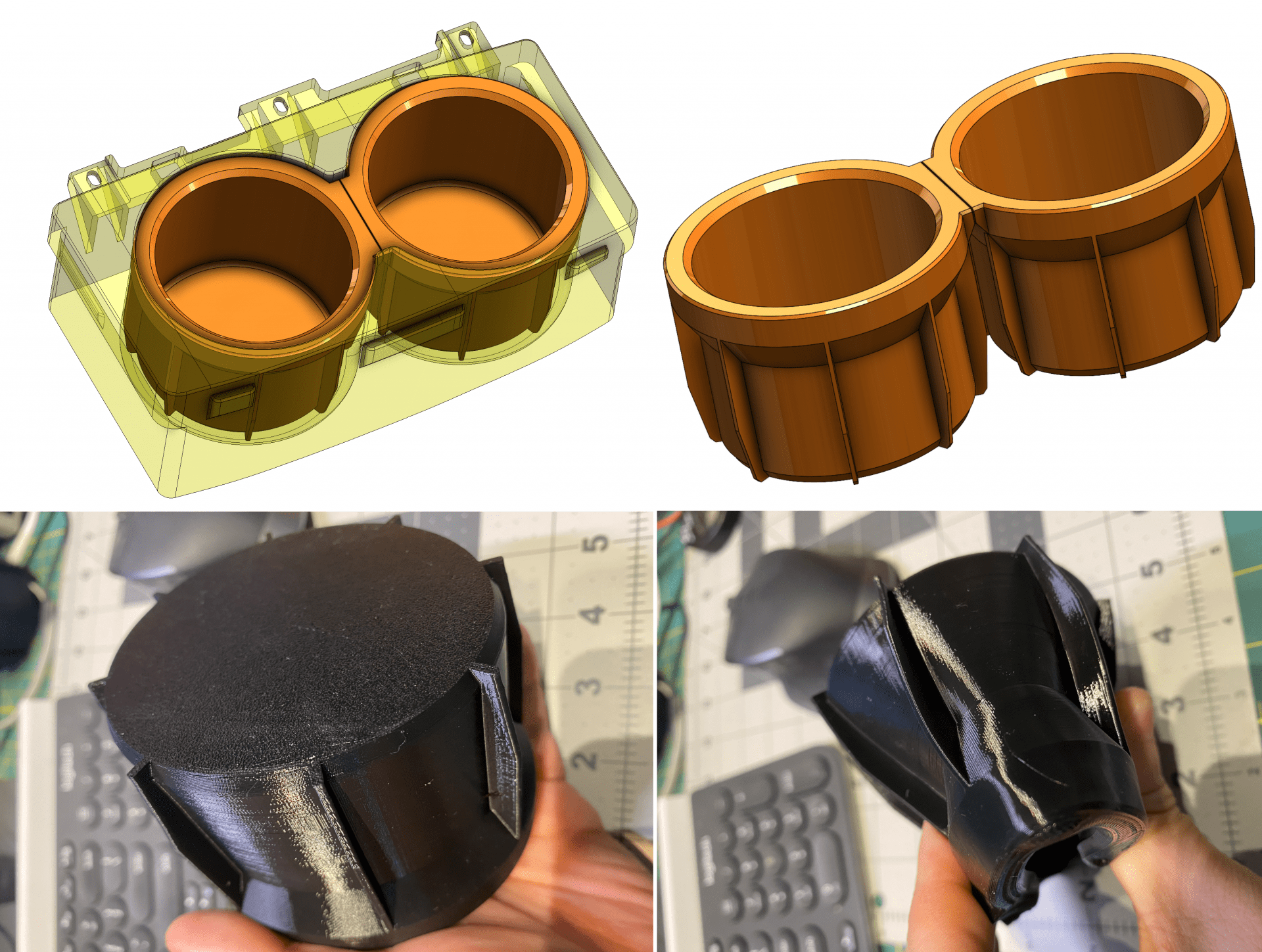

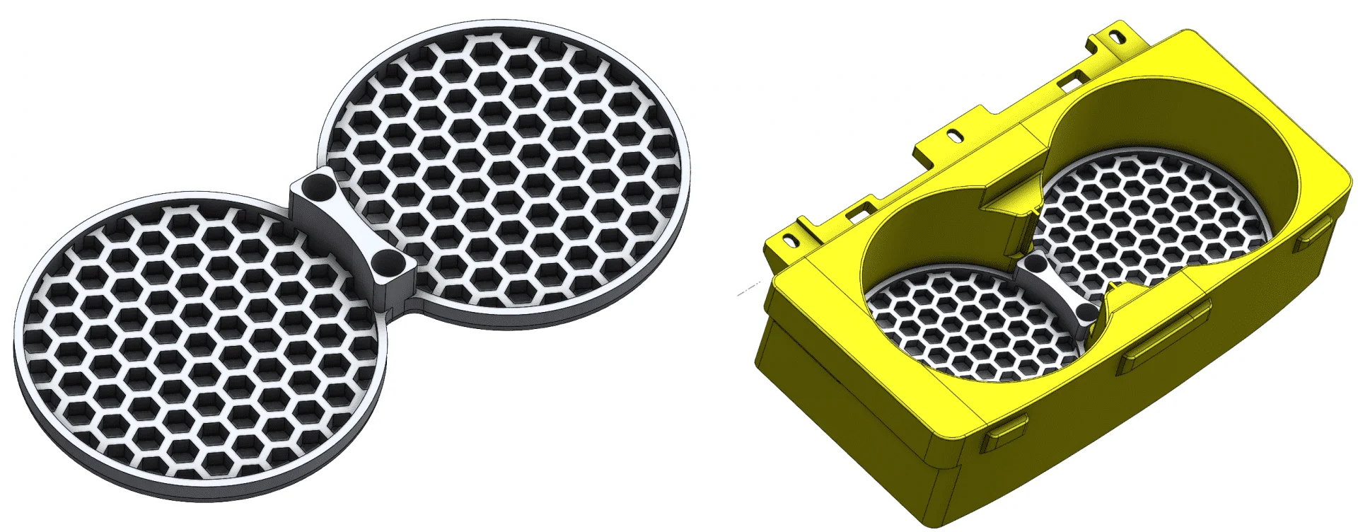

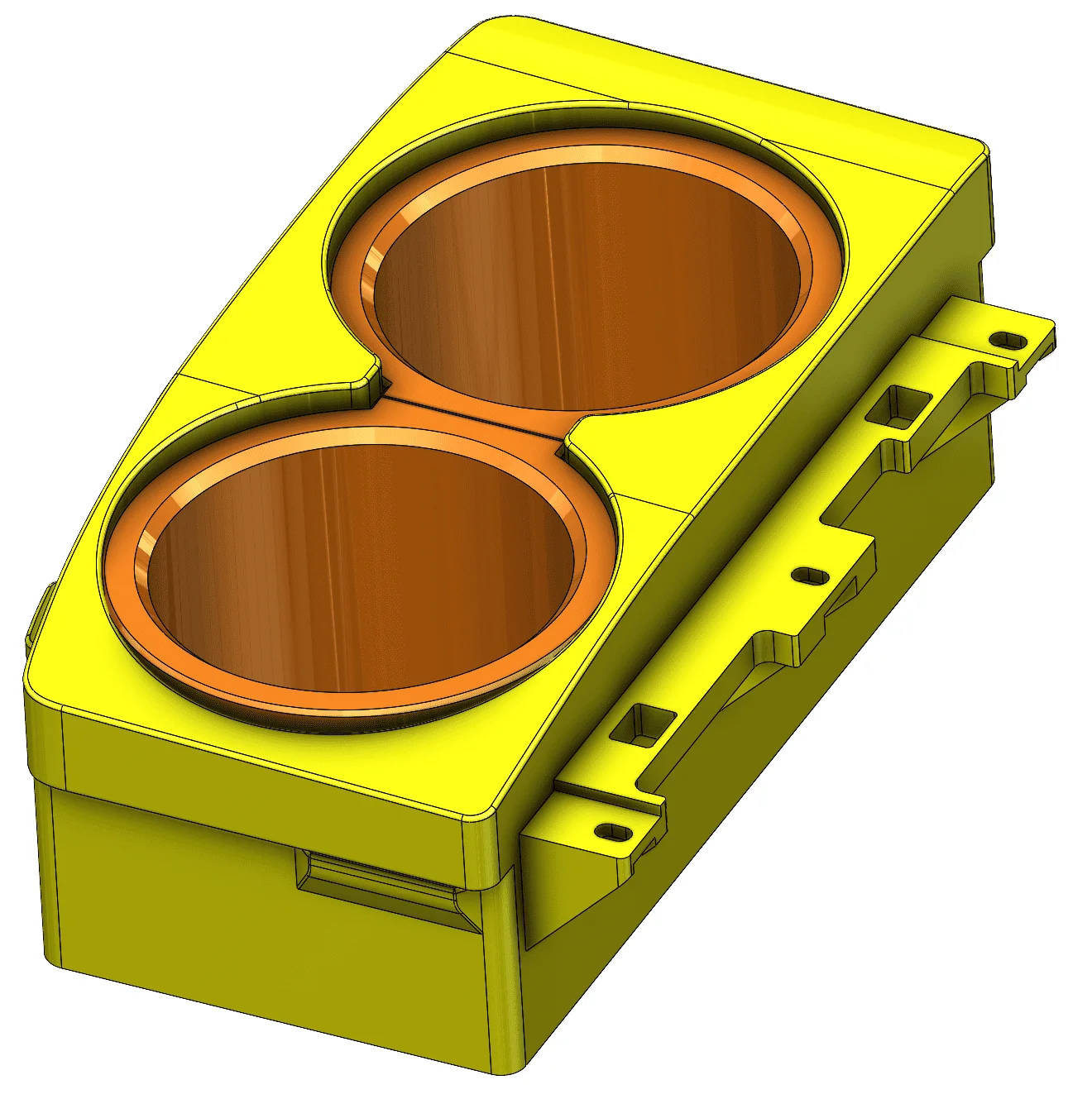

Thanks @I Lean for the feedback on the cupholder coaster. The previous design is very hard to remove from the cupholder for cleaning. A small raised feature is added in the center just beneath the butterfly. We can grab it and remove the coaster. Two holes? They are for pens or pencils when you dont use the butterfly.

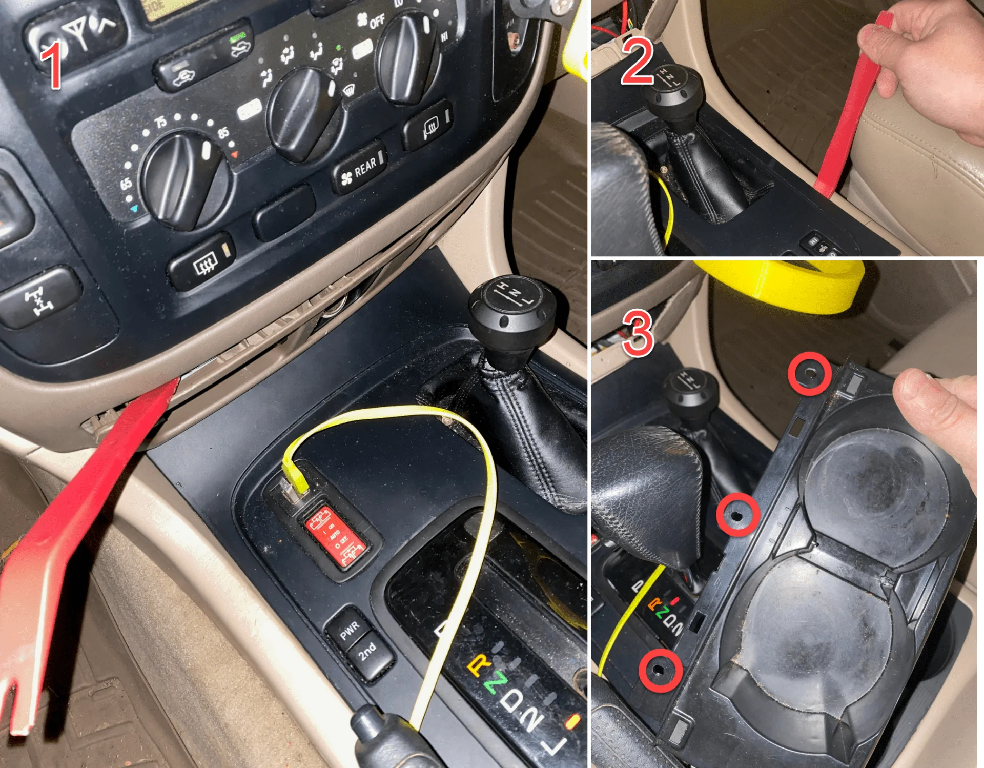

Make 28 Installation
Step 1 Remove the ashtray assembly.
Use a plastic pry tool to remove the ashtray assembly.
Step 2 Remove the center console panel.
Use the plastic pry tool to pry open the center console panel.
Step 3 Remove the factory cupholder.
Remove the three screws and detach the cupholder from the center console panel.

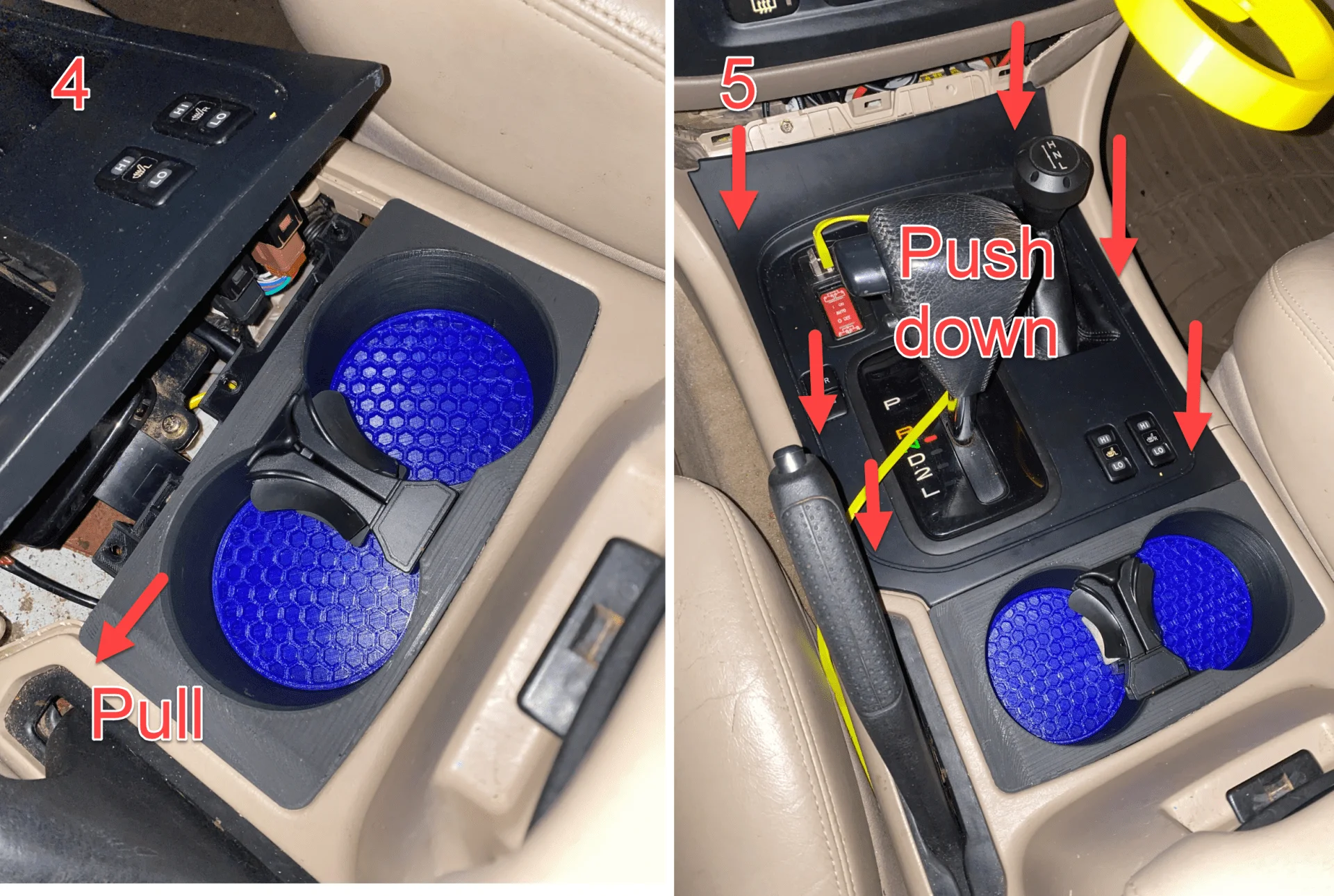

Step 4 Place M28 in place and push it down.
Pull the panel around the ebrake towards the driver seat so the cupholder can be inserted. Push the cupholder down.
Do not bolt M28 with the center console.
Step 5 Replace the center console panel and the ashtray assembly.
Push down around the panel to lock the clips.
For the non-butterfly version, I wanted to add two inserts which can hold regular sized cups.
That's what I'll need. I typically carry 1L water bottles with me (Ozarka, etc.), so I need something smaller diameter. Coupled with the deeper cup holder this would be perfect. Does a 1L water bottle fit in the insert?

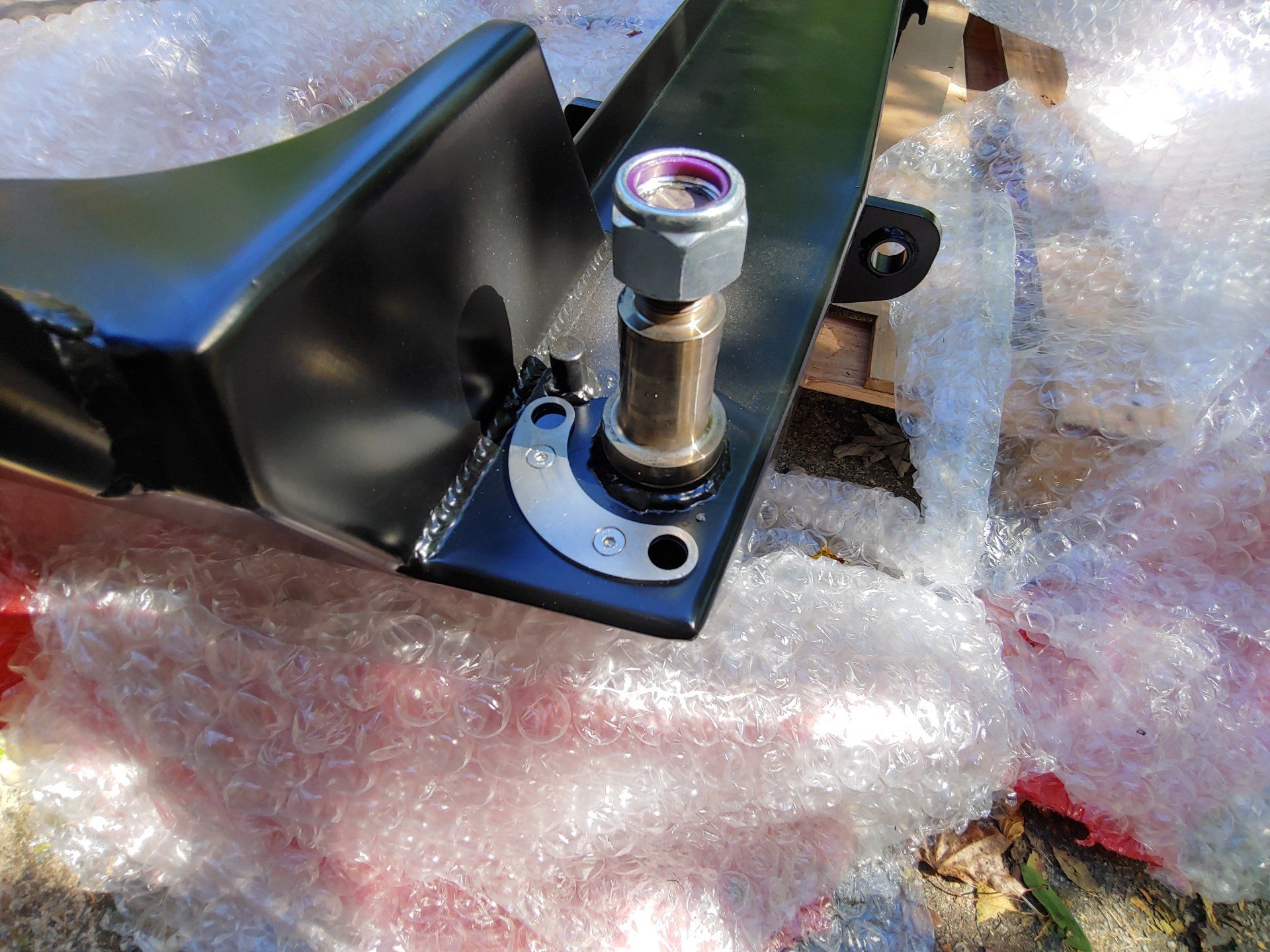

I've got a rear bumper with dual swing outs. I do not plan to, nor would I want to carry both swing outs full-time for road driving. I've searched but haven't been able to find, a cover, a condom really, to cap the bare spindles that hold the arms to prevent them from rust or other damage. Would need to be robust enough to handle general wear, handling, etc.
I'm not entirely sure how it might fasten, as the spindle is smooth and needs to stay that way. Maybe a pressure/tight fit, or some kind of soft material inside to allow it to squeeze the spindle. The lock nut could possibly be used, but I wonder if keeping the top of the condom a single, sealed piece would be best to prevent water intrusion.

The spindle is typically full of grease. Are you going clean the grease out and to re-pack the grease each time you take it off?

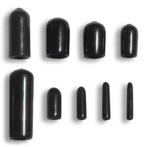

A tall vinyl cap might do the trick. Available from many places including McMaster.
I would. Once the bearings are removed it's just a residual layer on the spindle. Bearings are easy to store in grease, opening two swing outs multiple times per day sucks. I've taken to just leaving the arms open if I'm not planning on going anywhere immediately.
Great idea, thanks for the suggestion!
