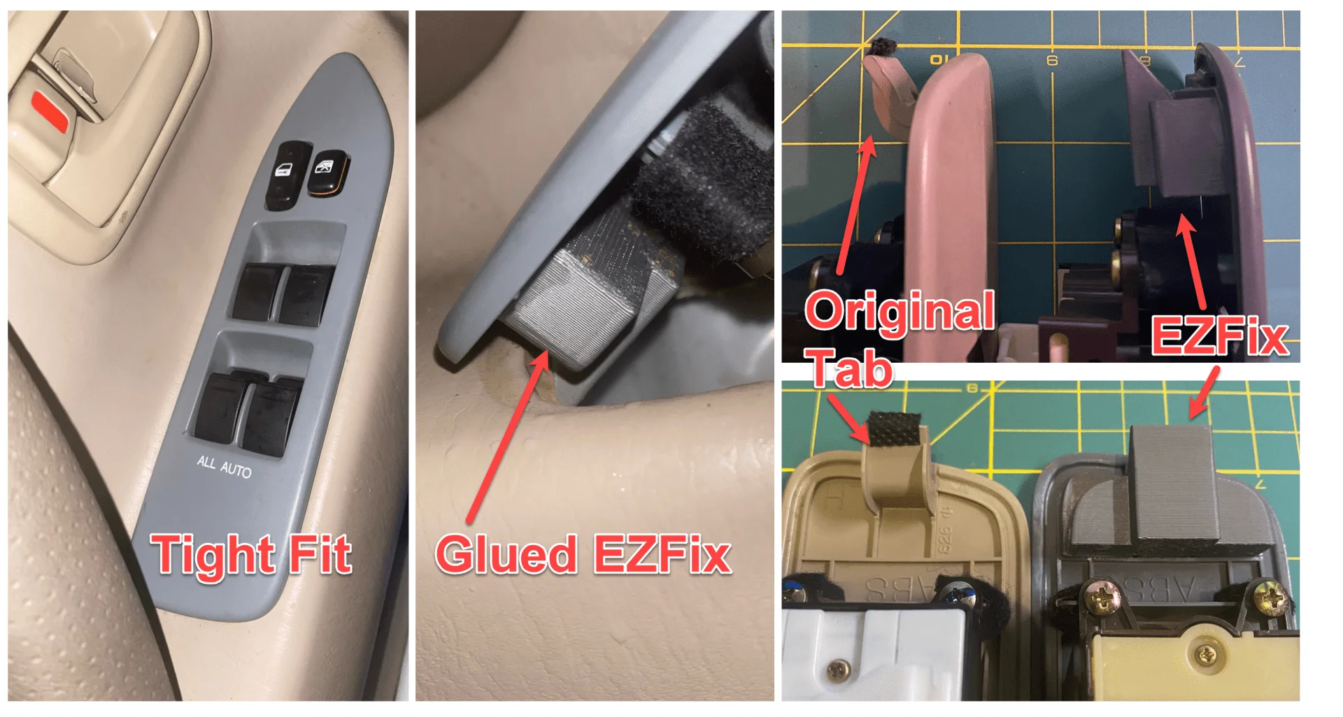

A lot of us have suffered from flimsy door panel caused by broken or deformed tab. The panel is getting harder to source and cost a fortune. The printed EZFix tab can be glued over the broken factory tab. EZFix has overall larger dimension and thicker material.
2. Glue I used:
Loctite Liquid Professional Super Glue 20-Gram Bottle (1365882)
The CAD took me about 1-2 hours. Material cost is minimum. So I will just make it free.

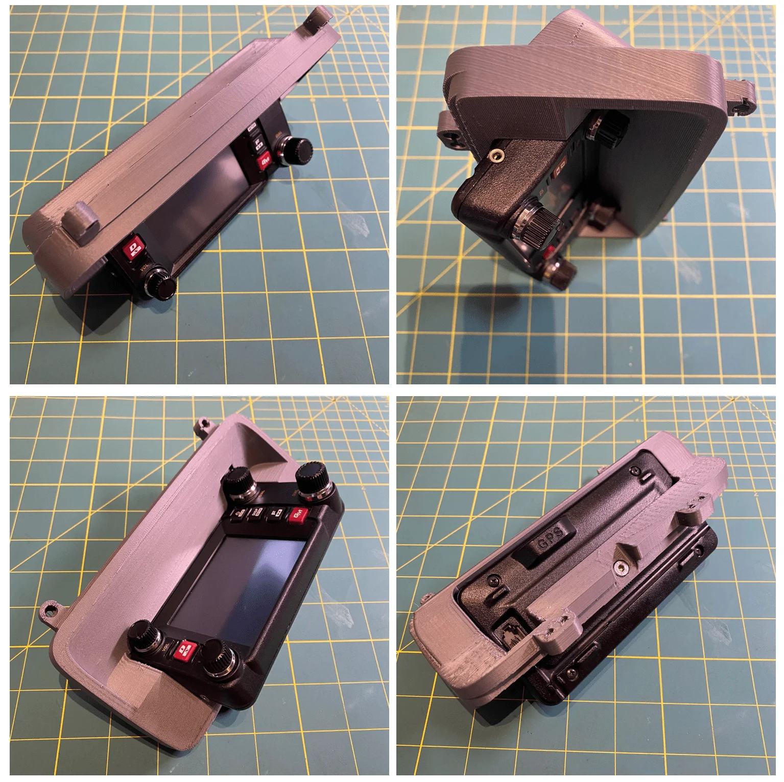

Make 23 V1 mounts YAESU FTM-400XD control unit in the overhead console. The M5 thread on the back of the unit is used. One 18-8 Stainless Steel low-profile socket hear screw (M5 x 0.8 mm Thread, 12 mm Long) is included.

So oddly enough I was looking at my switch panel this morning and it is the nose that sticks up and doesn't want to fit flush. Thought it was the rear for some reason, will investigate before I request one of the Mark 24s @BenCC .
You can try to bend the metal clip in the front a little
Yeah I gots to pop it out and see whats going on there.
