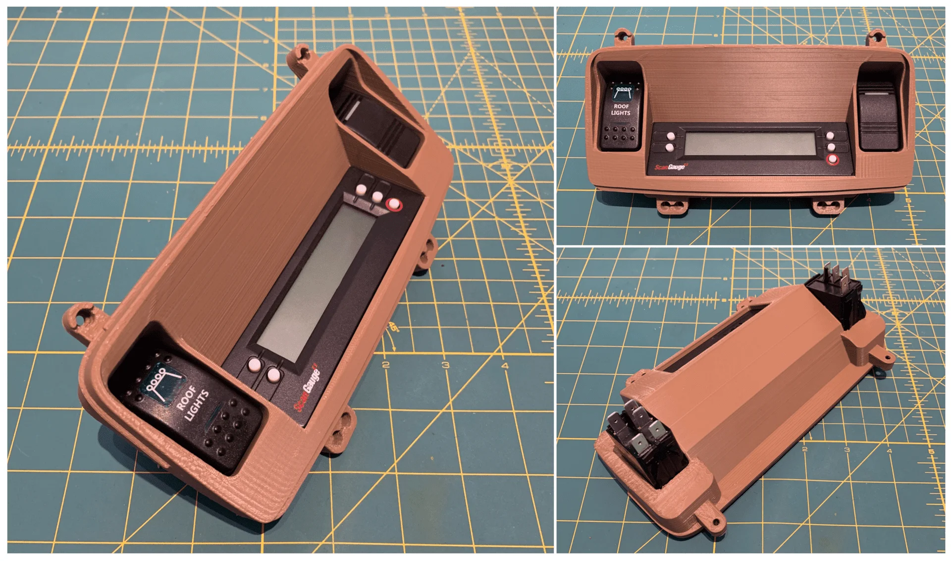

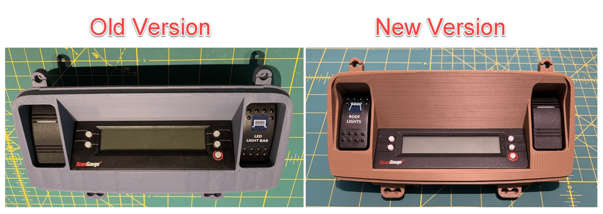

Updated Make 5 "Combo Mount". The major updates include:
1. The position and orientation of the pocket for Scangauge is optimized for better visibility.
2. The walls that separate the switches and the Scangauge are trimmed also for better visibility.
3. Print orientation is optimized for cleaner finish.
If you ordered Make 5 and want the latest version, PM me. I will send you one for free.

Does the switch locations support the OEM style push in/out switches? Rather than the rocker style?

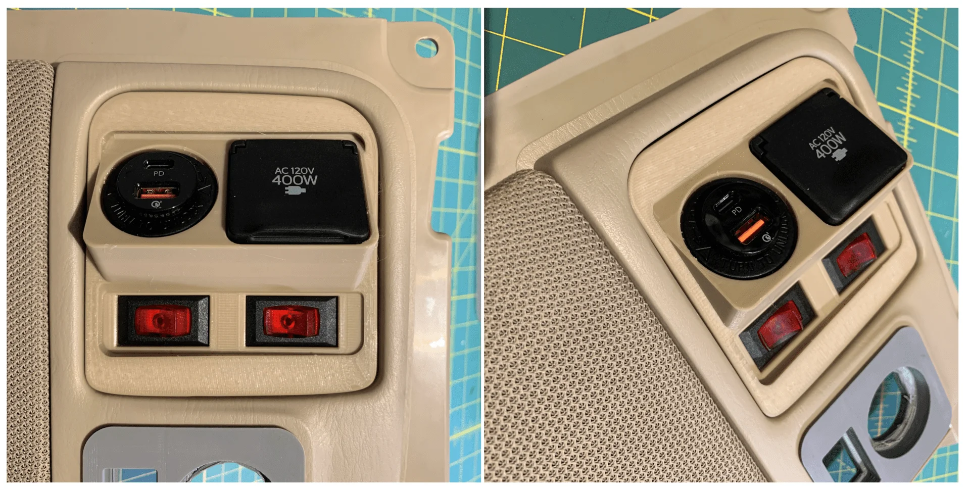

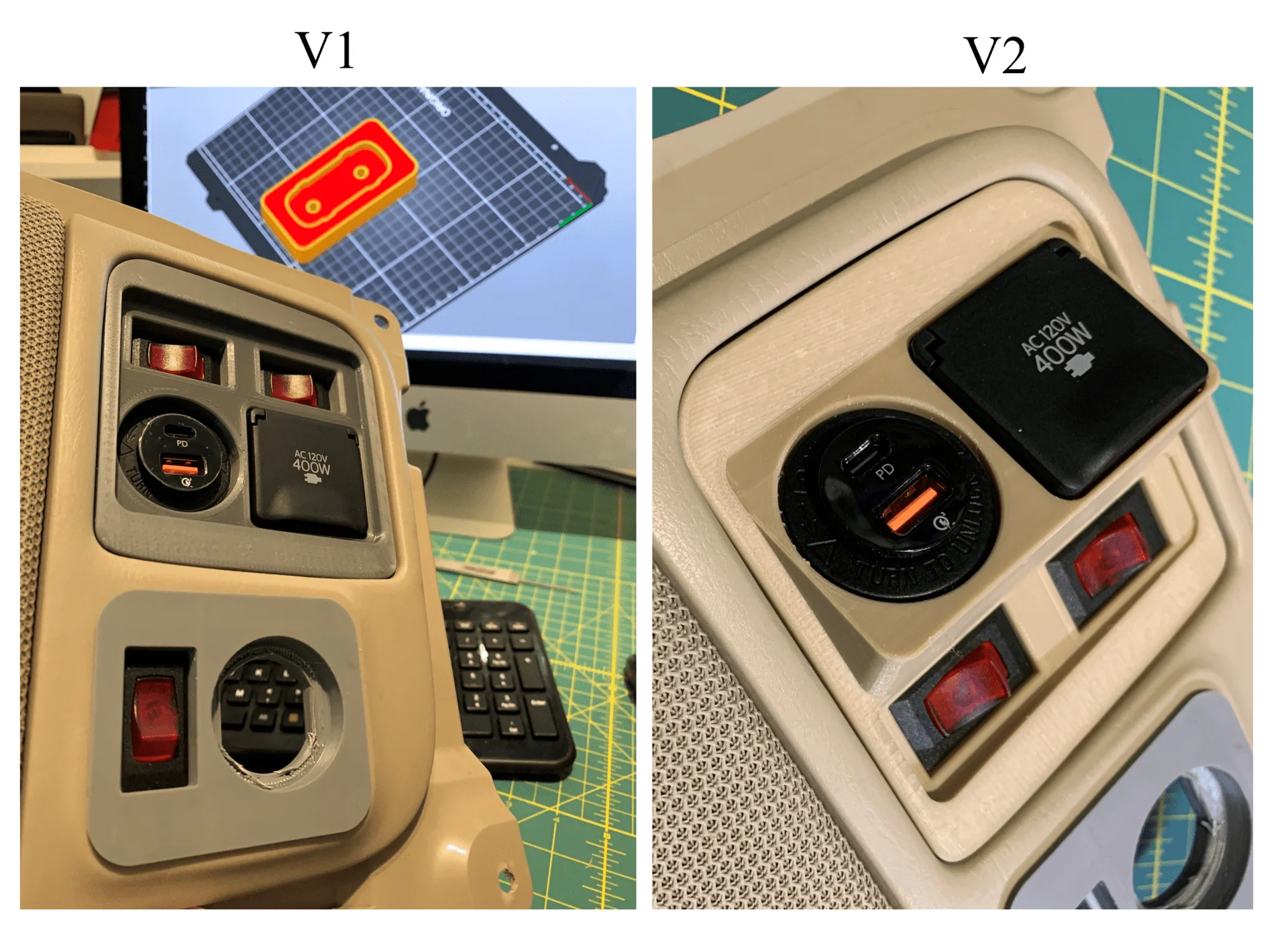

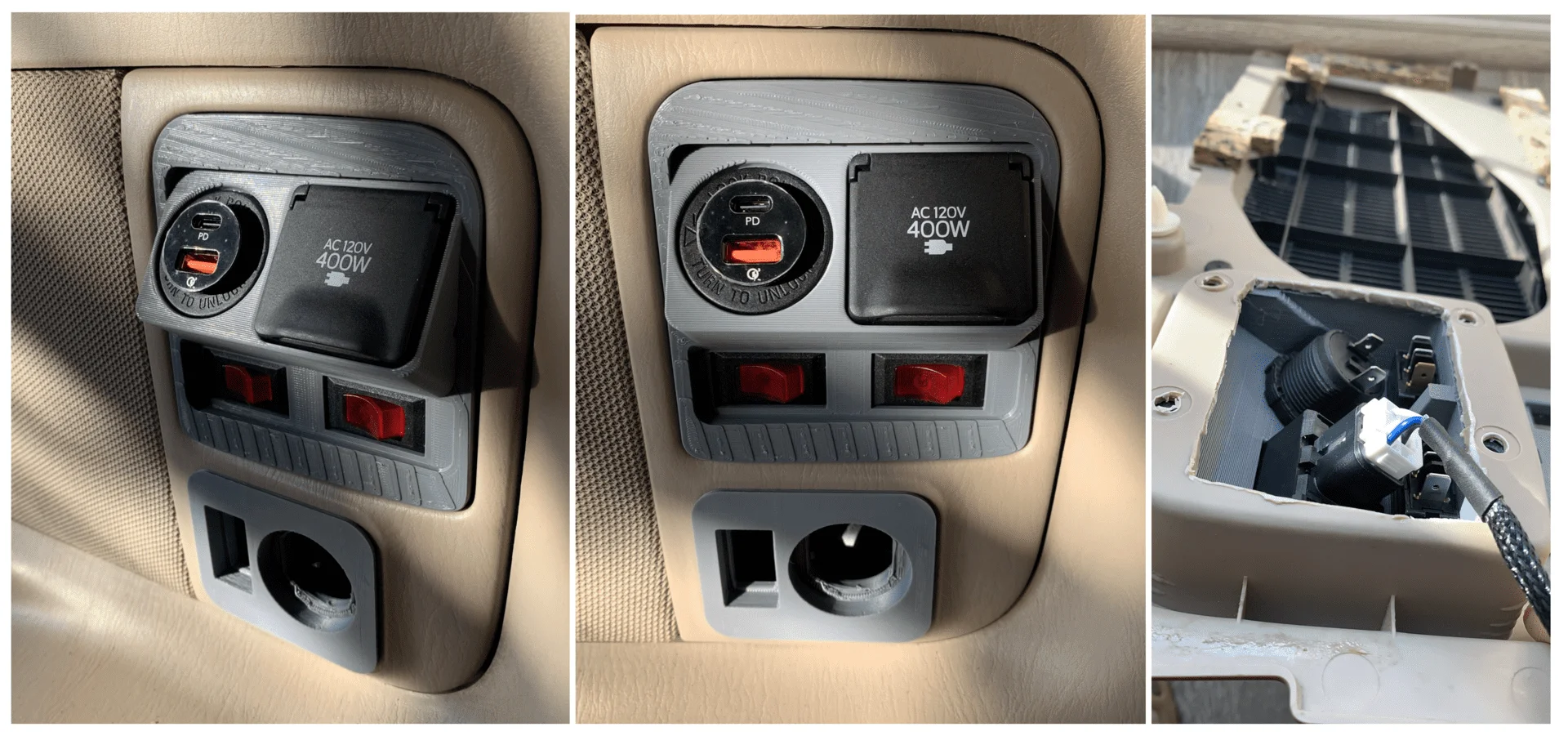

Make 18: Third Row Cup Holder Replacement Panel
18.1 Overview of the Final Product
18.2 Introduction
This make is to utilize the third row cup holder on the driver's side for power distribution.

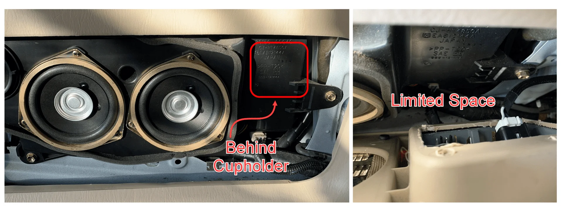

18.3 Design and Fabrication
Most of the early design effort was on matching the contours of the factory panel. More than 10 prototypes have been printed to get that right.
V1, aesthetically, is my favorite design. But when I tried to put it back on the truck, I realized that there is literally no space behind the cup holder. One part of the subwoofer sits directly behind that panel. So V1 only works if yo have already removed the factory subwoofer.
V2, is designed to clear the subwoofer. This is achieved by moving out and tilting both the 12V and 120V sockets. For both V1 and V2, an opening needs to be cut. Note: The rough finish is only on early prototypes to save print time.

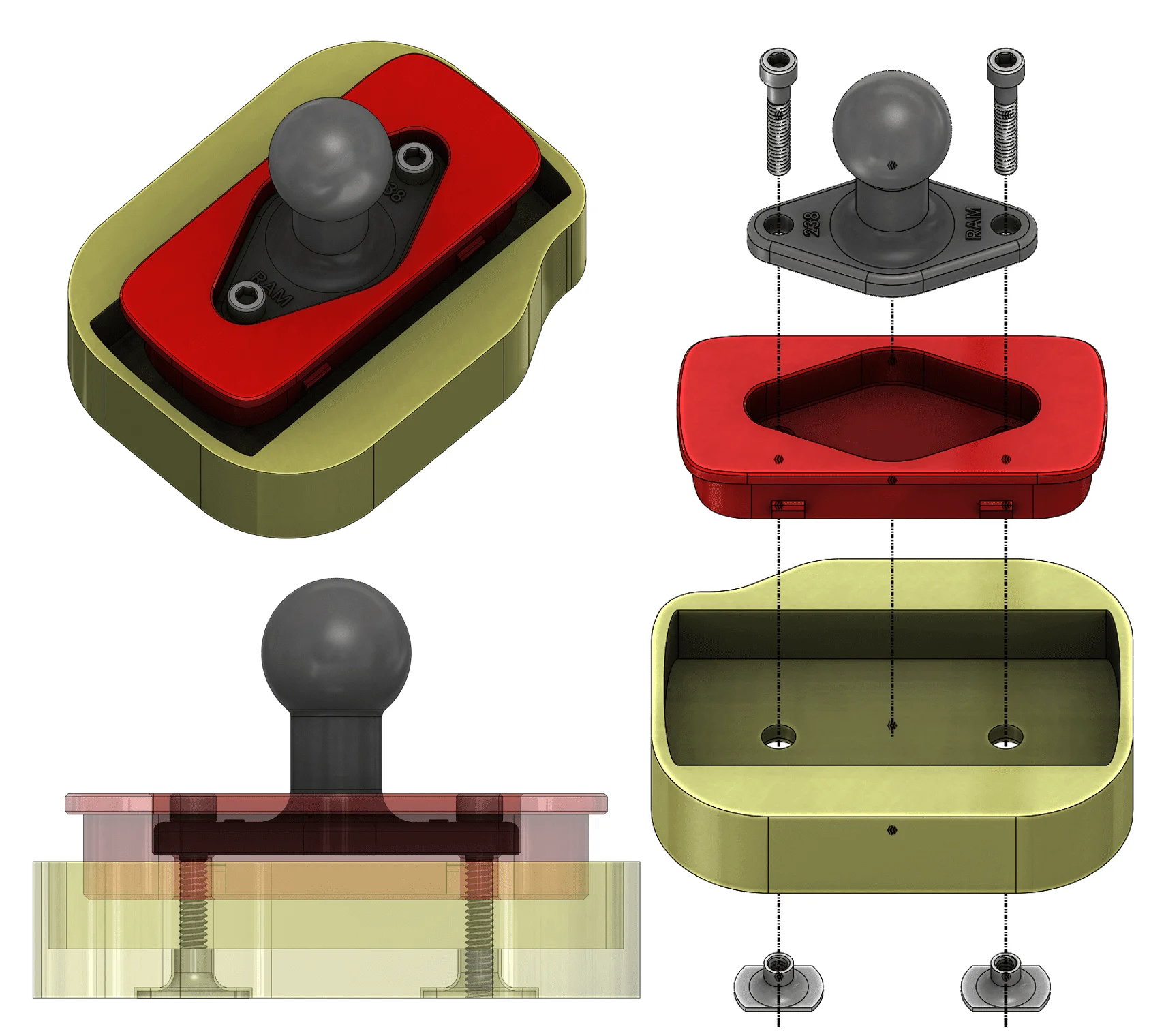

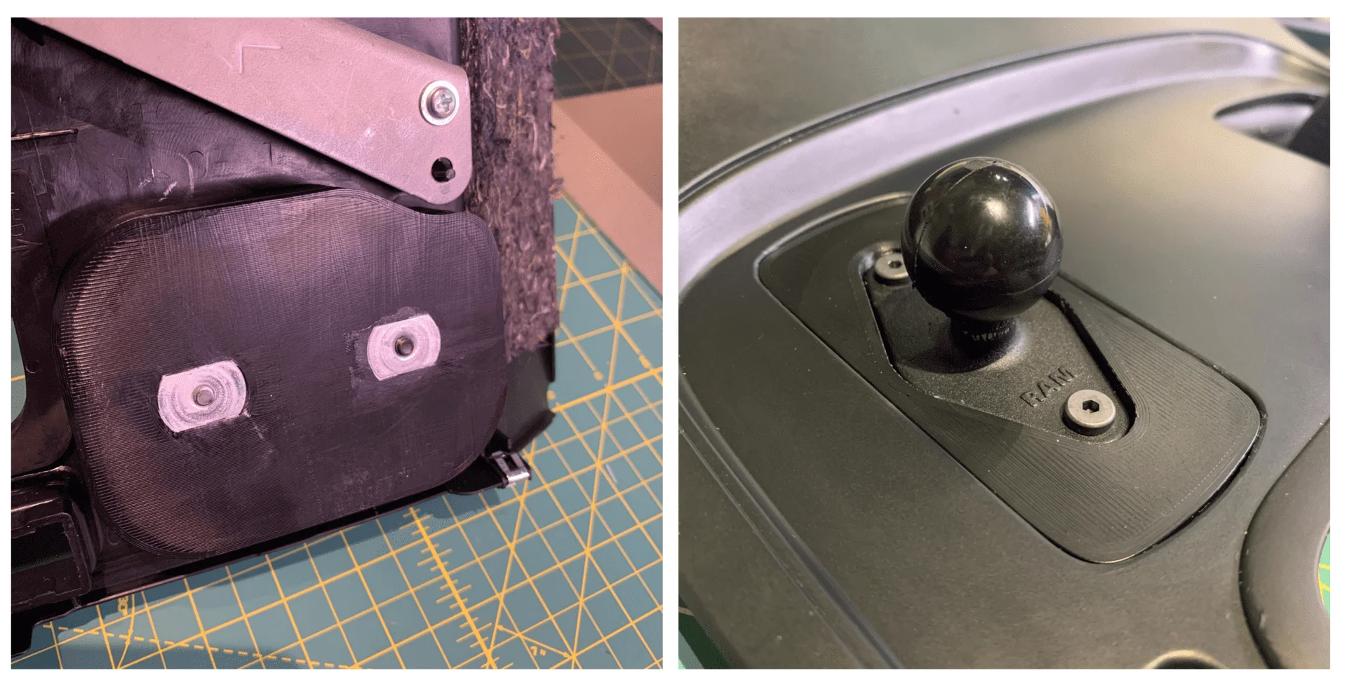

Make 6 V6:
Note: Ram ball mount CAD credit to Neal@grabcad.com (Free CAD Designs, Files & 3D Models | The GrabCAD Community Library).
2 Introduction
The original pocket cover only snaps into the main panel. If you fix a Ram ball mount directly on the original cover, with some load like an iPad, it tends to pop out. With this two-piece design, we should have a more secure fixture.
The fasteners used will be provided. For reference, they are listed here.
Steel Narrow-Base Weld Nut
Alloy Steel Low-Profile Socket Head Screw, Black-Oxide, 10-24 Thread Size, 1" Long
Note: The measurement was taken on my 2000 LC. The pocket contour may be a little off from a LX. A little bit of sanding or trimming of the part may be needed.

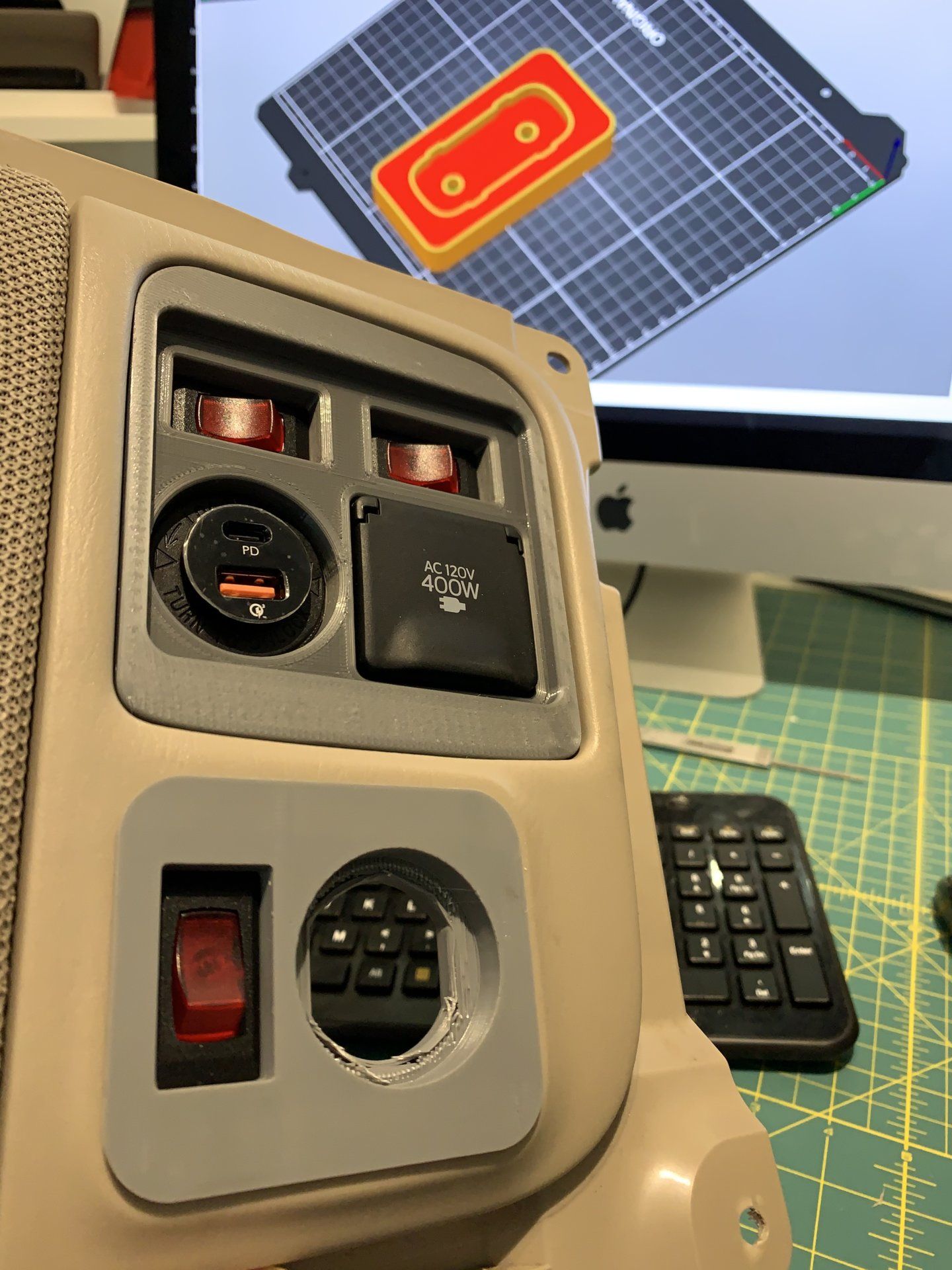

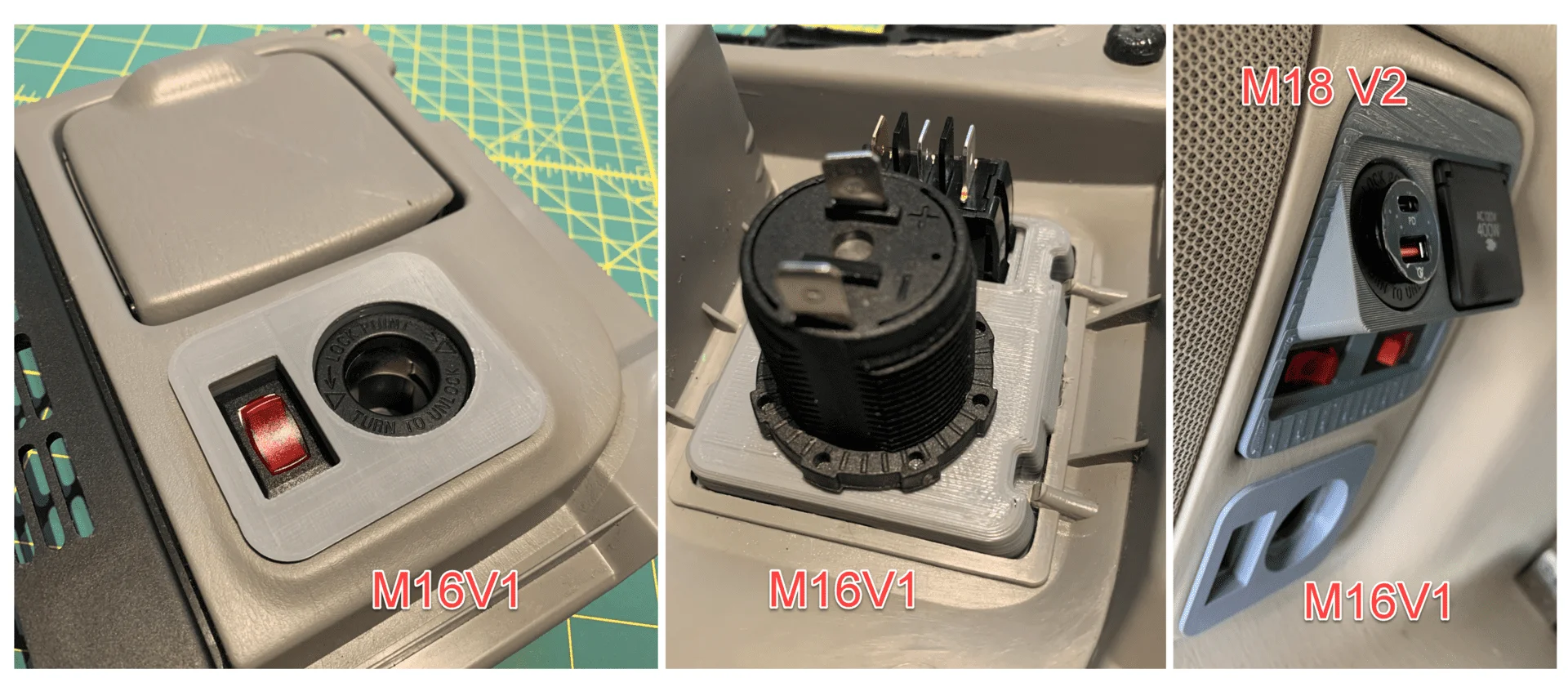

Make 16 V1: Third Row Ashtray Replacement Panel V1
16V1.1 Overview of the Final Product
16V1.2 Introduction
Make 16 V1 is a simple solution for a 12V outlet at the third row. It mounts one 12V outlet and one switch.
16V1.3 Design and Fabrication
It is a simple project. The only thing I need to say is that the switch can handle 10 amps. If you need larger current, do use a relay.

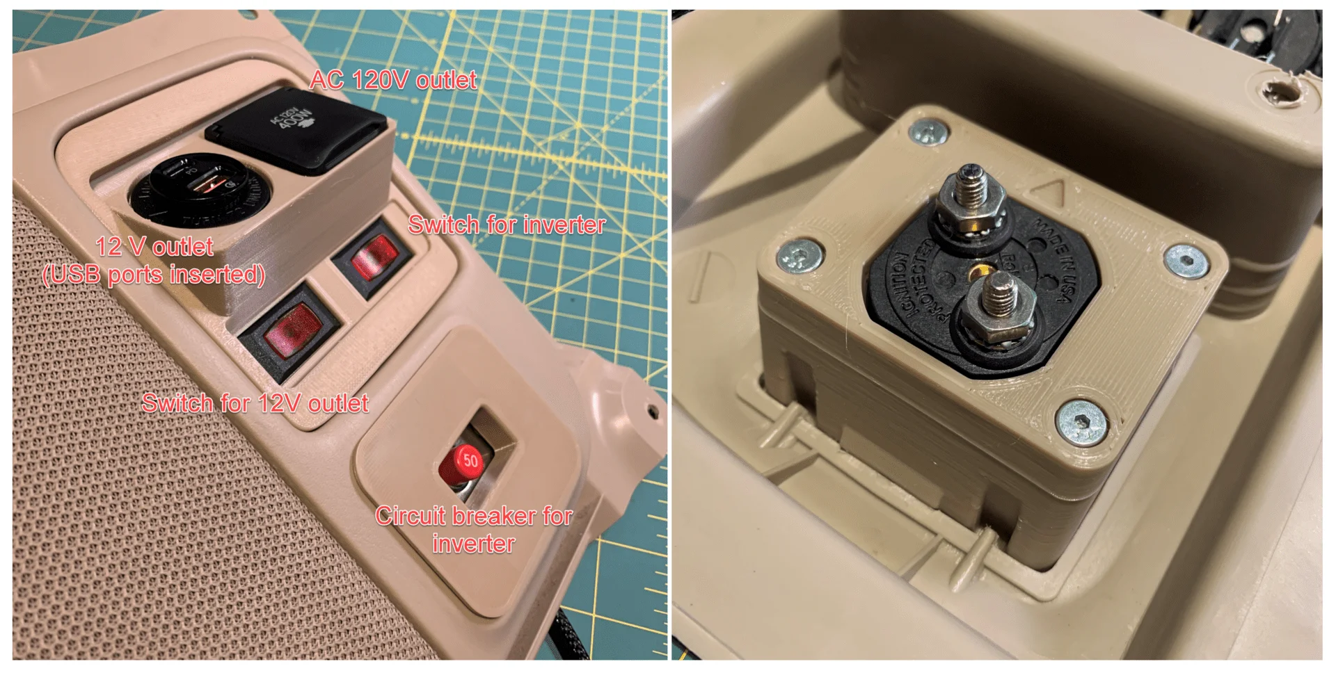

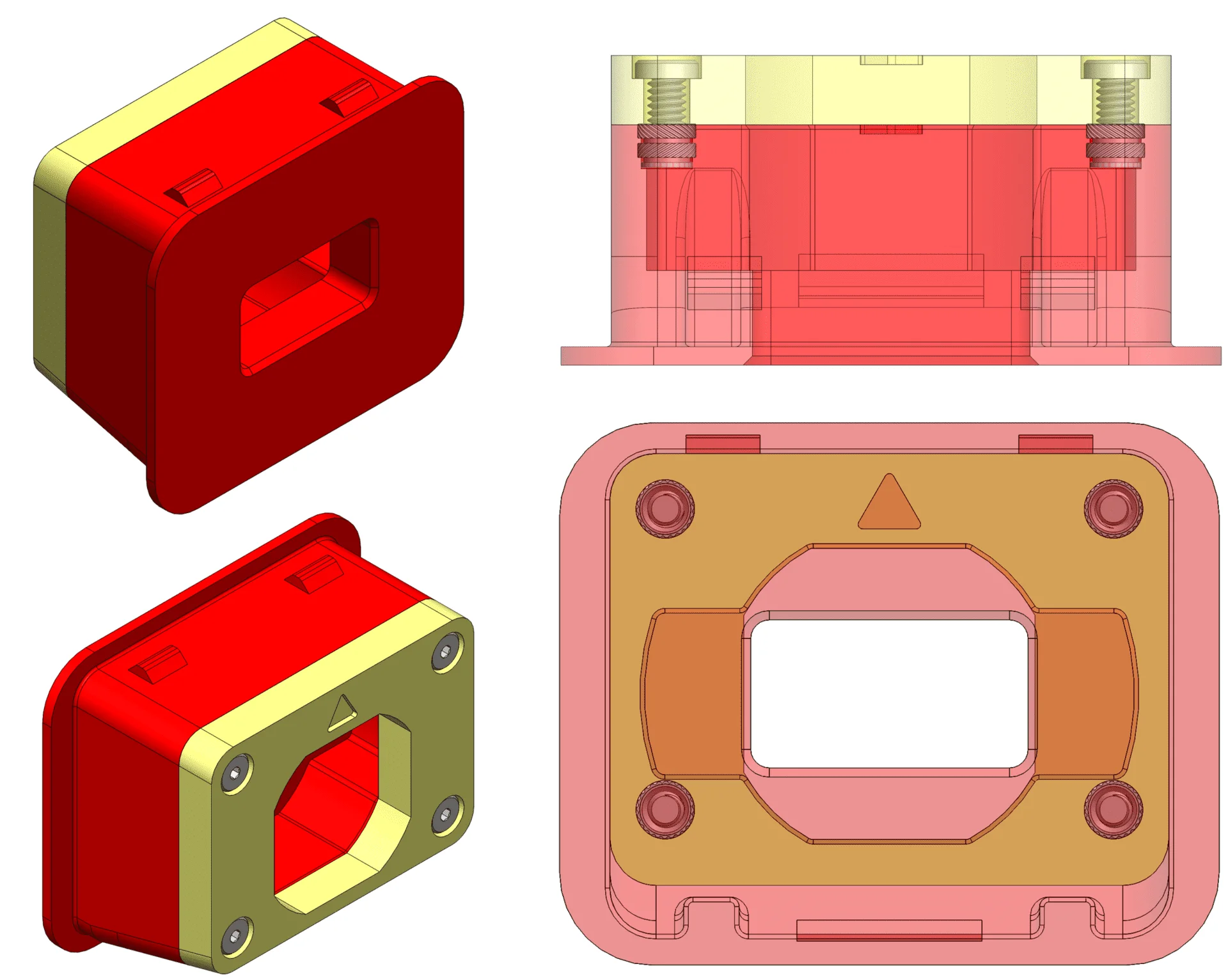

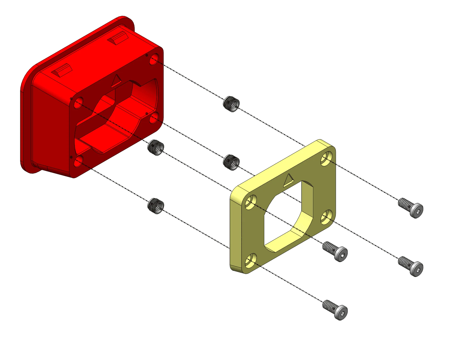

Make 16 V2: Third Row Ashtray Replacement Panel V2
16V2.1 Overview of the Final Product
16V2.2 Introduction
Make 16 V2 mounts one breaker to protect the inverter circuit.
16V2.3 Design and Fabrication
This is a two-piece design to mount the circuit breaker securely.
16V2.4 Purchase List to Complete the Installation
Circuit Breaker
(Select the current based on the wattage of your inverter).
