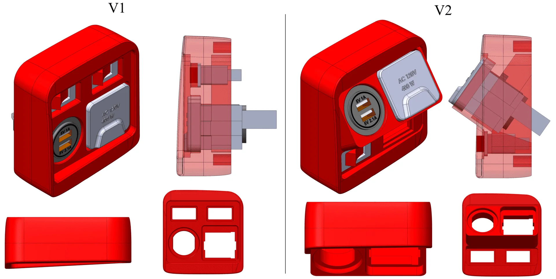

Make 18: Third Row Cup Holder Replacement Panel
18.1 Overview of the Final Product
18.2 Introduction

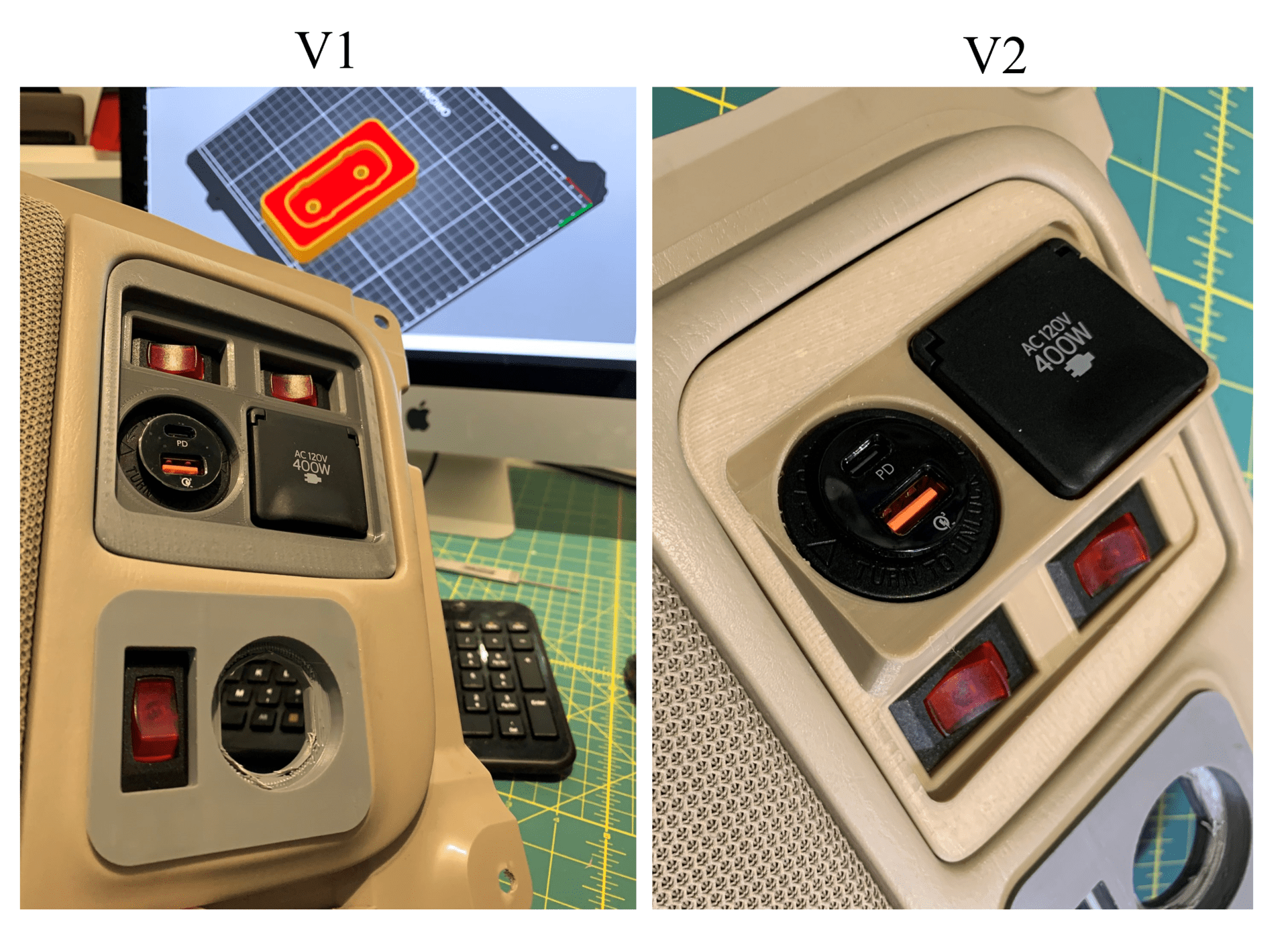

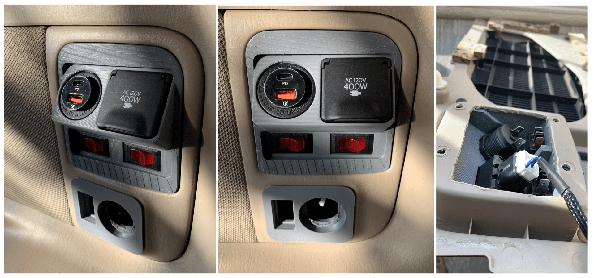

This make is to utilize the third row cup holder on the driver's side for power distribution.
18.3 Design and Fabrication
Most of the early design effort was on matching the contours of the factory panel. More than 10 prototypes have been printed to get that right.

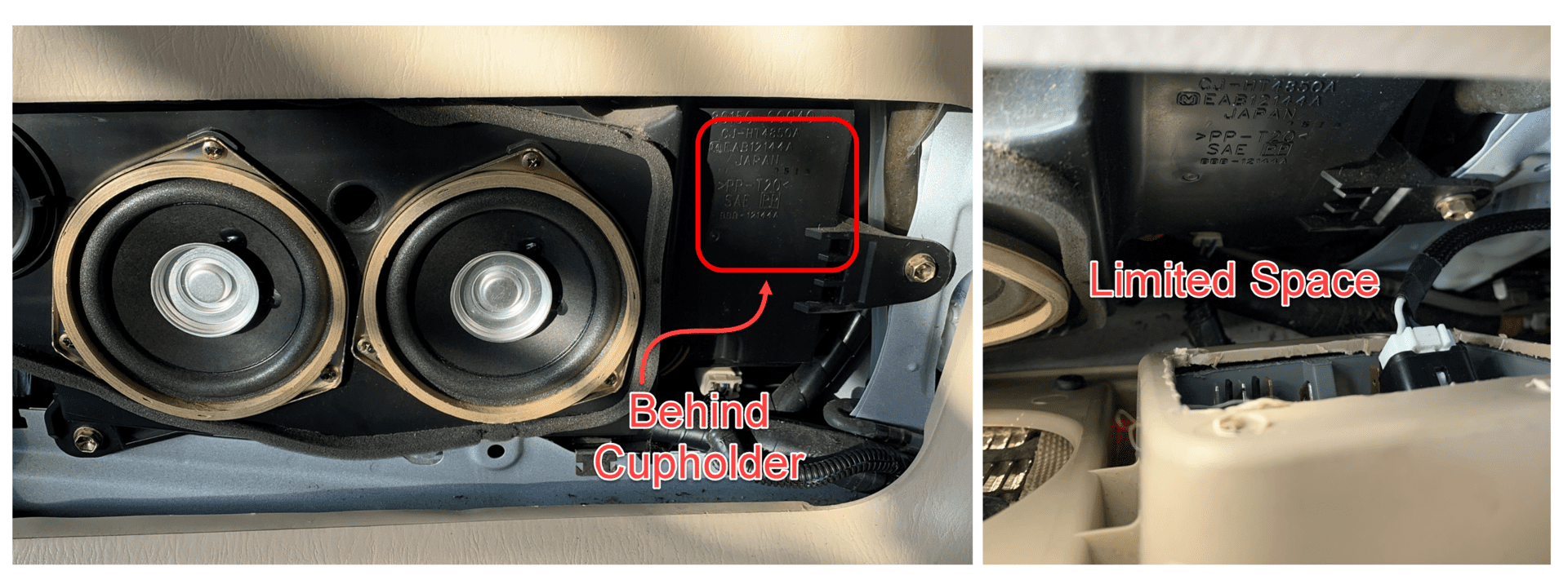

V1, aesthetically, is my favorite design. But when I tried to put it back on the truck, I realized that there is literally no space behind the cup holder. One part of the subwoofer sits directly behind that panel. So V1 only works if yo have already removed the factory subwoofer.
V2, is designed to clear the subwoofer. This is achieved by moving out and tilting both the 12V and 120V sockets. For both V1 and V2, an opening needs to be cut. Note: The rough finish is only on early prototypes to save print time.

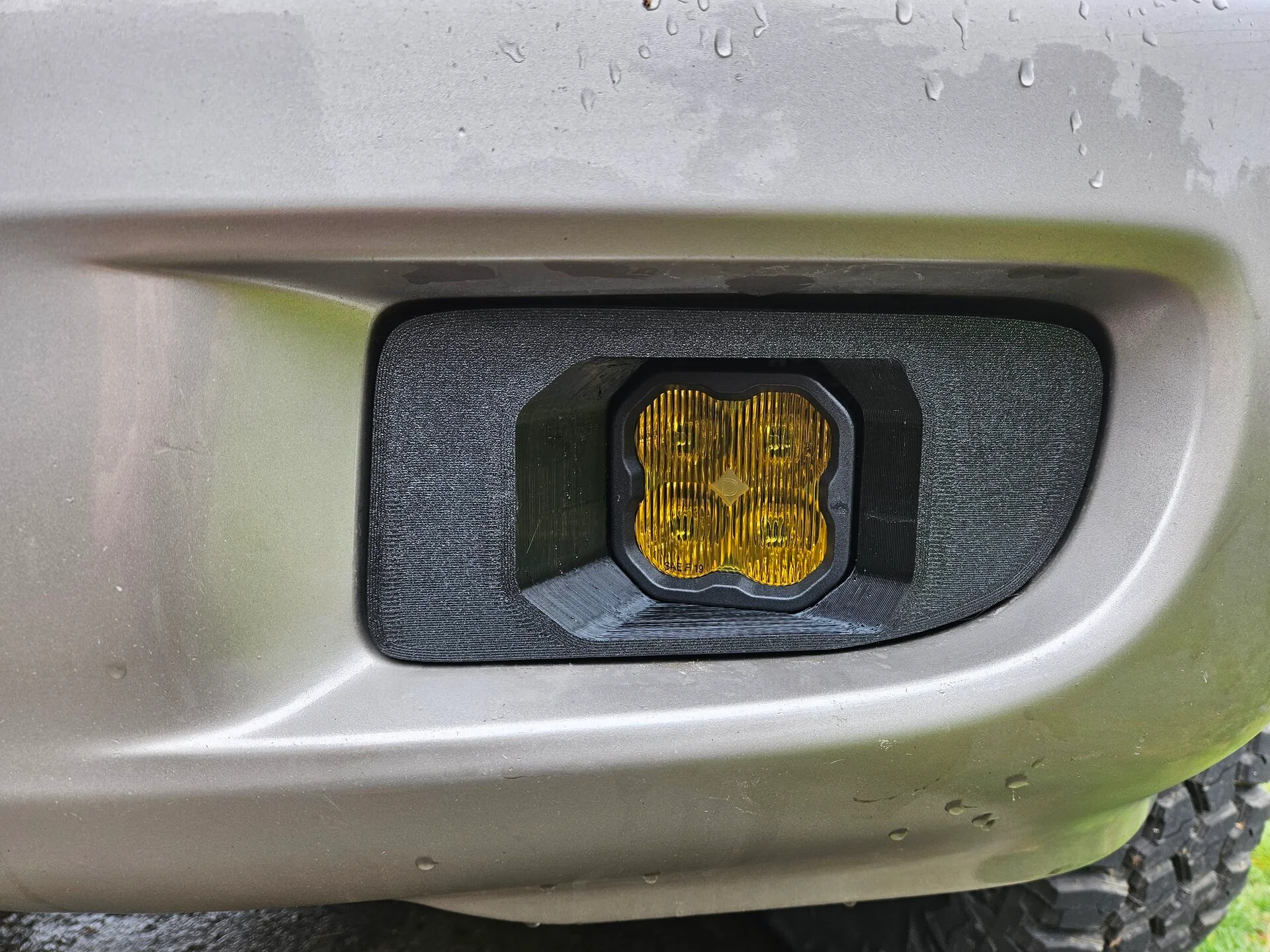

Make 19 V3: Fog Light Mount (Diode Dynamics SS3)

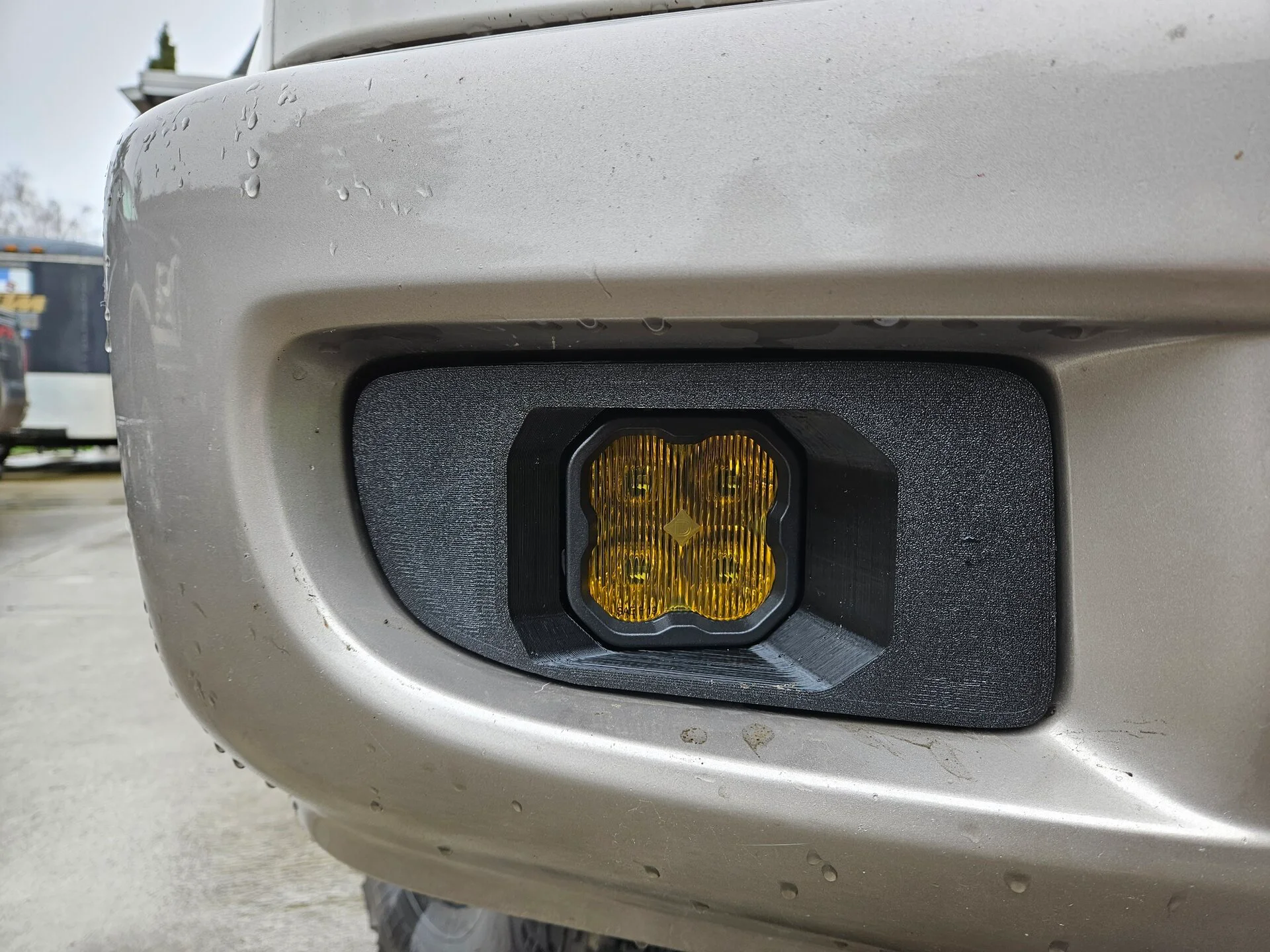

I've collaborated with Mike @98hundy on the development of a foglight mount for Diode Dynamics SS3. Today, he received the prototypes and I have some pictures to share.
More pics:
$150/pair (All fasteners included)
Shipping $12.1 (USPS Priority)

Ben was great to work with. Customized a set of inserts to me in a timely fashion with lots of communication. Quality work and very precise. Thoroughly impressed!
Very interested in this. Planning to get bumpers repainted and would probably have body shop paint these to match. What's timeframe for production? Looking forward to seeing light spread/throw and possibly option to angle them outward slightly depending on how mounting works.
We have to wait for Mike to do the test. Once I have feedback from him, I will do some final adjustment.

I'm stoked on the results. I do need to get them out in the woods/snow to see how they really do in the dark. These shots were taken in the city but with these plus new depo headlights, the light output is MUCH better.
These are the DD pro's in selective yellow, with fog lens. I have the DD sports on my tacoma, and the pros are noticeably brighter. The pros also can melt snow vs the sports, which I probably need to upgrade on the tacoma.
Two pods in fog area might be over kill if being used around other cars. If plan on using as an aux beam only, the more the merrier!
I'll post more shots when I can get out of the city!
