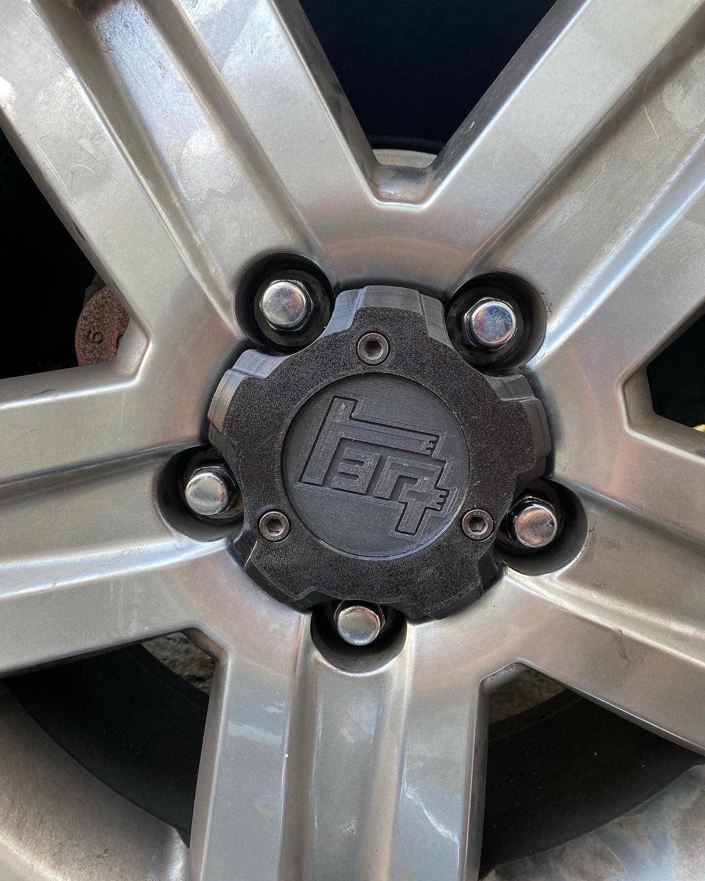

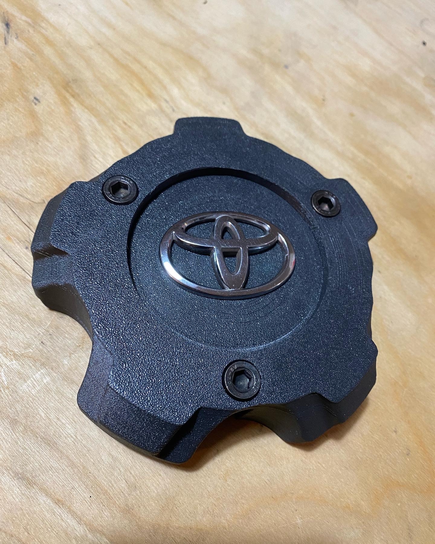

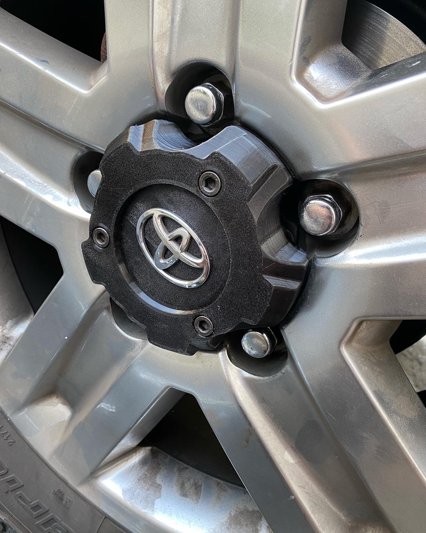

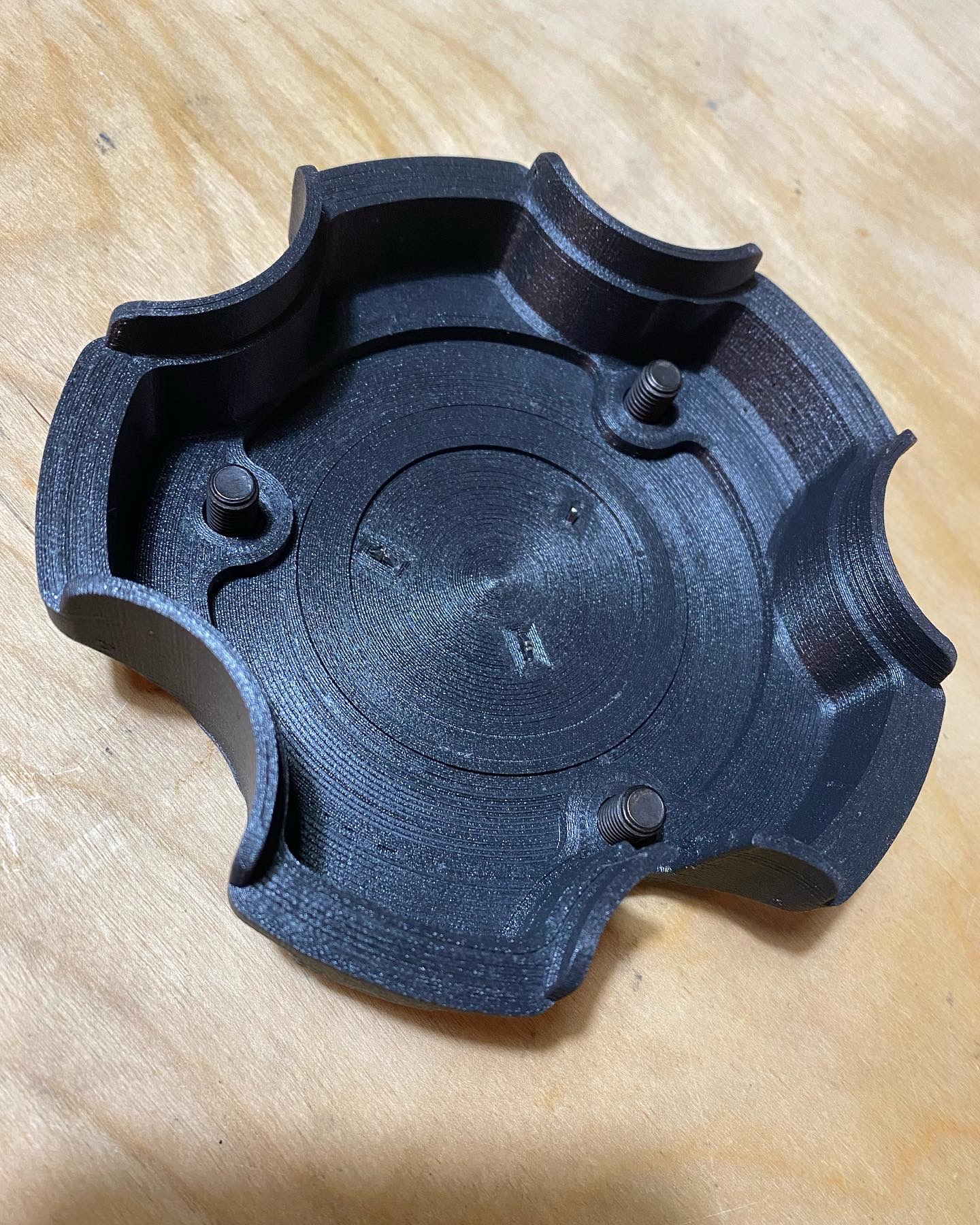

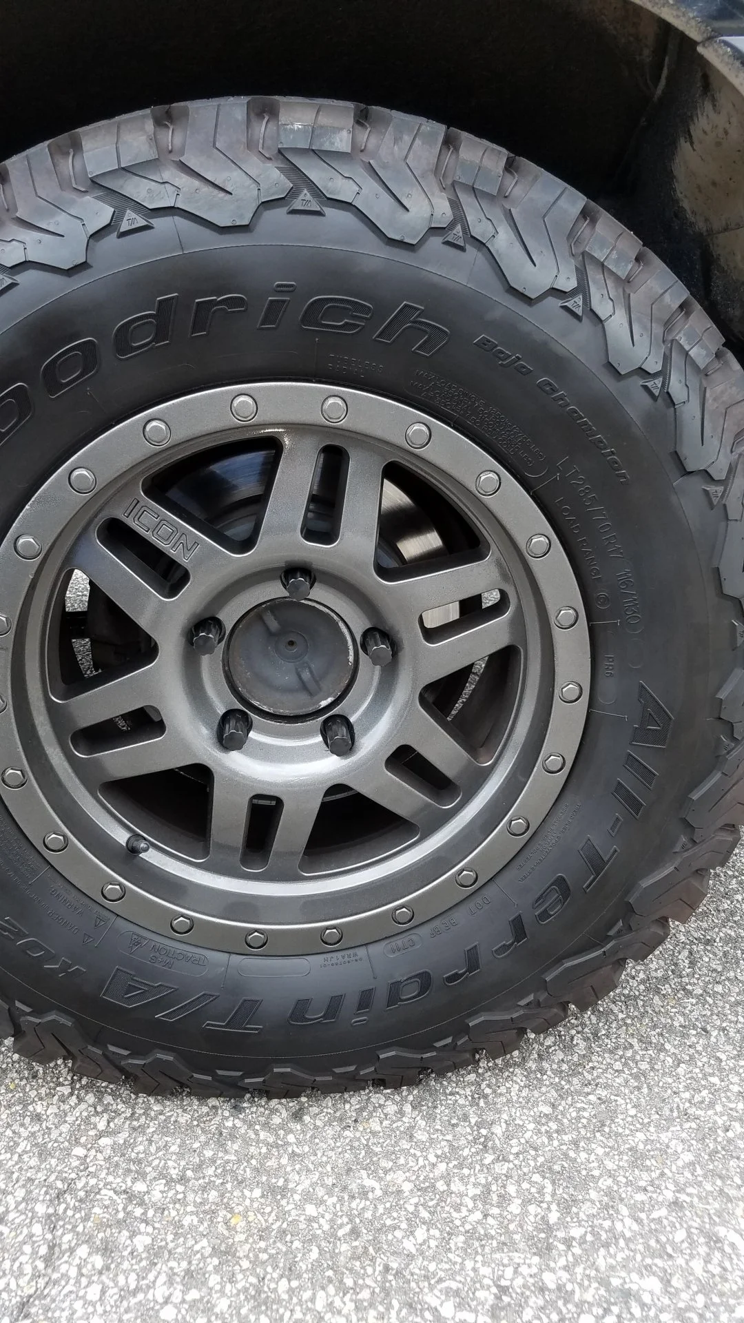

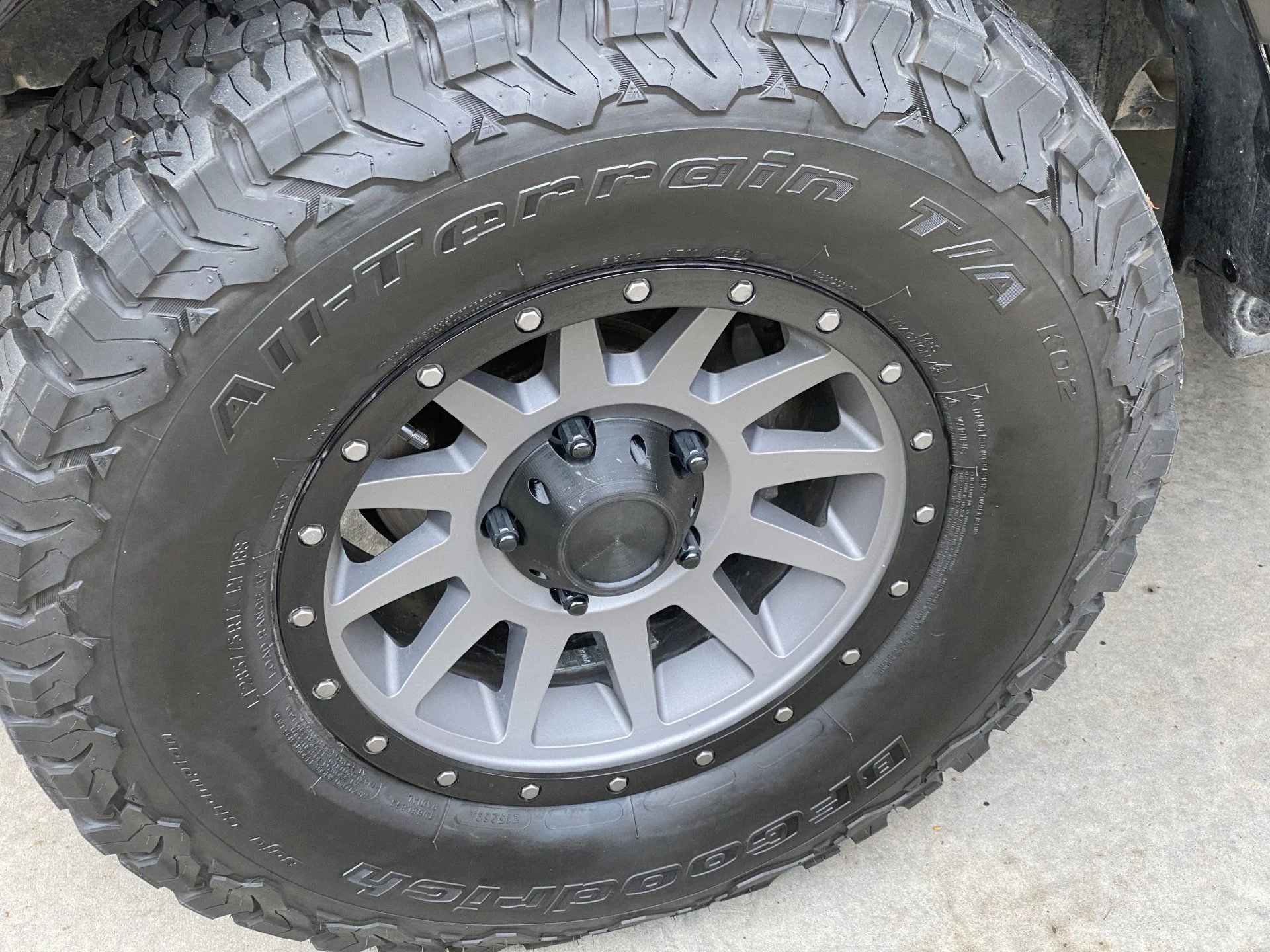

A new make: wheel cap for the Tundra 20-inch wheel on LC100/LX470. It clears the front grease cap.
No for sale yet. Testing.
Two prototypes:
Final product:

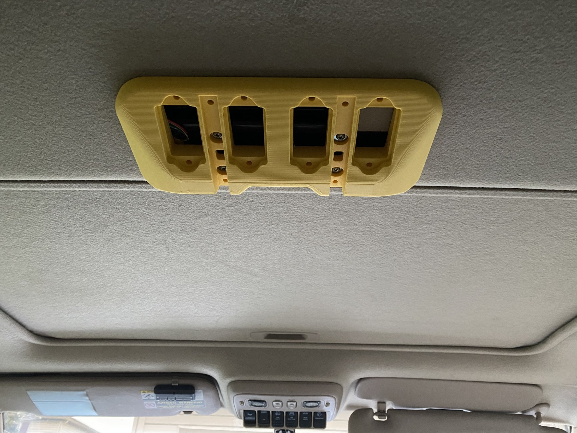

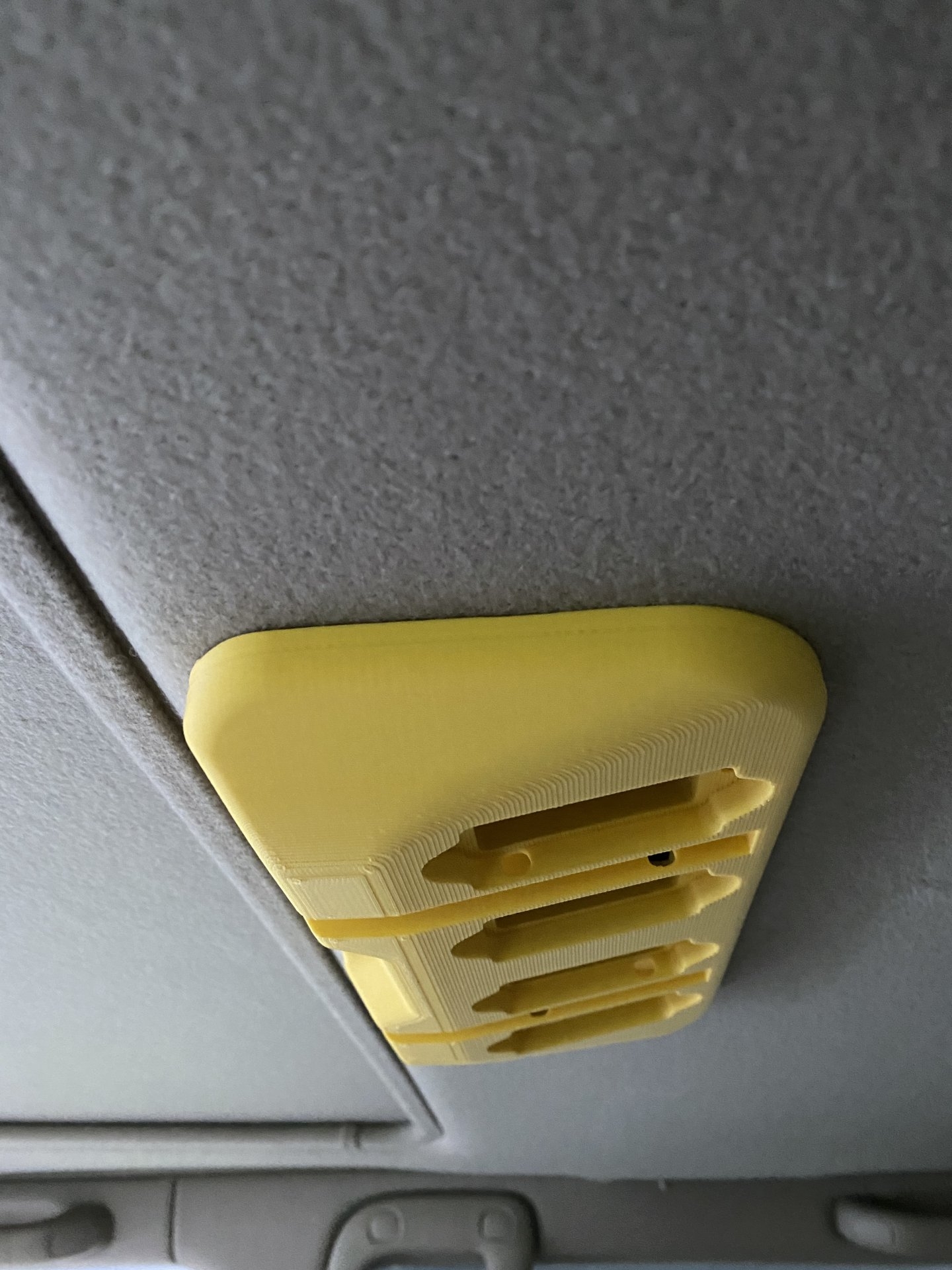

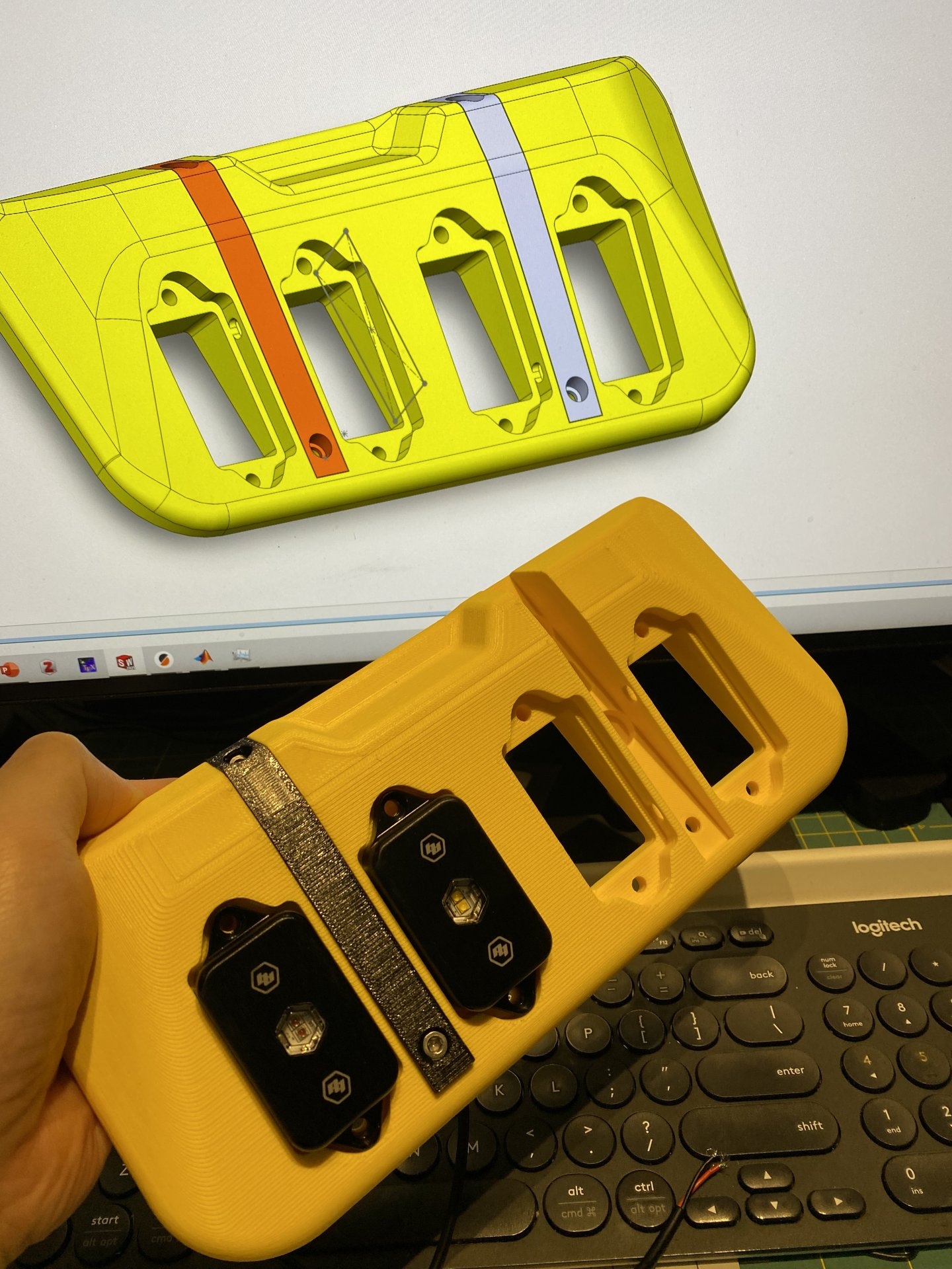

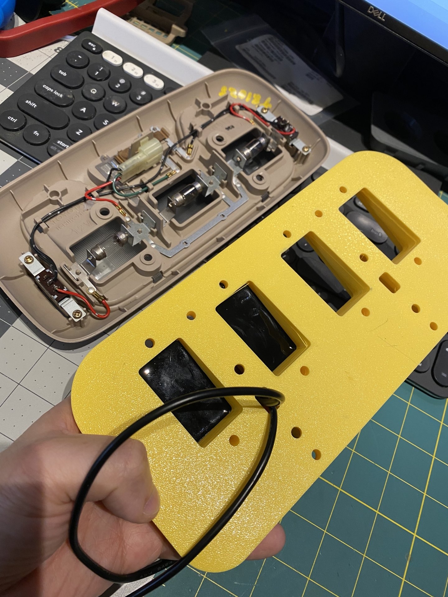

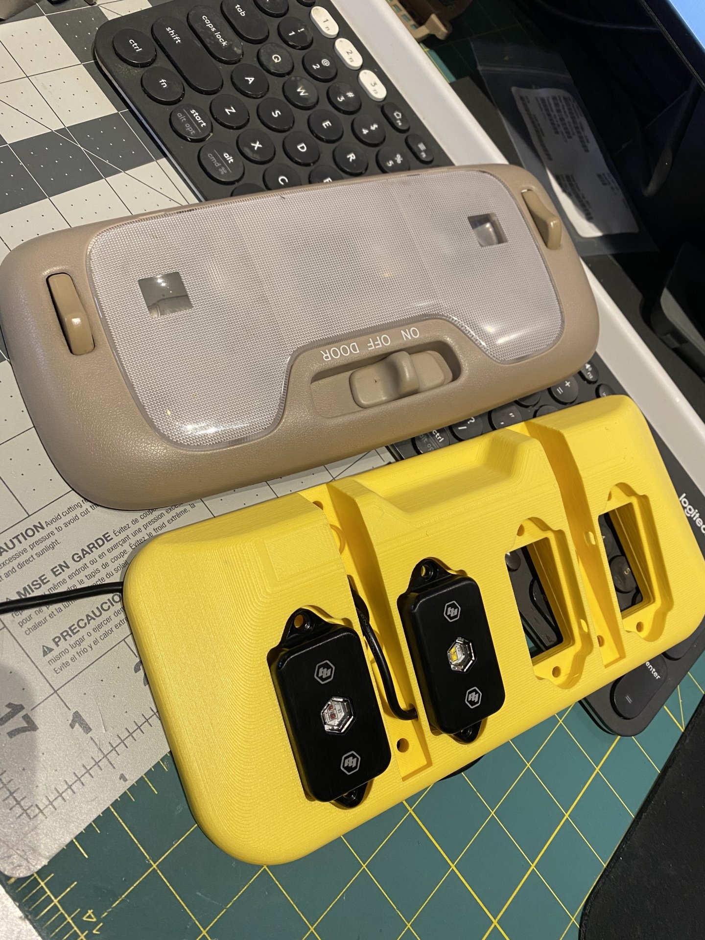

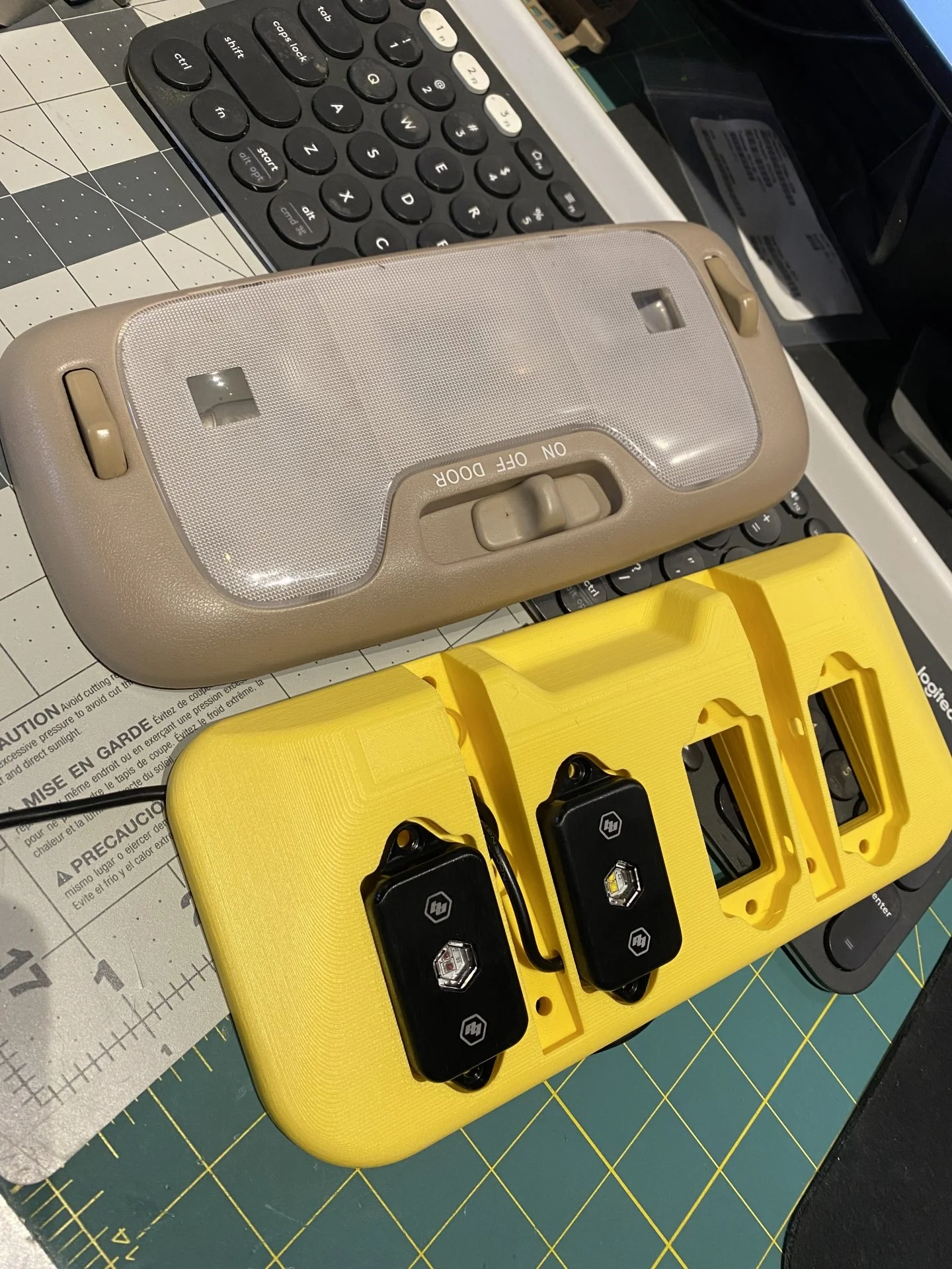

Planned to replace 2nd and 3rd row roof lights with packaged LED units.
The pics show the prototype for the 2nd row. It can take four Baja Designs Rock Light. Is it too much? The four LED units cost about $240.
Why don’t I just use LED panels?
1 Batches differ in dimensions slightly.
2 LED panels don’t have heat sink.
3 The availability is limited these days. They are always out of stock.
This is how it looks on the truck. I am making sure the prototype can be mounted on the truck. The design is subject to change. I would probably only mount two LED units. But there is no space for regular rocker switches in the roof. Need to find a switch with small depth.

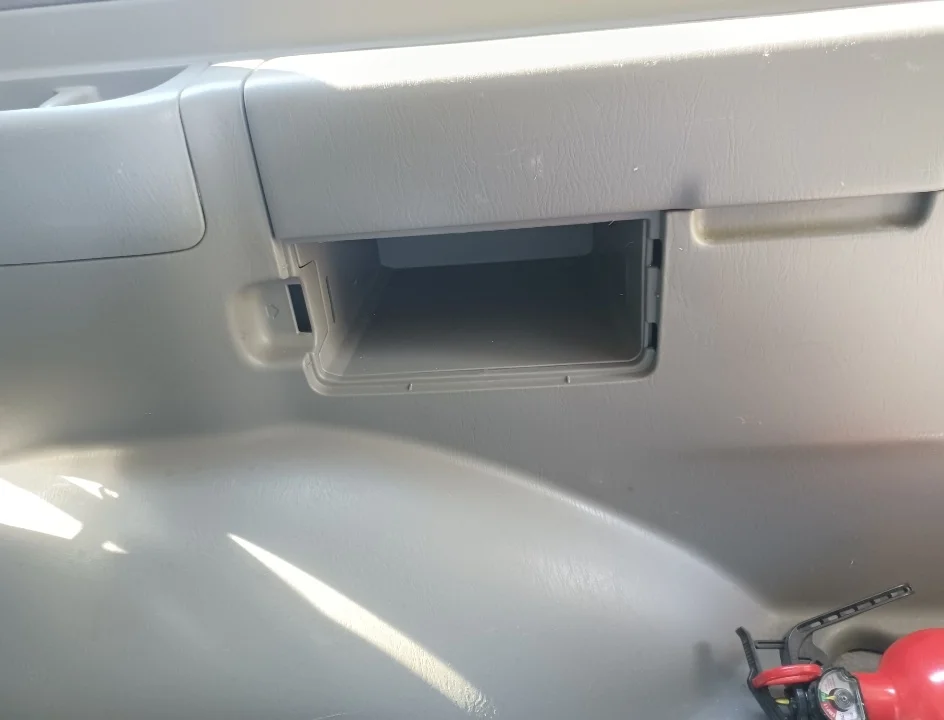

Do you know the part number on that storage container? Mine actually has a DVD player in that spot...I would like to remove and put the storage piece in there.
Ben,
Do you have any ideas for this storage area?
I have a 400W inverter that fits perfectly perfectly in there.

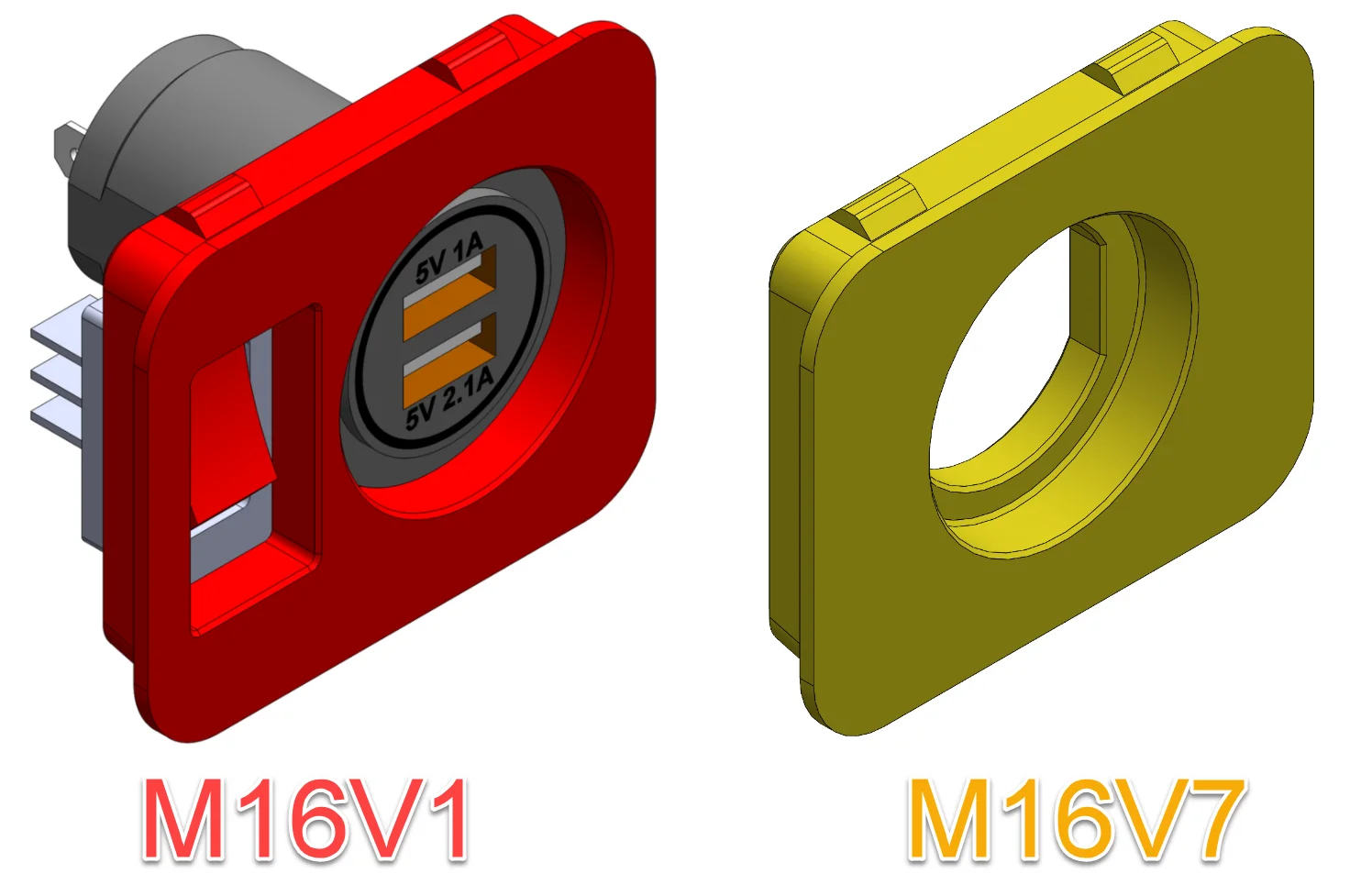

Tested the three-switch mount. The rectangular hole is a few millimeters short for three switches. Too bad it cannot be fully recessed.
This is one of the configurations. Planned to have
1. 1V2H (V: Vertical, H: Horozonral)
2. 3V
3. 2V (recessed)
Let me know what you think.

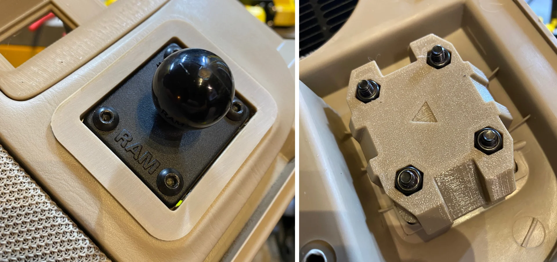

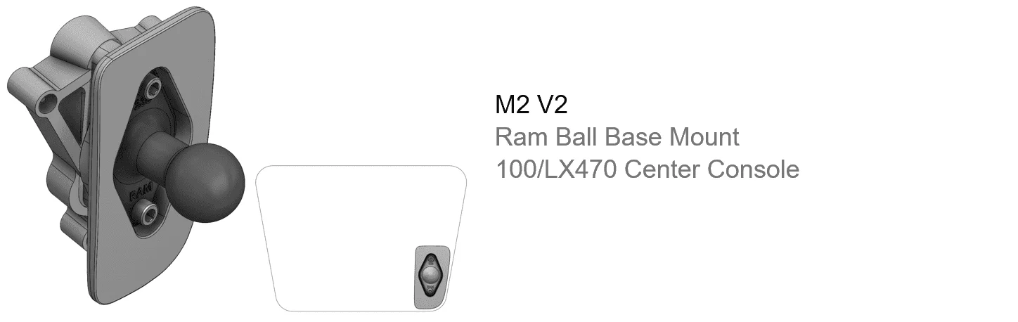

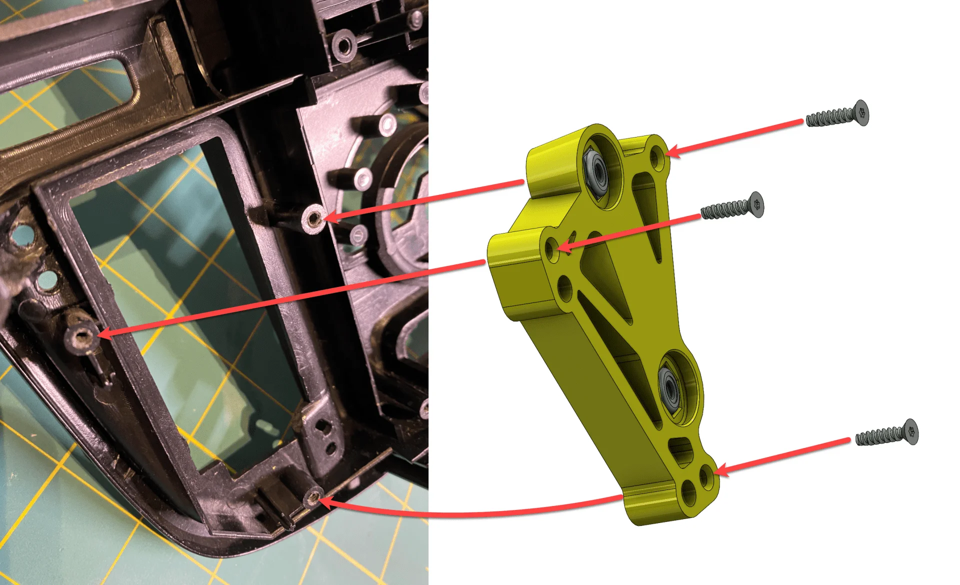

Make 2 V2: Ram Ball Base Mount
1. Overview of the Final Product
This is the final product, M2V2, installed on my truck.
2 Introduction
The design has two parts, the backing bracket and the face panel. The backing bracket is to reinforce the factory panel. Three existing fixture points are used.
The following figure shows the whole assembly (Ram ball mount is not included in the order).
All fasteners are 18-8 stainless steel and will be provided.
Three #4 Flat Head Thread-Forming Screws for Plastic
Two 10-24 Nylon-Insert Locknuts (Black-Oxide)
Two 10-24 Socket Head Screws (Black-Oxide)
3 Fabrication
The face plate is printed using chopped carbon-fiber nylon. It has a matte black surface finish. No painting/sanding/prepping is needed.
The backing bracket is printed with ABS.
This is the first project that I cooperated with @suprarx7nut utilizing his fantastic Markforged printer. The chopped carbon-fiber nylon has very high stiffness and high toughness compared to ABS I used on most of my makes.

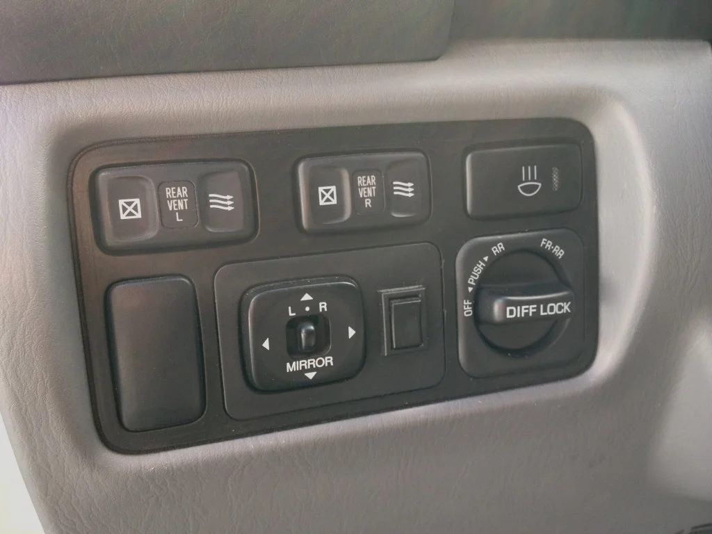

Hello,
Could you consider making an insert that goes where the factory diff lock switch sits - which will then accept a factory Toyota switch? 2 switches would be good even, but dont think that square shape is large enough...
Hey @BenCC , have you had a chance to make progress on trying to fit (1) or (2) OEM style switches in the diff lock switch location in this pic?
