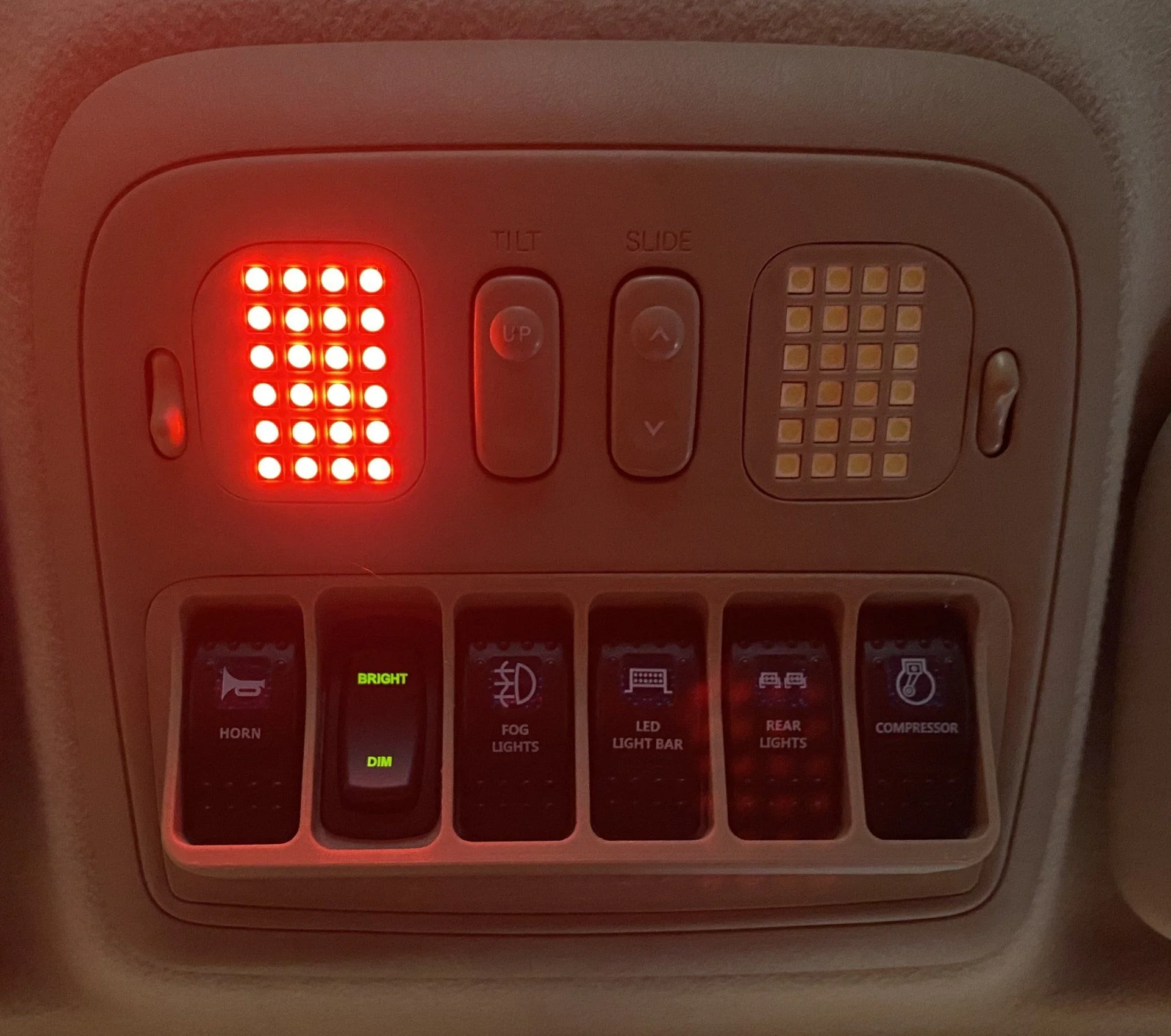

21.1 Overview of the Final Product
Note: The rocker-switch mount is M4V4.

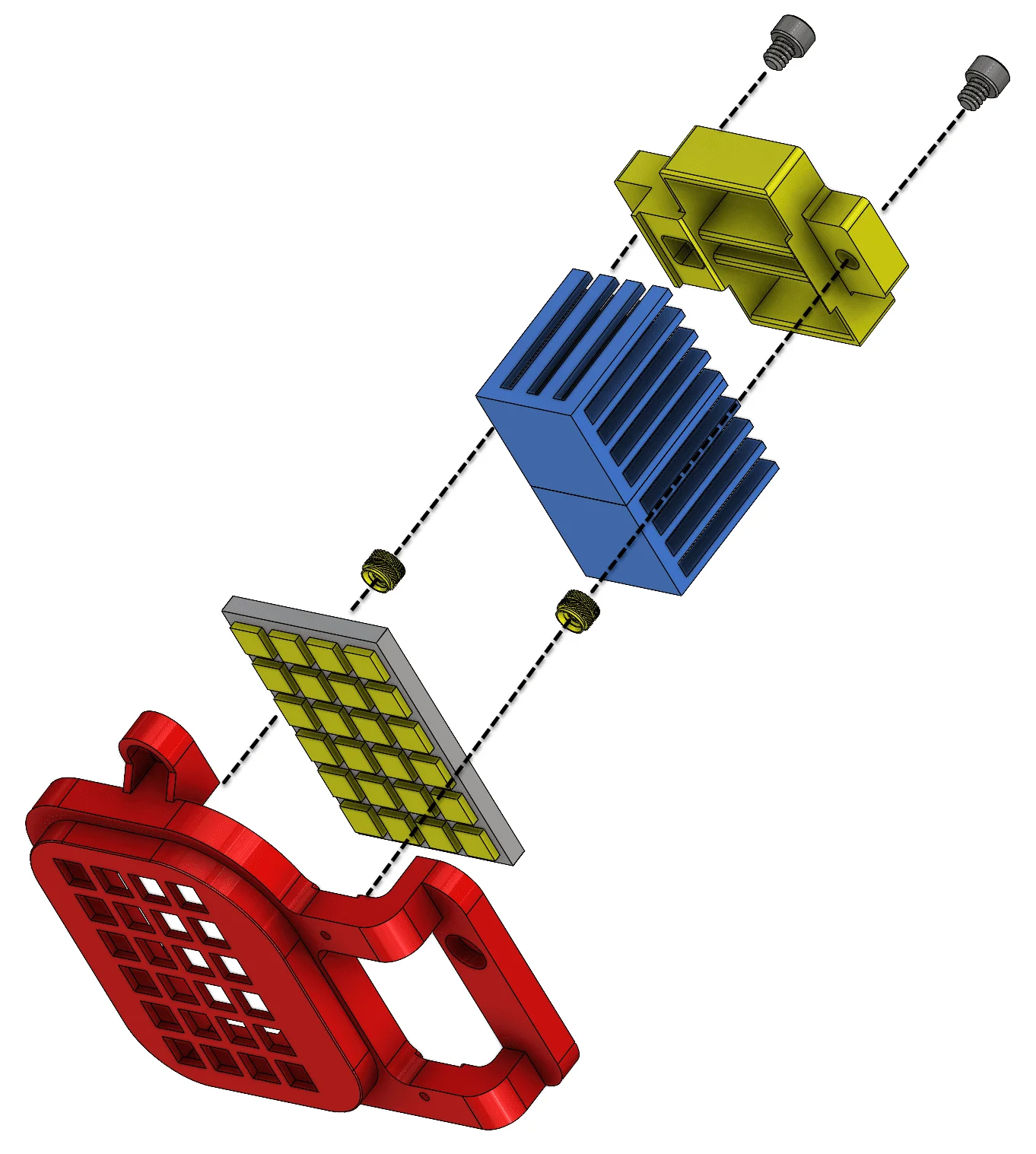

21.3 Design and Fabrication

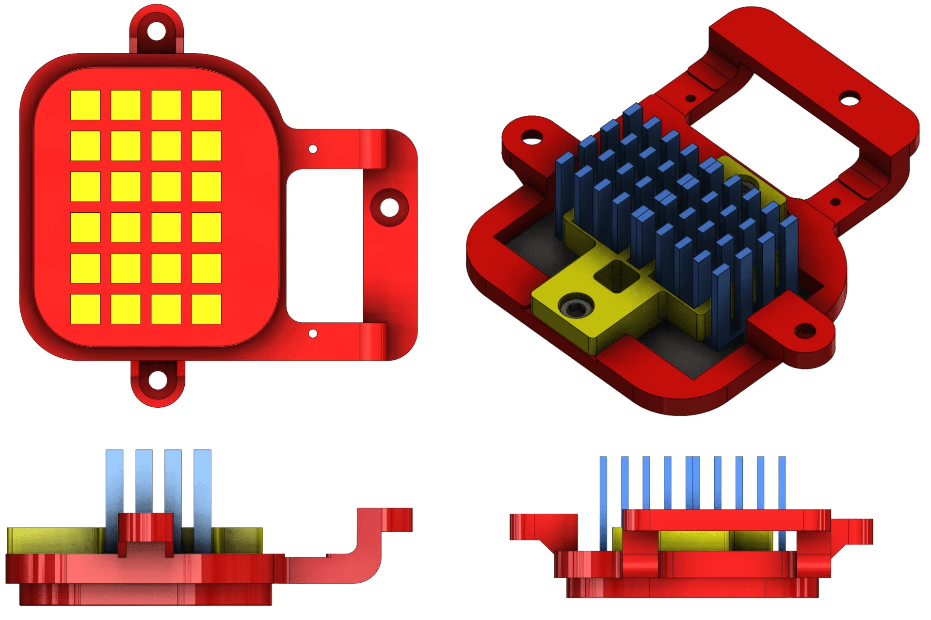

I used to put LED panels inside the lenses. Don't like that very thick adhesive stickers have to be used to fix the LED panels. The thick stickers retain the heat and shorten the panels' life. In this design, the LEDs are exposed. Heatsinks are put on the back of the panels.

The flickering is only in the video. I cannot see it with my naked eyes.

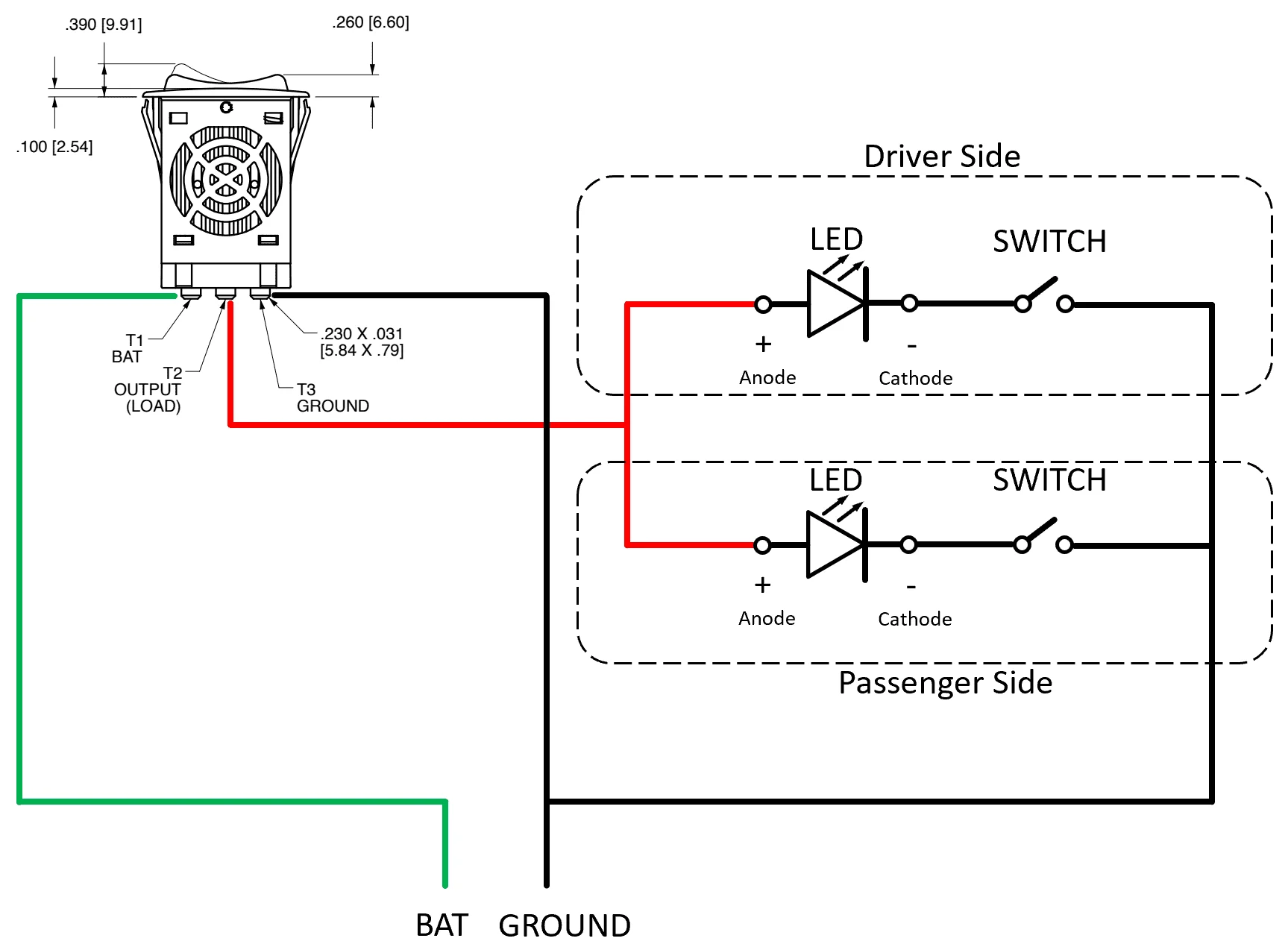

Wiring diagram:

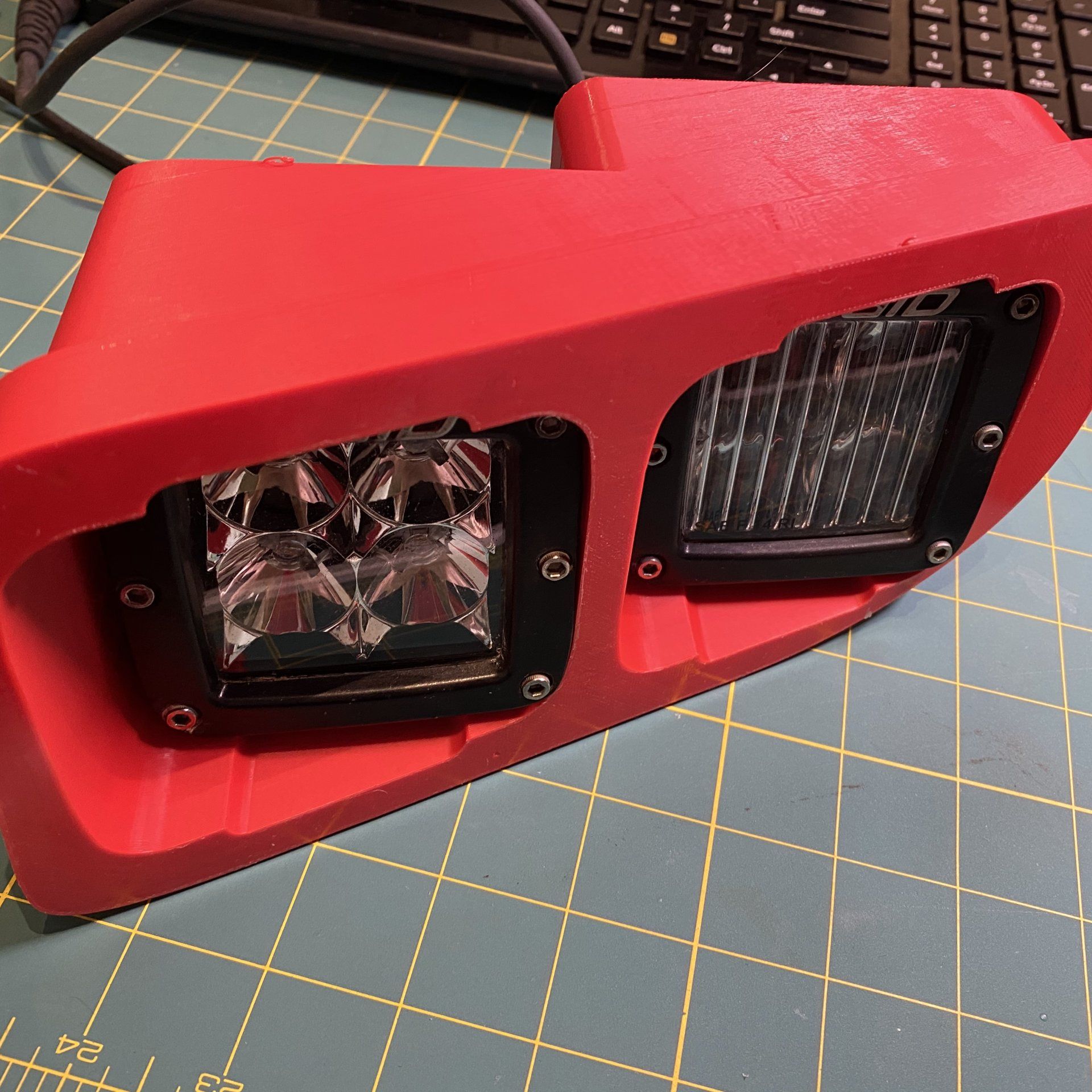

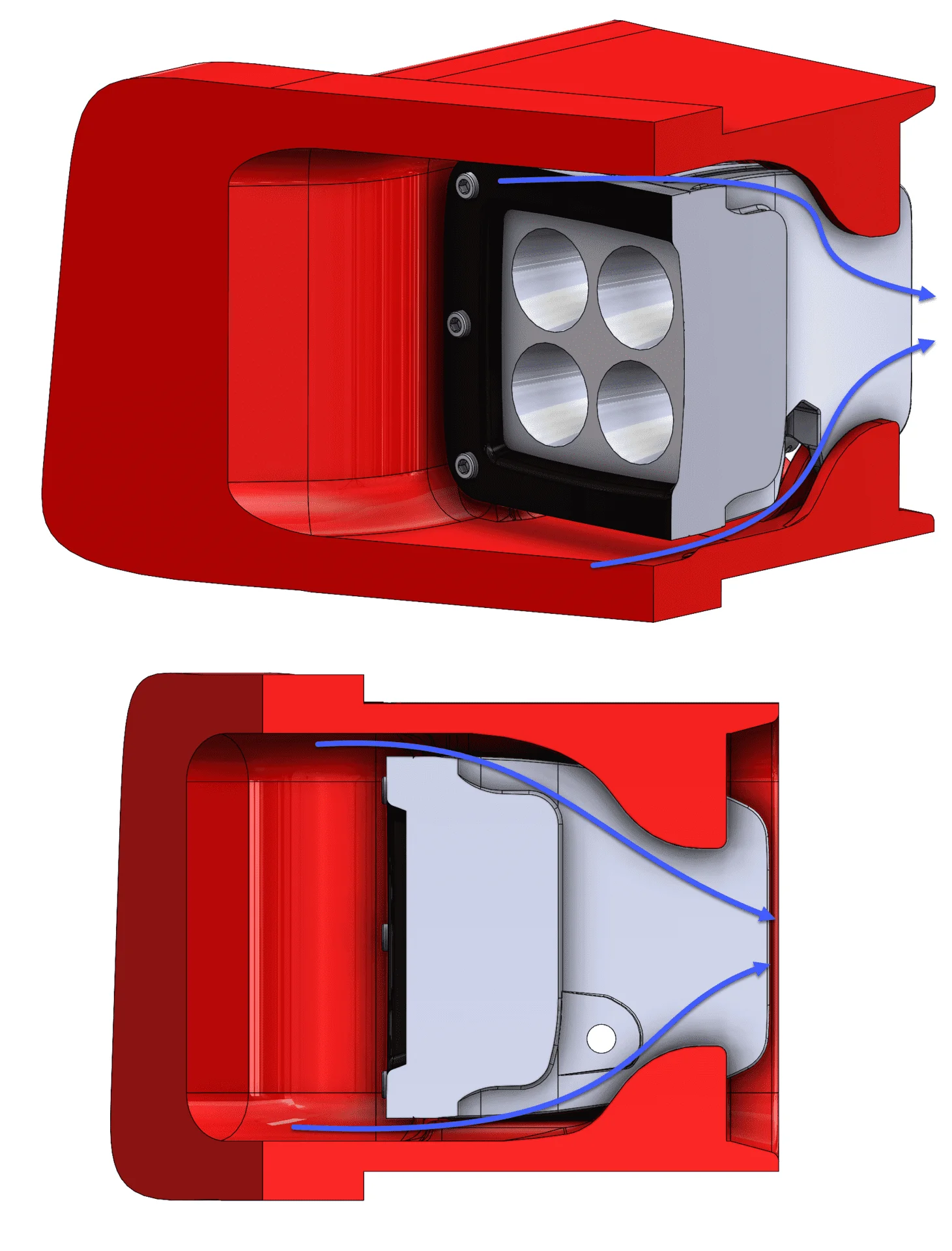

Some update on the foglight mount.

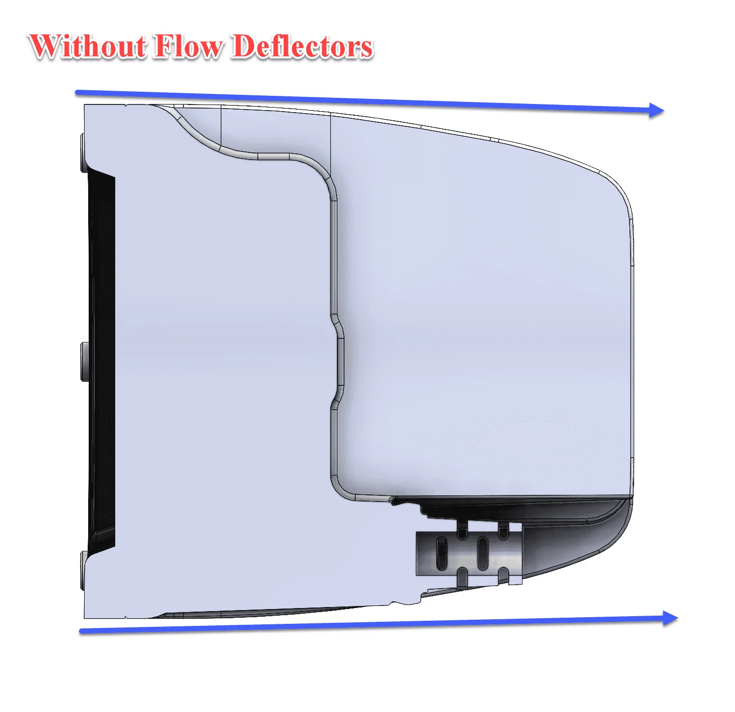

I changed the design to only mount one Rigid Industries D2 light instead of two. Mounting two is still possible but the wall thickness of the mount is pushed to several millimeters. I will explore the design for two D2 lights later. The major distinguish feature is the embedded flow deflectors. Without the deflectors, air would just pass the heatsink fins. I used to put D2 lights in confined space and they heat up quickly. With the deflectors, air should be directed to cover larger area of the heatsink fins.
Plan is to print in ASA material (good weather and UV resistant) and mount on my truck for several weeks and keep improving before being released.
Please feel free to comment and critique.

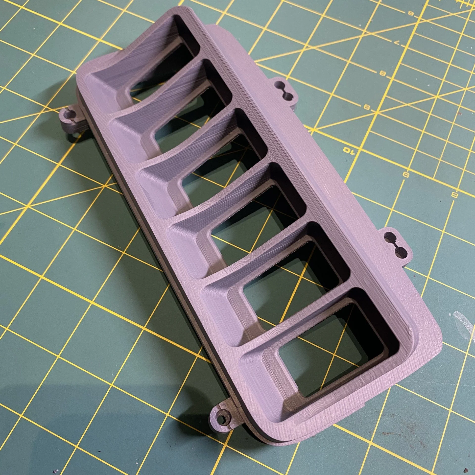

A test print:
looks great, what bumper is this intended for? Any pumper that takes the factory fog?
@BenCC : That looks great! The only concern would be that if Rigid decides to change the design/layout of their heatsink fins and then it's back to the drawing board. But other than that it's a great design that looks almost OEM, love it. The big question would be whether to color match it gray to the bumper or do black to offset it a bit.....hmmm...
It is a good point. The design of the D2 series have been stabilized. They have been using the design for years.
