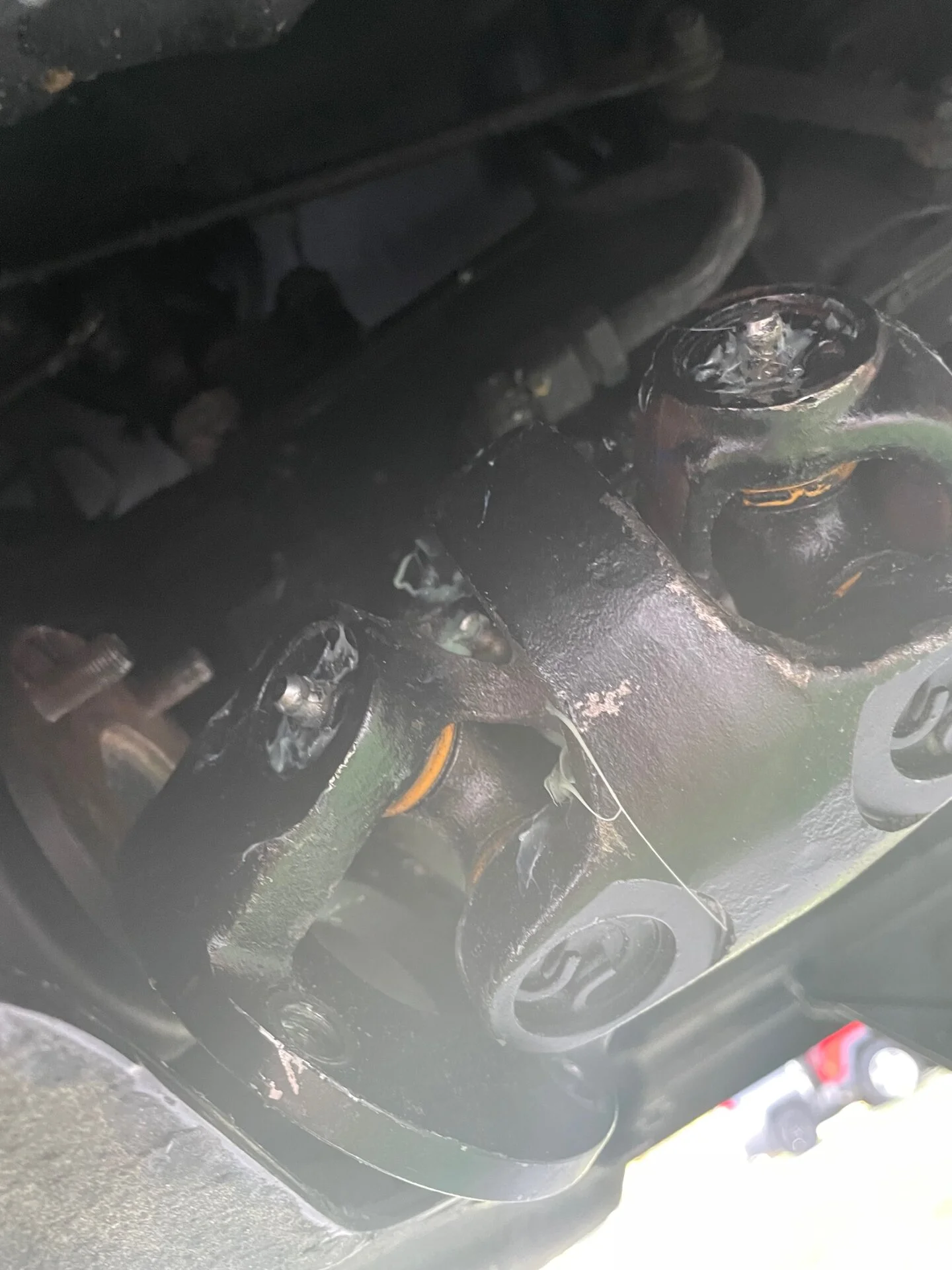

Did you grease the center part of the DC joint? A lot of people miss that and it's catastrophic when it goes. TW states it's supposed to be greased every 3000 miles IIRC.
shoooooooooot, not sure. I know i pumped all 3 joints and the yoke. didn't see any other zircs. that's probably it, damn.
Should be four plus the yoke.

To grease that shaft properly you need to take the shaft out of the truck.
Might as well lock the center diff and see if the noise is gone while the shaft is on the floor.
You also need a needle tip for your grease gun to get the center zirk. The TW double cardan is a decent drive shaft, but maintenance is a PITA.
Well dudes, i dropped the shaft this morning. I was able to get to the fitting by just taking off the rear 4 bolts, jacking up the front of the truck and spinning wheels until i could access the fitting with the joint bent.
greased up that fitting and no more noise! Hopefully I prevented too much damage cause I didn't drive too far with the noise.
Thanks for the insight, Problem solved! But damn, that's gonna be a pain to do every oil change haha!
