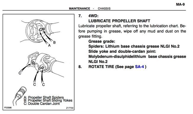

From a 4 Runner FSM: note the recommendation for a Moly fortified grease
for the slip yolks and the Double Cardan joint.
FWIW
