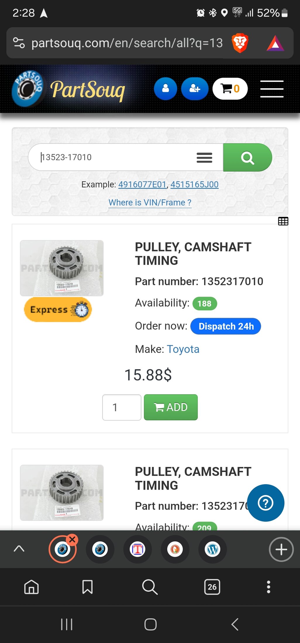

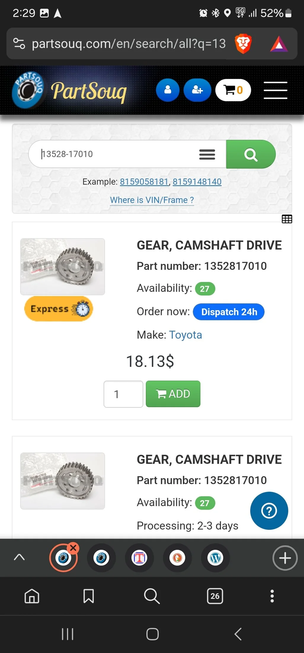

How where belt drive gears removed from cam and pump?
When I tore down my 1hd-t, the gear was so tightly wedged onto the taper of the camshaft, I bent the gear pulling it. I had to replace the gear.
Both gears/pulleys are less than $20.
MIght be the next thing to fire parts cannon at.
