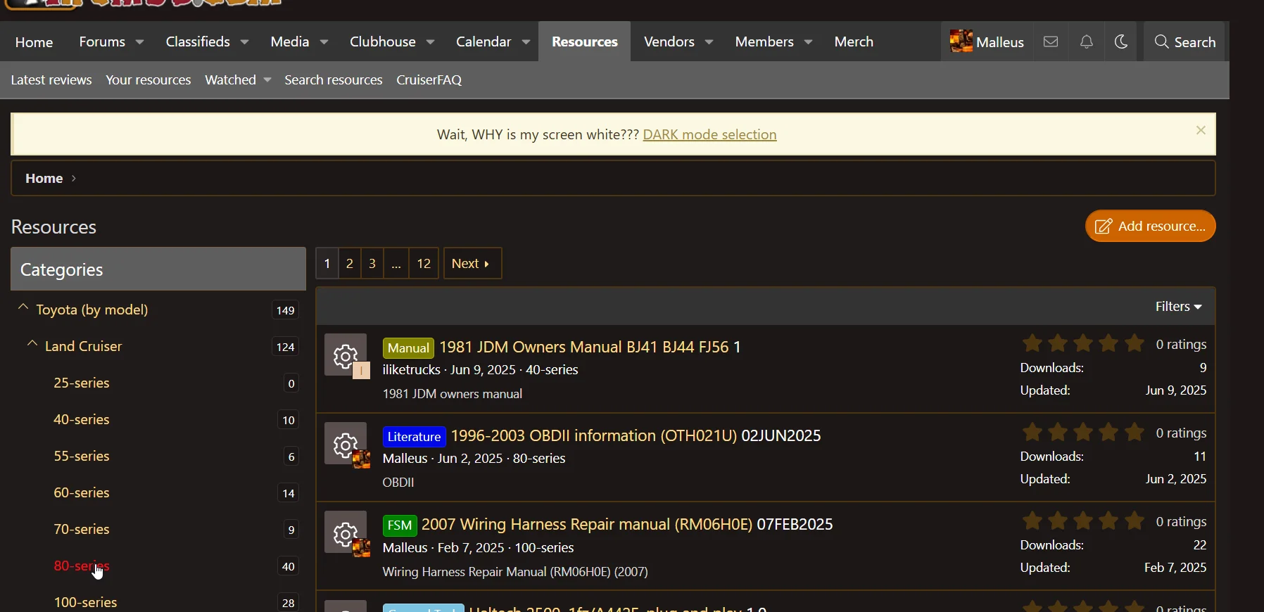

Download the 1993 or 1994 service manual from the Resources forum, 80 series section (I can't remember if there's a '93 version in there or not, they are both the same for this section) and refer to the Automatic transmission section of the manual.

Where are you finding PDF files of the 94 FSM? Thank you for posting this.
You won't see this on your phone (another good reason to use a computer for computer stuff...)
Pm me your email and I’ll send the zip file I have of the 94 FSM. Its one I got before we had the awesome resource section on here. Thanks to @Malleus
The version in the Resources forum is bookmarked ;)
